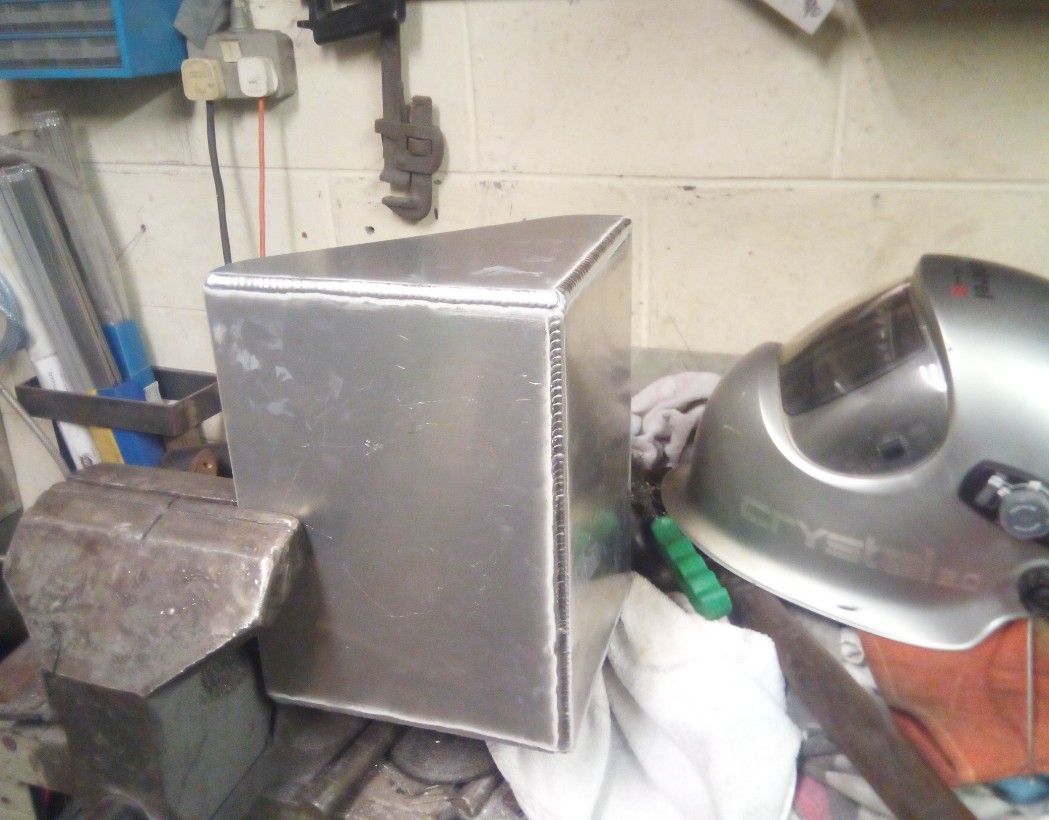

Yes but I have never seen anything as bad as that before which suggests, at least to me, the heat treatment of the sheet was not correct.
I have noticed a lot of that kind of thing increasingly happening over the years with the Aluminium, I have seen me chopping off a 150mm wide strip from 10mm thick sheet and the cut piece ending up like a banana and that was chopping it with an Evolution saw so no heat at all involved.

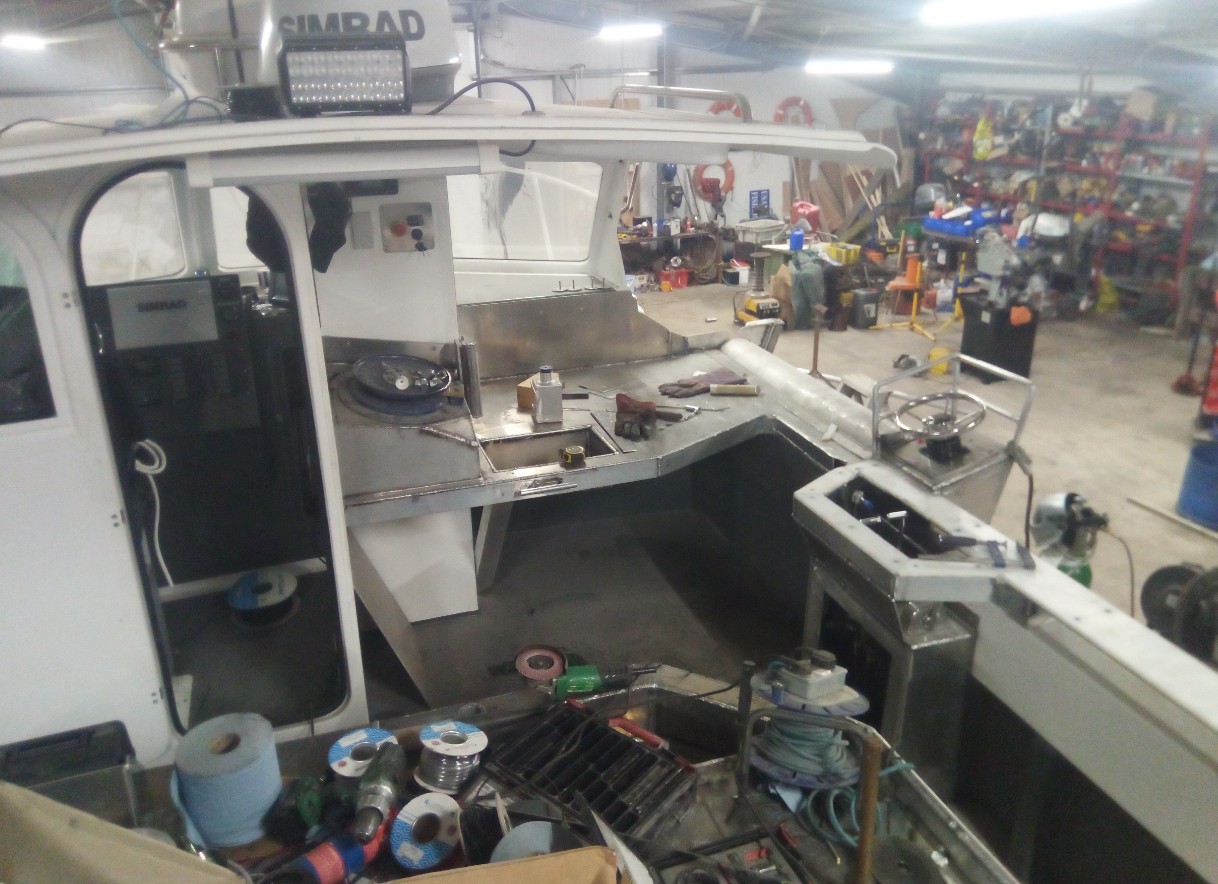

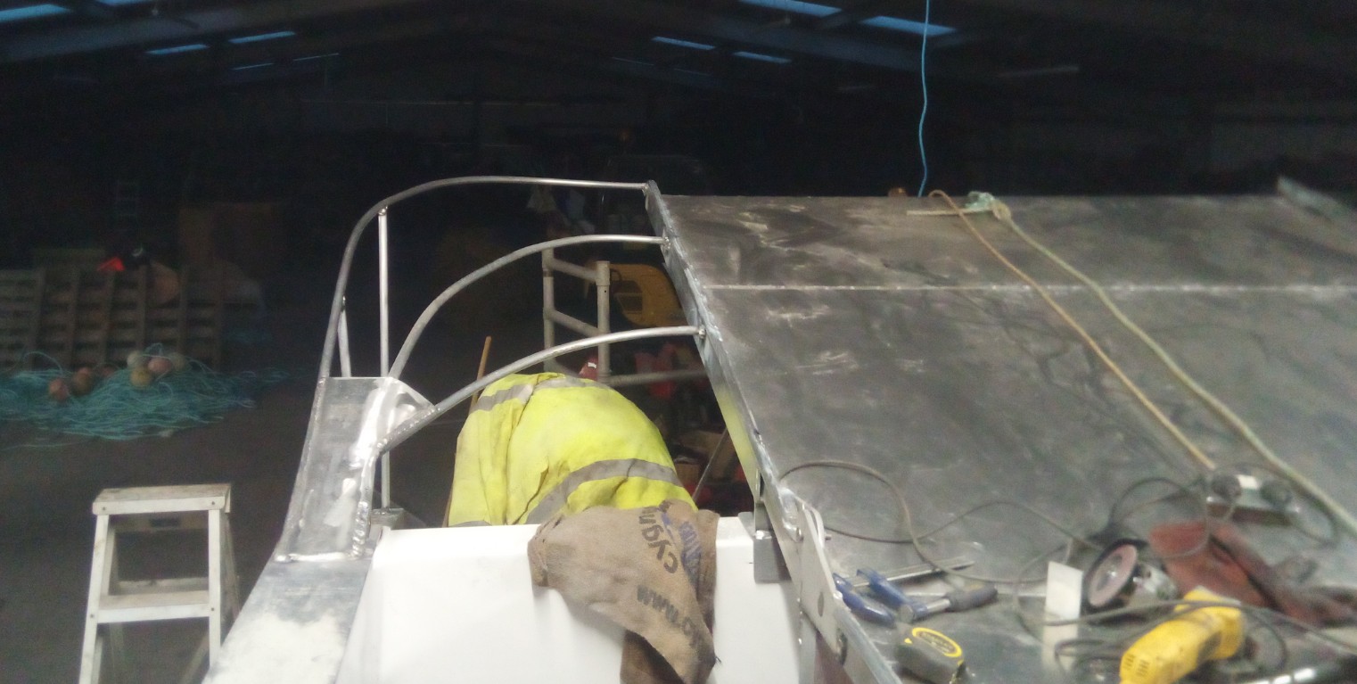

Some more progress.

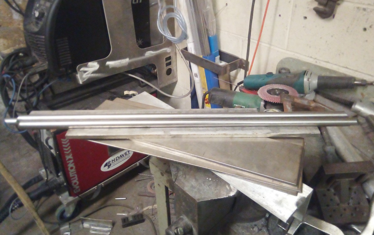

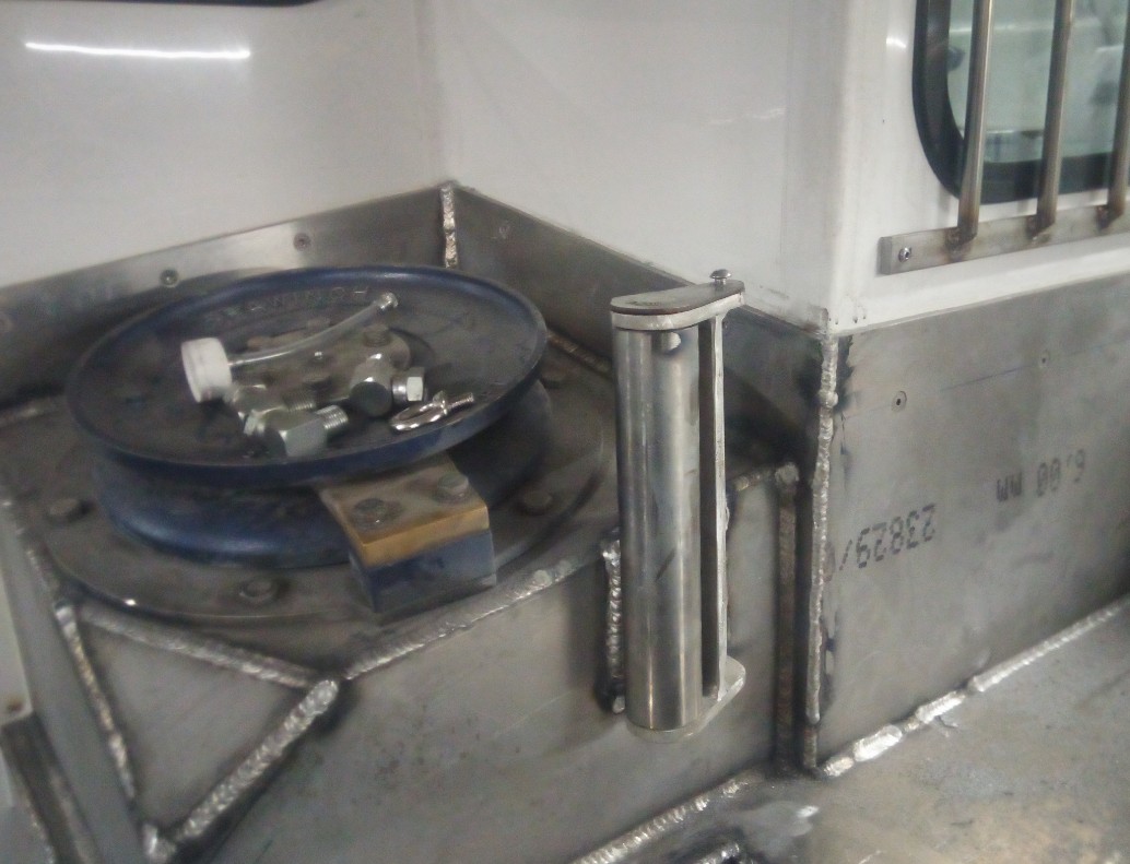

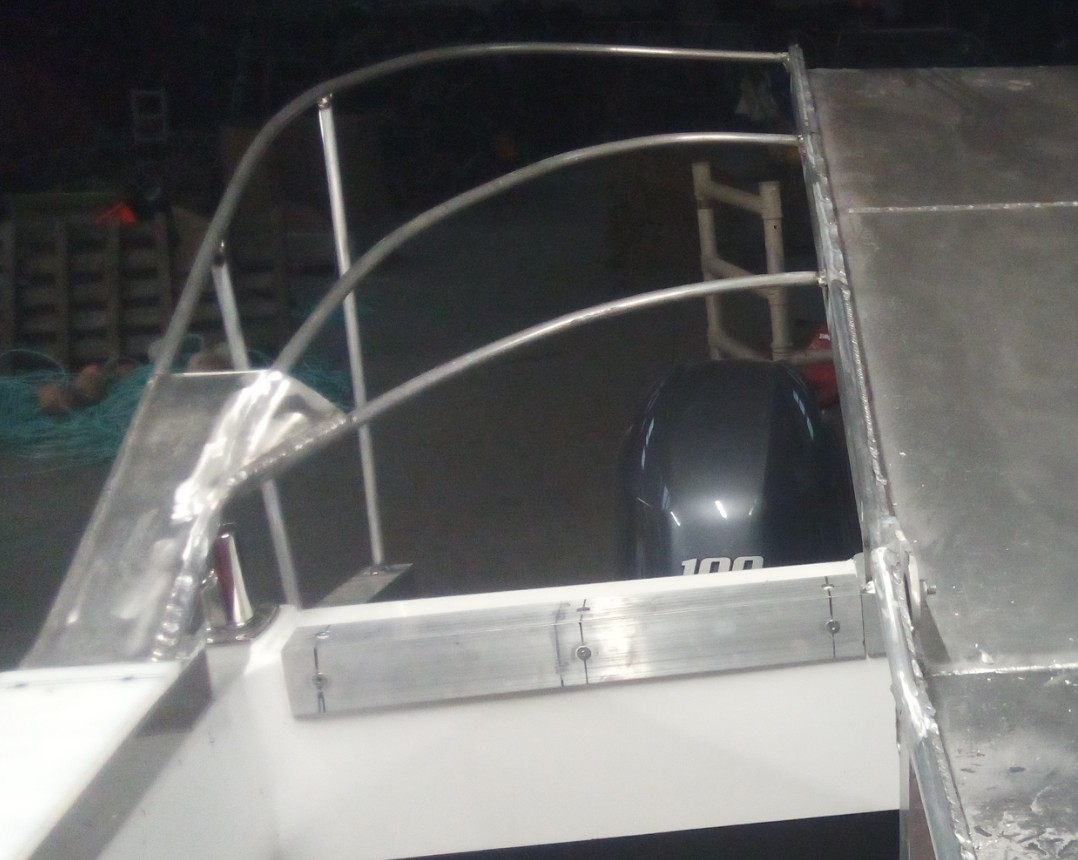

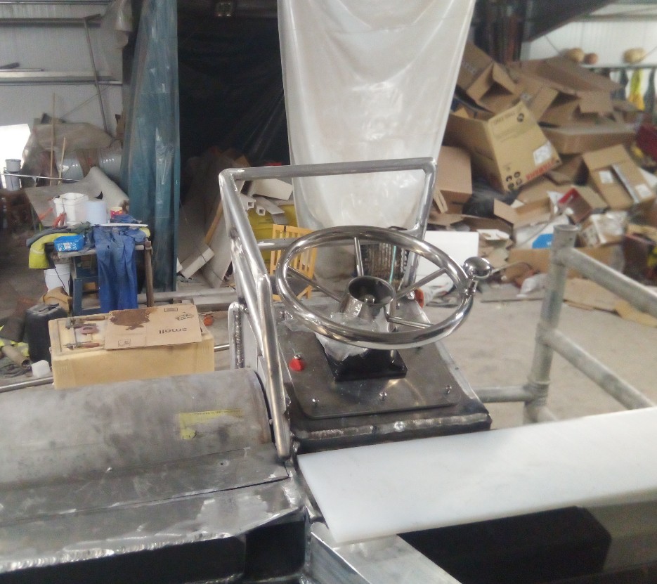

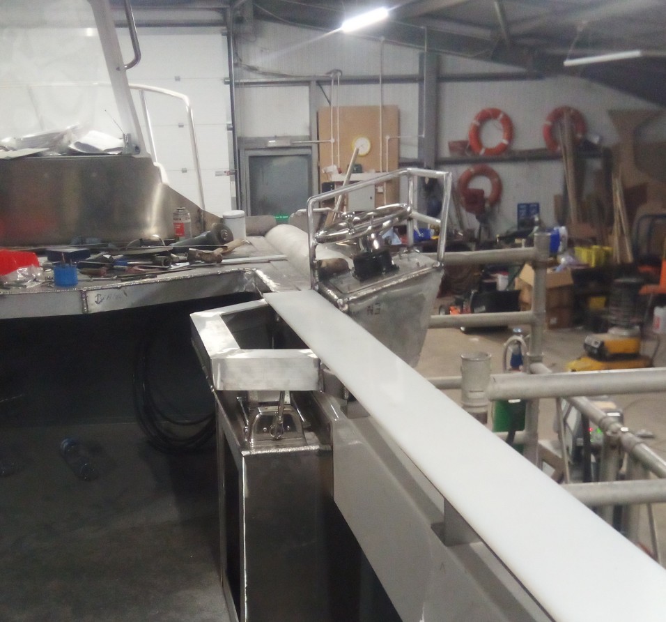

Guard rail around the external wheel.

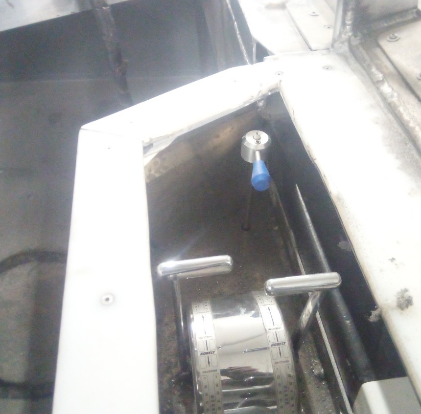

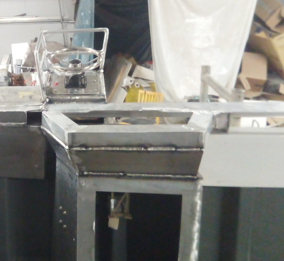

Angle frame around the control handles to allow creels to be slid over the top whilst also protecting the handles and the sides which will stop ropes jumping round the controls whilst the gear is being shot away.
View attachment 198516 View attachment 198517

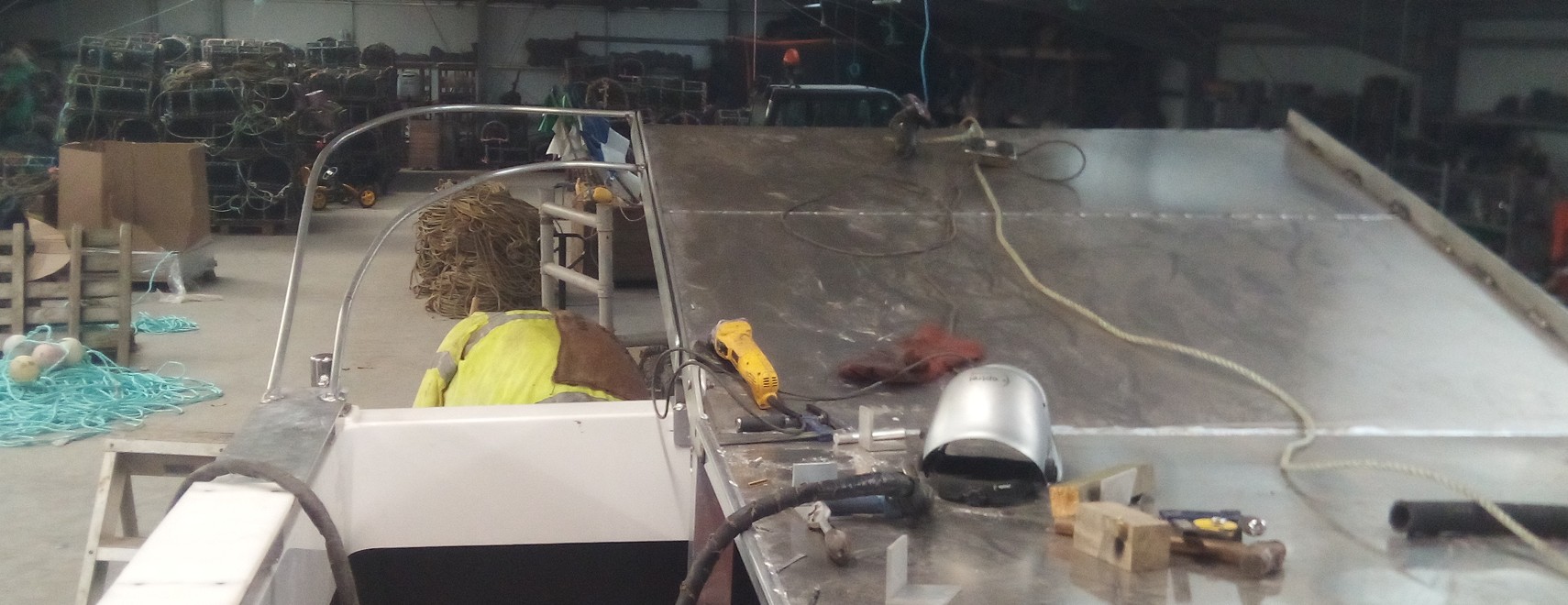

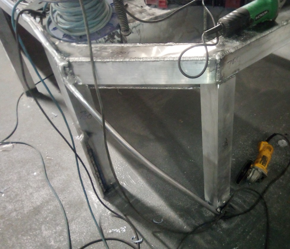

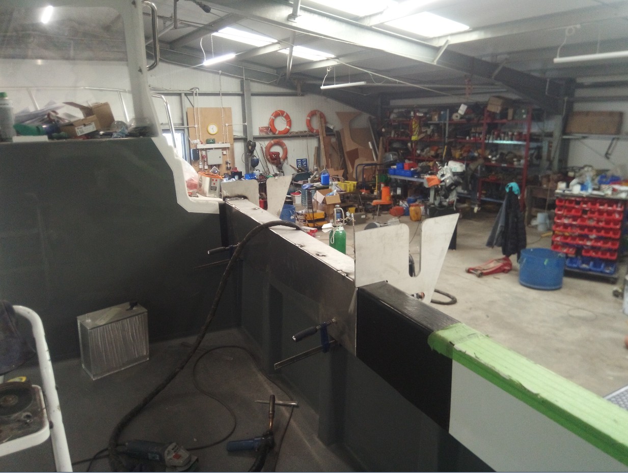

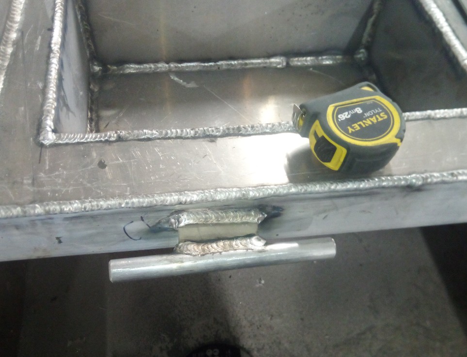

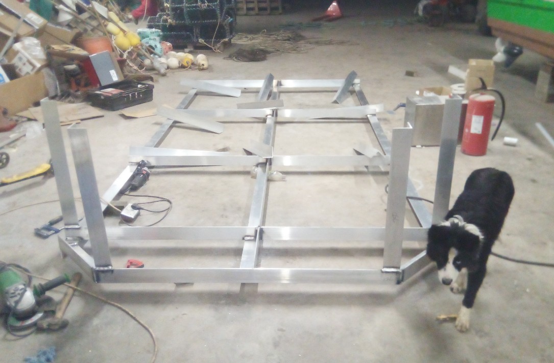

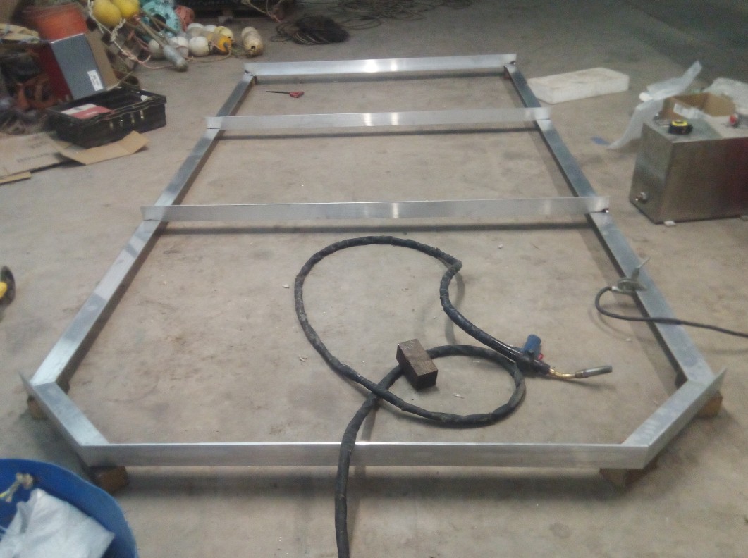

Angle cut for the shooting table, placed on blocks ready for welding.

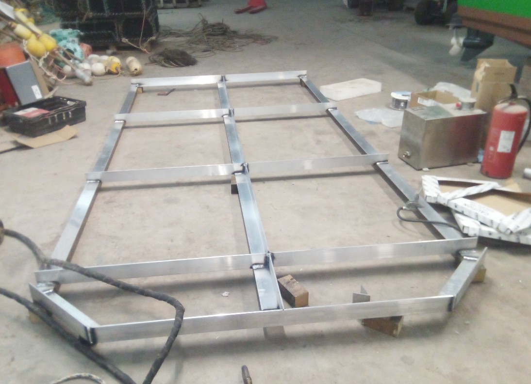

Outer frame welded and middle supports cut and welded in place.

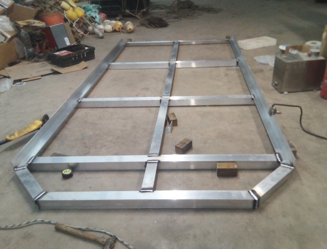

Flipped over and the top side welded.

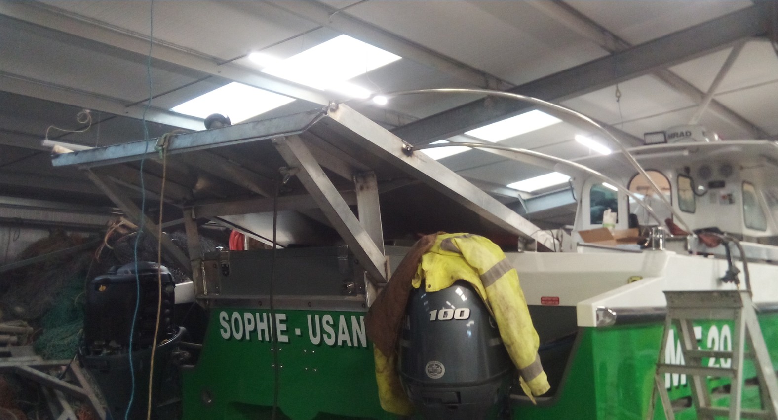

It was then lifted onto the boat and adjusted for height so I could measure each of the 13 legs lengths.
Got them cut and started welding them in, ran out of Argon so the rest will have to be done on Monday.
