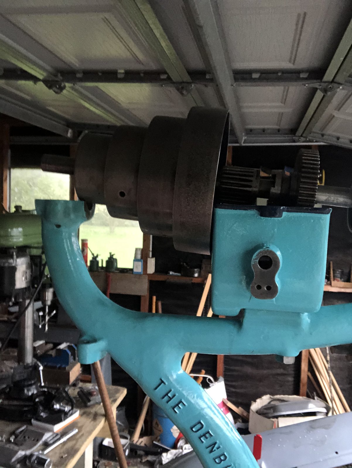

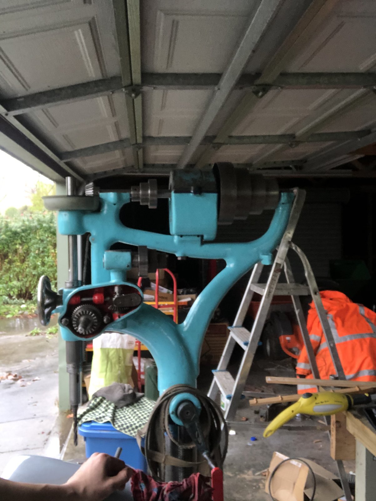

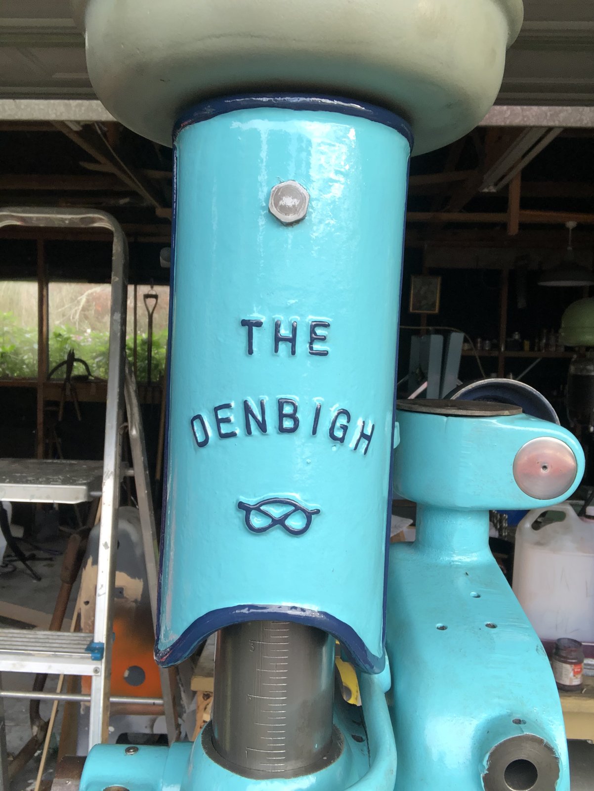

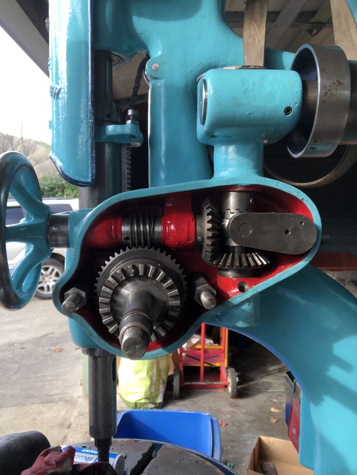

I should have remembered... the cone pulley doesn’t go in when the backgear housing is fastened to the frame. Getting it in was a hassle and probably easier with two but I am just one. It did work eventually!

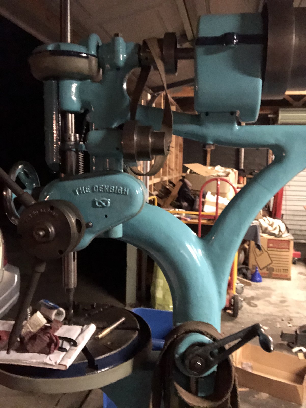

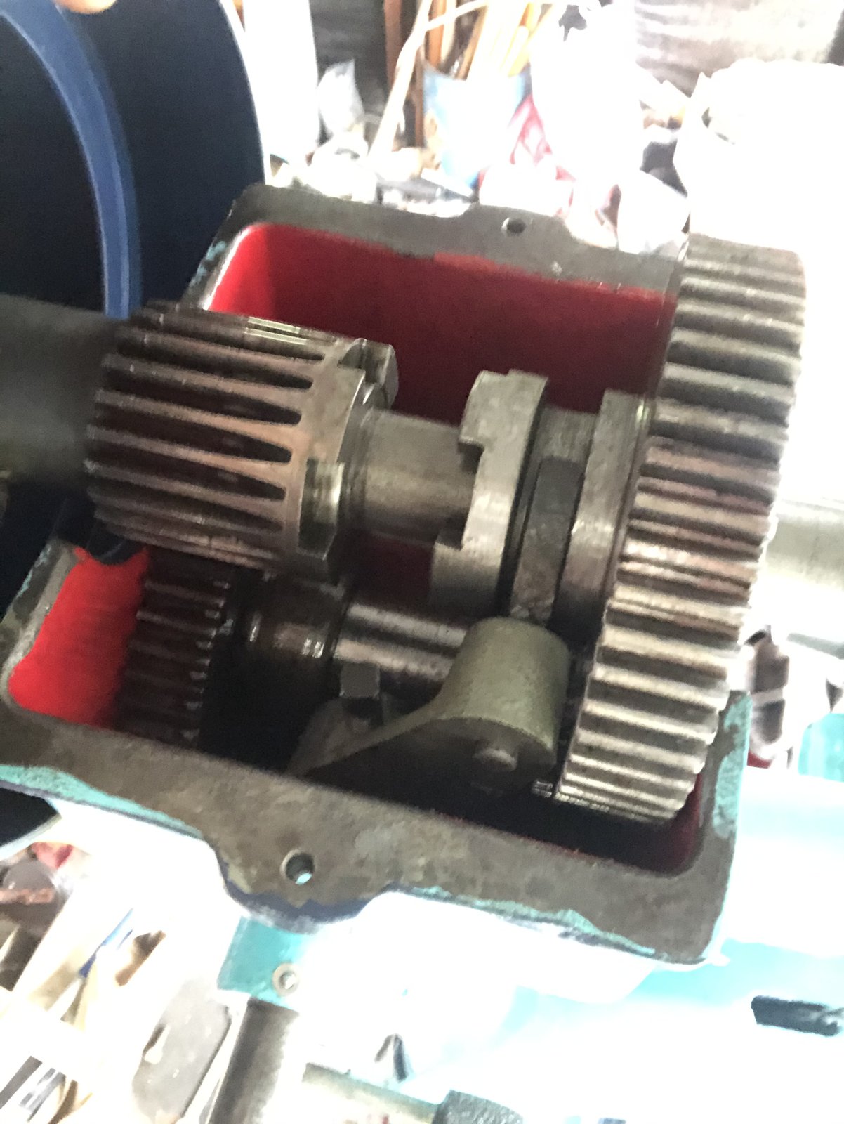

Of course, reinstalling the top shaft means fitting the back gear lever. This was an equally fun task. Now to clean and paint the bearing caps, and the lids for the gear housings.
