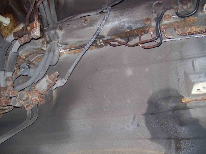

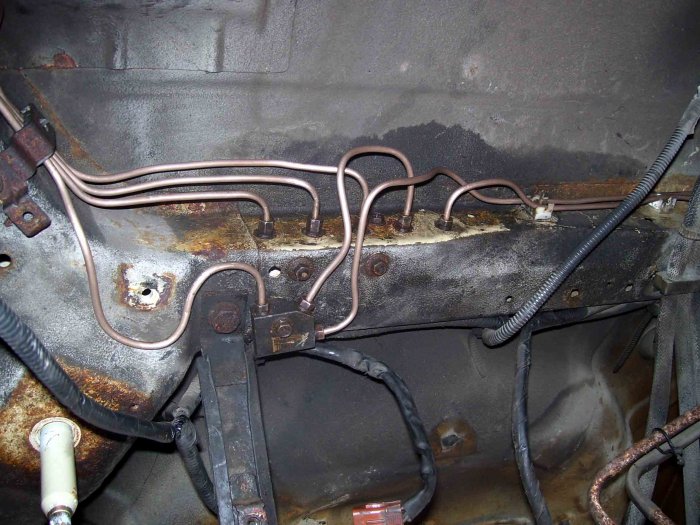

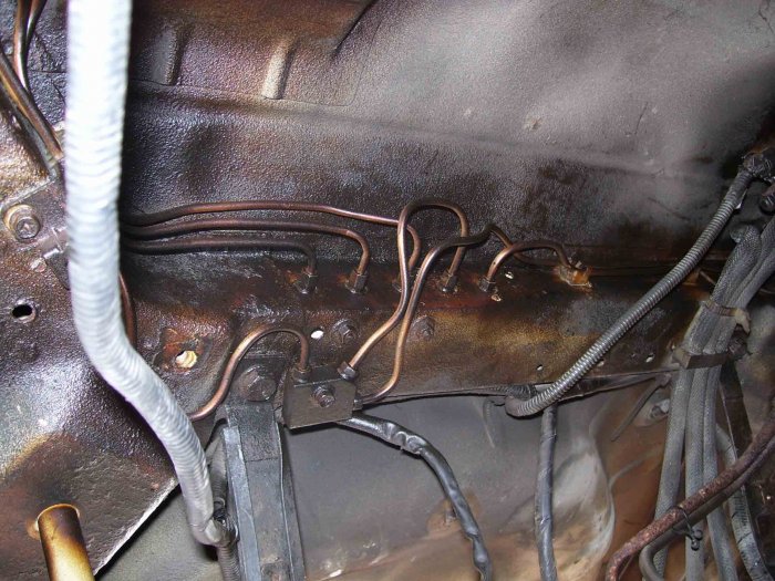

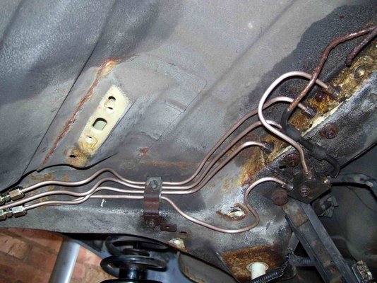

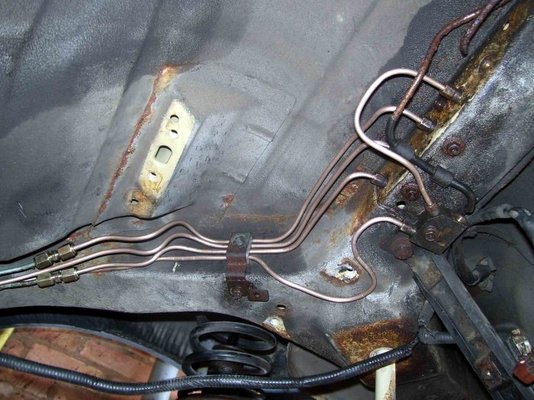

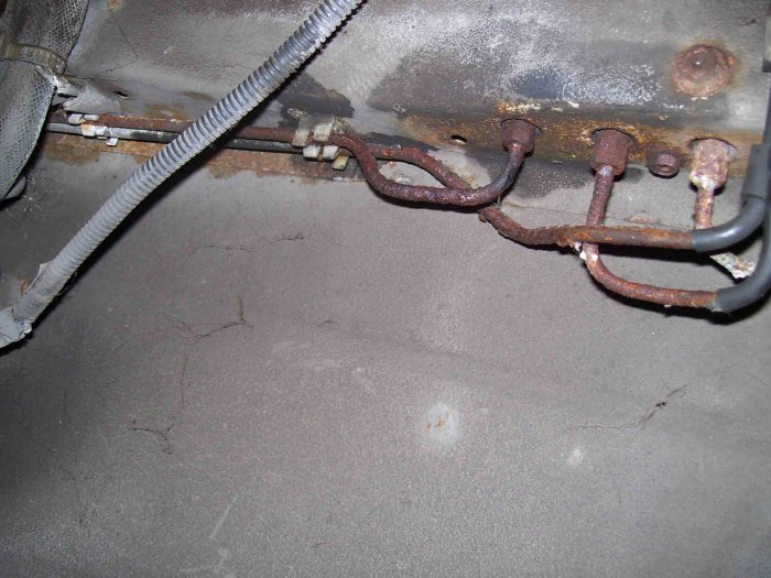

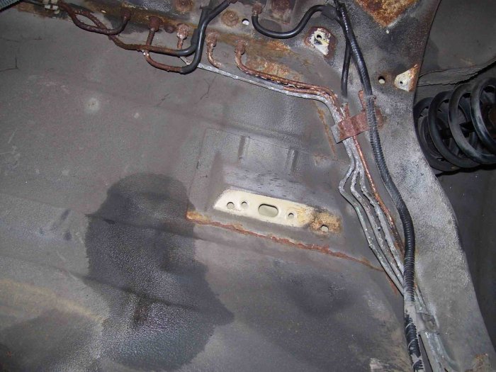

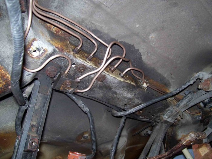

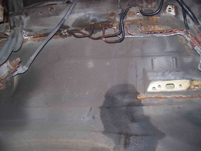

Spent the last week rebuilding the Z in the hope of a successful MOT. (I think the sunny weather went to my head) Bad idea I'm afraid.
Tester blew a major brake line during test, (fluid everywhere!!) emissions went through the roof and to top it all, 2 rear bushes had failed causing wheel movement.
Brake lines go over the back axle, so rear sub-frame out. arrrhhhhhhh.
Still, back to welding.
