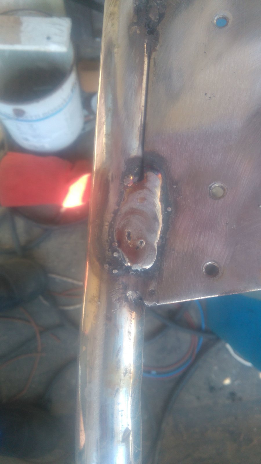

Today i ha to weld a ladder for a yacht
So i used this tecnic noboby know it '
Must use an arc welder and two rods, one in the electrod holder, and one as same of tig as filler metal.
So that is results
9/10 mm round box and 13/10 mm flat
2,5 siderotermica citoinox E316L 90A
