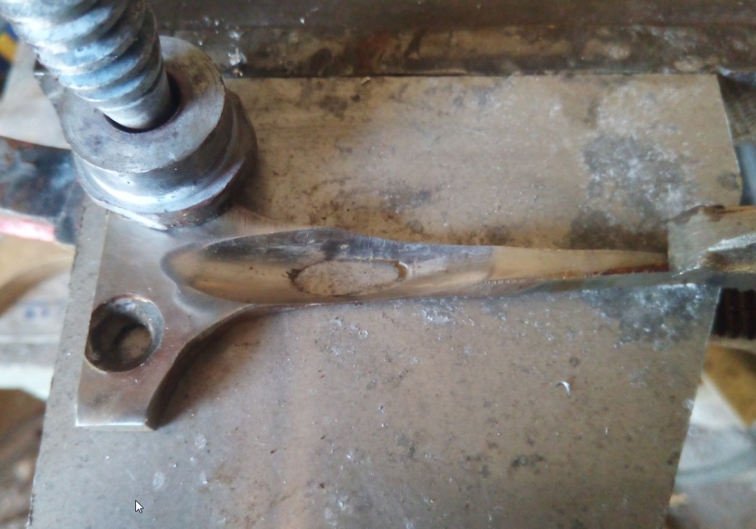

Yes isn't a structural weld, was only to prevent boring noysAnyone new looking at this its strongly not advised
This is for anyone new to welding that saw this and thinks it's a good idea
Yes i do for this reason because the base metal is 0,9 so i had to put more metal to prevent holesI think he used a tig rod as extra filler. Not uncommon, pipe welders here do it to fill faster.
So first question why?
Because i have only 2,5mm inox rods
The base metal is something like 0,9mm and I had to do by using only a buzz box, i have not a tig welder.
Gaps?
There was something like 2mm gap
I’d be chucked off too mate.Oh you'd be thrown off an oil rig for saying that. If it gets the job done, pass x-ray and UT, then its a job well done.
Yes but you have got to remember we live in world where if something was to happen you would be taken to court and sued we live in where there's a blame there's a clame now days gone by people wouldn't think but now you've got to be careful what you doOh you'd be thrown off an oil rig for saying that. If it gets the job done, pass x-ray and UT, then its a job well done.
Trust me some of the best welders in the world do this and the rigs are still standing.Yes but you have got to remember we live in world where if something was to happen you would be taken to court and sued we live in where there's a blame there's a clame now days gone by people wouldn't think but now you've got to be careful what you do
If the steel is 15mm too short they don’t ship another one out and shut down production for another week.I’d be chucked off too mate.
If it ain’t on the paper work it shouldn’t be going into a job. Passing NDT tests is one thing but traceability is another. In the event of a failure you cannot have differing welding methods undocumented all over site to get the job done. It might have nothing to do with the failure but if the paper work doesn’t match the actual method or conditions then it’s just a mess for finding root cause and will likely slow things right down.
I'm looking at it as a liability thing no doubt the best welders do it but I wouldn't chance itTrust me some of the best welders in the world do this and the rigs are still standing.
I was running procedures for Sapura Acergy in Malayasia for PLEM’s, all the frames we’re heavy rectangular hollow section, we got procedures approved for full pen single sided T-joint with maximum allowable gap of 12mm, this was possible by buttering the face of box section/plate with 3 weld layers maximum, this was put in place to save time and mistakes for fit up, although when non critical scenarios comes along applications like this “Texas Welding” can have it’s place but I would not recommend doing this especially in novice hands!If the steel is 15mm too short they don’t ship another one out and shut down production for another week.
Procedures go out of the window in the real world all the time mate. Workshop that’s different, you can cut a new piece of steel, gouge a weld out and re-do it.
There’s a reason the best welders are often offshore. It weeds out the chancers.

You can do it with minimal issues if you’re a good welder, don’t let the inspector see you do it though!
You need to go way, way over the normal amperage for the size rod you’re using.
Useful when the fitter has left you a massive gap.
Can’t say I’ve ever heard of doing it on stainless though to be honest.
To me the weld doesn't look that bad but neither does it look too great.
The question though is why was it done that way?
There doesn't appear to be a huge gap that required filling up so I can see no reason not to just weld in the normal manner with a single electrode.
I often have to do repair jobs on boats where there can be a gap, with no way of physically pulling it back together, and personally I prefer just to run beads down either side until the gap is small enough to bridge, then again I am no expert being self taught so.....
