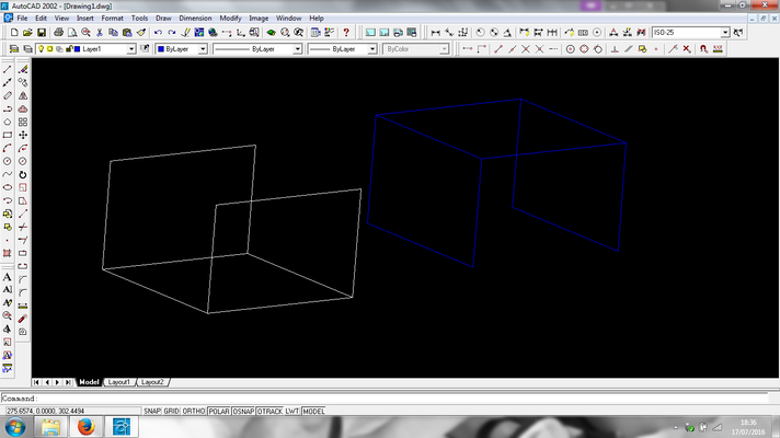

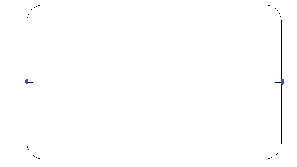

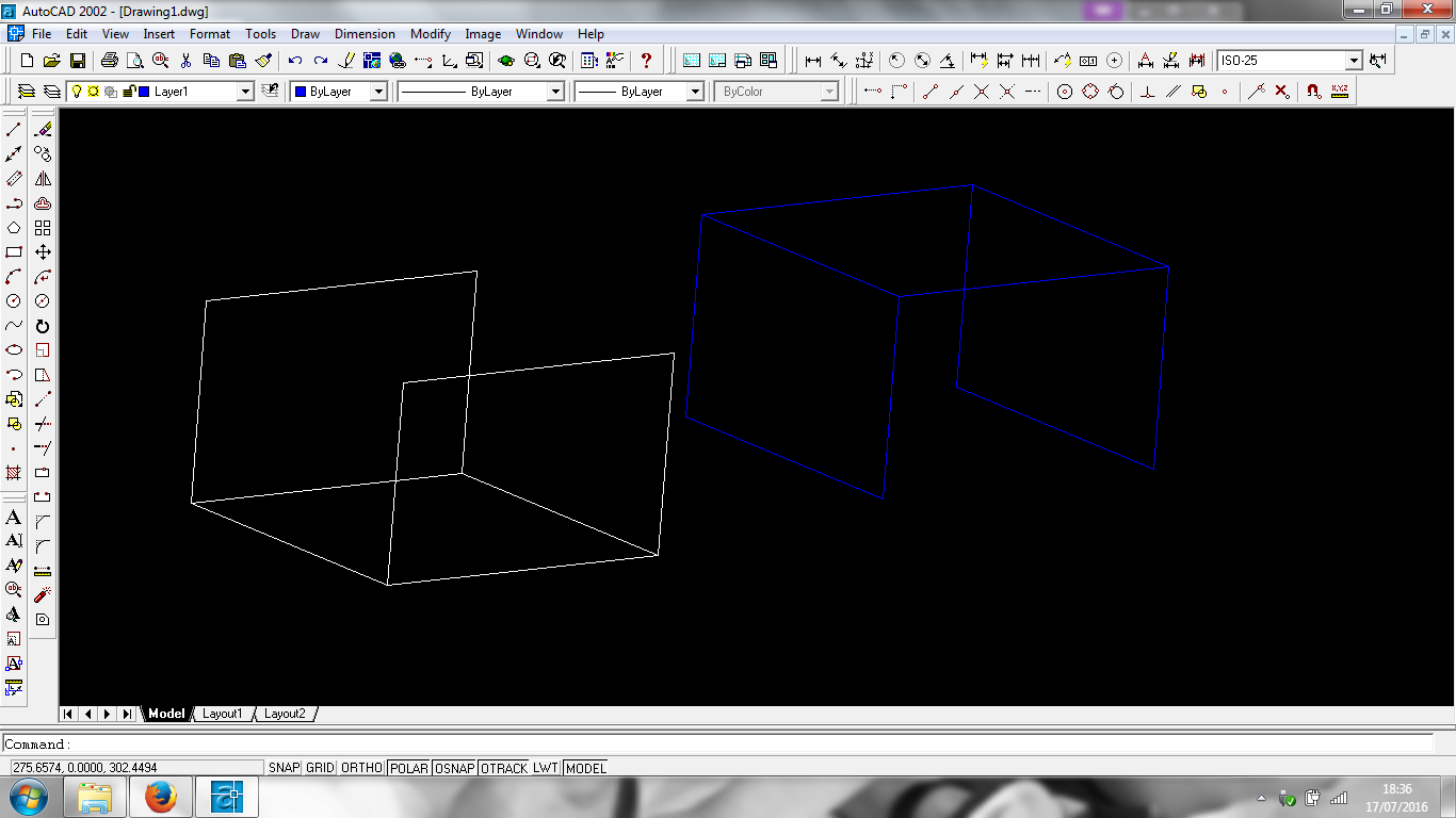

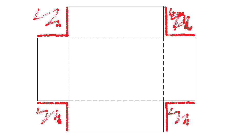

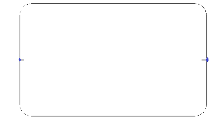

As useful as box and pan folders are there are simpler, faster and less wasteful ways to fold tanks. The open box + a lid method...
takes longer to layout and longer to cut out than folding two [ shapes like
More importantly it's easier to make sure you're folding against the grain without wasting even more material...
The 2 interlocking Cs (or one of them and a top hat shape to include mounting tabs) work well for small stuff but for larger tanks i'd rather use flanged joints to add stiffness and simplify assembly for example...
Bit more welding but that's the easy/fast bit of a fuel tank anyway. Radiused bends are better than sharp corners from a fatigue POV and while they make life easier/faster you don't even need to make/buy a folder for smallish tanks... just solid table, a bit of tube welded to some box or angle and some clamps to hold everything down while you bend the sheet round it by hand
