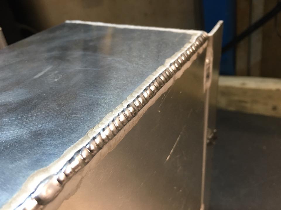

Turn up the current abit more Giz. Those outside corners look very cold. The weld shouldn't peak on top of the corner it should be the corner. Nicely blended in radius.So word has got around that i now do TIG welding. I was contacted today by a Local fabrication firm....Asked me to weld this tank together...
Went really well....Just over 2 hours start to finish (That seem OK time wise?) Customer supplied the ally already bent. Fit was about 80%...Some big gaps to cope with as a result (2-3mm) But it went all right.

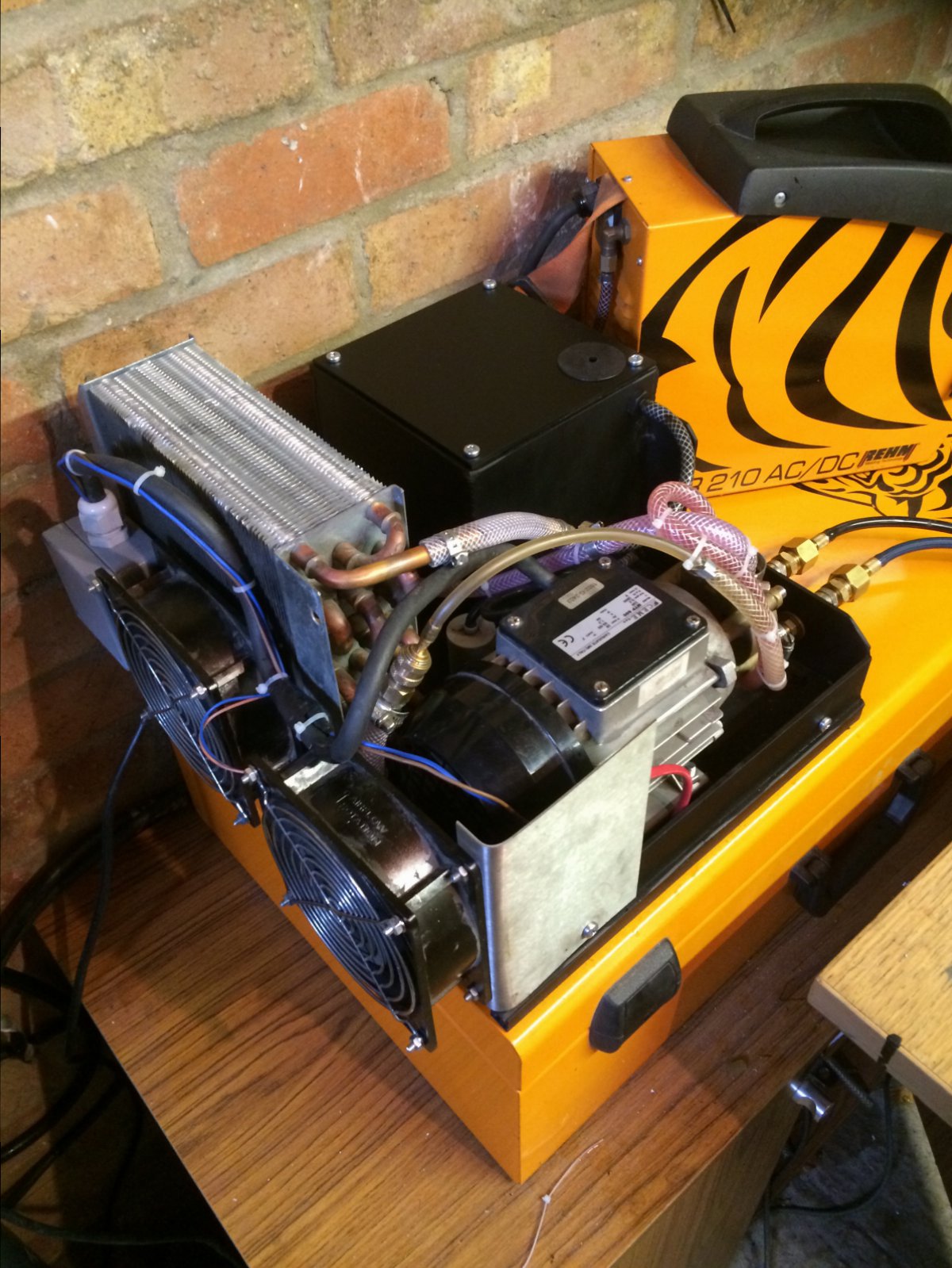

However, towards the end the Tungsten started to split and spit into the weld pool....The torch was unbareably Hot....I Really need to invest in a cooler i think. But i can't really afford one, and ive got too much work booked in to stop whilst i get one sorted
You have done a good job no question but refining and going forward I'd say pick up your current and there isn't a need for all those start stop points. A long run like that you could do easy in one hit. Use all the filler rod learn some feed techniques.

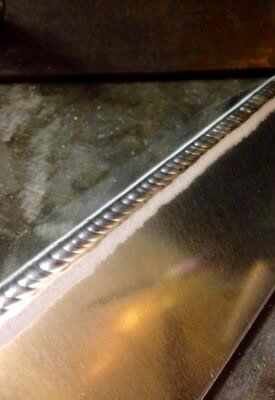

You can see what I mean below. Yours looks colder and peaky not blended as well. Too many stop starts.
Whats the tank used for? and do you pressure test for leaks ? nice job though
Your doing enough work to justify investment. Buy yourself a new kit with cooler and pedal. Speak with @Tom Orrow L about interest free finance. He has some great stuff and you can tailor the payment to suit you. He isn't allowed to advertise or push sales but I've dealt with him and there is no rule stopping me recommending his company. Your quite dependent on your welder now and it's only a cheap starter set. Speak with Tom he will help you out no end, he has for me on numerous occasions.Guilty....The stops starts were due to the torch getting too hot to hold. hence my need for a cooler I think.
1300 Stock Car. I did a leak test, and no leaks to be found![]()
