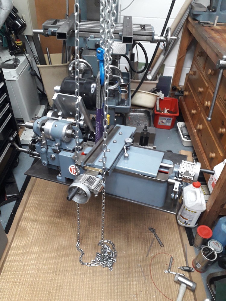

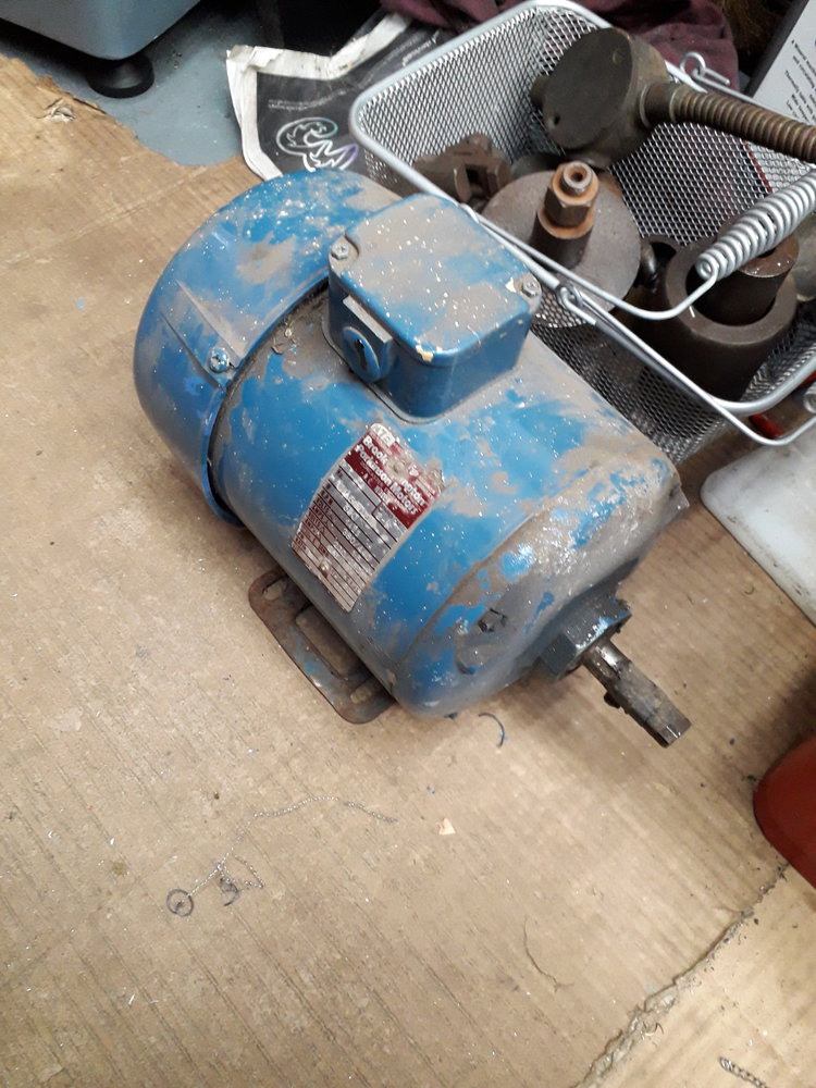

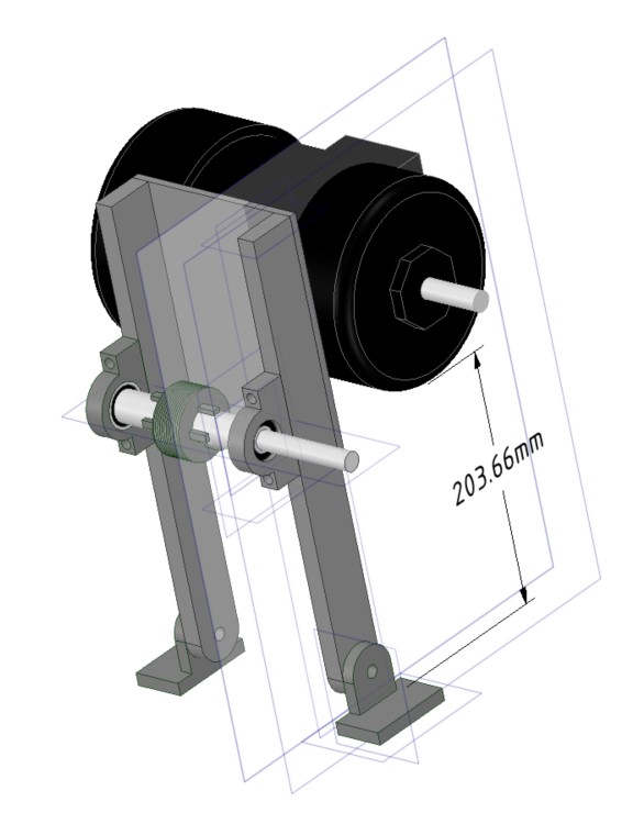

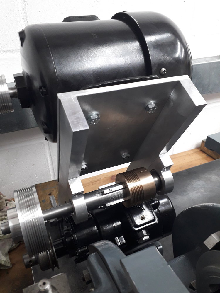

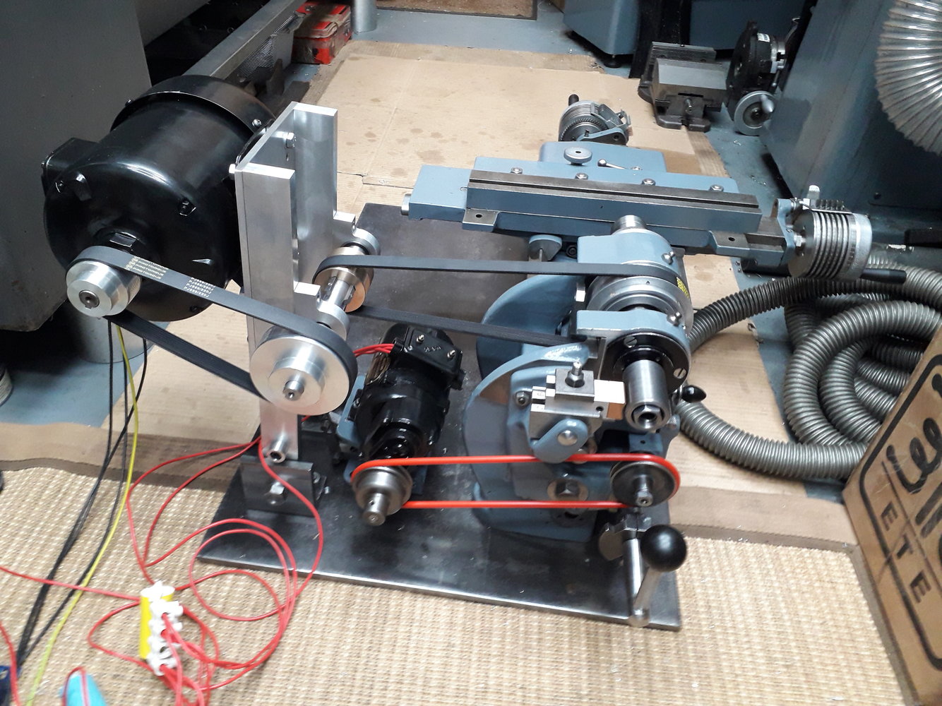

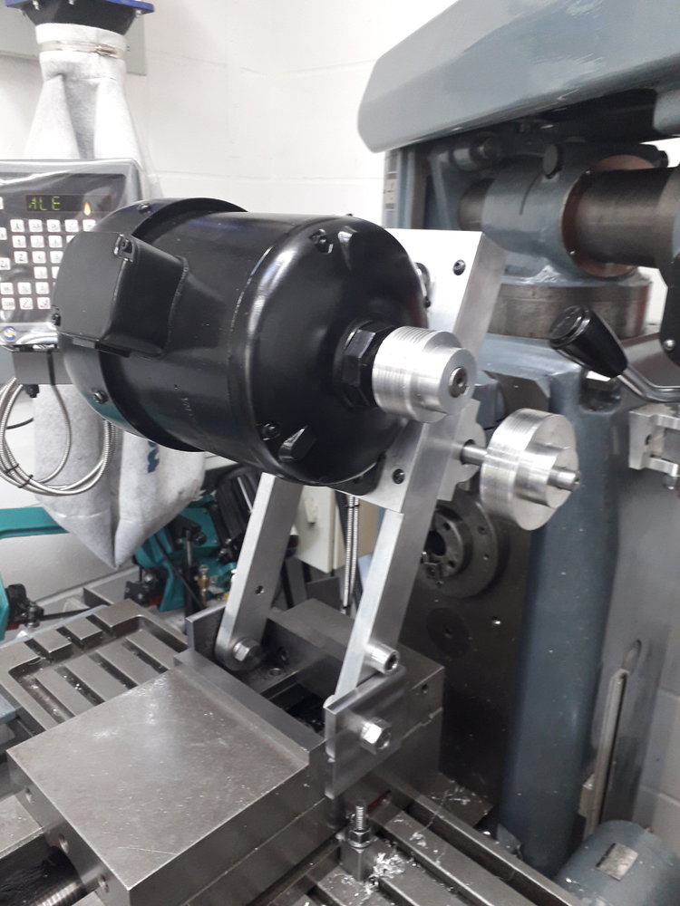

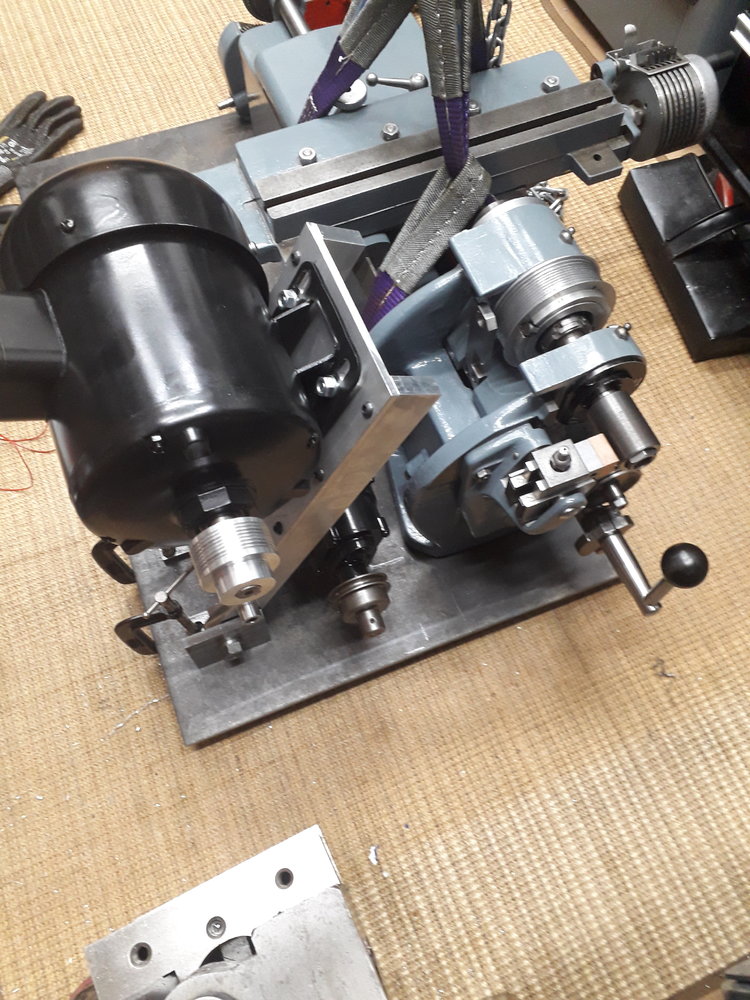

I was thinking in terms of a couple of lengths of 25x50mm box section, which will fit where the bits of wood are at the mo under the lathe, then a piece of 10mm plate behind the lathe, prob 8" x 30", to carry all the motors (3 incl the carriage feed!) and an idler shaft for the spindle. It originally would have sat on a cabinet (long since gone) which I don't have room for (or money for - people ask crazy prices for such things!)@RobCox whats the material you require for motor mount ? and maybe worth putting up a wanted add for a suitable motor..most of us on here have loads of under the bench stuff![]()
Good idea about the wanted ad, I'll sort it tomorrow.

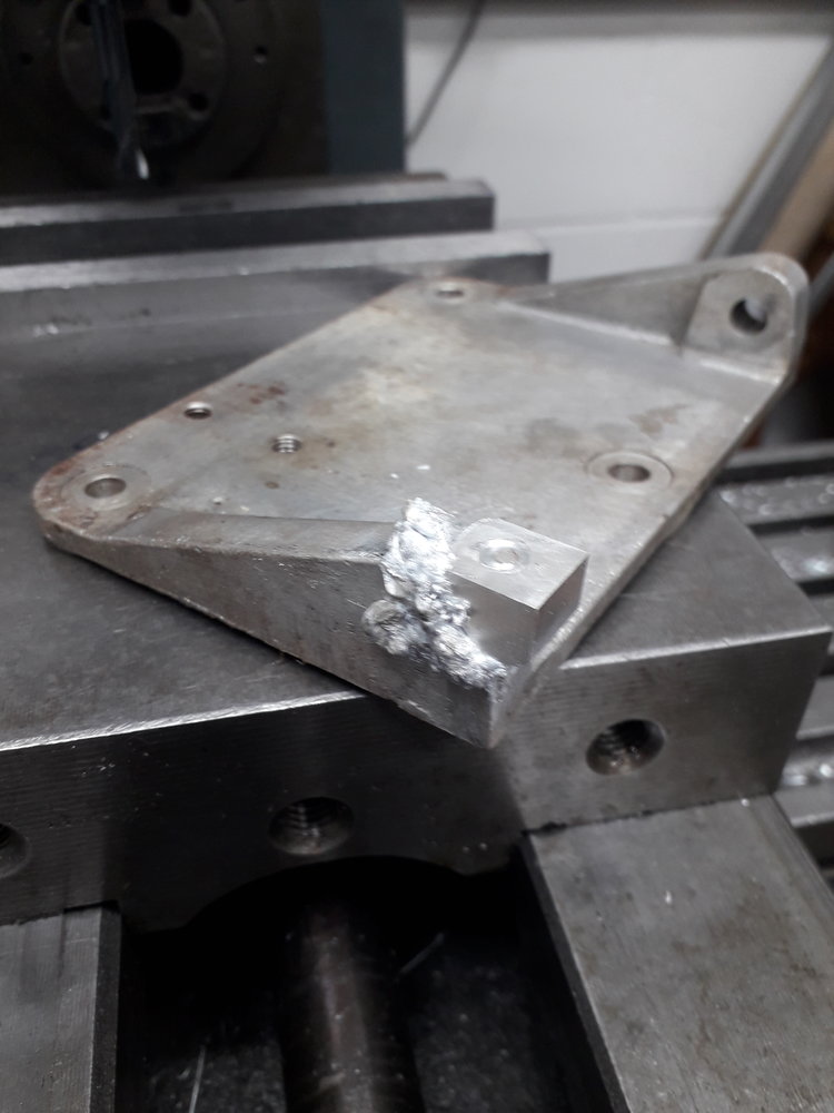

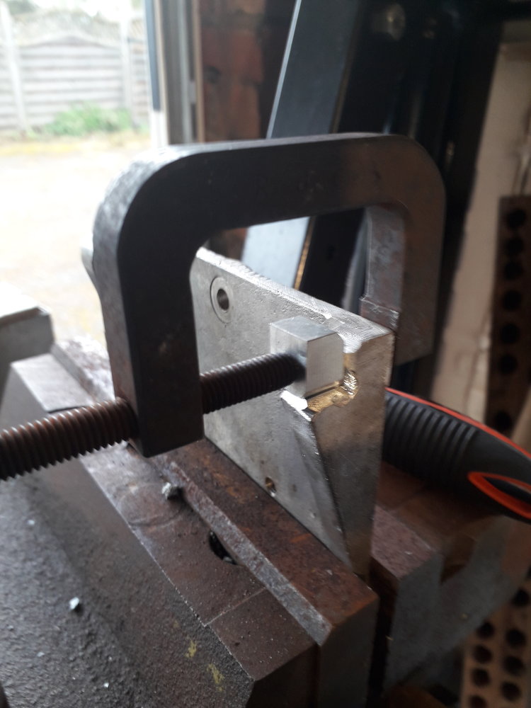

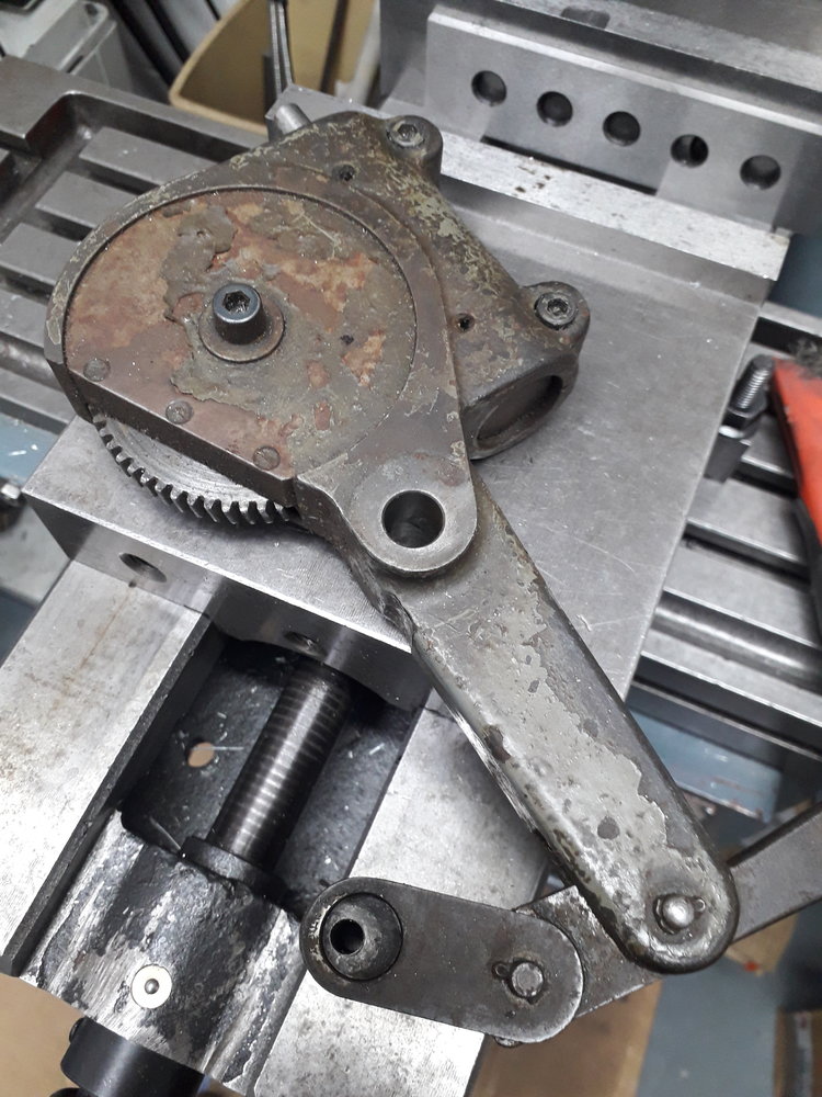

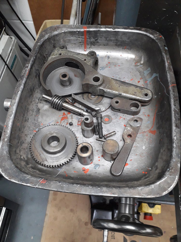

, one of the lugs holding the rod cracked. Turns out there WAS a grubscrew after all and like a muppet I'd missed it under the dirt - it was at 90 degrees to the other hole which had evidence of threads, so had been redrilled and tapped and the tiniest grubscrew fitted.
