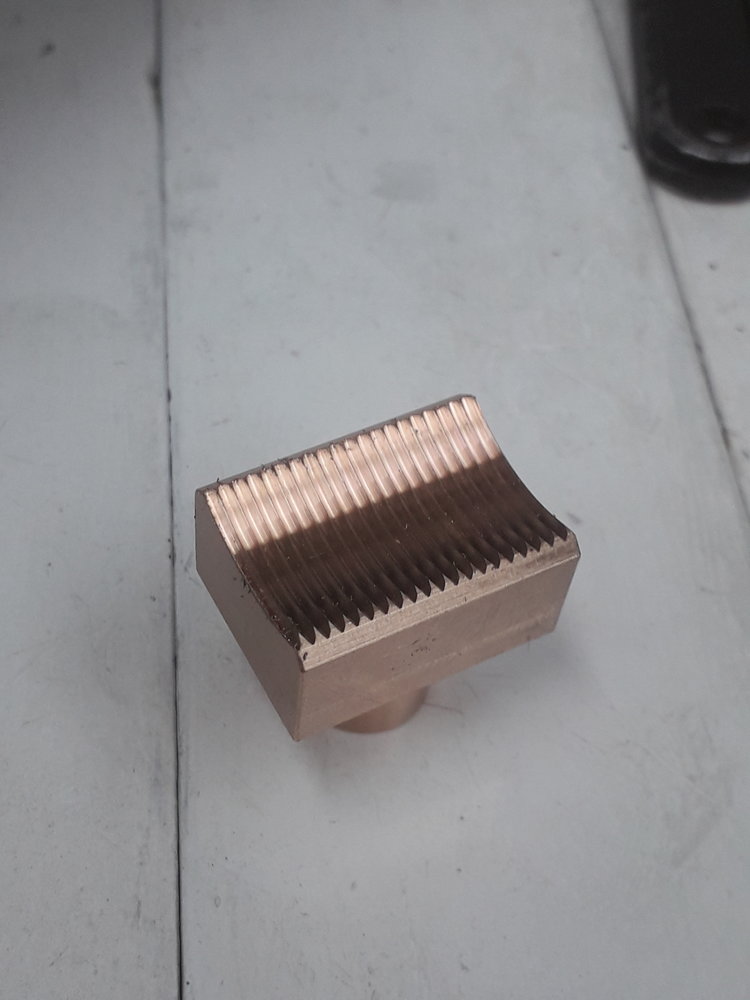

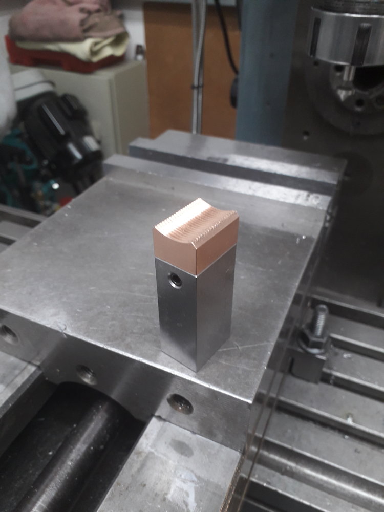

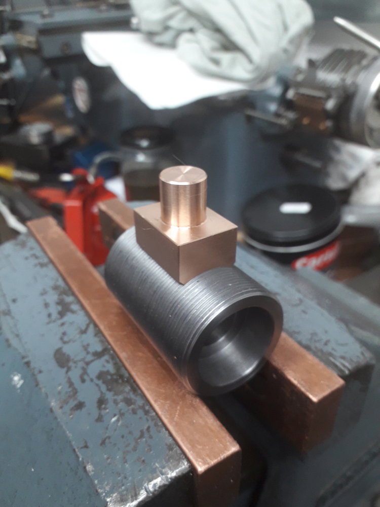

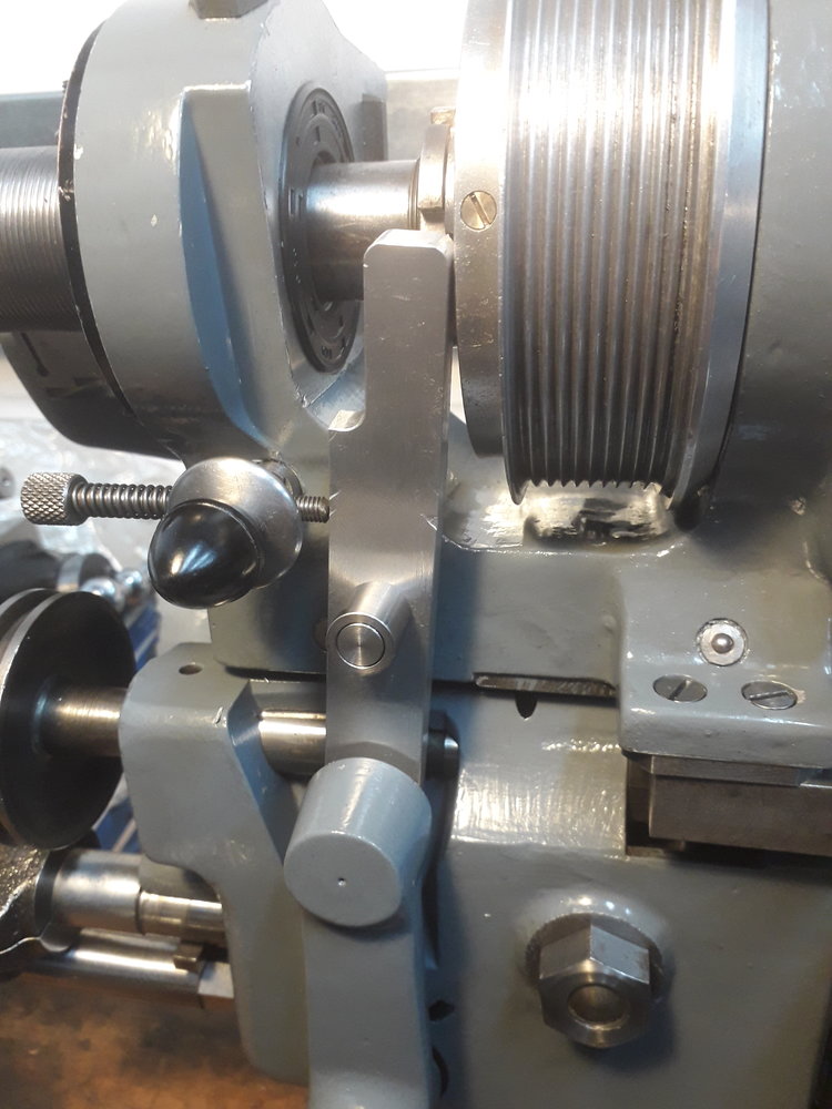

I finished up the hob follower yesterday. This is the part that sits on the platform behind the hob and engages with it to move the headstock to the left. I had it in mind to make this out of a solid piece of bronze, until I found out how much that would cost x how many thread pitches do you want. I found an image of a hob follower on the web and figured I'd copy that design.

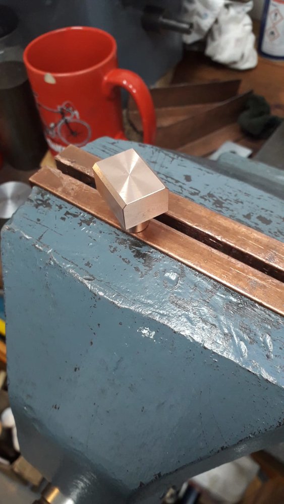

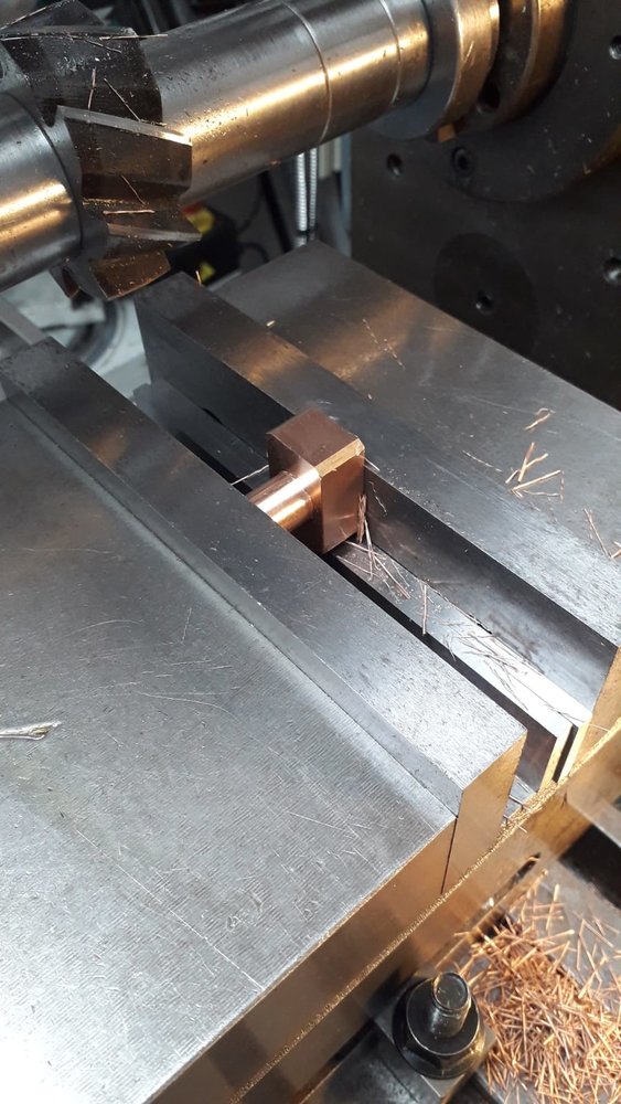

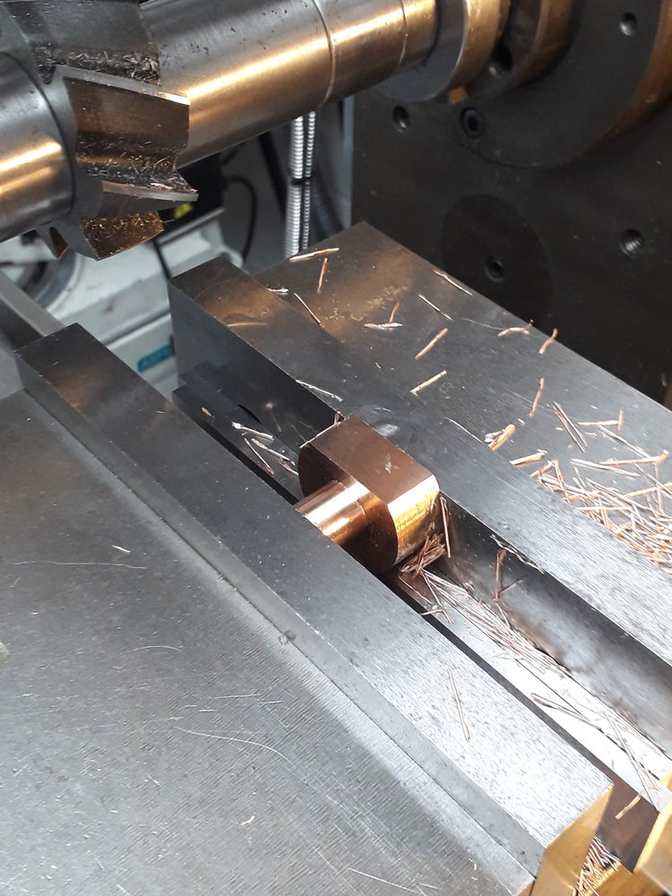

I started with a piece of PB1 bronze I had left over from another repair. This was the perfect size, 1 1/4" dia. I turned a 1/2" long, 1/2" diameter spigot on the end, parted it off, reversed it in a collet chuck and faced it flat, then over to the mill to cut the large end to a rectangle:
The finished size of the rectangular end was 0.75 x 1.00 inches, which fits perfectly in a 1.25 inch bar (think of a pythagorean 3-4-5 triangle). Add a couple of 45 degree bevels and this is the follower blank awaiting the threading setup:

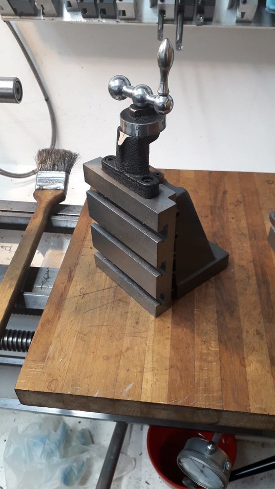

This part now needed some female threads cut on it. I had the choice of making a fixture, holding it in the 4-jaw and offsetting it the right amount and conventionally single pointing an internal thread, but in the end decided to hold the blank on the compound and rotate the tool in a boring bar. To hold in on the compound, I got out my very first milling machine:
I originally bought this to do some milling on my minilathe in the days before I got a mill. It was so successful that I got a mill soon after. The general lack of rigidity in the whole machine made the whole exercise a waste of time, so this slide has sat on the bench for years unused. I almost sold it at one point but the buyer pulled out, by which point I'd already regretted trying to sell it and figured it'd come in useful one day.
Bit of modification required to mount it on the compound of the M300. The post that secures the QCTP is threaded M12, so I drilled the milling slide 12mm and machined a bolt to length:
Refitting the tool post is much more faff, as the compound slide has to come off to get at the locking grubscrew underneath.

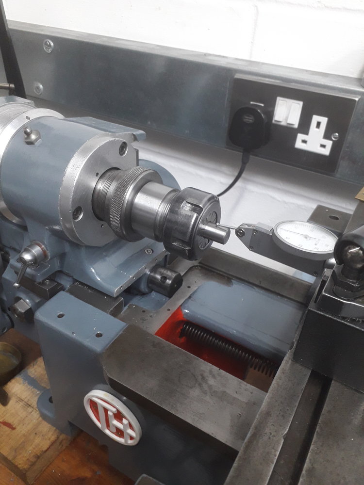

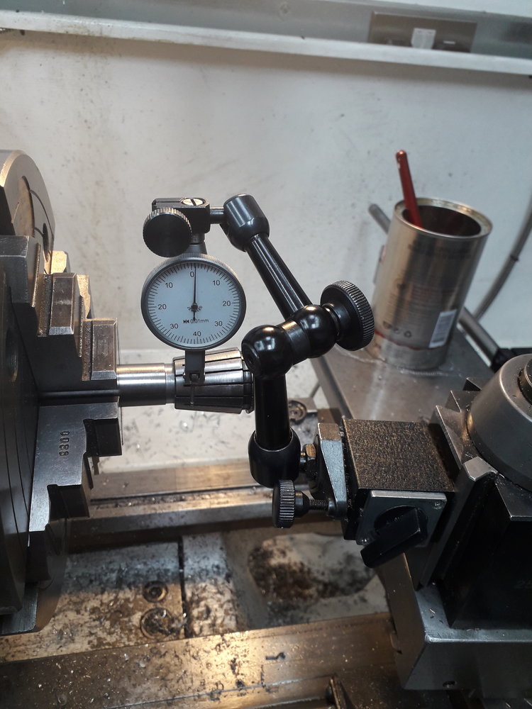

I've got a nice little vice to go with this which I've abused (holding parts while I braze them) and repaired (new screw and nut after the original brass nut fractured). Here's the setup with a DTI used to check that its aligned to the lathe axis:

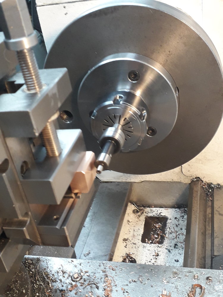

The compound is set at 30 degrees here, but I turned it parallel to the lathe axis - after I'd set it up the first time - as there wasn't enough cross slide travel. First machining op was to put the inside radius on the face. So first, measure where the face sits in relation to the spindle centre using an edge finder:

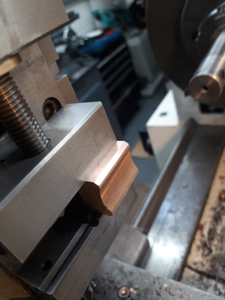

Move it out to the correct radius and use that distance to set the boring bar swing up, then machine away. The height of the milling slide was fine tuned during this machining op to get the workpiece centre bang on centre height:

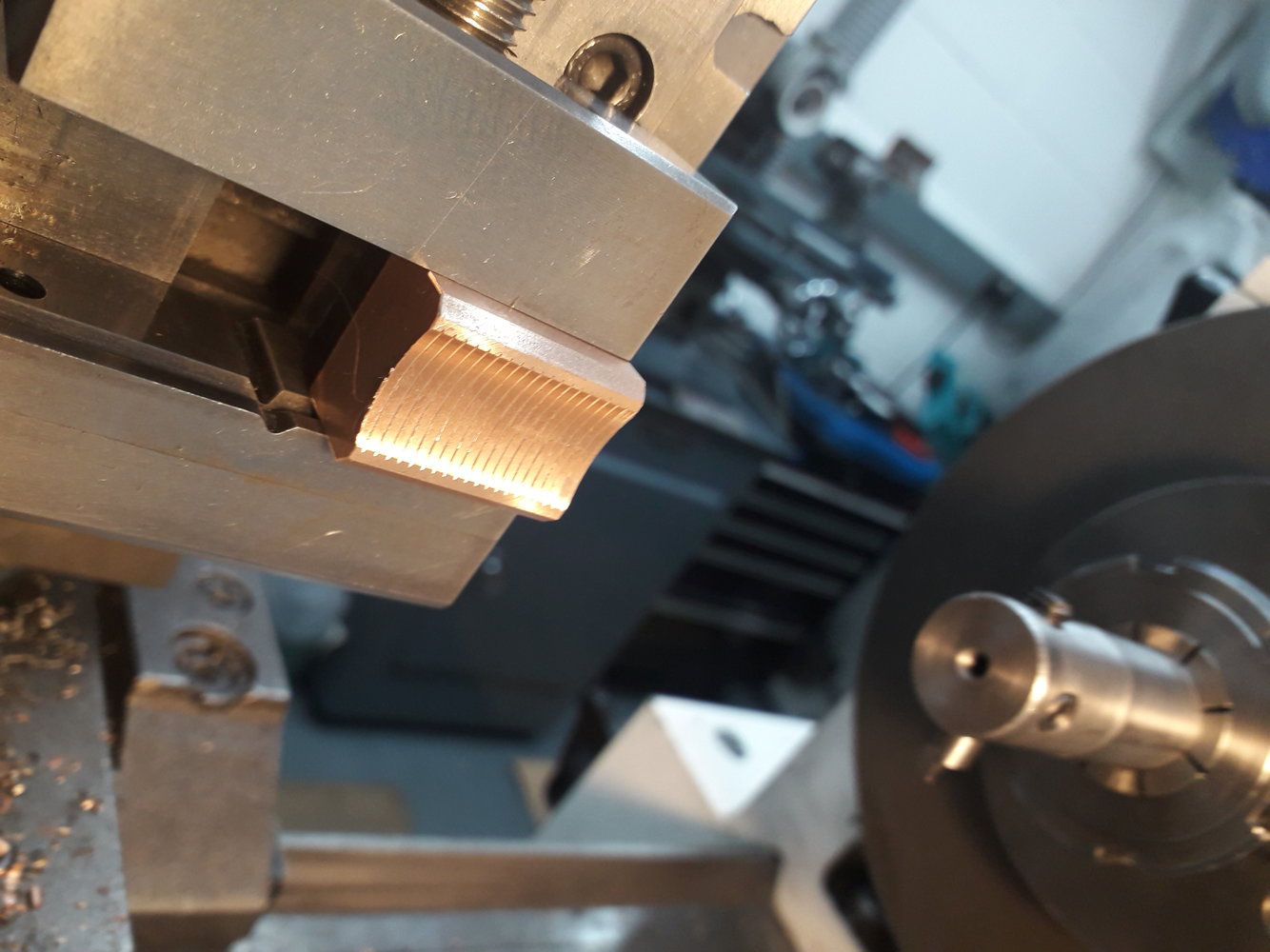

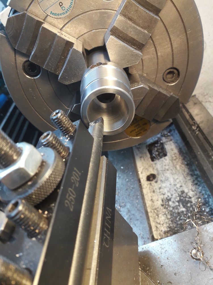

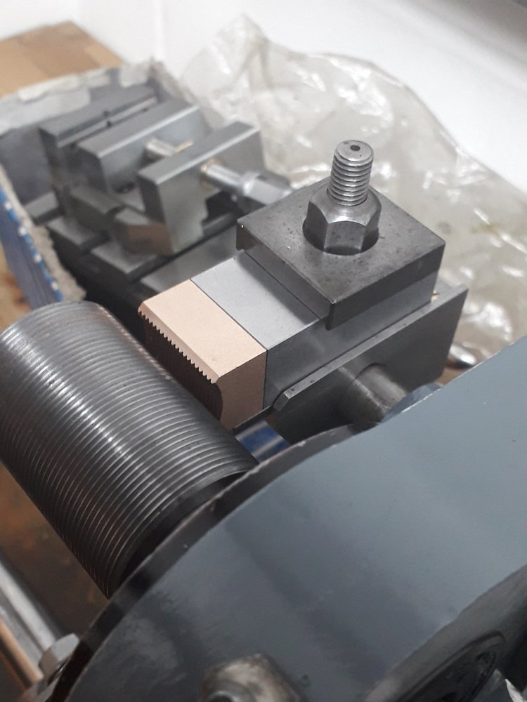

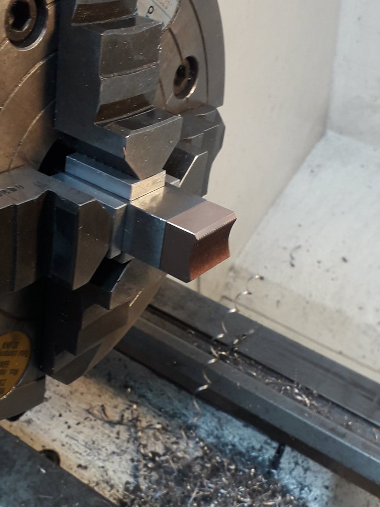

I then ground a 60deg threading toolblt of the right length to fit in the boring bar, used an edge finder to reset the new position of the centre of the blank, then the threading is done as normal, except the tool is rotating and the workpiece feeds along the bed:
This is the threading tool, set to the root radius of the finished threads:
