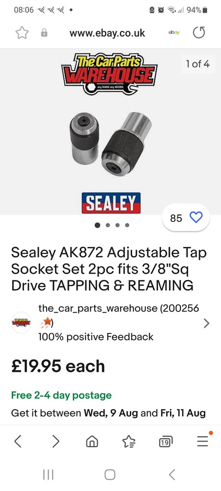

I use these and a sliding 'T' bar (plus extension if required) for hand tapping, great for restricted access which most of my jobs are.
Sounds like something i need to try on some scrap…. And probably with an old tap or 2!
