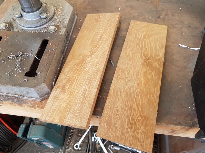

I got one of these
https://www.screwfix.com/p/erbauer-tct-circular-saw-blade-40t-254-x-30mm/22702
and one of these
https://www.screwfix.com/p/titan-tct-circular-saw-blade-16t-180-x-16-20-30mm/93193
as the price is the same, well near enough as a spacer itself and i got three with it. Blade is no good unless it fits the Evo rage circular saw i have.
This was done with two cuts as the timber is 110mm and the max cut depth on this is 65mm.
That was all done with the 1/2hp motor, as said it had to be fed a bit slower than you would normally feed it.
I have removed the 3hp 2800rpm motor off the compressor as i would rather have the extra power for it. Just need to sort a new pulley now as the original pulley is 5/8 and the new 3hp pulley is 19mm.
