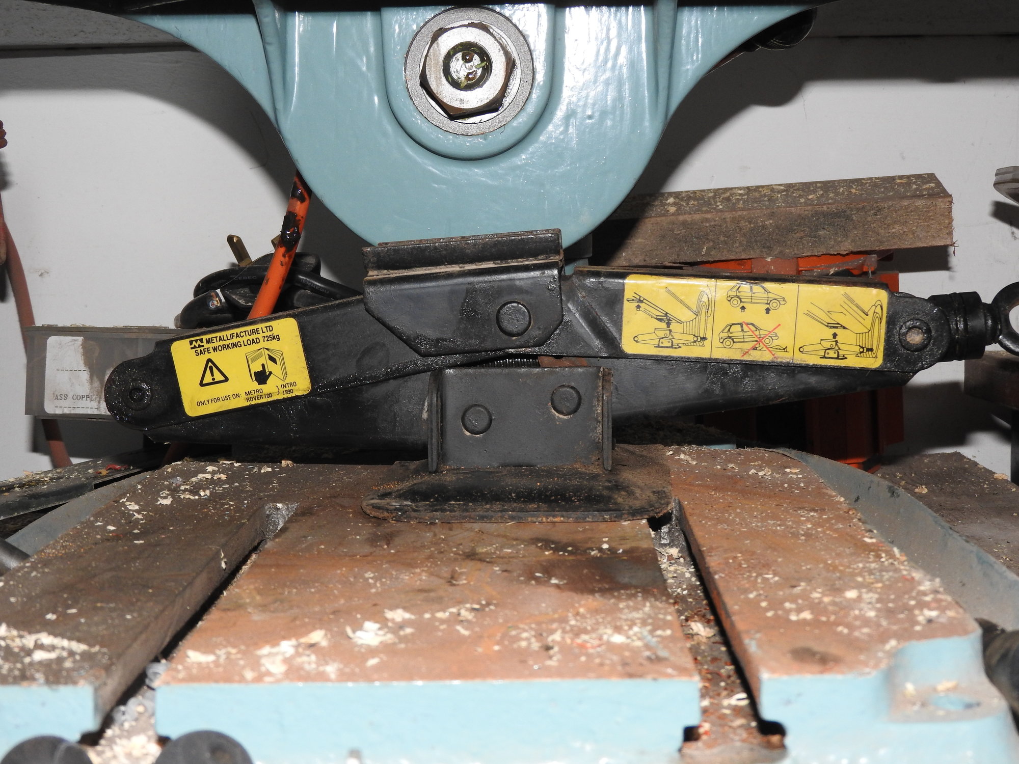

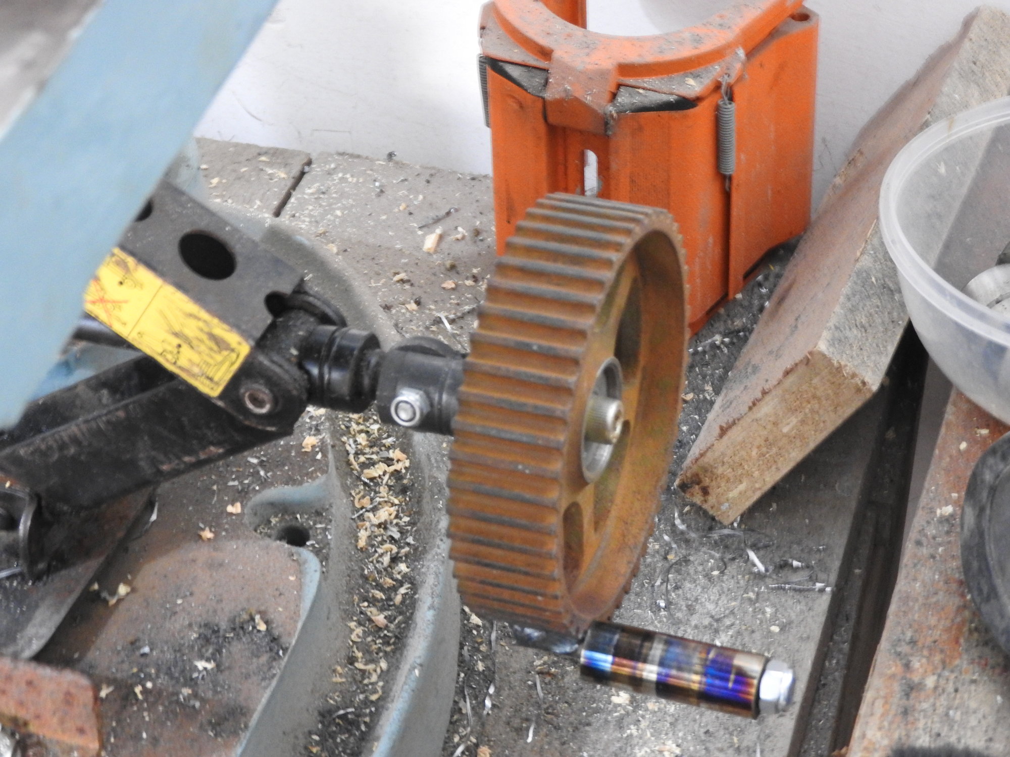

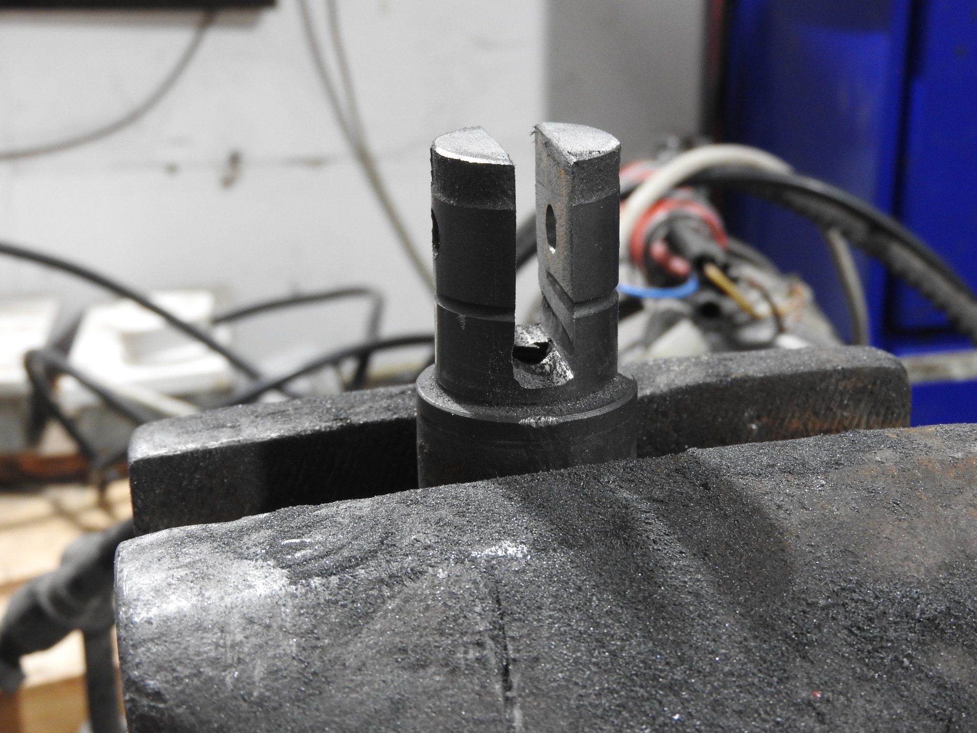

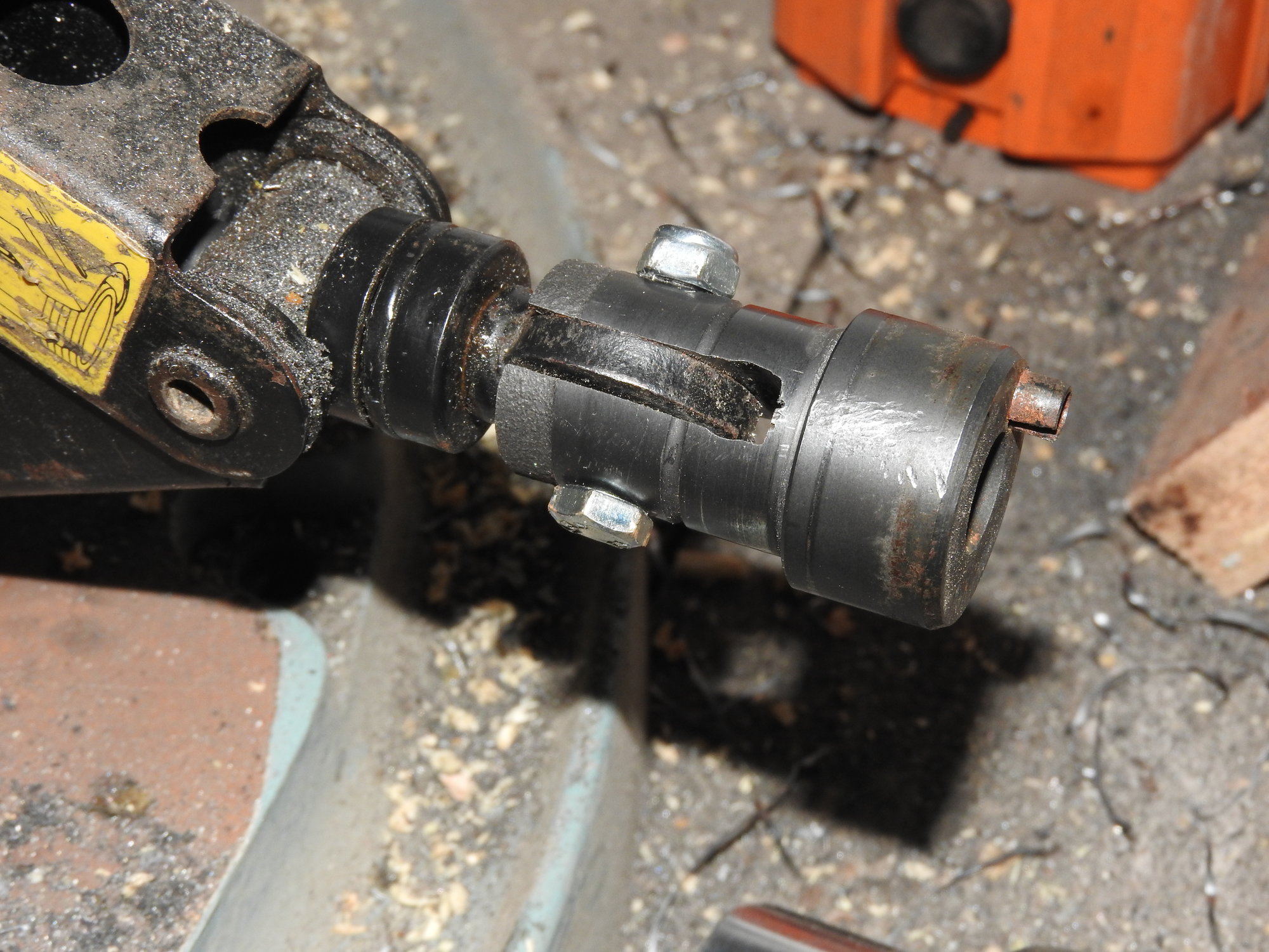

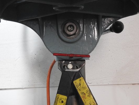

the thing this drill could do with is a means of lifting the table, and this is what I came up with.
I had a scissor jack from a Rover 100 so decided to use this as the means of lifting the table

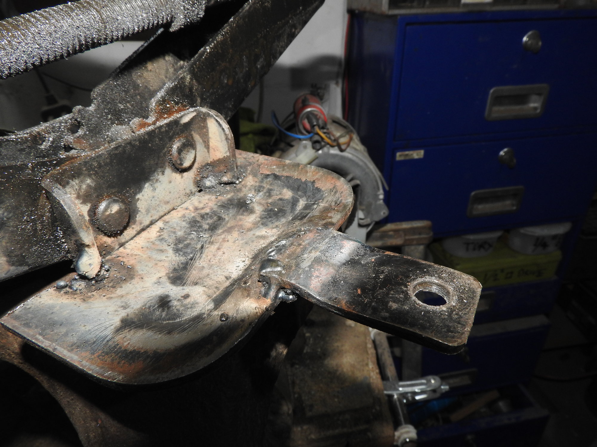

Unfortunately it wouldn't fit under the table mounting, and close to the pillar was found to be the best place to lift. At the same time the jack wouldn't fit far enough back for the lifting pad to fit underneath the mounting boss.

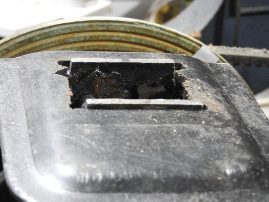

So I cut the rear part of the jack bottom plate off to get nearer the pillar and inverted the plate to lower the jack slightly. The protruding bits were filed flat and the hole squared off and tidied up prior to welding.

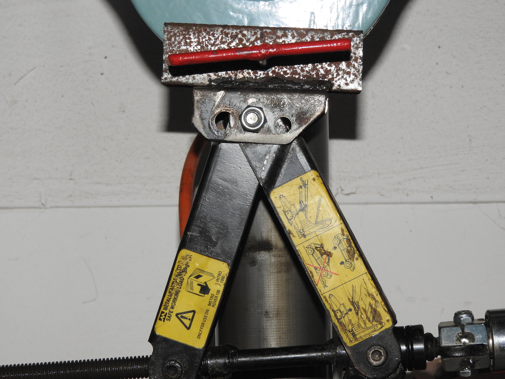

The lifting pad on the jack was removed at the same time. The piece under the lifting pad is pivoted off-centre, this was repositioned so it pivoted about the centre.
It still has a tendency to tilt and cause the table to swing to one side. A piece of angle iron with a hole drilled in it for the red locating pin to pass through fixed that one.
