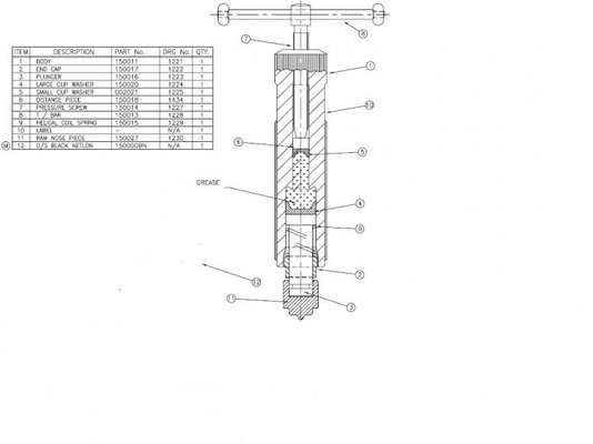

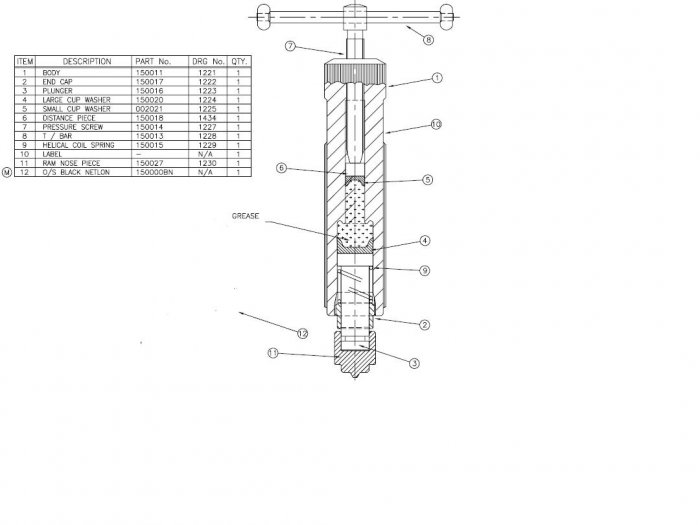

I have a Sykes Pickavant series 1500 hydraulic ram that is not working very well.
Does anyone on here know how to dismantle these so I can check out its internals?
I know I can buy a seal set with instructions but would like to take it apart before I buy the parts to see if its worth repairing.
