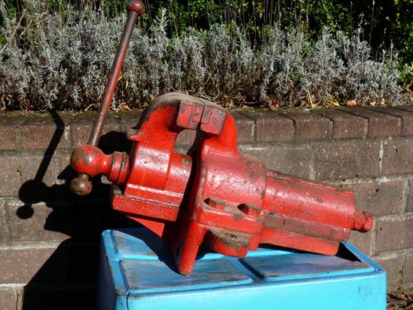

So much for me not having a fiddle with this vice until I'd got other stuff done. An obligatory mug size comparison. It's a 4" vice. Pipe jaws are approx. 2-1/2" wide.

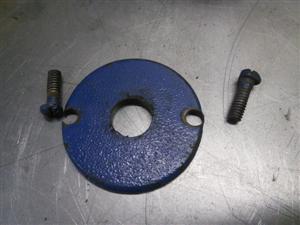

The cylinder parts stripped down.

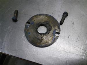

The base/body after derusting.

It looks in pretty good condition for its age I'm guessing.
