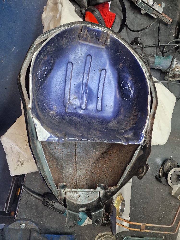

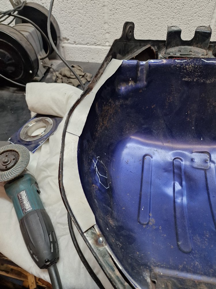

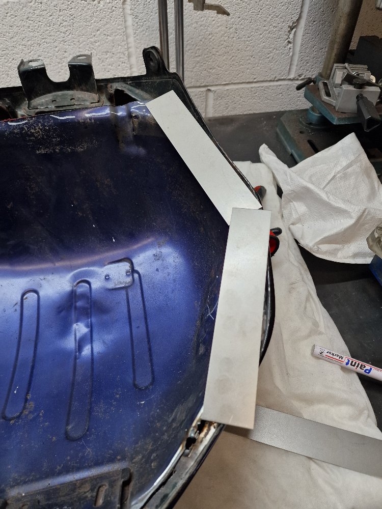

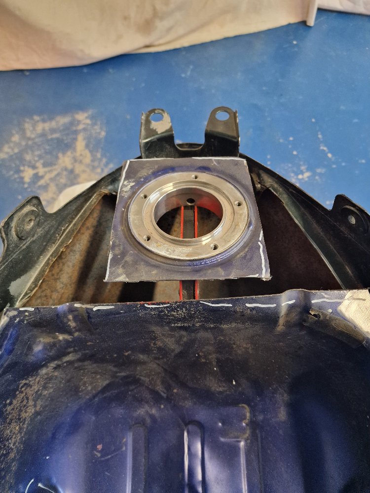

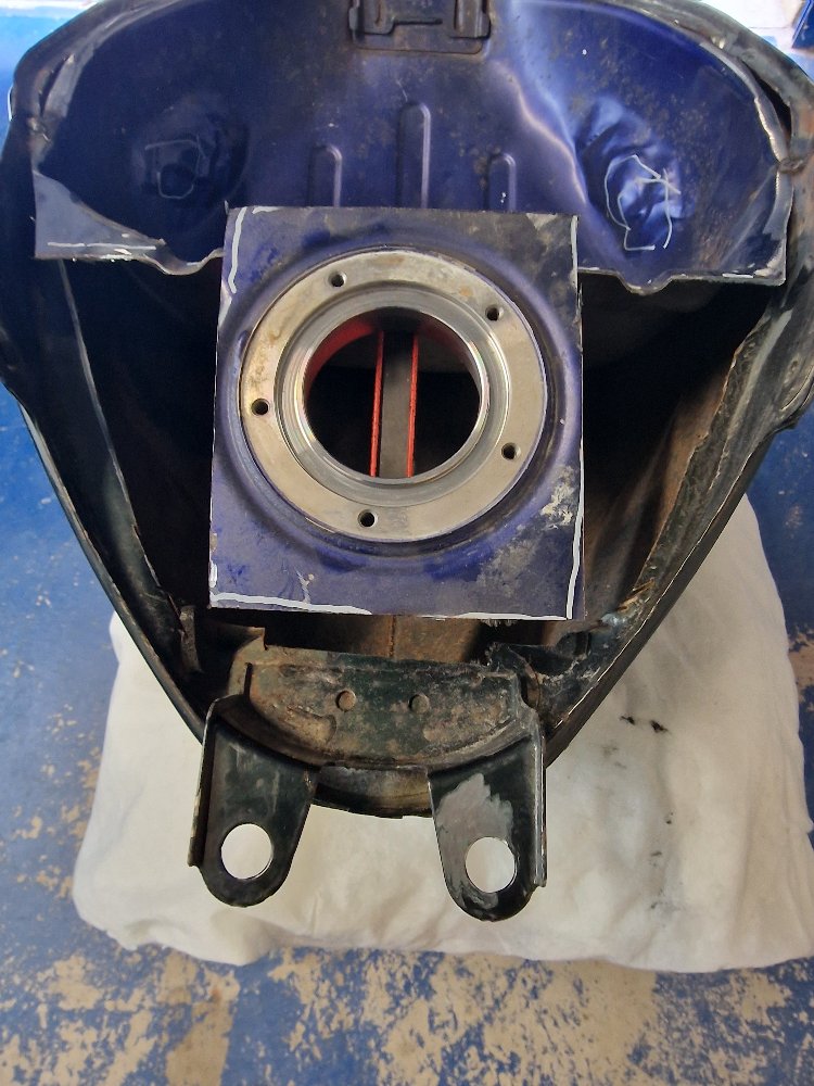

That's it, and I think I was overcomplicating what I had to do by treating the GSXR base as a single piece. By cutting the back 1/3 or so off the base I can set the front section for the airbox and then either reuse the rear section. Or I can cut the pump mount out and make a new well to take the mount.Do you have a flat section at the rear bottom of the RF tank?
Cancel this I see you have the air box to take into account as well.
The second option is better as I have a lot of room below that on the RF now that the carbs and airbox aren't there. Plus it'll give me some additional tank capacity which will be handy.
