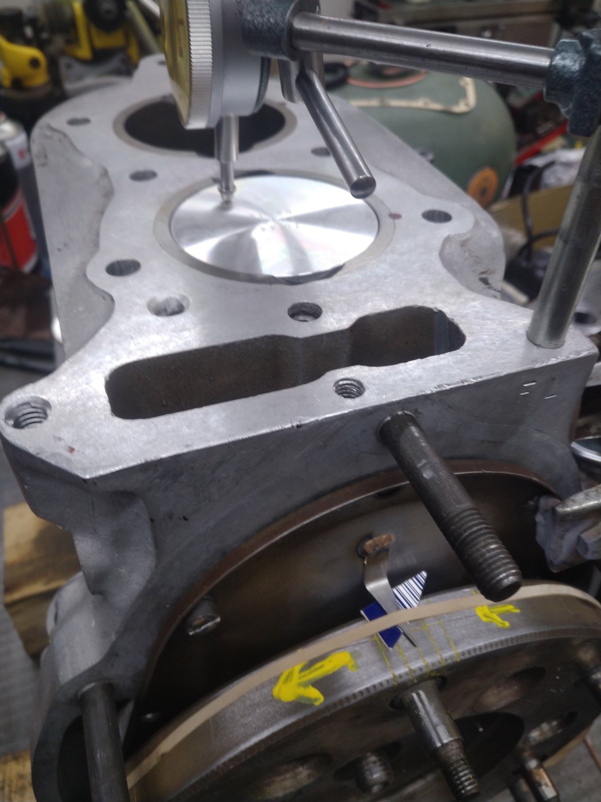

Hermes have collected the Kickstarter Quadrant, so with any luck you'll get it in a day or two.
, I was waiting to open it on the 25th
. Andrew thank you so much. I look forward to receiving it.Cheers.
Cat out of bag, I was waiting to open it on the 25th
Sooooo, awemawson has very kindly donated the quadrant thats been rattlin around his desk for the last 50yrs has finally found a home. Andrew thank you so much. I look forward to receiving it.

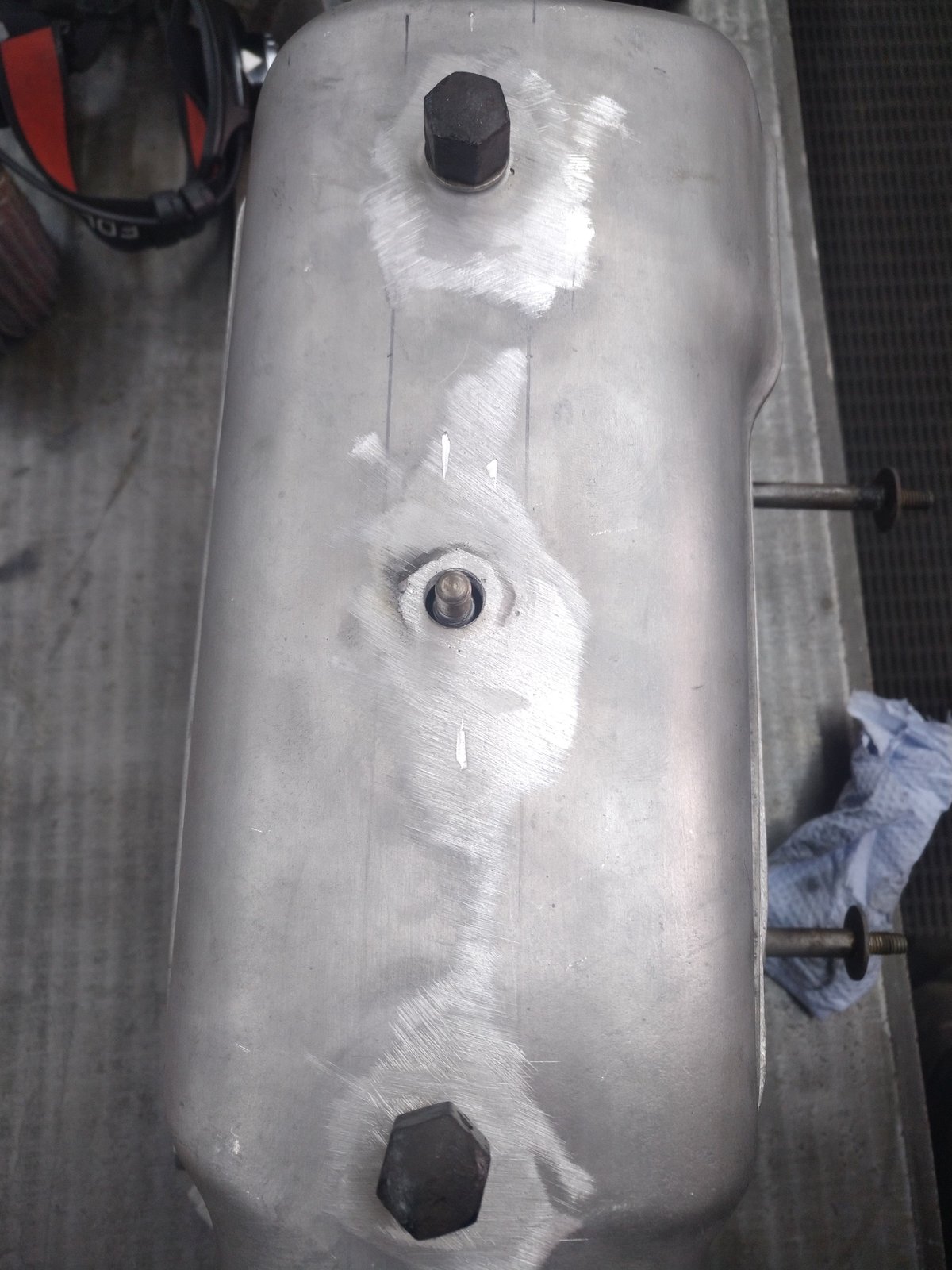

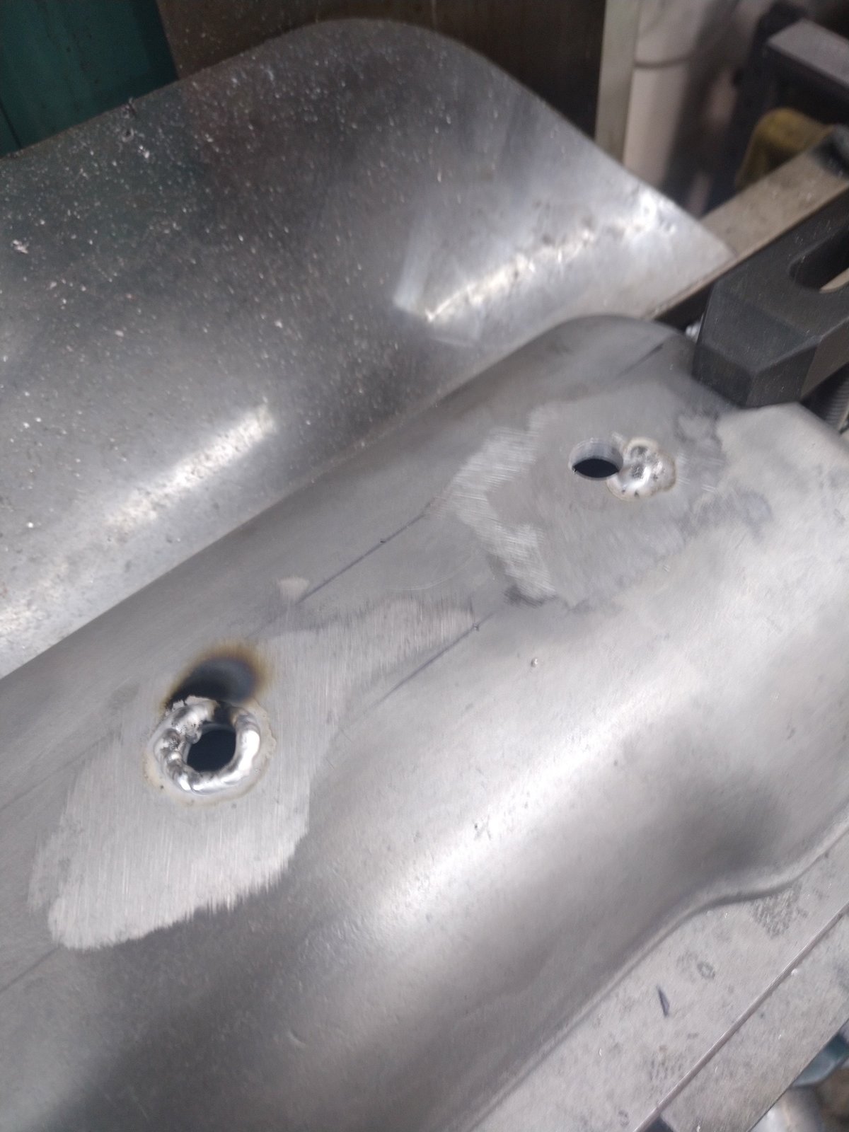

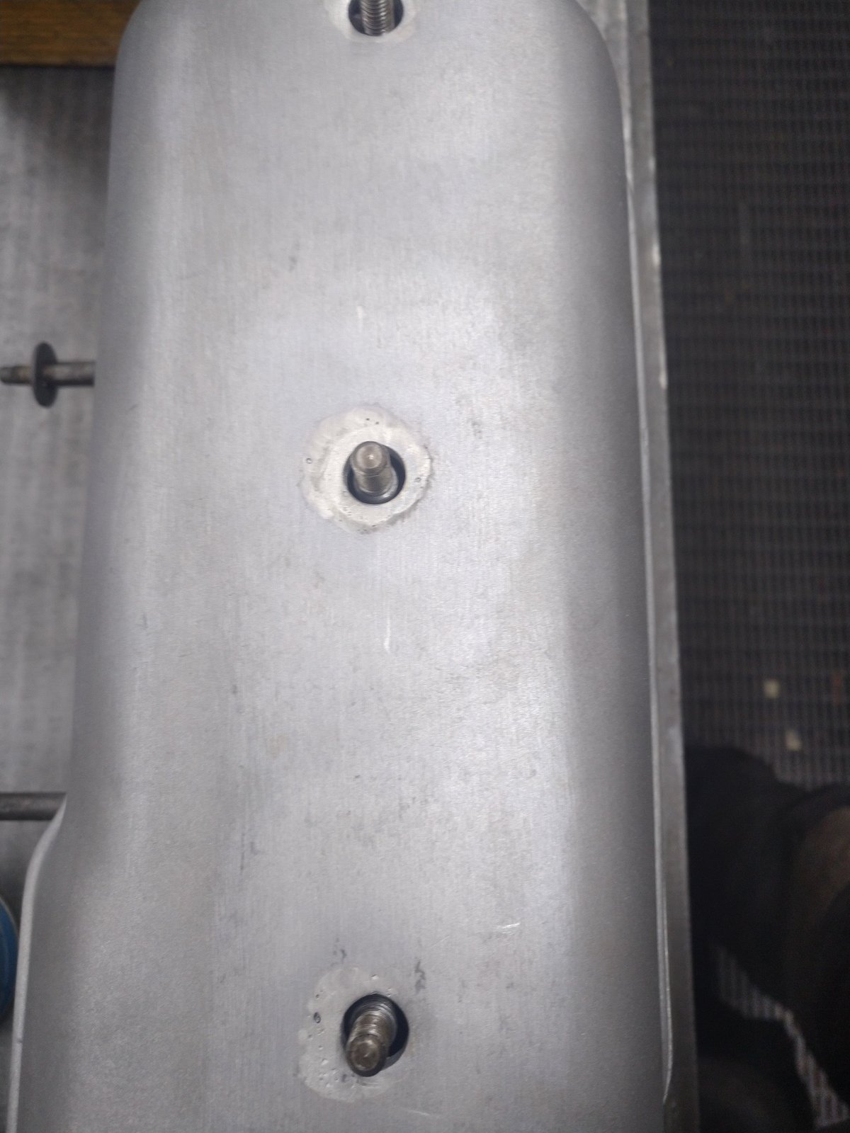

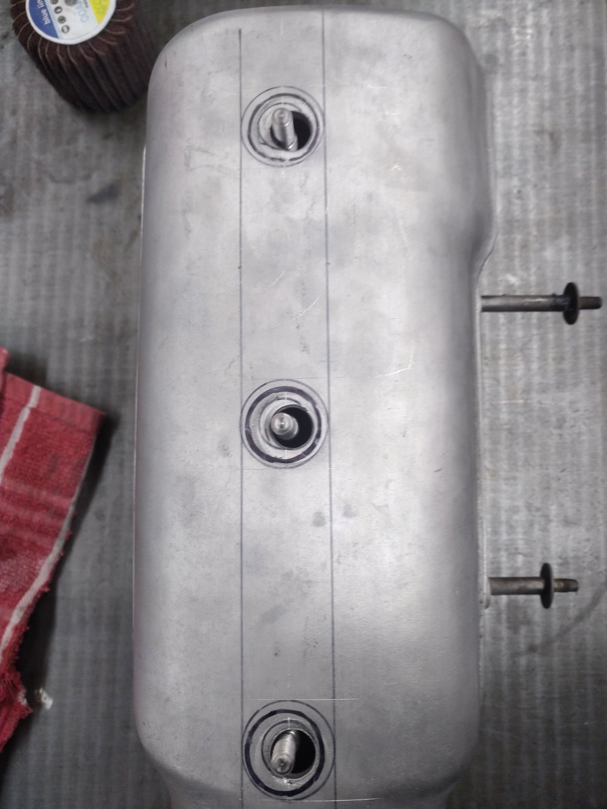

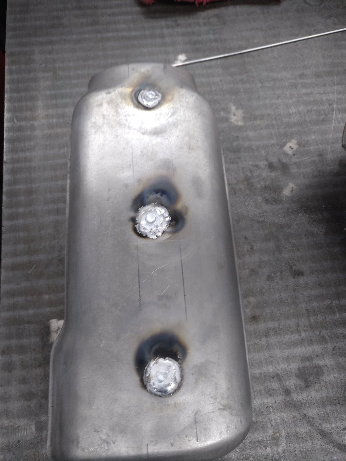

...I had to butter the middle hole after I took too much off, the other had porosity I knew about. Rewelded while still on the mill. Making sure I was earthed directly to the part.

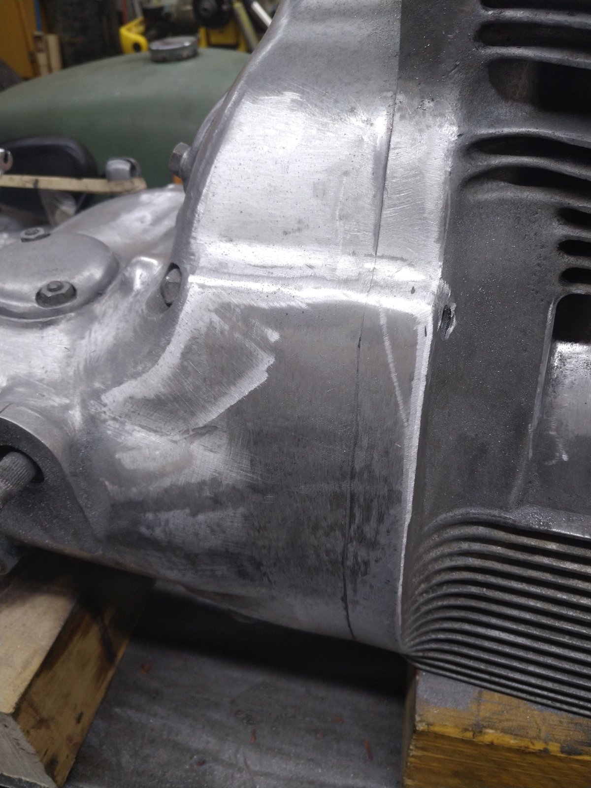

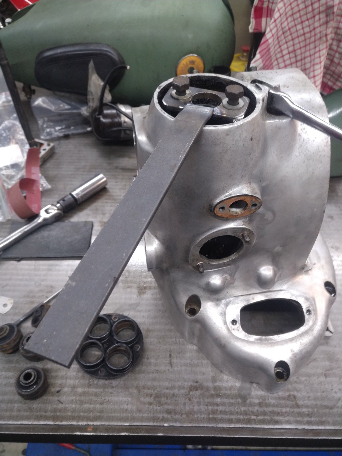

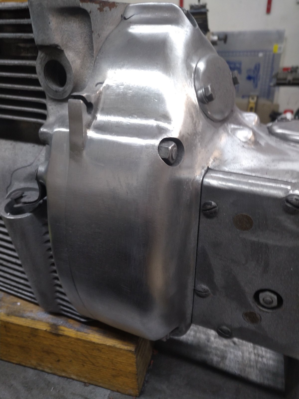

did all but the gearbox case today.

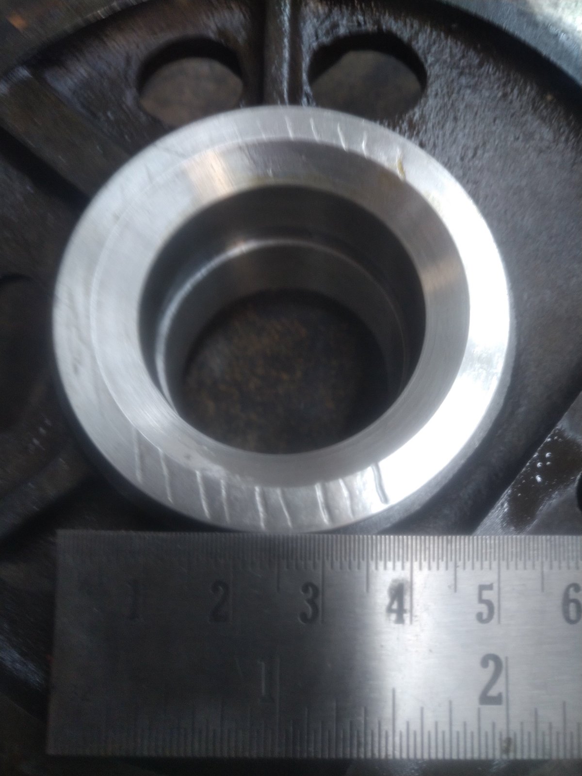

Some of those indents must be 40thou FFS
enjoying this thread , thanks , shame about that maching(?) but no doubt you will sort it .
