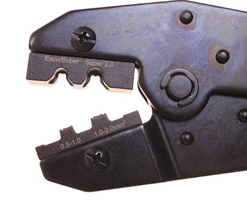

Aye, I think they are like that except with three positions.They should look like this
The rounded end is the mechanical crimp, the 'm' shaped end is the electrical crimp. If you don't have, I'm sure you could improvise with a pair of long nose pliers and a quick dab of a little solder.
