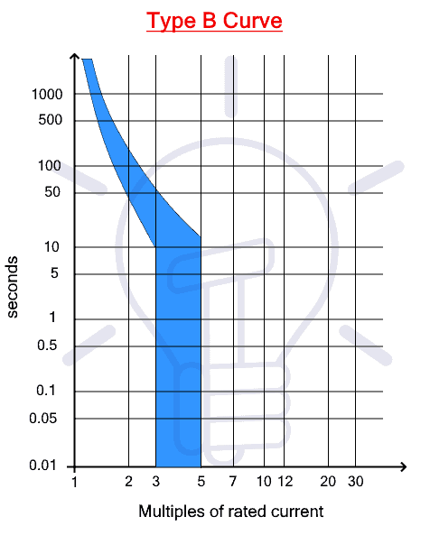

All MCBs (or RCBOs) will trip when the current exceeds the maximum rated current, as you would expect. However, it's not a binary "Exceed current = trip, don't exceed = don't trip" decision.
The breakers operate on a curve where they will tolerate an increased rate of current ("inrush") for a pre-determined period of time.
Inrush is dependent on how much of an inductive load is present where, simplistically put, an inductive load is something with a moving part like a washing machine, lathe, drill or compressor. Or welder...
A device that has an inductive load can demand an inrush of 2x, 5x or even 10x its normal running current. So a 3HP motor on a lathe or a drill will draw 10A once it's up and running but might need 6x that (i.e. 60A) to get going.
This is why a "perfect MCB" that just cut off at its rated value wouldn't be much use in real life.
In reality, MCBs have rating curves as per this article (and many others).
Here you'll see that a typical-household B curve MCB is has a curve that says it will (simplistically) withstand up to 5 times its rated current for up to ten seconds.
If we go back to our 3HP motor, that would suggest that we need an MCB that can handle the 16A in a ring main, so in theory a B curve B16 would do fine -
But spot the range, which is 3 to 5 x rated current. The MCB would have to sustain 60A+ for up to ten seconds, which on paper seems doable. But note the curve is 3-5 times so the minimum they will design to is 48A and, rest assured, nobody wants to go to court to defend why their MCB design hoped for the best....
Then we look at the C curve, which looks like this:
And now we have a minimum of 5 x 16A (on a C16) = 80A up to 160A. Admittedly for a maximum of one second, and then there is a rapid turn down in the current limit before it will trip.
So generally, for a tool with a high inductive load, such as a motor or a welder, you would want to pick a C curve MCB.
