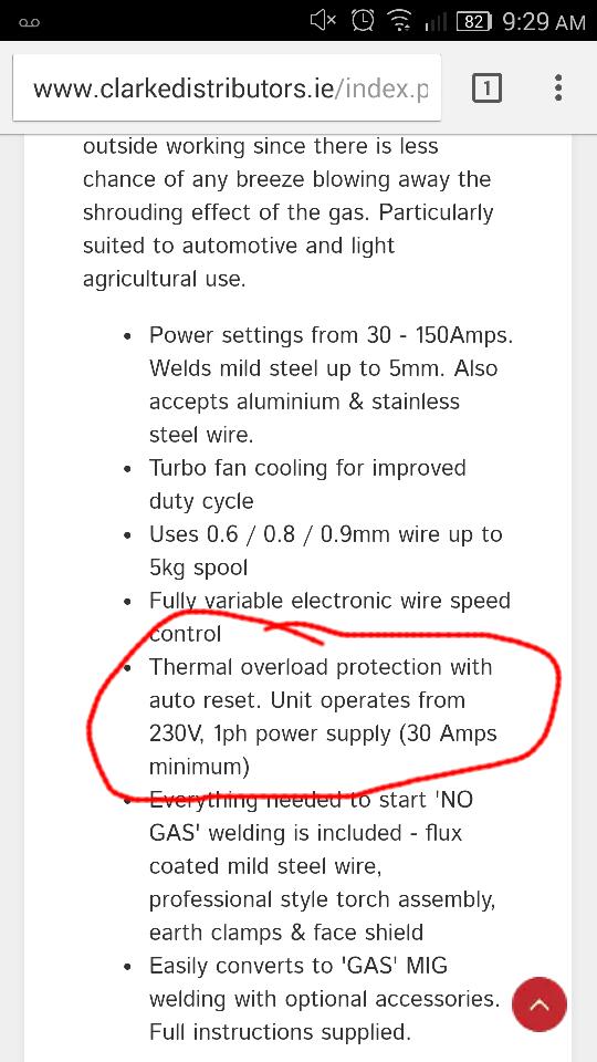

Clarkes up to the 160 (which is really a 150) are used by owners with normal household electrics, a few people find if used on full power they can pop the occasional fuse but the majority have no problems at all..including myself.
il go with the clarke....to start with il be using Flux core as its a little cheaper to run though it's messier(don't mind) . In terms of the material thickness that can be welded....is there a difference in thickness of material in regards to wherever use Mig wire with gas or Flux core?sorry mig wire just looks like copper wire to mecopper wire
Mine 180 16 on 13 amp plug not running now need a motor can’t find one any where britweld weld rite welderHey folks
Probably asked loads already but a suggestion on Mig welders that will safely run on a 13amp socket. From reading it's under 150amps i believe ? Just some odd work on 4-6mm metal...gates, barbacue, wheelbarrow some off bits to keep me entertained....gas and gasless preferably

A mate of mine used a pair of compasses - seriously! I wonder what their current rating isWell, if we're going to continue down the thread resurrection patch () I feel duty bound to say that it's not the 13A fuse in the plug that will make the difference, rather than the C curve C16 MCB in the distribution board...
