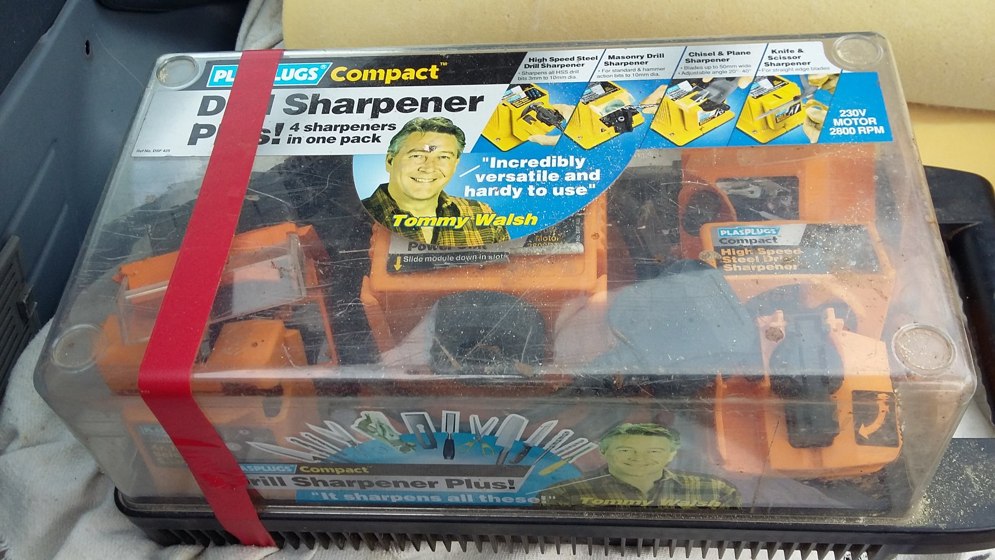

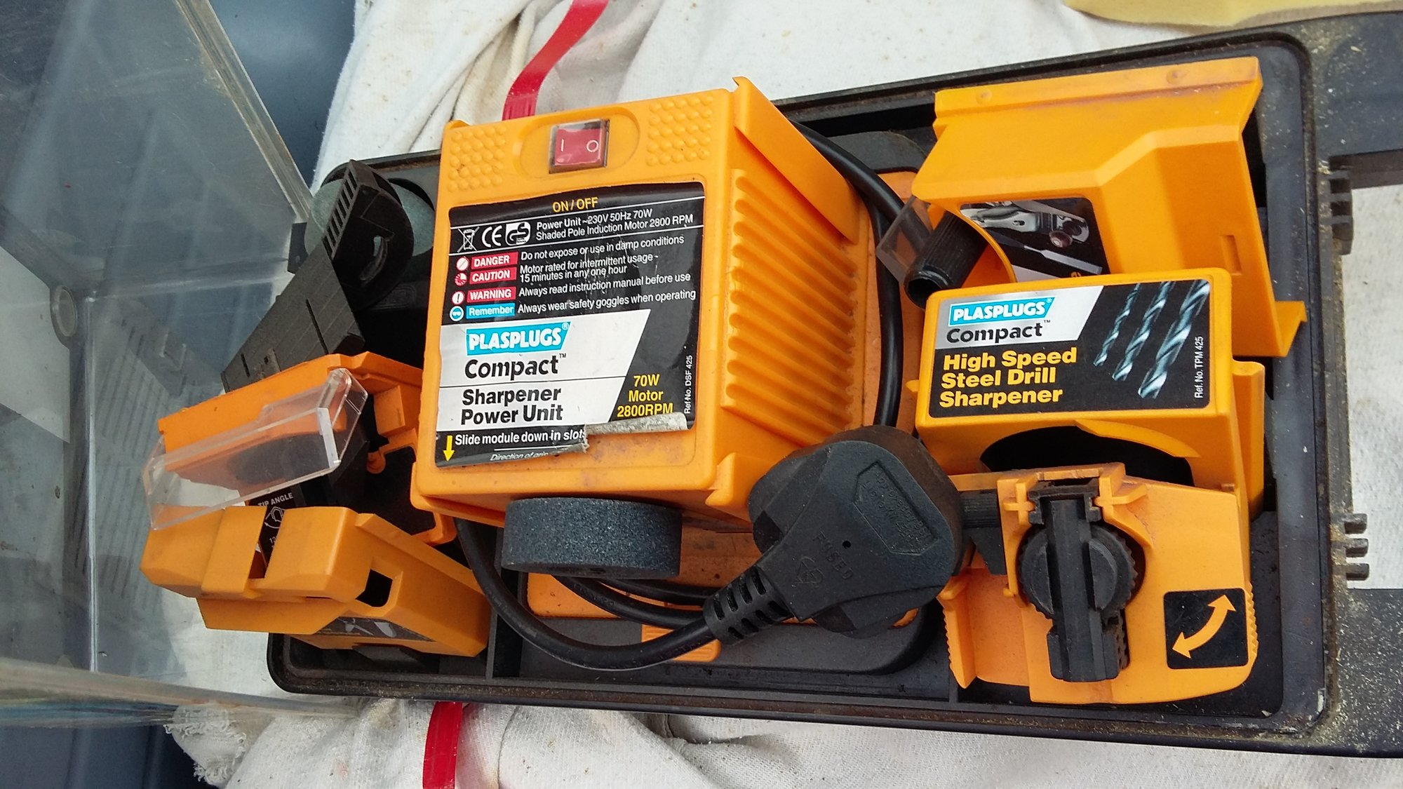

Here we are, Tommy Walsh approved too.
Tell us more
that looks like the lidl one I haveHere we are, Tommy Walsh approved too.
if slimboy gets his going its free sharpening from them pmsl
I can teach free hand sharpening of drills in a very short period of time. Its amazing hiw many lack this simple and essential skill today.I have a slow speed Creusen grinder but wont embarrass myself with hand sharpening drill, so can anyone suggest a simple drill sharpening system for touching up those blunt drills which I am loathed to throw away?
good god that was the rawlplug one I got cheap and chucked it in the bin wonder how much that nurd got paid for advertising that crapHere we are, Tommy Walsh approved too.

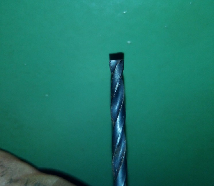

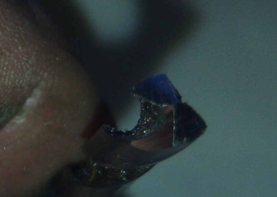

That’s where they are bloody handy things. Anything smaller than 4mm I have to chuck out now. Cant seem to hand grind a nice edge on the little ones.Tested mine out again today on a load of drills and all came out perfect, smallest was the one in the pics below, a 2.8mm that had snapped. I ground the end flat as per first pic.
Into the drill doctor and ground and split pointed it and it was spot on, drilled a bit of 316 and as good as any I have used.
