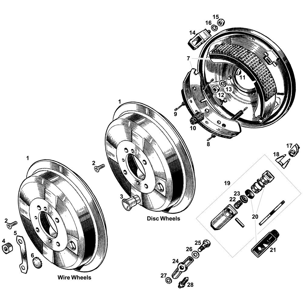

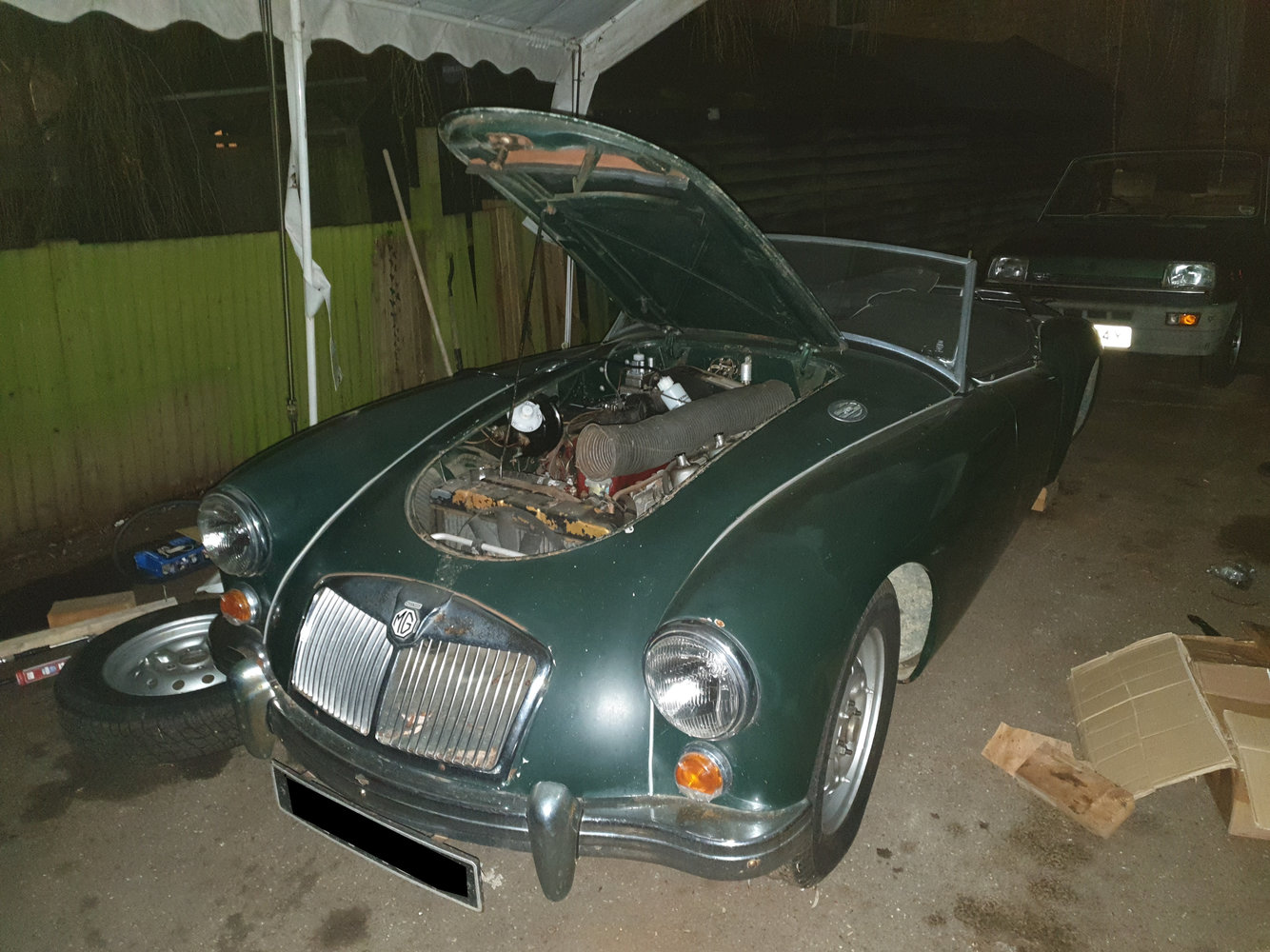

Hi Malcolm,I changed the rear brake cylinders in my MGA last week. There had been a problem with the master cylinder which caused the pressure to stick on and blow the seals in the rear cylinders. I replaced the rear cylinders. Tried to bleed the brakes but couldn't get pressure. The master cylinder was suspected bad anyway so I changed that.
I've been trying all day to bleed the brakes again. I've put a litre of fluid through and there is no more air coming out. Rear brakes are adjusted tight so they don't travel. I still don't get pressure. The pedal goes down to the floor and takes another 2 full travels to become firm.
Logically it must be the rear cylinders as that's when the problem started. They are funny things that require an internal spring. I wonder if the aftermarket suppliers all include the spring. Maybe I'll order some reassuringly expensive ones from one of the major suppliers.
What else can I be missing? I've never had trouble bleeding the brakes on this thing before.

I also have an MGA, 1600 mk1
