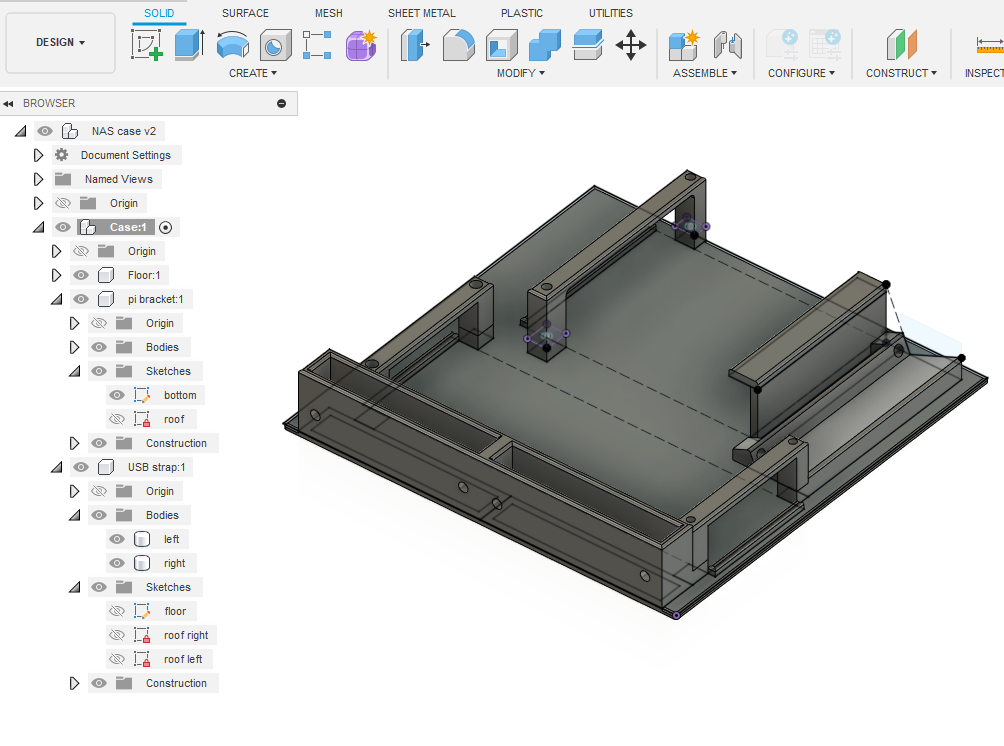

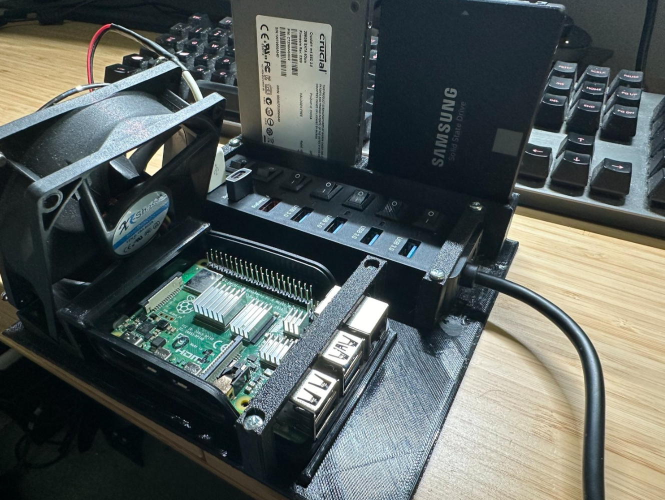

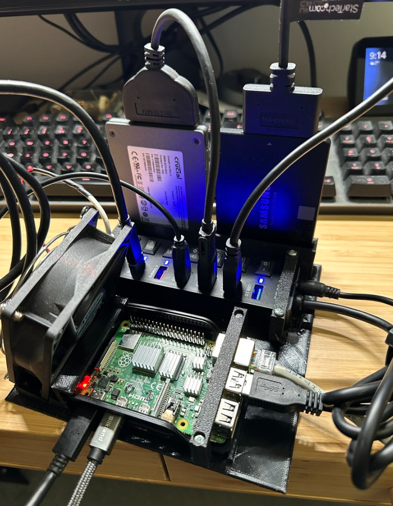

I haven't measured it but it's worth looking into some of the videos around the Topton motherboards. They've been reported to consume less power than Raspberry Pi's in use and offer far more capabilities.Acasestand for my Raspberry Pi powered NAS (Network Attached Storage).
It's going on a shelf so doesn't have to be totally enclosed, just hold the bits together without them straining at their cables.
Yeah - I've got a NUC for home assistant so will likely buy another if the NAS works out. At the moment, it's cost me literally nothing as I had the SSDs and pi lying around so it's just to prove whether I need it (I'd rather not go back to having a bunch of servers in the house).I haven't measured it but it's worth looking into some of the videos around the Topton motherboards. They've been reported to consume less power than Raspberry Pi's in use and offer far more capabilities.
I built a little server for the office using one and it's been great, Proxmoxx as the main OS then various VMs running things like pfsense for dns, VPN etc., some Atlassian software etc. It's a bit unfair to measure the power consumption in this situation because it's currently running far more than a Pi ever could.

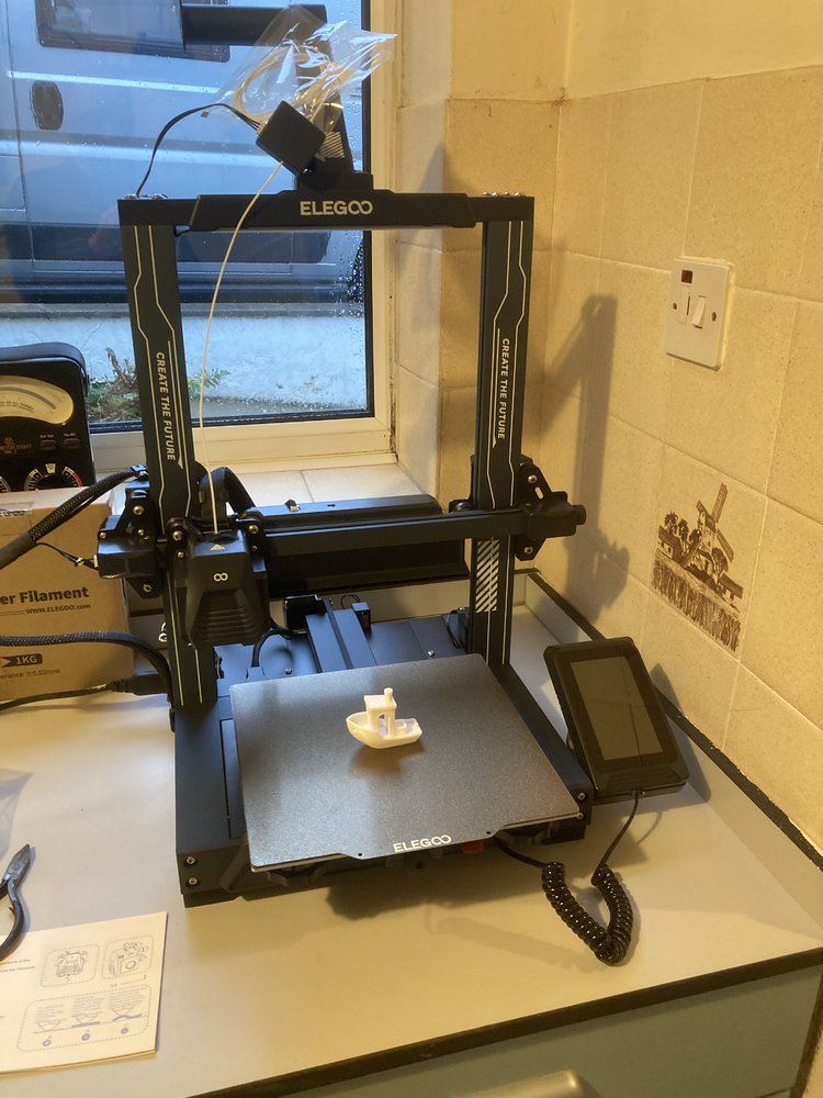

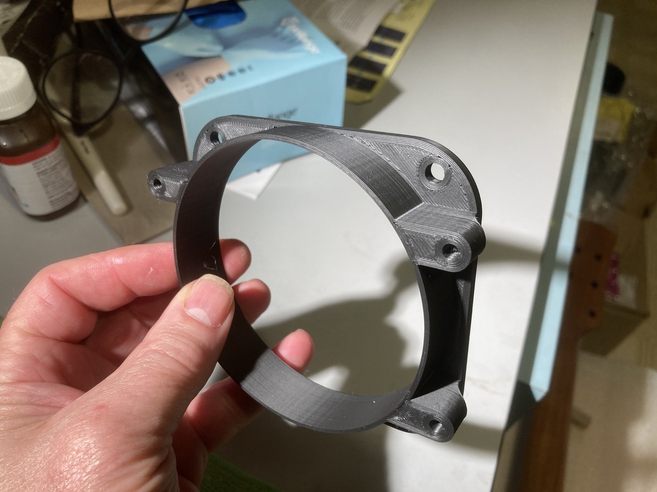

Well, I just got this one (Elegoo Neptune 4):
I printed an adaptor ring that I’ve been fiddling with in F360.

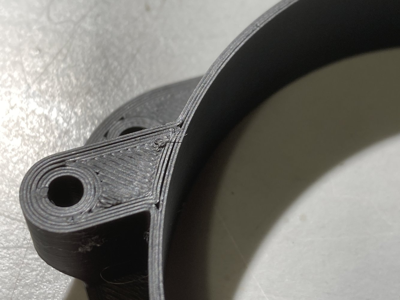

I was impressed with the finish, but there are areas that don’t seem fused. (I was using the default temperatures, etc. from the slicer that came with it, so peering down the rabbit-hole of slicer settings at the moment!)
Took just over an hour to print.
This was only printed in PLA, but the final article will need to survive being outdoors, or under a car bonnet - What type of filament do people use for functional stuff? (I had presumed ABS, but PETG or ASA seem to be as good, but reportedly easier to print.)
Whatever it is, I need to get hold of some and get the printer dialled in.
Thanks.Your print issue is the pressure advance settings being out for the filament, you probably need to run some calibration prints. There's a little underextrusion too, turn the flow up a couple percent.
That matte surface generally means it was printed too cold for the speed too, if it was normal PLA.
I can see that there are options for various calibrations in the Orca slicer.Honestly ASA prints more easily than PETG really - it's similar flow and behaviour wise to PLA, PET-g is sticky, stringy and needs slower speeds than either

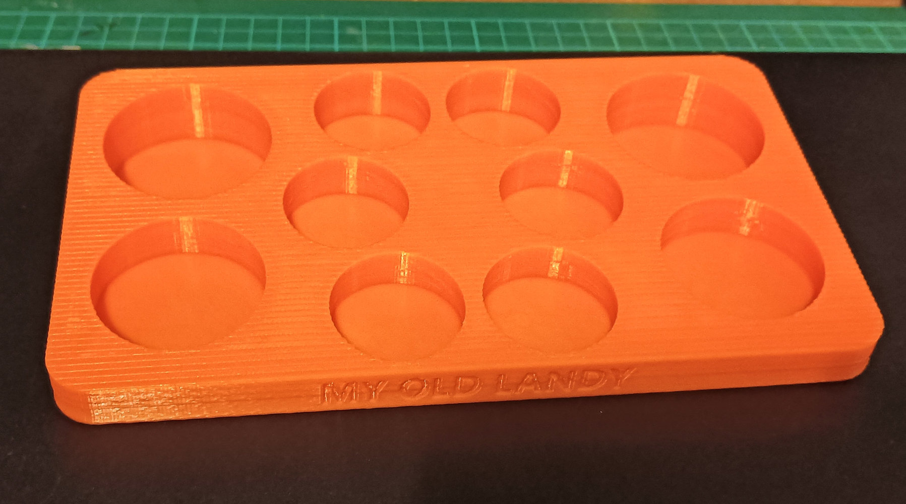

Hmmmm... I printed the above in PETG, which I've been using for about a month, and I might go back to PLA.
The printer (Ankermake M5) is super fast with PLA and would have printed that stand in 1 hr 20 minutes (100g of filament) but took 4 hrs 40 with PETG. Seems that this printer (other manufacturers are available...) won't do superfast on PETG. I think it's worth the dehydrating hassle with PLA to get the speed back, to be honest. I've also found that PETG lifts in the corners on large prints (heatbed is set to 80C) which hasn't been a problem with PLA.
For something like that with a wide thin base, in PETG, I find that printing it with a 3mm brim helps reduce the risk of corners lifting part way through.
