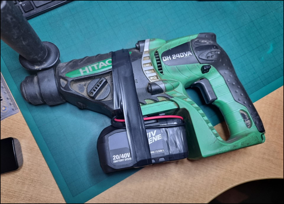

Is that the “before” pic?Made a battery adapter for my 24v hammer drill which has dead ni-cd batteries

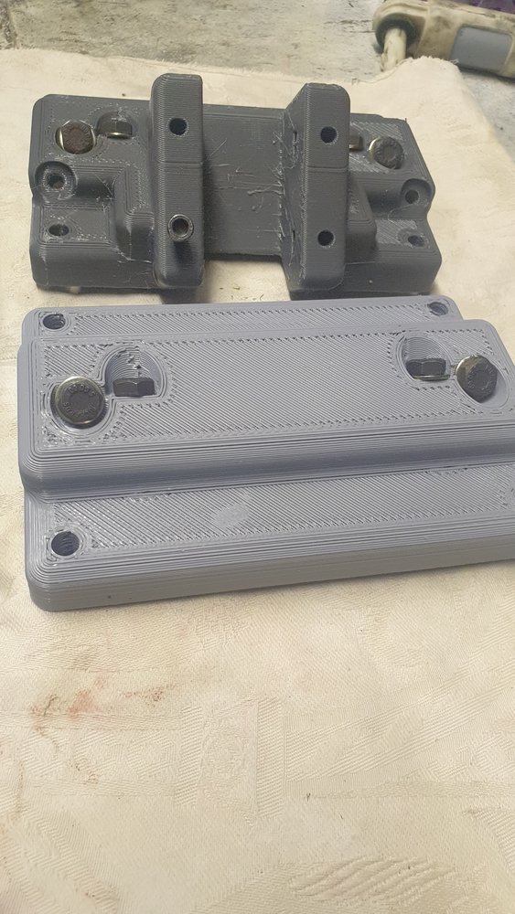

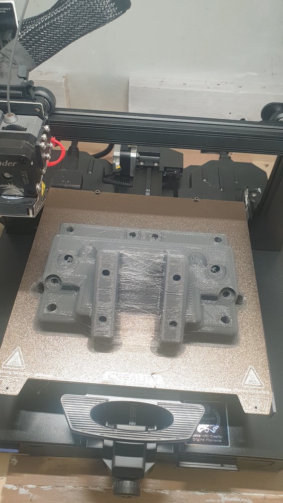

Parts feel solid. 1st time using a 1mm nozzle. Do I need to increase the extrusion multiplier? Any tips appreciated!You've got a lot of underextrusion there? Hopefully doesn't take too much in the way of load!
0.5mm layer heightWhat speed and layer heights? Seems a bit cold for a 1mm nozzle, I usually end up 260-270 with petg and 1mm extrusions.
I mean 0.5 is fine with a 1mm nozzle, his extrusion widths is probably 1.1-1.2mm
It's the actual flow rate that's the issue at that temp, I think even if it's a CHT nozzle you'd be struggling a bit there.
Would a CHT nozzle be any benefit with the standard hotend?I think even if it's a CHT nozzle you'd be struggling a bit there.
