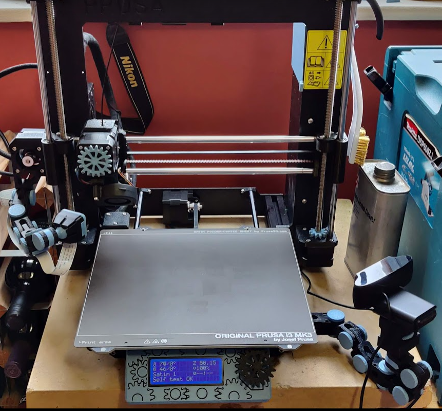

I'd say it's a bit of both as well as the nozzle catching the un laid filament run it not only catches & sometimes melt it it often drags the left & right edge of the first few layers up like Turkish slipper & fills the torn up areas with globs of cooling the prints is torn off the bedI have had a closer look after another test print came unstuck (deliberate adhesion test). The nozzle was covered in baked ASA filament and what I think is happening is to do with ASA / ABS only. As a print loses adhesion and warps, those areas are higher than the nozzle. When the nozzle meets those areas, the material is melted by the nozzle and sticks to it before being deposited back onto the print. At least I think so. It doesn't make sense that the print in question didn't warp yet was covered in rubbish though.
Putting a skirt around the print when you design & digitalize the print helps to prevent this as well .
Have you done a proper nozzle clean with an acupuncture pin up the nozzle hole after you have used a brass brush to remove any nozzle crud off a hot nozzle . Do a melt run test after cleaning the nozzle to ensure you get a good 3 inches of free flowing melt . Occasionally using the acupuncture pin , will loosen some carbonised crud & dust inside the nozzle bore that clogs the jet a bit .
I've found over time that once I've run the heater through two cycles prior to printing to get things nice and hot for a good print I need to raise the z axis to max and use a make up pad ( 1,200 for £6 eBay Oct 2021 ) to remove any globs of melt that have run out freely . Having my the printer bedplate raised to eye level means I can easily see if I've managed to get everything nice & clean and see how things are printing I don't have to look down and guess if things are running well . When you get proficient with your printer you'll be able to wipe the nozzle whilst nozzle is raised & the x axis is being traversed immediately before the actual pre print run print starts depositing the nozzle any more extrusion .
