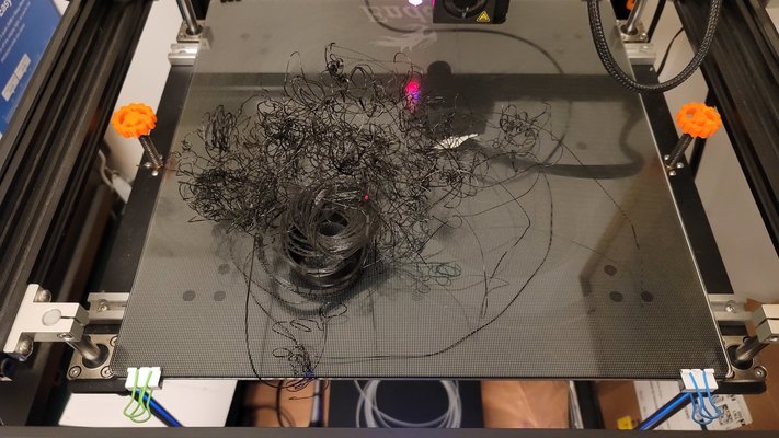

It's an Ender 5 Plus
)For my prints I'm using pretty much Cura defaultsThe quality isn’t completely due to the printer, but the stepper drivers will make a difference.
The settings in the slicer will make a difference, if the slicer is set to print in 0.3mm layer height the print quality will not be as good as 0.1mm layer height. Also print speed can change the quality

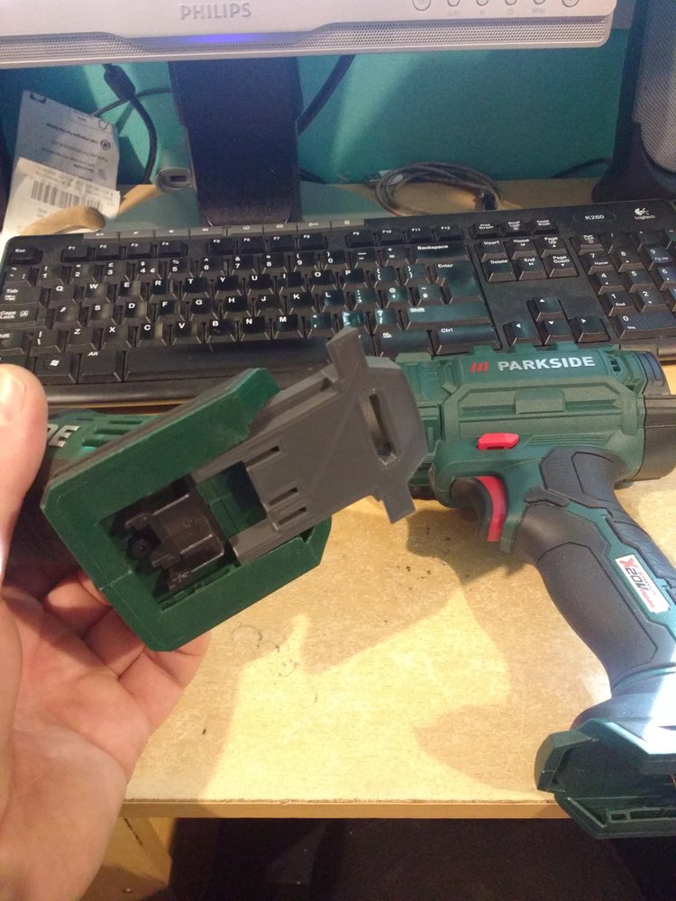

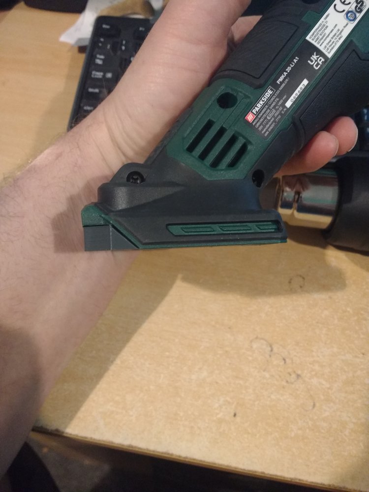

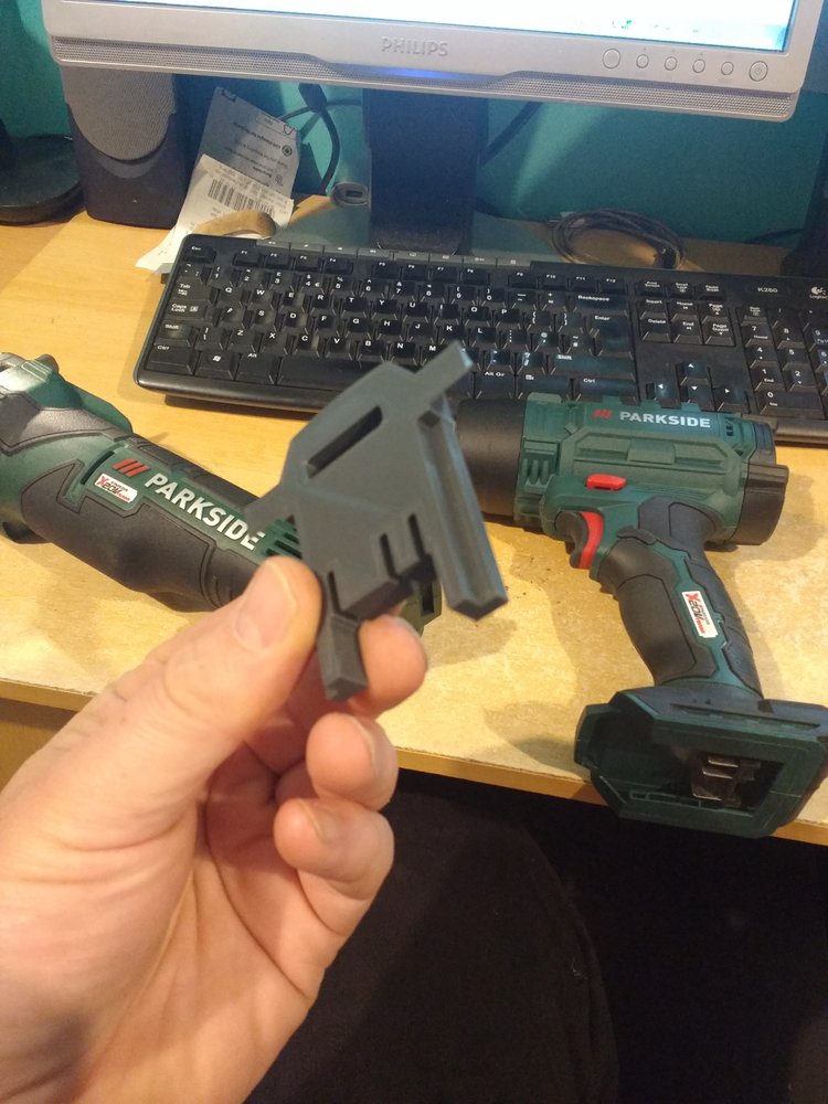

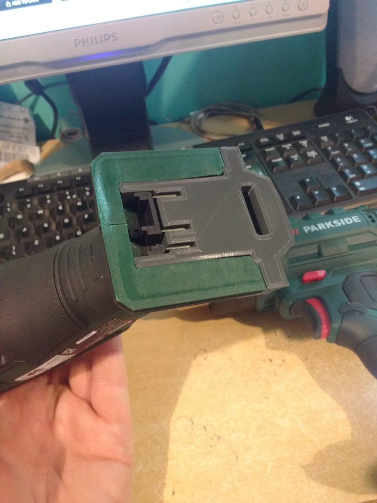

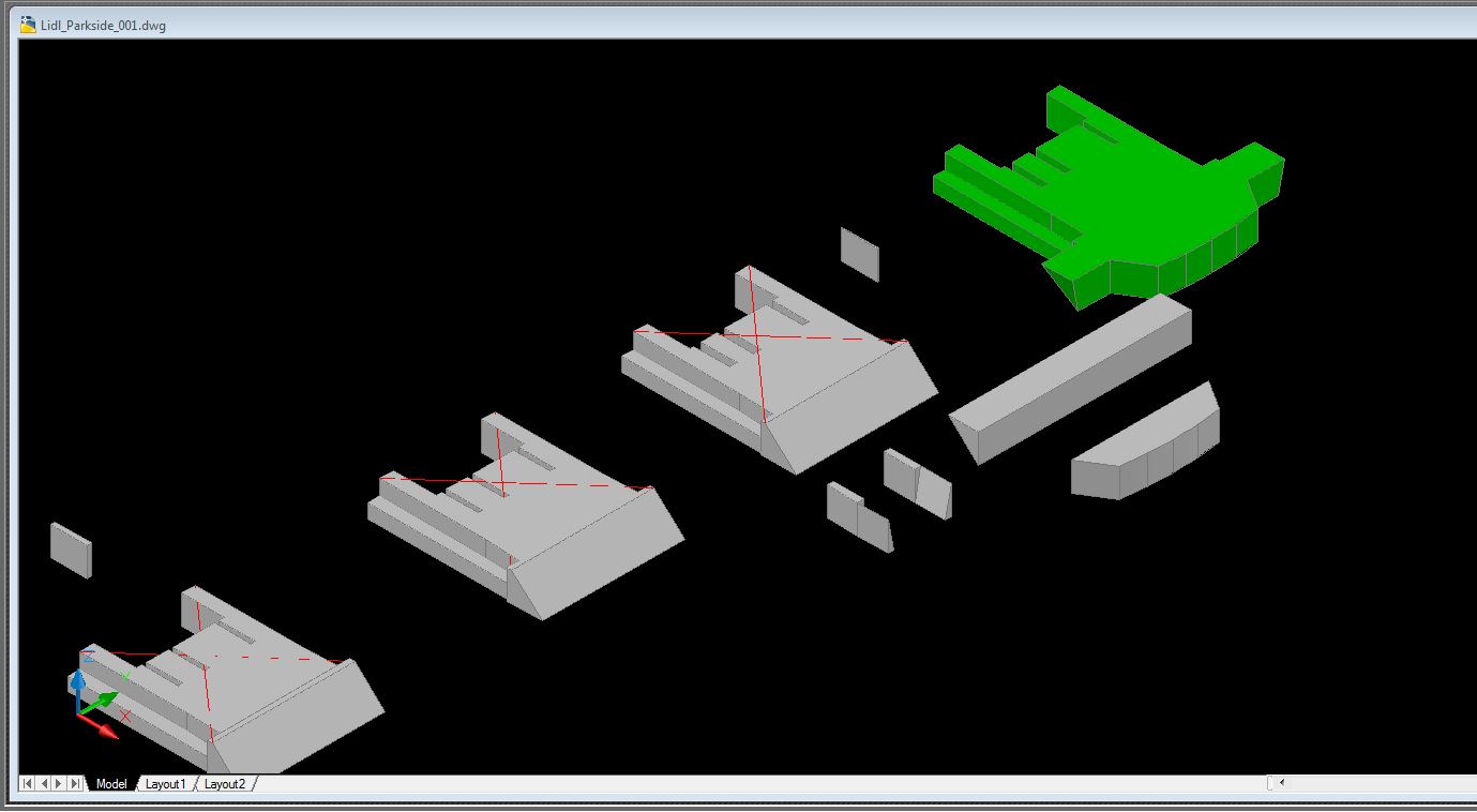

Sat down last night to start a Makita to Parkside adapter. as per my previous post. Got so far with it then went to bed. This moring I fired up AutoCAD to carry on but couldn't remember where I saved it. What I did find though was the previous drawing I did in April 21! I'd totally forgotten I'd even done it.
What sir needs is Everything. It indexes all your files, so you just need to take a guess at the filename. Free too![]()

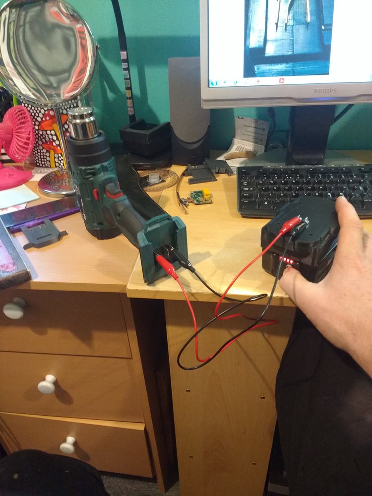

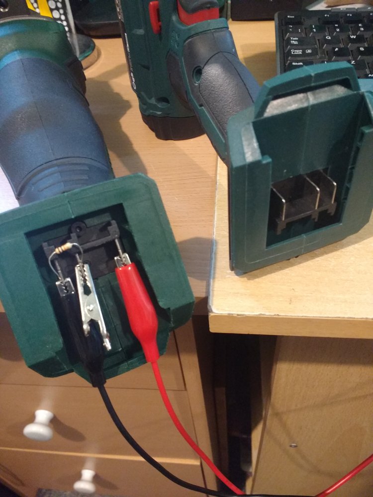

For the 3rd pin you can use a 10k resistor from T to negative on the tool and leave the battery 3rd pin unused.
If you can get it near the cells (if you were making up a battery case for example, not just an adaptor) a 10k NTC thermistor would give some overheat protection, but wont do anything through a layer of plastic.

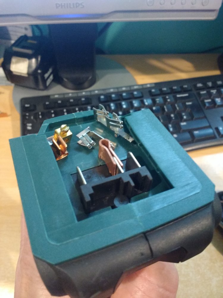

My attempt at contacts, theres a few pics of my ferrex adaptor, bent out of brass sheet.

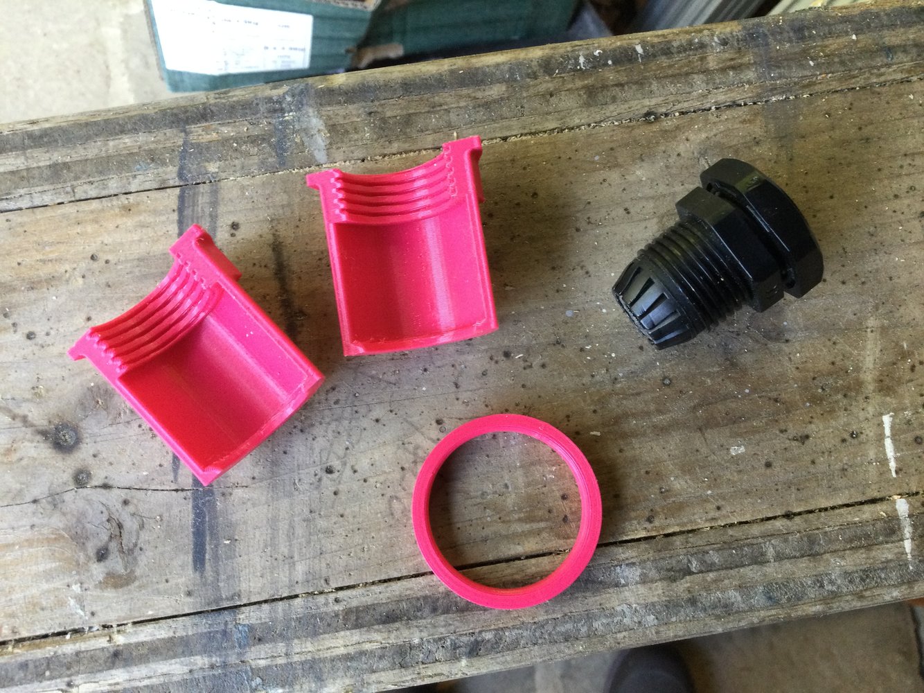

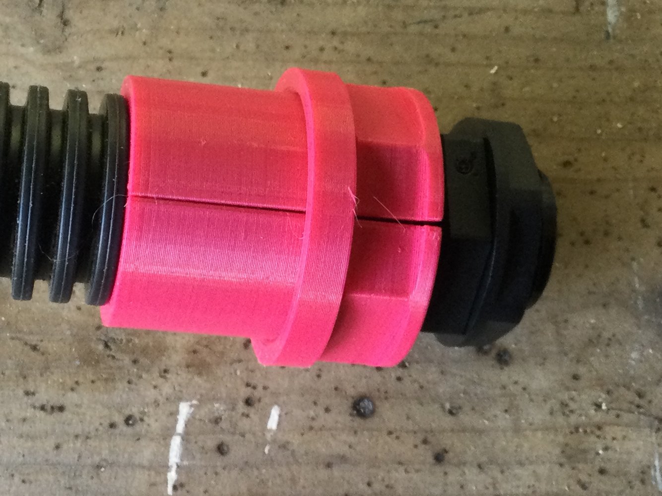

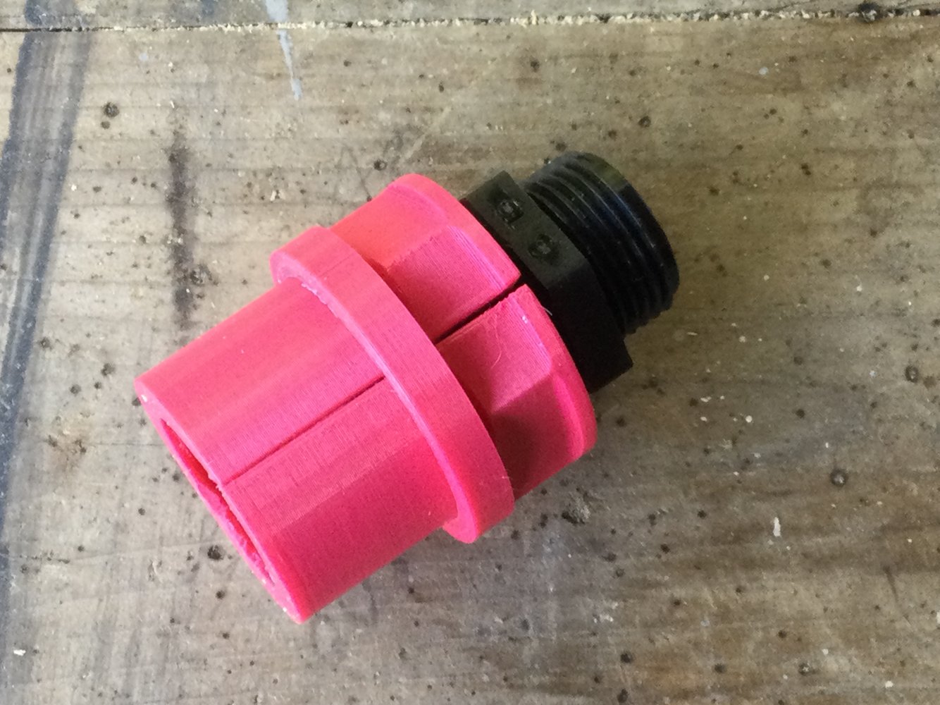

it only took about 2 hours to draw, four hours to print four of them and it saved me having to throw away 0.75p worth of valuable plastic conduit![]()
But then you’d have a saleable design!However you now have a saleable design which I would be interested in downloading!
seriously though, if you want the F360 file, or the gcode file from Cura I can email them to you. I could even dig out the product code from CPC for the conduit pack and cable glands if you want.
Pm an email address. Do you have a preference for the F360 file format? I seem to remember that there are lots of export options.That would be kind of you. You need to charge enough so that there is little benefit in anyone trying to sell it on. Cults3D is a good place to advertise it on. I have some free and some chargeable designs on there.
