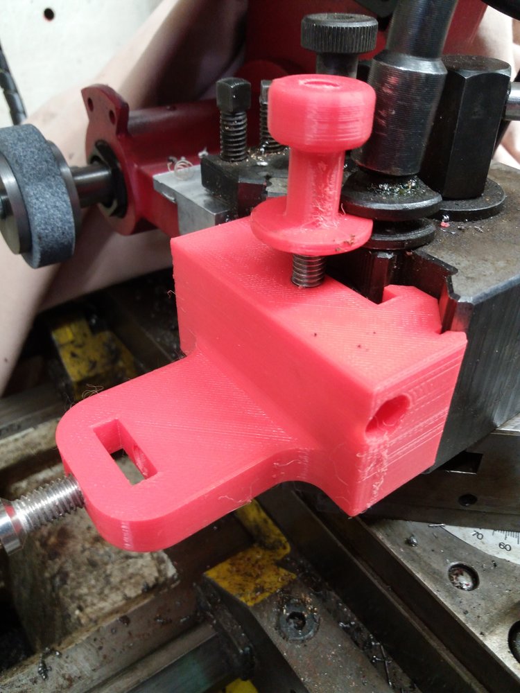

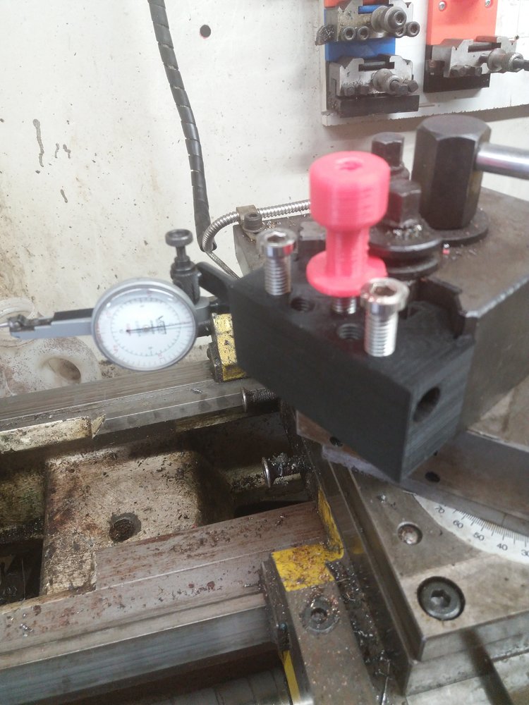

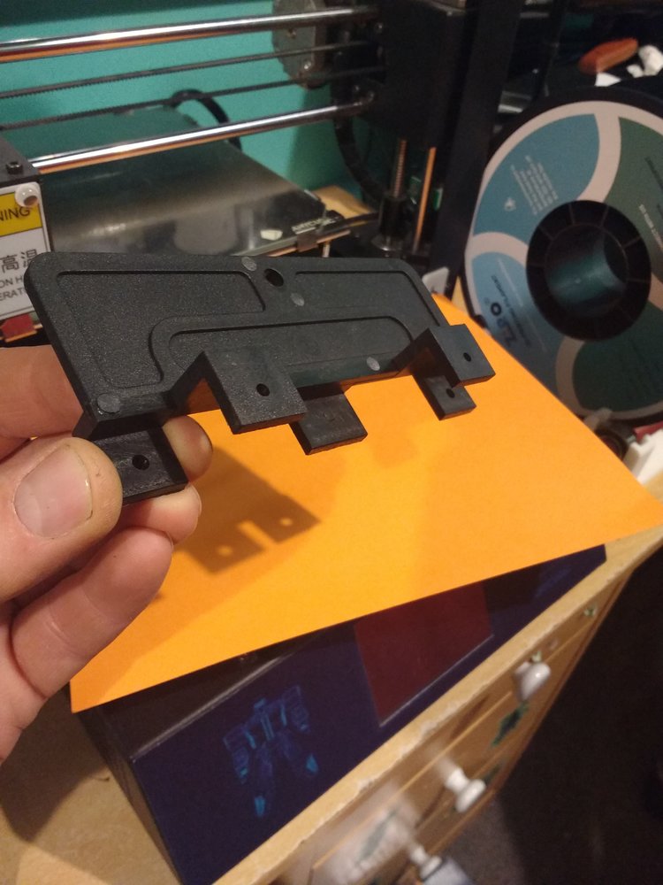

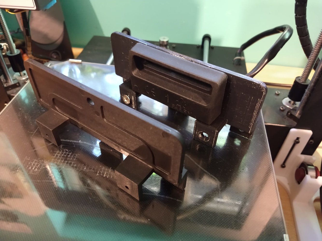

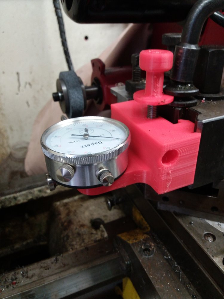

That's cool. Don't suppose anyone knows of similar for a dickson tool post. Size 2 I think mine is??My Boxford STS lathe uses a Rapid type L quick change toolpost. I printed these to allow me to use a dial test indicator without using one of the toolholders.
I printed two types, one for my Verdict DTI and one for a plunger type DTI.
I printed the holes at 6.8mm so I could run a tap through them.
In the background you can see the holders I made the toolholders.

Did similar for my wedge tool postMy Boxford STS lathe uses a Rapid type L quick change toolpost. I printed these to allow me to use a dial test indicator without using one of the toolholders.
This bloke lists various one, with and without DTIThat's cool. Don't suppose anyone knows of similar for a dickson tool post. Size 2 I think mine is??
