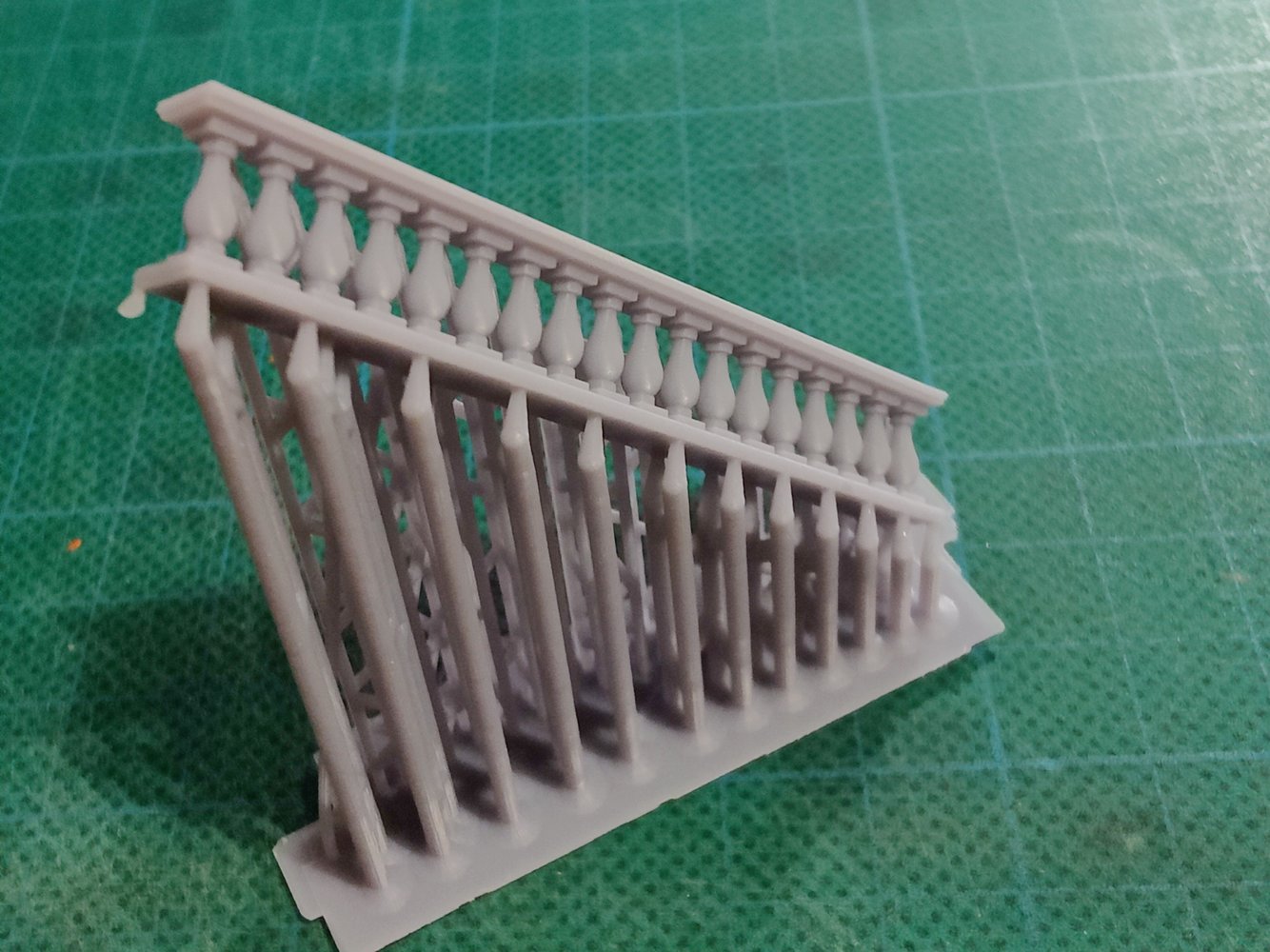

2 lengths of balustrade that sit either side of the top central pediment

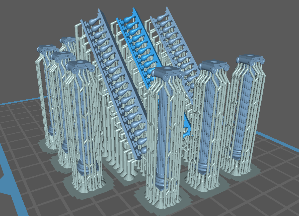

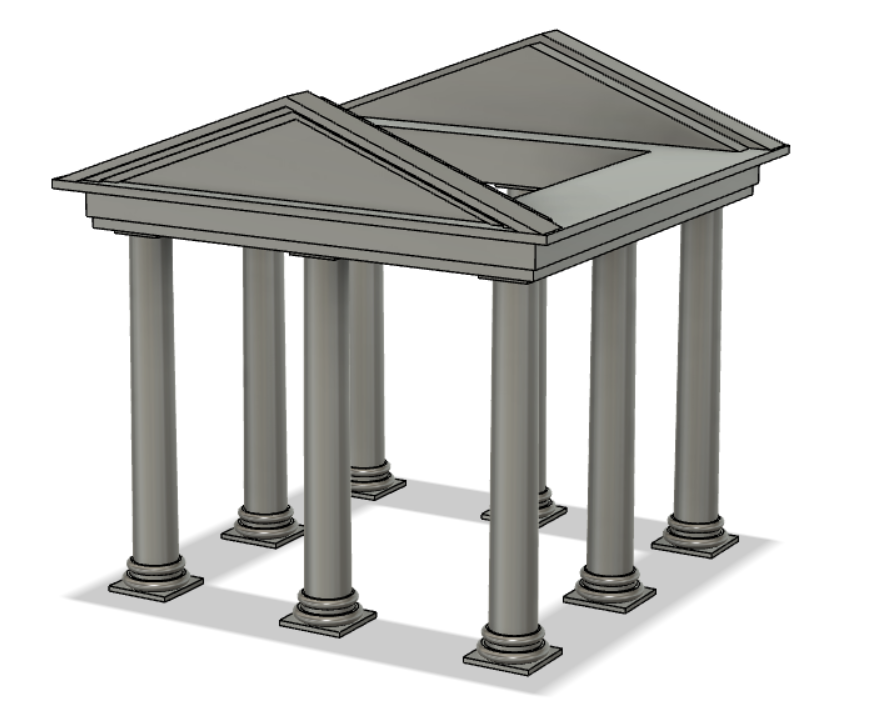

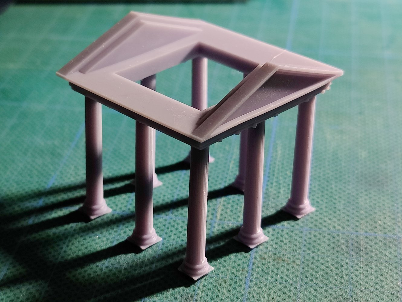

First off was the Roman temple, and at only 42mm high some of the details were going to be challenging to resolve with the resin printer. The main structure was modelled in F360, note the roof is missing - this will be added with printed card

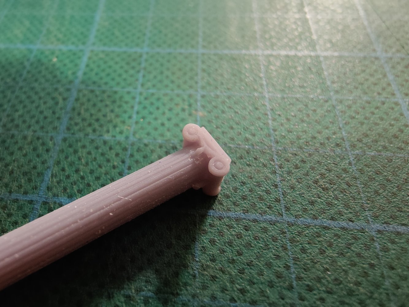

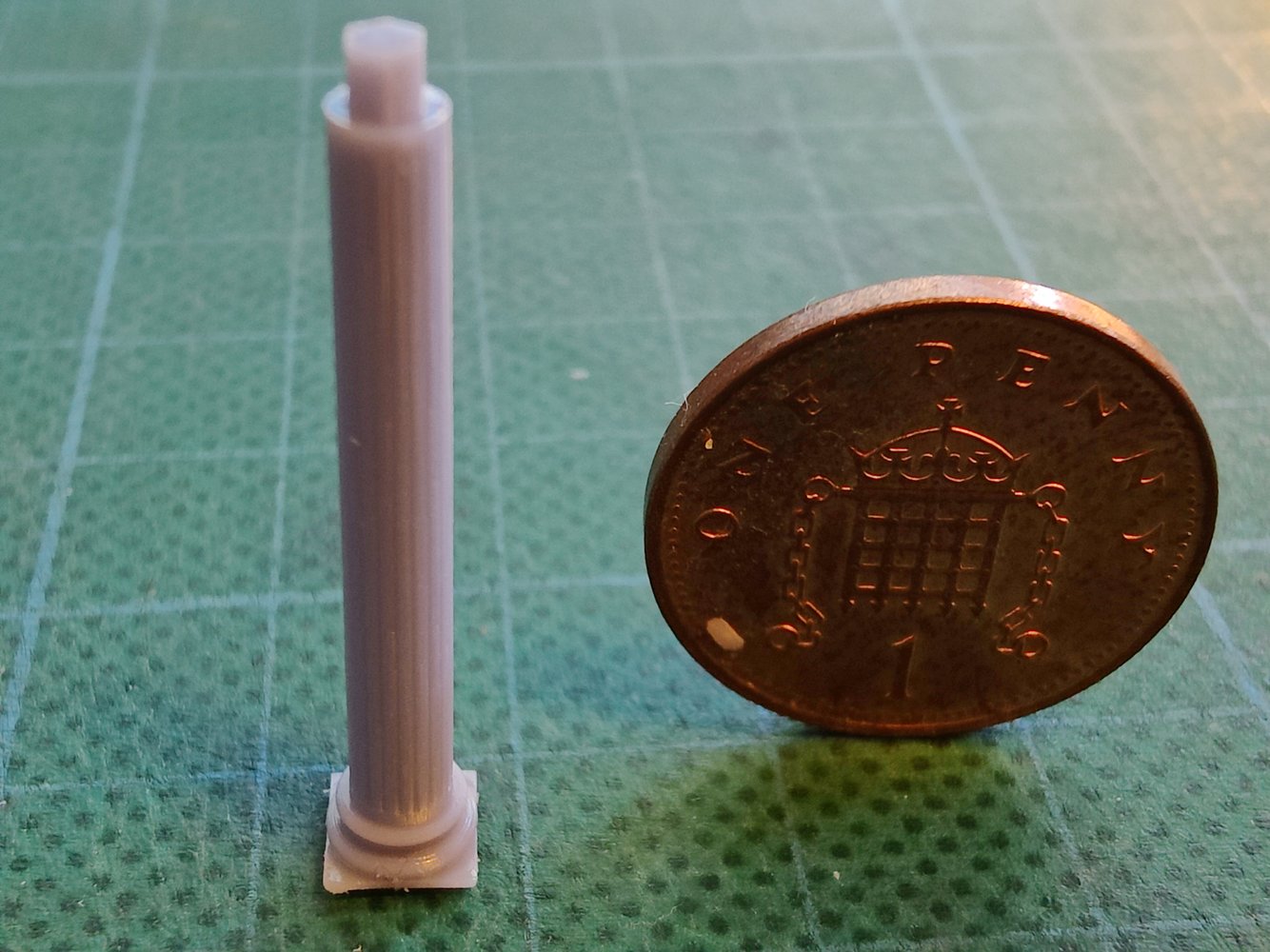

In this view of the model pillars have a plain shaft but flutes were added for the test print...
It was going to be challenging to print it in one piece due to the support structure required and excessive cleanup and so the pillars were printed separately and then attached to the roof structure

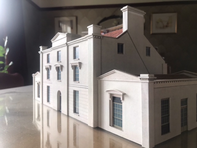

A little more progress on The Oaks model - front porch columns and ballustrade around the roof..

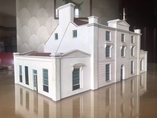

The actual model is coming on well too...
