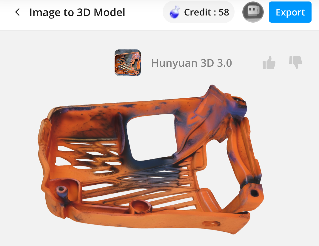

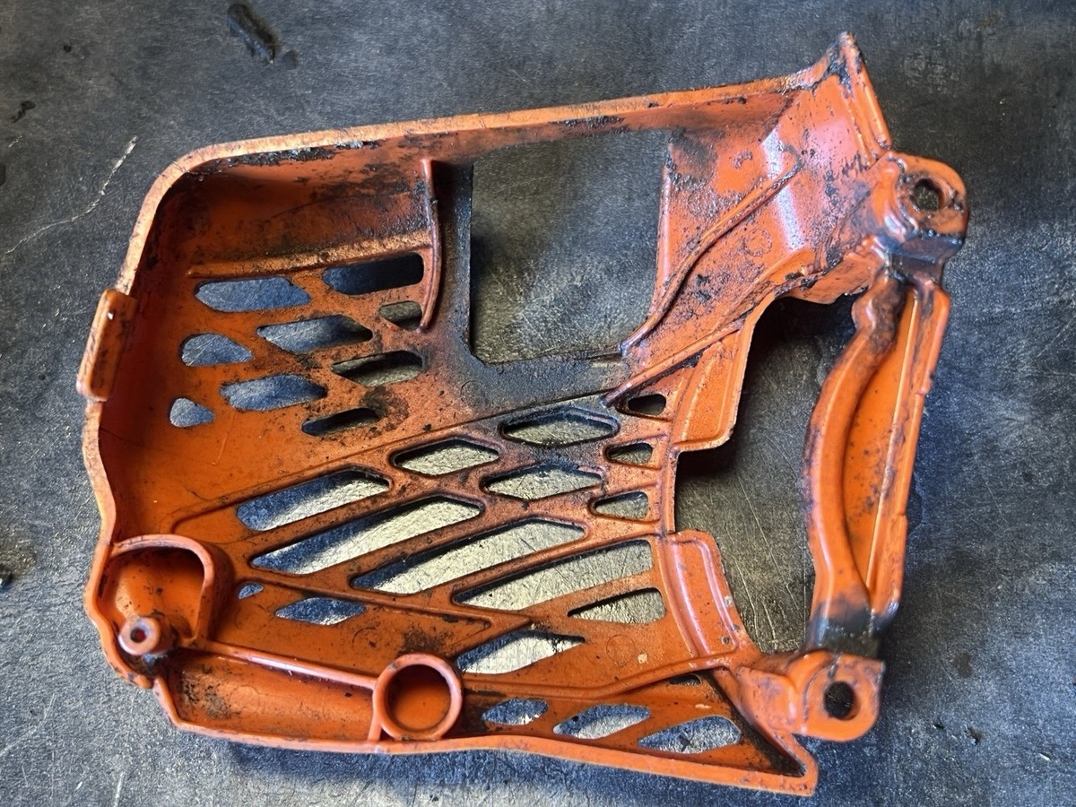

Bambu and I'm sure others have a few AI tools, gave them a try. The Statue tool is a bit rubbish.
Image to 3d, impressive but not perfect. It only takes one image, would be much better if it coild work from a few. There is another one that uses 360 video, I'll try next.
For the test, an Echo 2511 chainsaw exhaust cover. These are known to melt and break, so wokld be useful to print in something better. It didnt like a clean new one on white background so found this on ebay

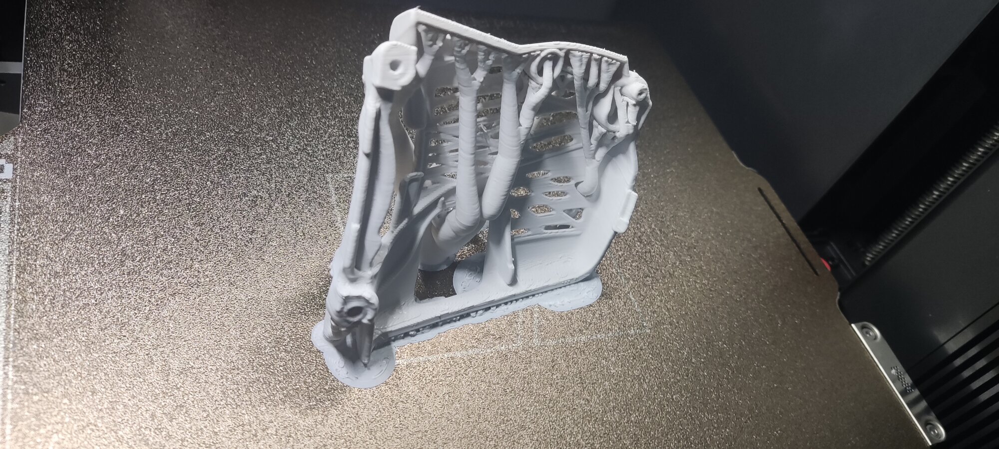

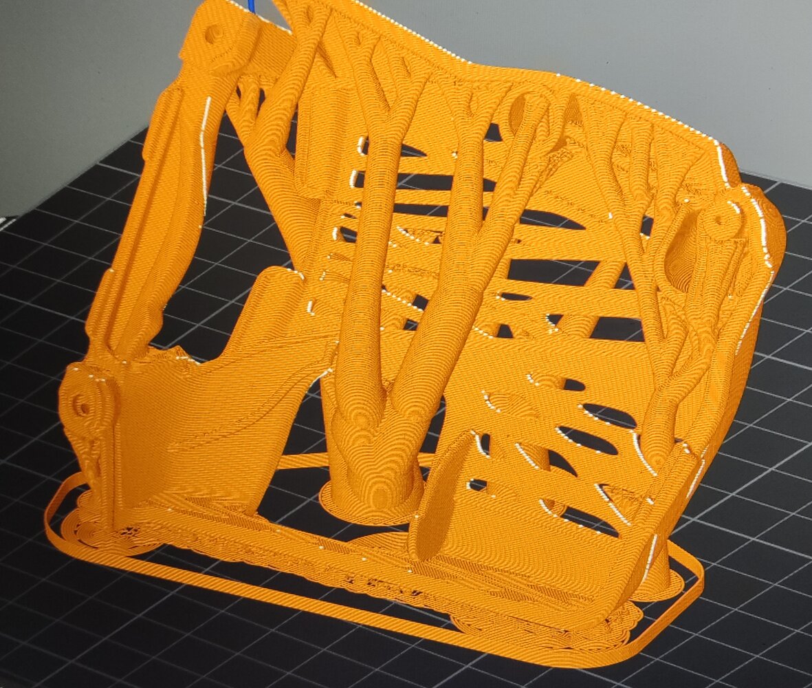

Studio set it this waysupports may need improving
White ABS

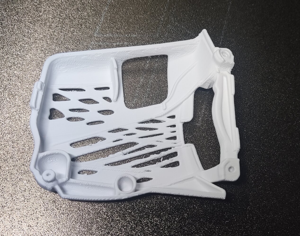

The result. There was some spagetti where it tried to bridge the gaps but not bad really.
No it doesnt fit, depth is about half and about 20% too small. While I could try scaling it, probably best to try the 360 video generator instead.
