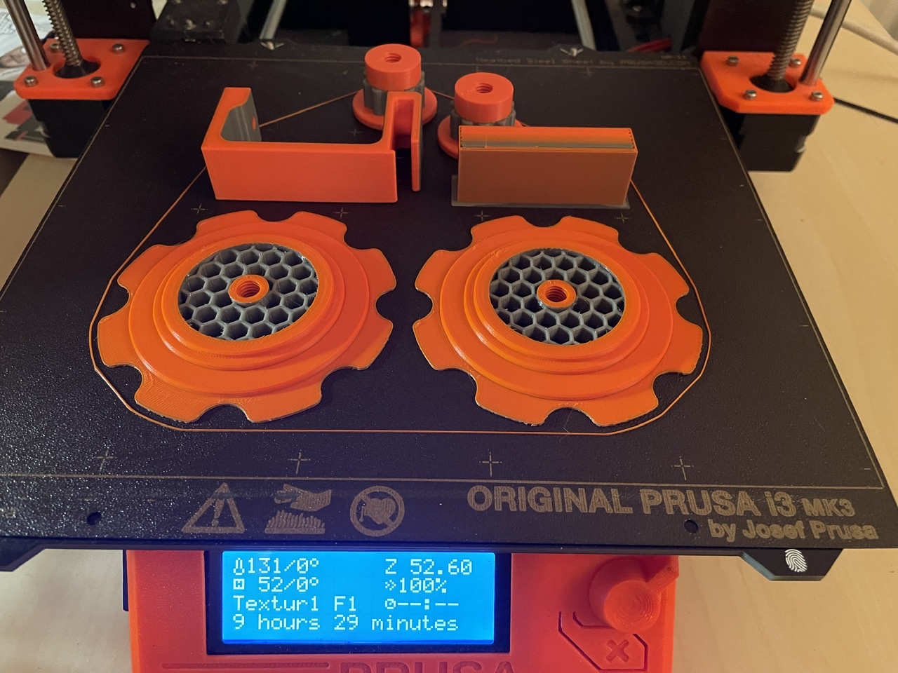

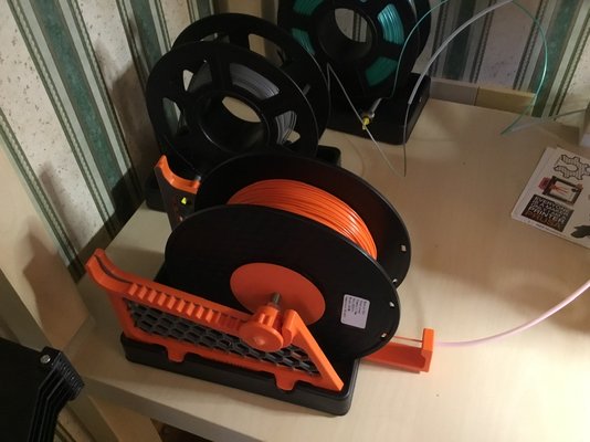

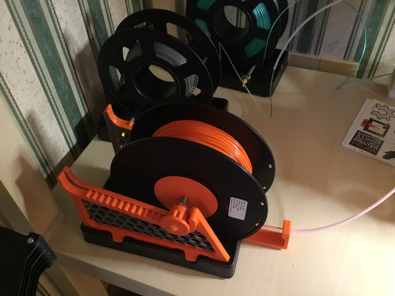

A gravity powered self rewinding filament stand. Solves the issue of extra material being loose after an unload (as seen with the grey filament)
It's to take up the slack in unloaded filament of the MMU2S - it's still attachedI like it, I just don't understand how it works. Explain please!
Reel runs back down the slope? Surely the unloaded end is still "loose"?

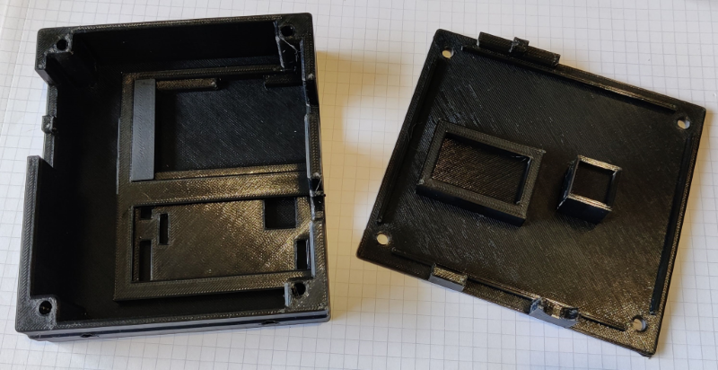

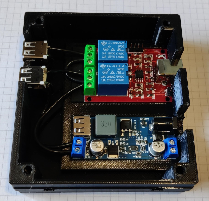

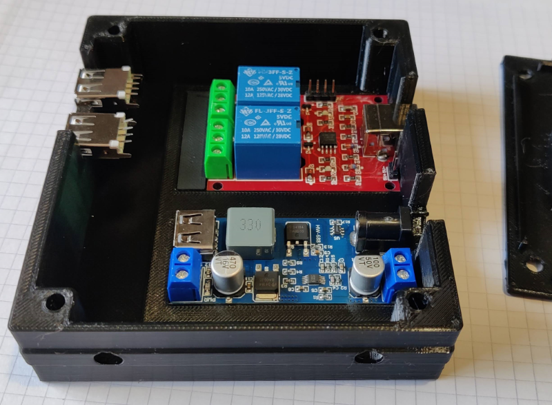

Nice. You can get little breakout boards with USB connectors on them. Might be easier to mount?One of the main reasons I wanted a 3D printer was to print boxes for various little electronics projects. Last night I finally used the printer for that purpose! I really didn't think it would work as the CAD model was knocked up in about an hour before bedtime so that I could leave the printer going overnight. There are definitely things that could be improved but I'm happy with it for a first attempt:
The pockets in the base (left) are the right shape for a couple of off-the-shelf PCBs (a 24 V to 5 V DC/DC converter and a USB relay board); the sticky-up bits in the lid hold the PCBs in place so I don't have to bother with screws and such like to keep the PCBs in place. I'm honestly quite gobsmacked that I got the measurements of the clamping pieces right first time:
I couldn't think of a sensible way to hold the loose USB connectors on the left: although they're clamped by the lid, they can still move in and out, so (after trimming the unwanted pins and soldering wires on) I glued them to the base with superglue. Hopefully that will work: it seems okay so far.

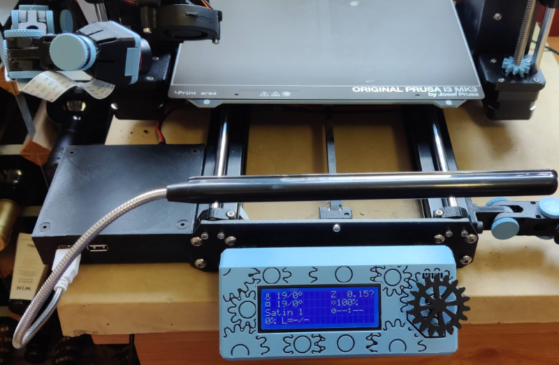

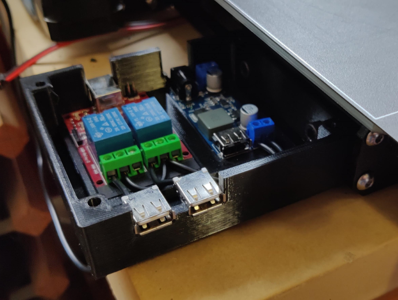

It goes here, on the side of the printer (attached to the 3030 extrusion with a couple of t-nuts):
Power comes from the printer power supply and the rear USB port is connected to the raspberry pi. The front USB ports are for lights, which can be turned on and off in software (using the USB relay board). That means that if I'm out of an evening and what to check up on the printer, I can connect remotely, turn the lights on and view the feed from the cameras. I can then turn the lights back off.
At the moment the only way to control the lights is by logging in to the command line with JuiceSSH (ssh for android) and typing in commands. Next job is to add a button to the octopi web page.
For now though, it works (although the eagle-eyed among you will have spotted that when I took this photo I'd forgotten to plug the USB cable in to the back - it took me longer than it should have to work out why it wasn't working)
Your not the only one lol. It will come as no surprise that I still don't understand after the explanations..I like it, I just don't understand how it works. Explain please!
It’s this, when the colour switcher unloads filament it’s only back to the MMU unit - so the distance between the print head and the MMU. This creates a bit of slack which the reel rolling back down the hill takes up.It's to take up the slack in unloaded filament of the MMU2S - it's still attached
Have you got a link to that file ?
I guess you mean behind not being? Damn speil chuckers. LolIt’s this, when the colour switcher unloads filament it’s only back to the MMU unit - so the distance between the print head and the MMU. This creates a bit of slack which the reel rolling back down the hill takes up.
link to the model: https://www.prusaprinters.org/prints/10370-gravity-spoolholder-for-mmu2s
Heres a video of what I’m talking about (skip forward to 2:00)
The OEM solution is a buffer cassette - the black thing you can see being the printer in the video - which works fine but takes up space.

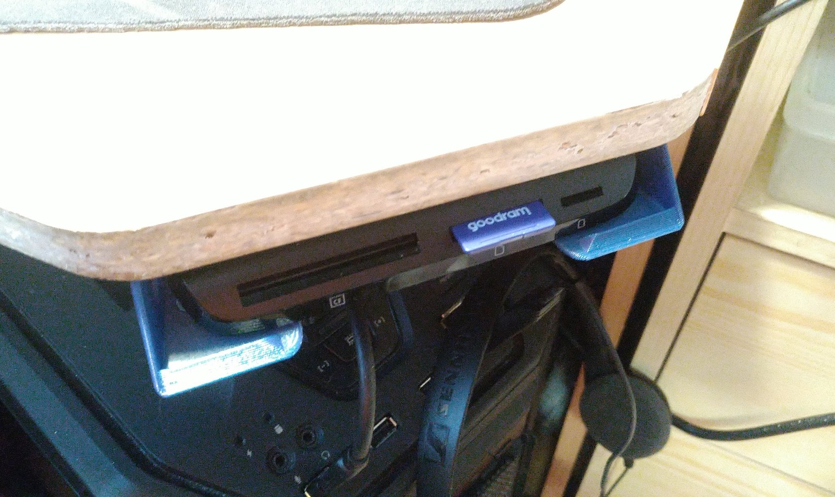

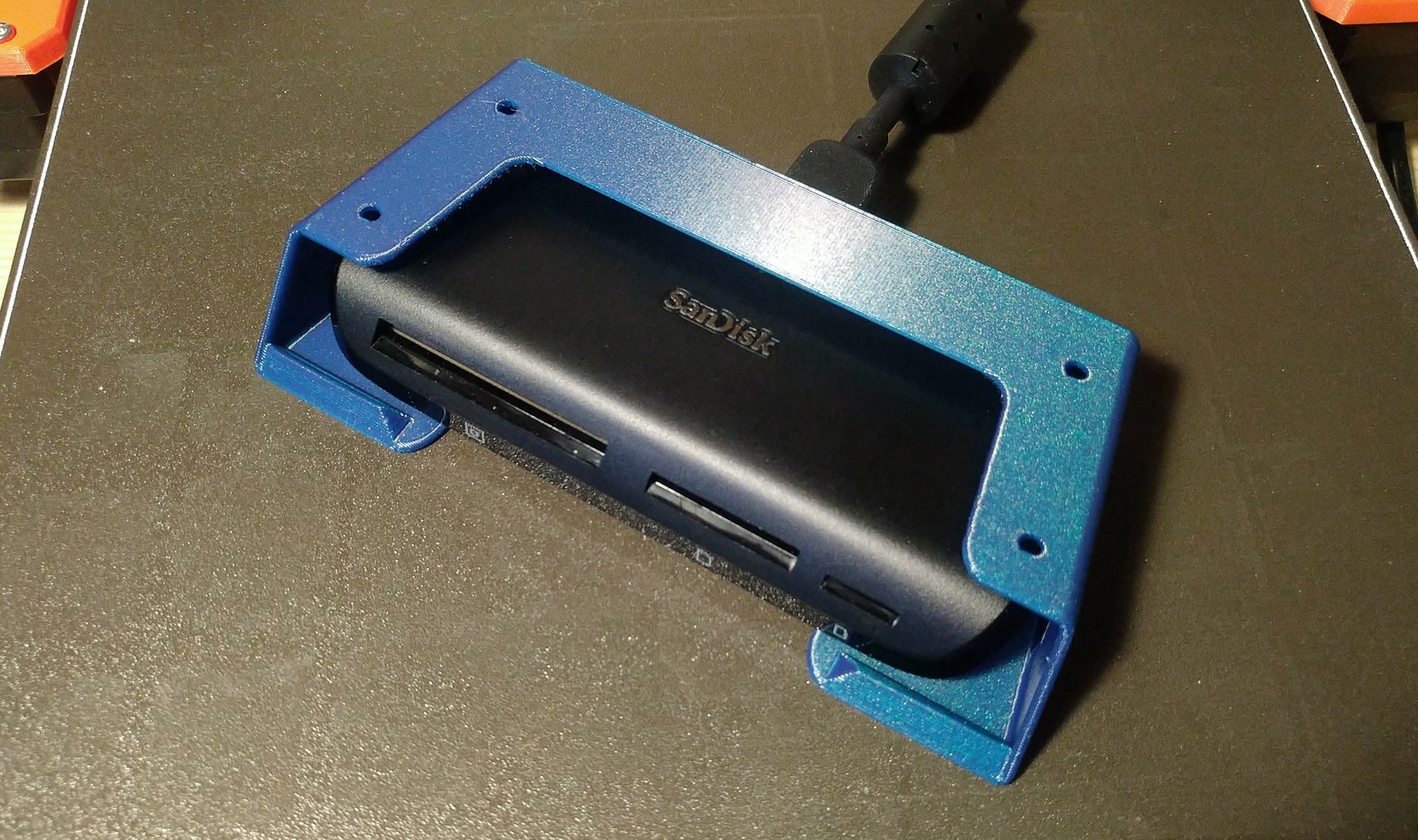

Console for a SD card reader
