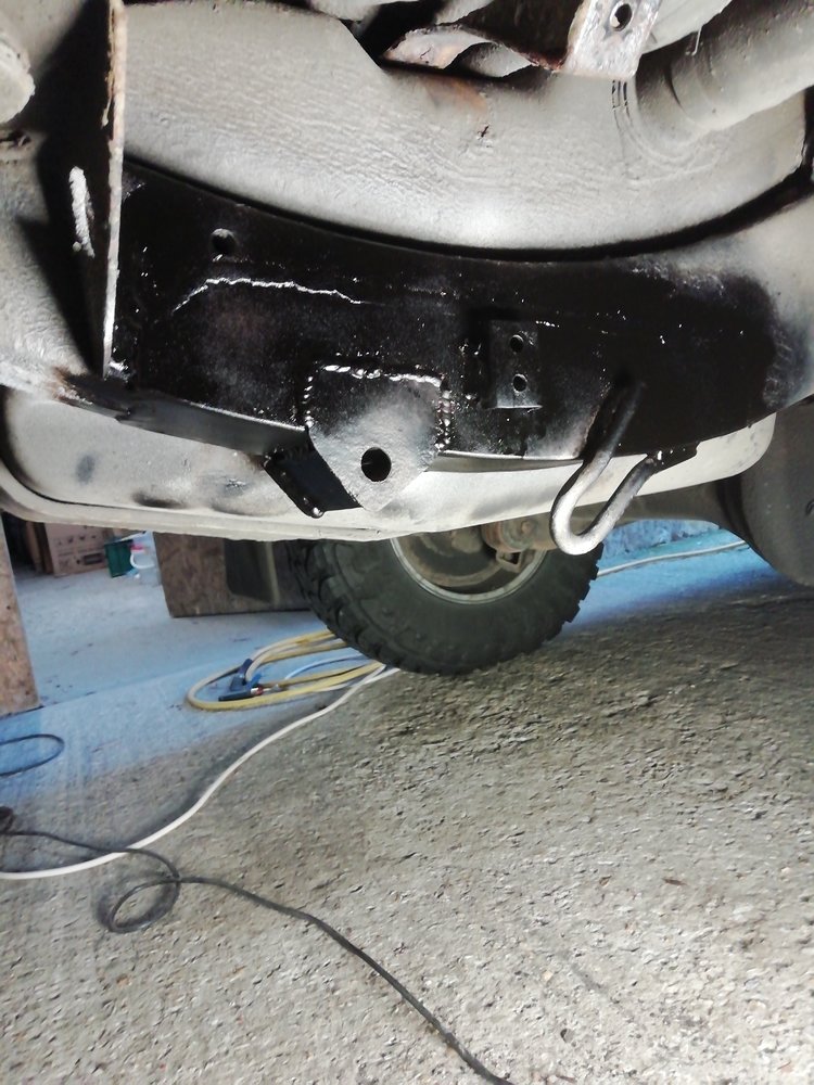

Nice one. Well doneCompletely assembled my car and put it back on the road.
Clutch and crankshaft seal
Cost less than 70 euros instead of 300
I believe that a week spent on my car and under the rain has been worth

I believe that other than the money saved , it has much more value to have learn something during the process.Nice one. Well done![]()
