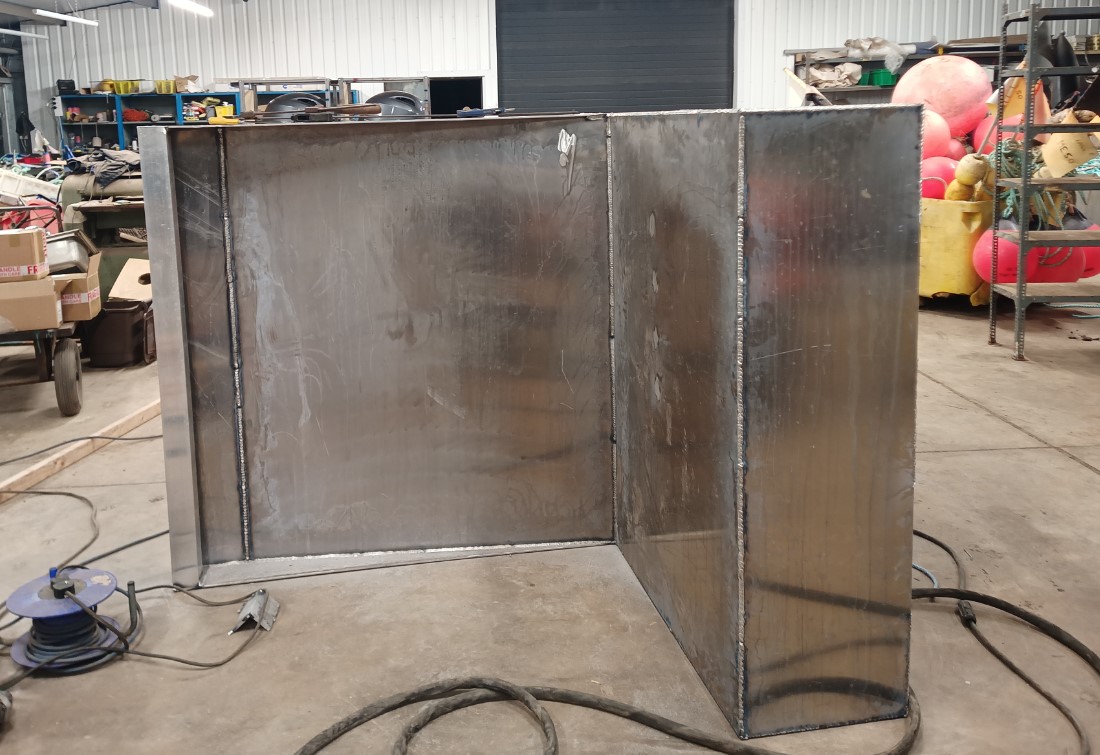

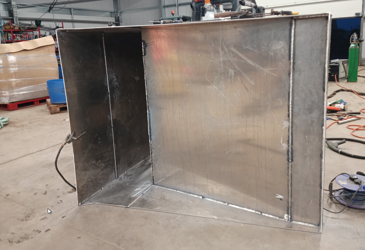

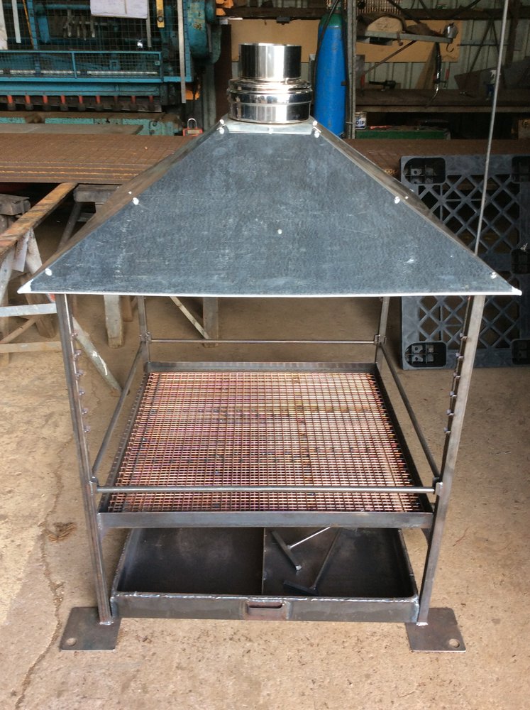

Never made it up to the hopper until today, got it finished so just need it brought down to Arbroath then a bit of fitting to the boat and I am done, hopefully

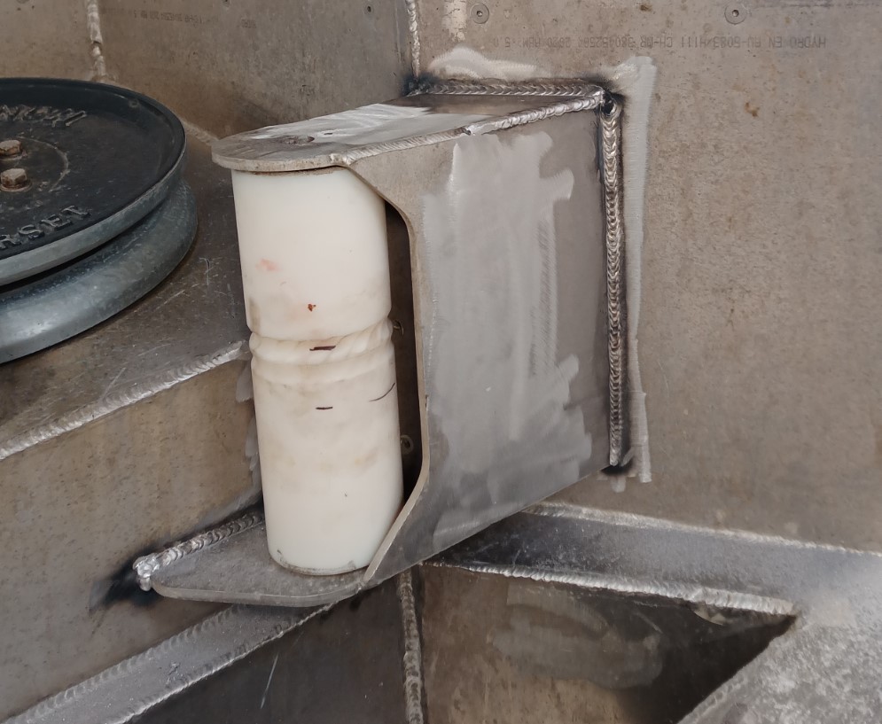

The four gussets welded in, 12mm 5083
Got the table welded up and funnels welded on. Also sliding doors fitted.
And with the table folded up.

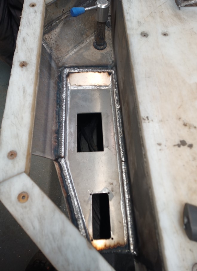

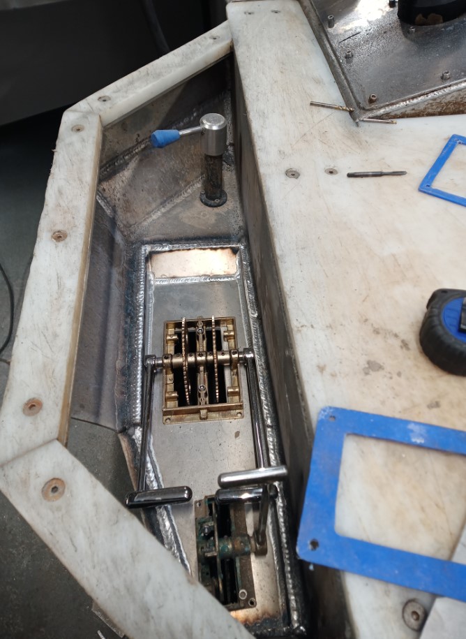

The guys will bring it down for me first thing in the morning but I will then go back up to do some alterations to one of their boats so this afternoon I cut and welded up a bit to lower the throttle/gear controls as he is putting ones on with longer handles.
I did this on one of their other boats recently and it made a big difference to the ease of taking the boat out of gear due to the extra leverage the longer handles have.
To save altering the whole console I made up this bit that will fit into the hole I cut in the top of the current console.

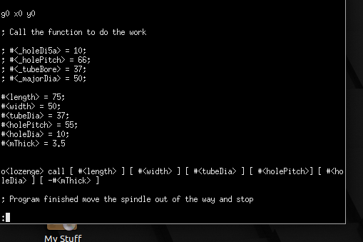

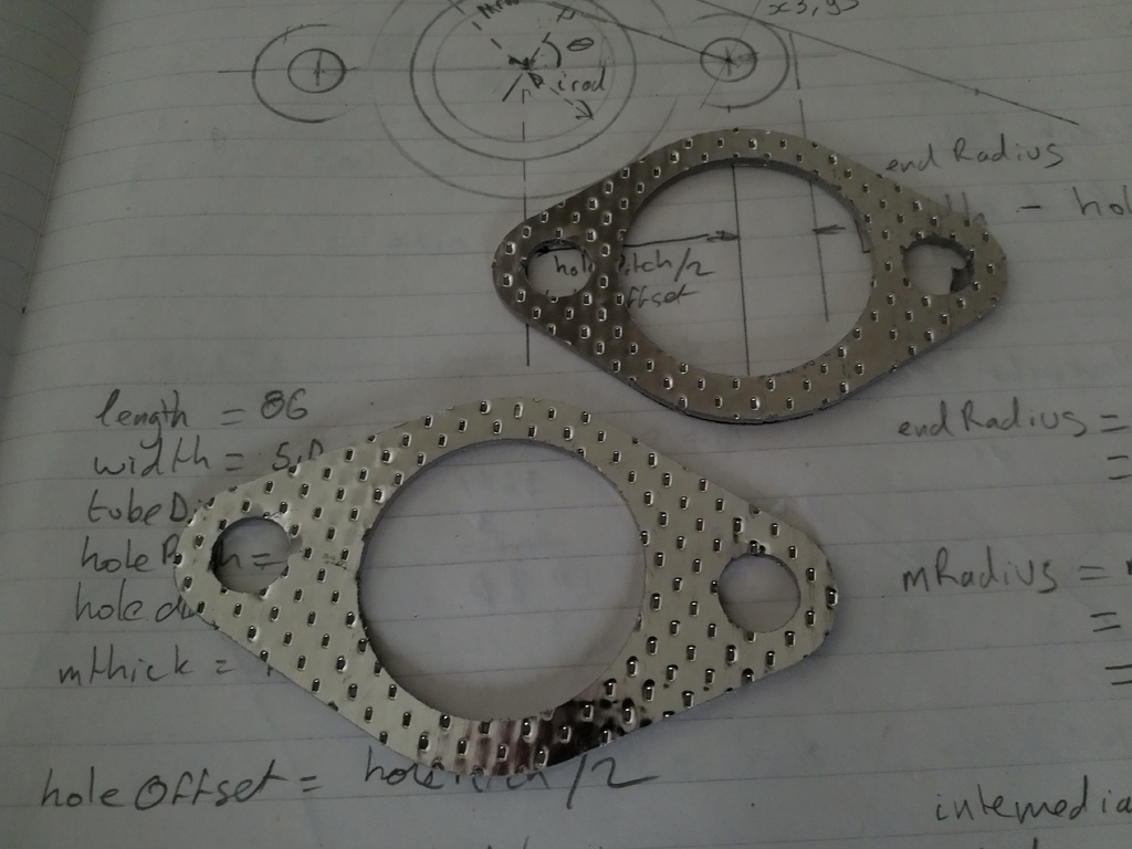

and yes, I called the function lozenge because I may want to have different shaped gaskets in the future...
The server I was using for running LinuxCNC went pop when I turned it on so I had to rebuild the whole thing on another box then tune the machine in. I had the old settings to work from but it was so long since I had built it I also spent a lot of time re-learning what I had done and what I had tweaked. It now works better than it did before but it was a lot of trial and effort for not a lot of improvement.
