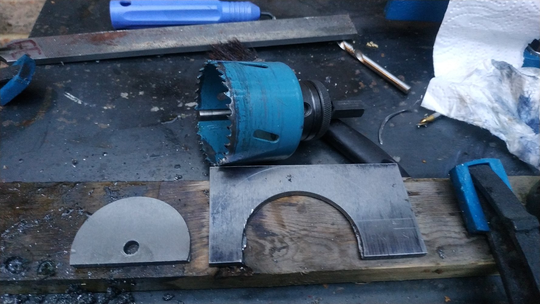

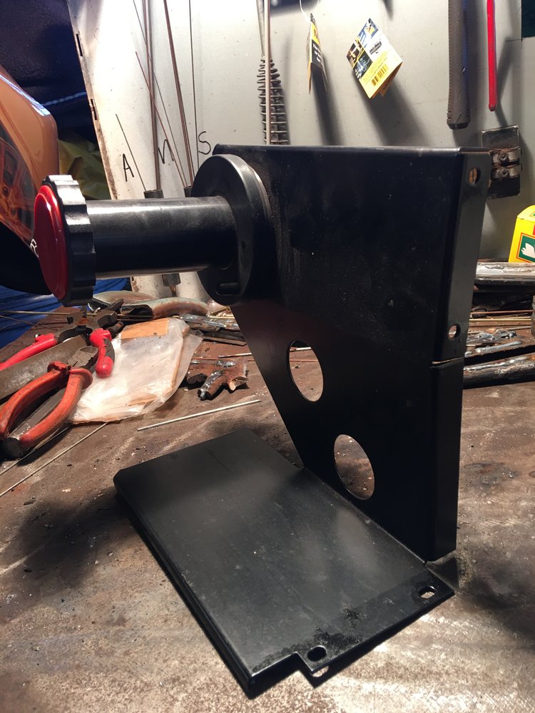

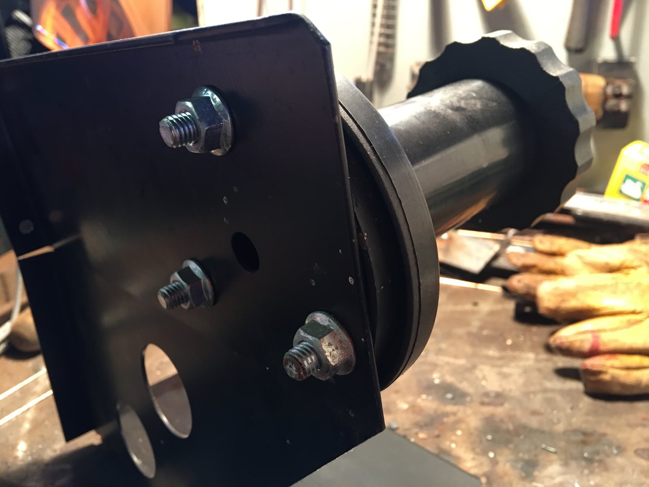

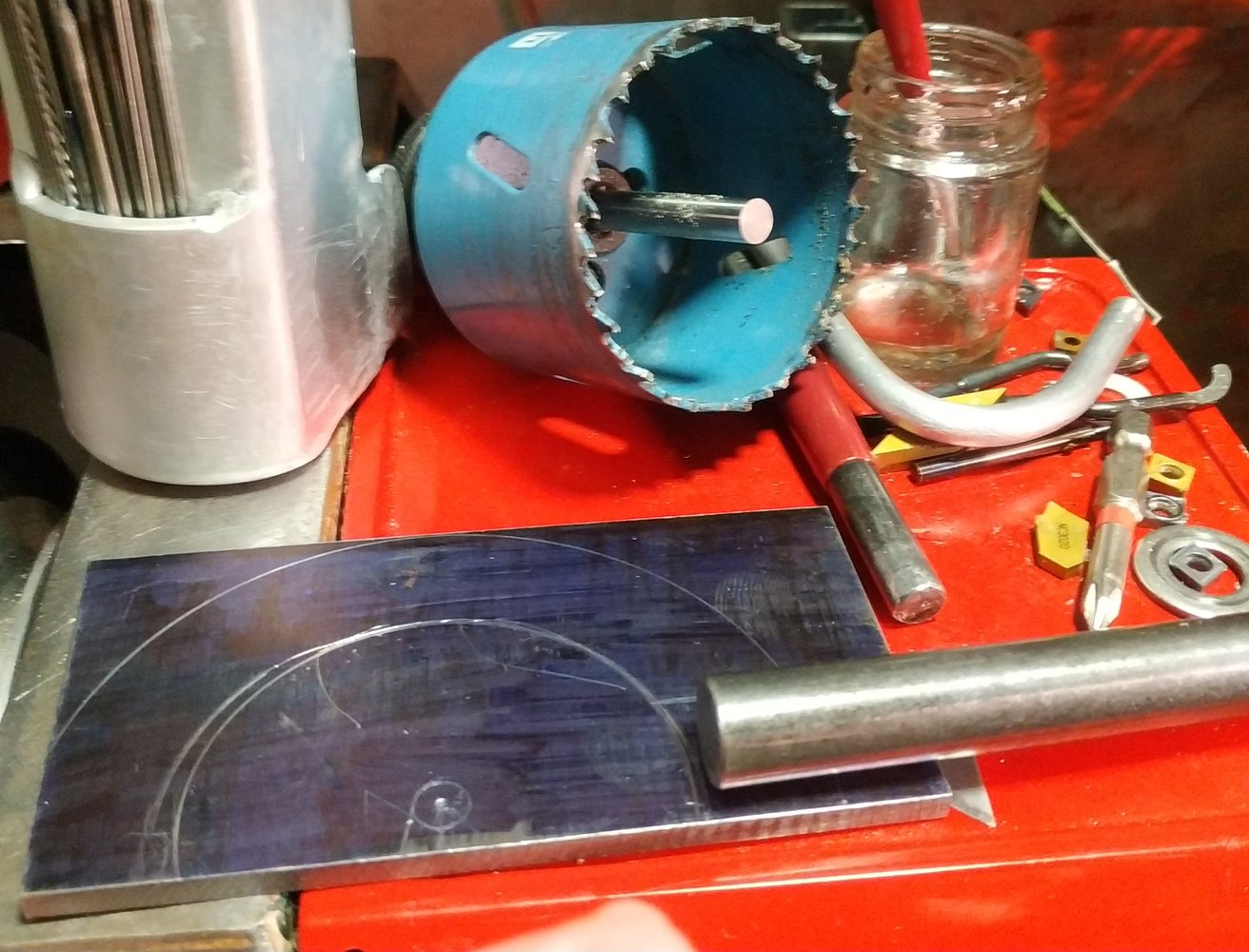

Hello Damian, Long time no see,Here are photographs of my 15Kg wire carrier, It came supplied by the welding set manufacturer ( Butters/Fimer) and attaches to the rear of the welder with 4 X 5mm bolts, Quite a light carrier but amply strong enough, I still have a 12.5 Kg reel of dual shield that you can pick up next time you are in my area, (Nipon steel 1.2mm AWS A5 20 E 71T 9M-J)Today I made a contraption to see if I can get 15kg rolls to work on my mig.
The idea came from @gordon stephenson who has something similar on his mig. (I think)
I've an Rtech MTS250 and it takes 5kg rolls of wire.
It's a 250 amp mig and can burn a 5kg roll in short order.
Also I wanted to try dual shield mig and I have a few part rolls which are also 15kgs.
This is just proof of concept, because if the feed mechanism isn’t up to it, it's not worth pursuing.
Started with couple of bits of 40mm angle and flat bar.
Turned down a 10mm bolt and an old skateboard wheel to preform axle duties.
Then fitted to the top of the welder with neoprene packers.
An off cut of torch liner, some 5mm bar, more neoprene for back tension, a couple of vice grips and a few cable ties complete the "thing"
It seems to feed wire ok, I will see if it welds tomorrow before I waste any more time on it.
View attachment 317512View attachment 317513View attachment 317514

It is the MTS255S which is a different from their standard Migs being that it is Mig Tig Stick, hence the initials.Is that a 250 or a 180? neighbours got the R Tech 250 and a 15Kg spool fits inside, he upgraded frrom from the 180 and that only accepted 5Kg spools inside.
