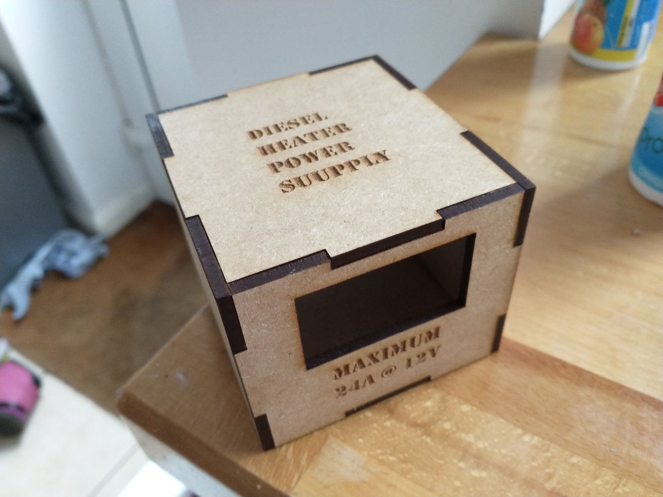

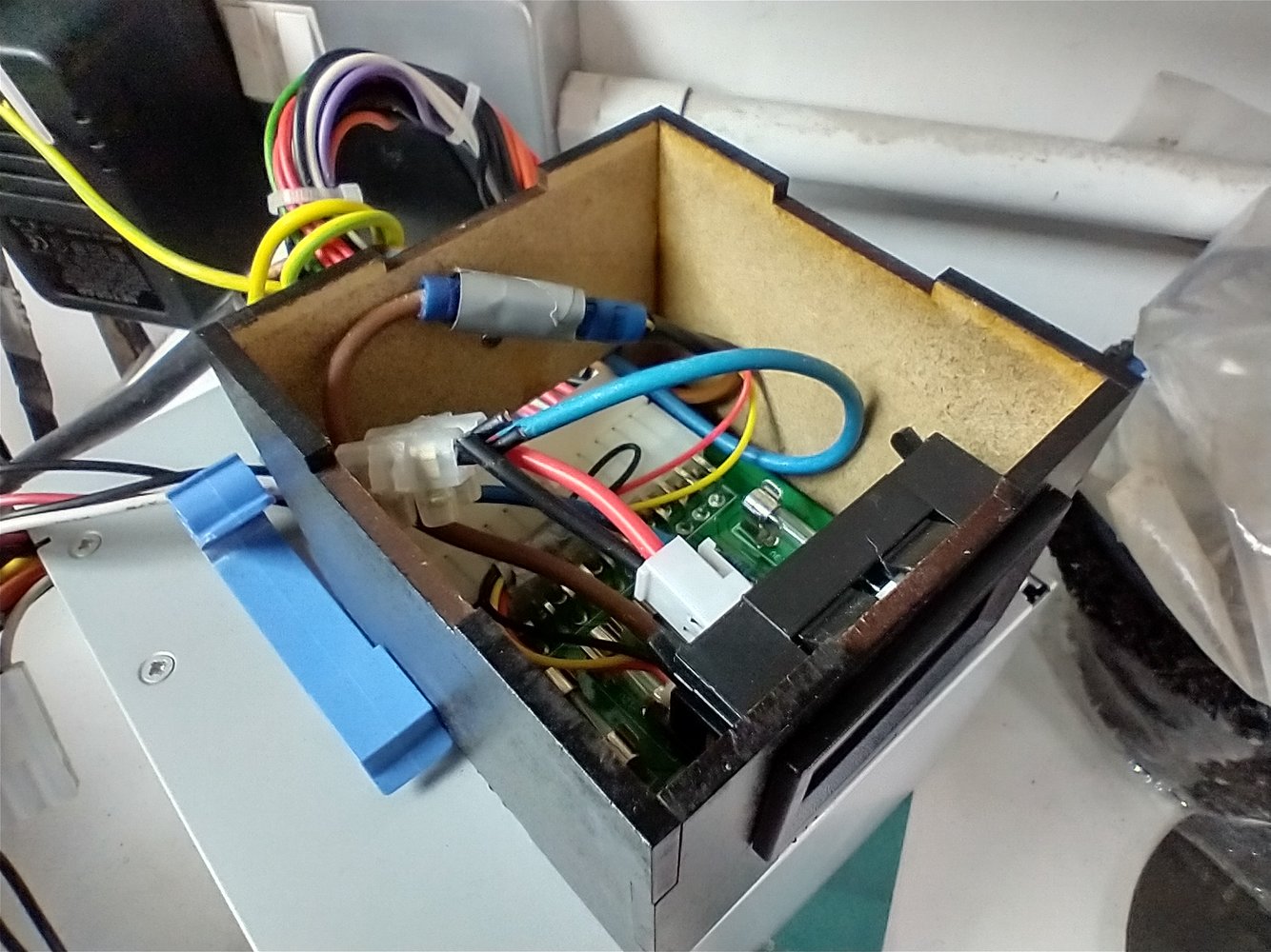

Another laser cut box for the diesel heater ATX supply. Spot the deliberate mistake...
Added a few coats of spray acrylic and added the ATX breakout board and meter
Looks okay. The "high current" lead provided to the shunt is more of a resistor so will need to revisit that's it gets warm when the glow plug is on!

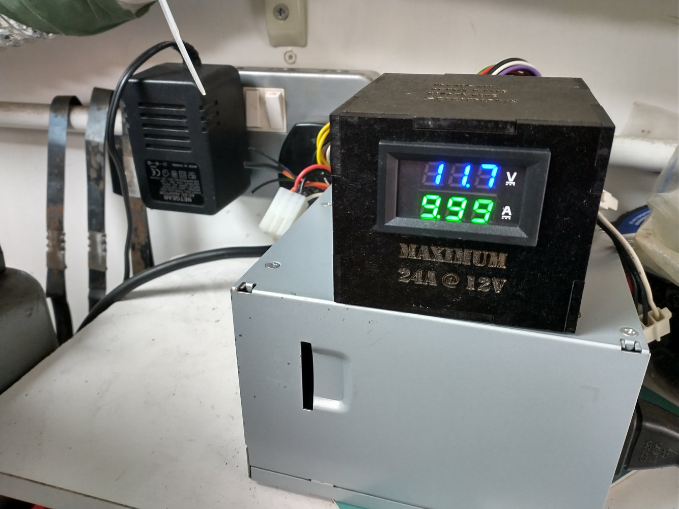

Meter is maxed out when glow plug and fan are going full speed. Might see if I can get a higher power meter in the same size as it useful to know what the heater is doing.
