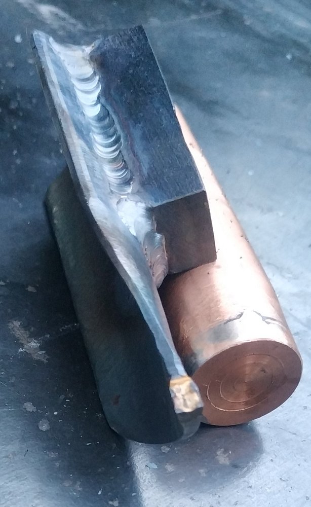

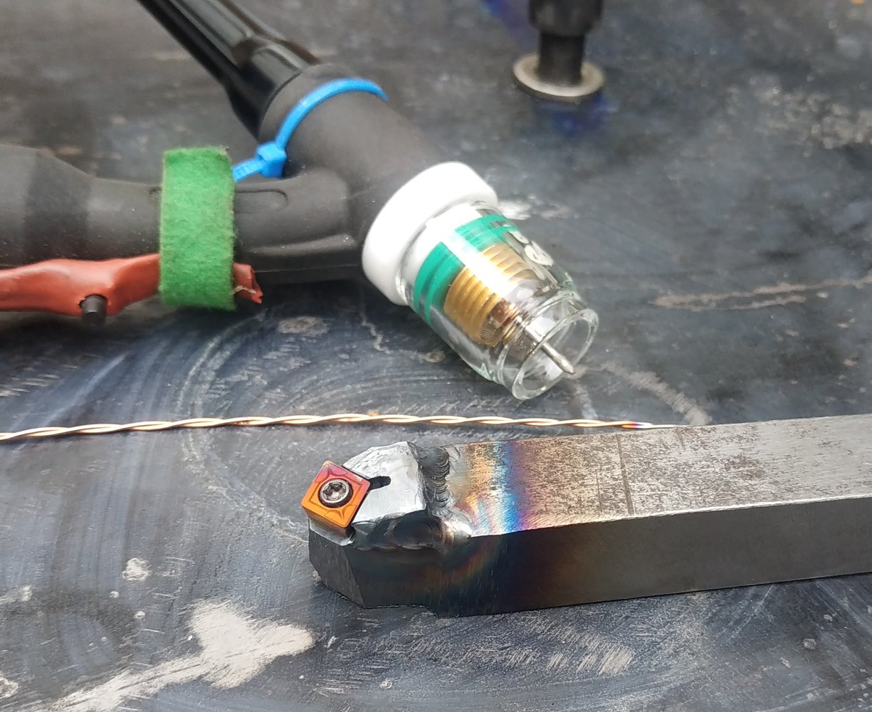

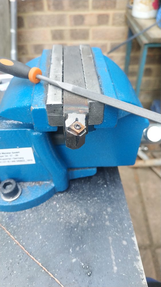

I got a control handle in to repair.
I was going to vee it right out, fully weld then bore/tap but when I took it apart it had a helicoil in so I wondered if I could just weld it the way it was. Vee'd it out a bit and clamped to a chunk of steel.
Filled it up with weld.
Ground flush and it seems to be doing its job.
Next up was a steel hauler knife, both sides worn, normally I would tig but decided to give the wee stick welder a go on pulse and see how it performed.
Seemed to be fine so after 5 or 6 2.5mm rods I ground it down.
Repeated on the other side.
Job done, not sure if it was much quicker but I was wanting some messing around with the pulse function as I haven't had much chance to use it since I got it earlier this year.
