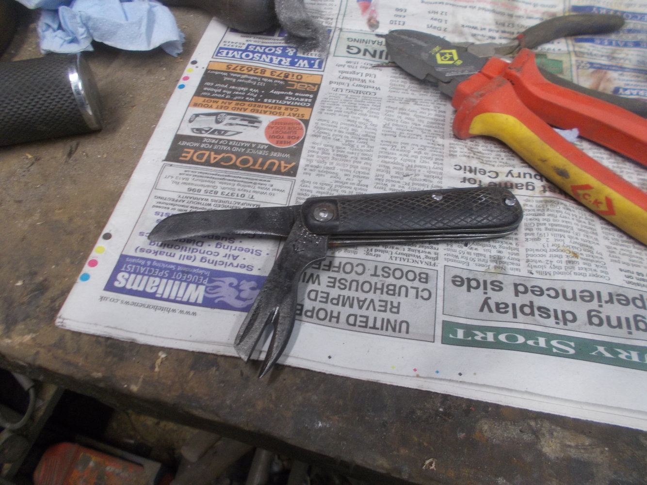

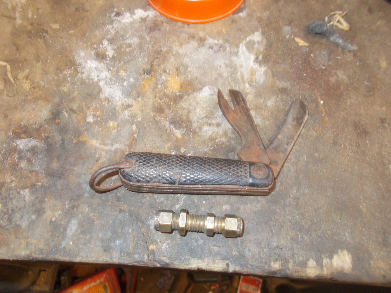

Bit of fun the last few days.
I got this penknife a few weeks ago, it sat around for a bit, so the last few days I have striped it and cleaned it up. Only to find a surprize.
The case was swollen with rust, the loop was broken and the blade was curved from years of sharpening.

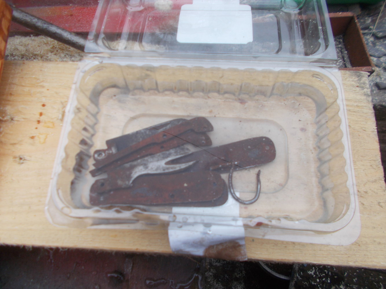

Broken down into bits and left in Citric acid for a few days.

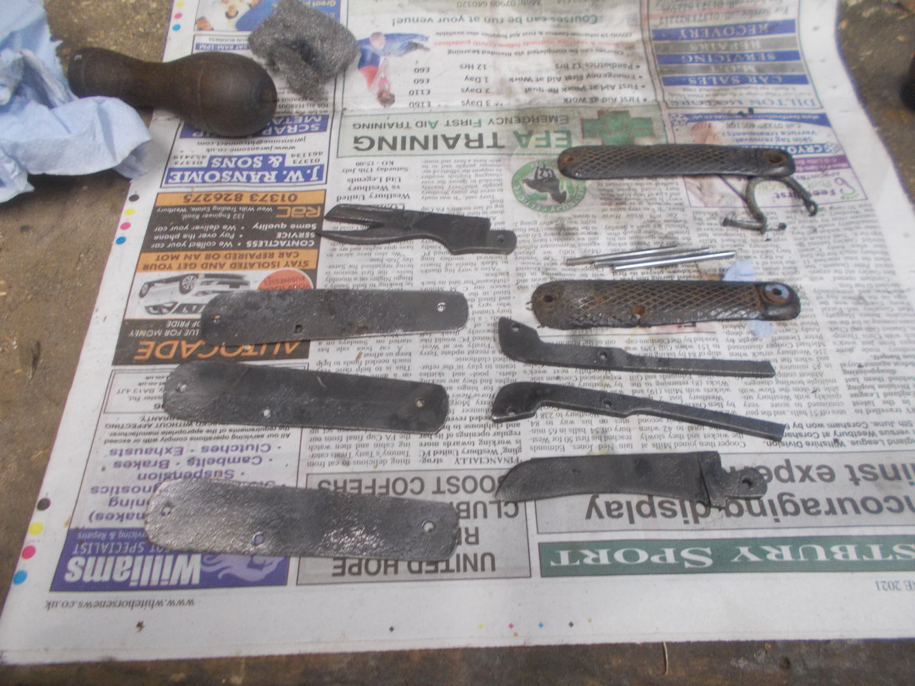

When the metal parts were cleaned up a Government Broad arrow, a date stamp, a name and a Ships Book number was found, on different parts.
Plus some soft metal bars to make new rivets.
RHS Third and fourth parts form the blade springs. The look identical, but they are not. So it is best to make sure you know what spring goes with what blade.
Assembled and new edges onto the blades.
The Royal British Legion have ben sent an E mail to see if we can get more details on the owner, with luck return it to the family.
