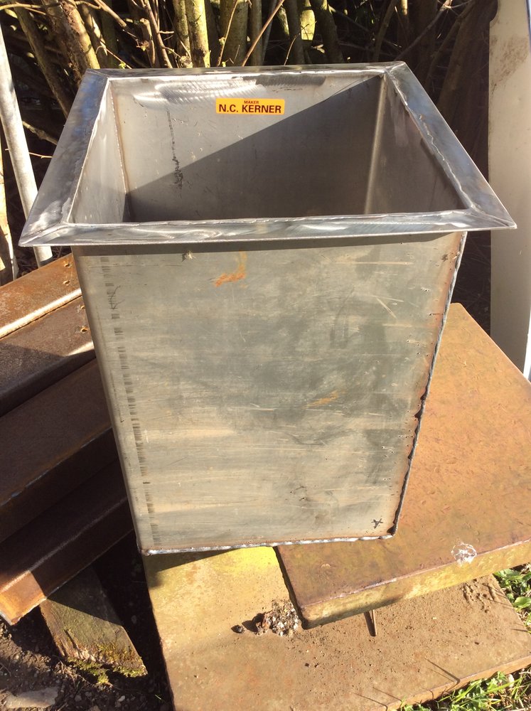

Must be a small boat if it fits in thereA stainless steel store box for a sailboat.View attachment 296353
Beat me to it!Must be a small boat if it fits in there![]()
Miss read the purpose of it .What would that be welded like ?

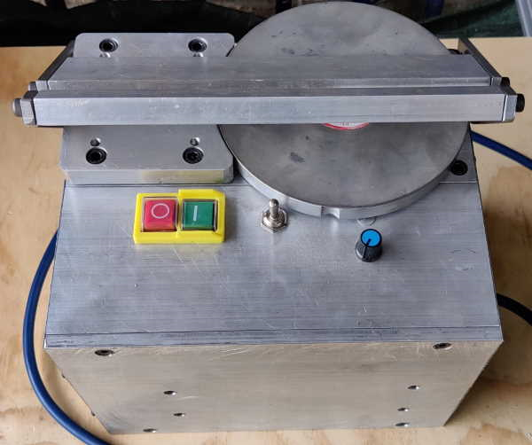

The woodwork shop had a bigger version of that at school. Disc was around 40cm and set up like a (old) record player. Post off one corner held the tool clamp which swung to even the wear. Ace for plane blades.A bit more progress on the slow speed grinder today. I started by making the four pillars that hold the gearbox assembly above the electronics housing. That enabled a quick test fit:

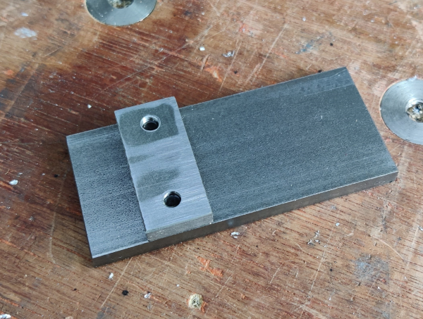

I then put one of the plates on the mill and hogged out a load of metal to allow me to fit the switchgear.
With hindsight, I should have thought about this a bit more (or modelled it in the CAD or something)...
A quick test fit of the electrickery onto the plates:
If was at this point I remembered that the spinning disc hangs down over the bottom panel and hence would hit the potentiometer.
Back onto the mill and I drilled another hole so the pot could be fitted the other way up. I then made a little hole filler out of some aluminium round bar.
Et voila:
It's a bit cosy inside around the front panel, but it's not too bad:

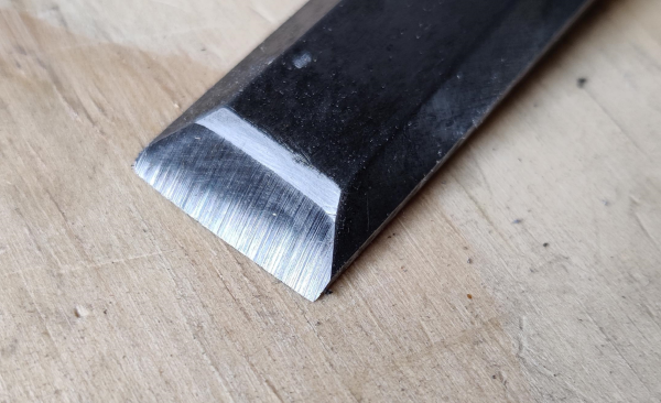

I still haven't modified the table to give a bit more clearance and I need to make a cover before fitting the table. In the meantime, I couldn't resist a little play using the reference surface (which I'd previously adjusted to be level with the grinding disc) with a honing guide to reshape and sharpen an old chisel.
I had a play putting a secondary bevel on (I'm not sure why, I was just experimenting) by putting the honing guide on a steel rule. I should have picked a wider rule as I wobbled off the edge so the secondary bevel is a bit wonky, but it worked and that's the main thing:

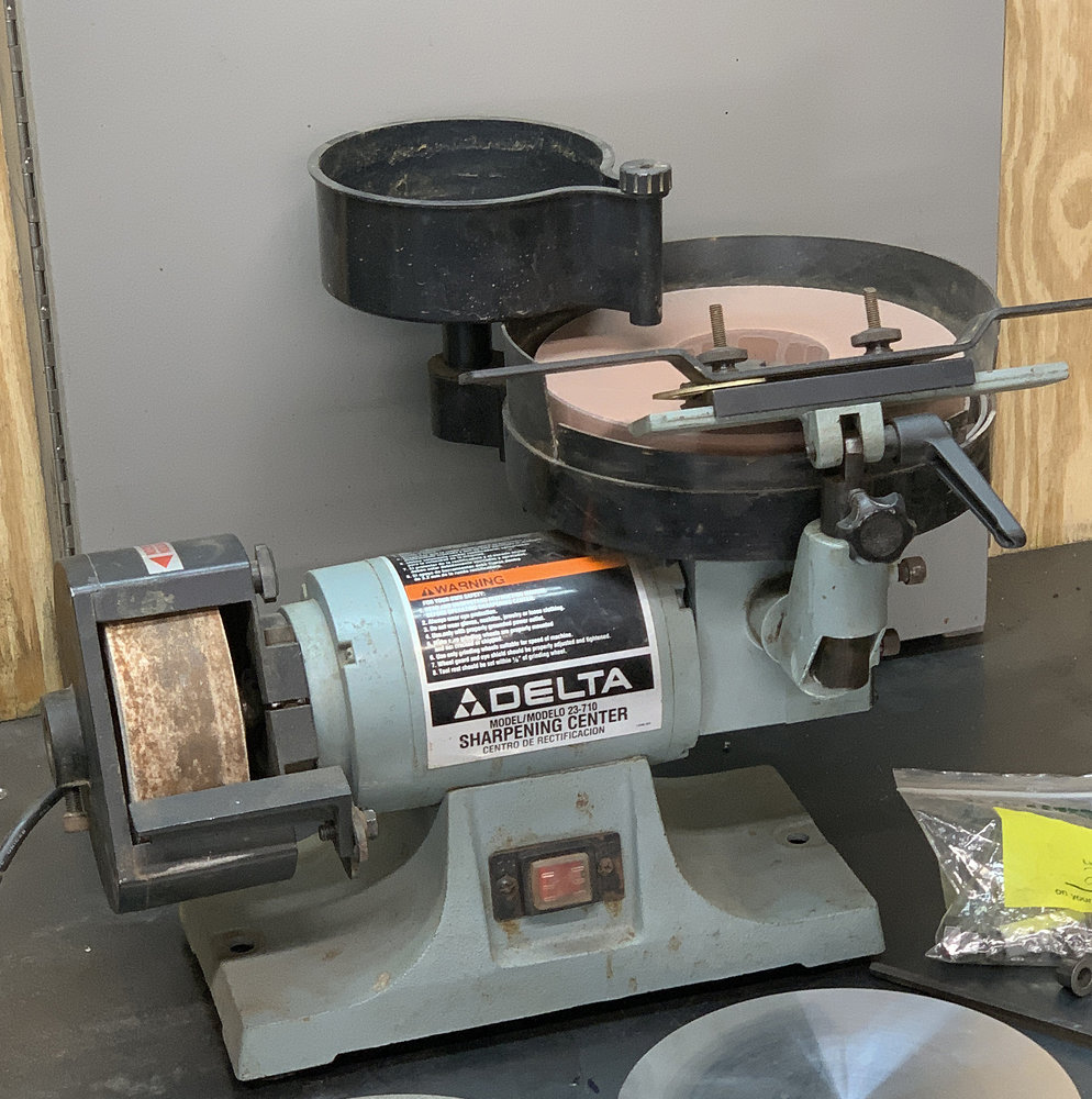

On the subject of sharpening stations and honing guides, I have a benchtop sharpening station with a horizontal honing wheel with a water drip and an adjustable-angle sliding tool rest/holder. While it's not quite as fancy as the Viceroy, it works well, and my planes and chisels are happier now with their bright new edges and backs, especially after I gave them a light touch-up with a finer stone. The adjustable orifice in the gravity-feed water drip works well, although the drip rate is more consistent if I keep the reservoir at least 2/3 full. I haven't used the left-side (dry) wheel yet, as I still need to order a replacement eye shield for it. The wheel guard for the left-side wheel can be rotated, and the tool rest/holder can be detached from the right side (horizontal wheel) and moved over and attached to a socket in the left-side wheel guard, which I think will be very handy for doing the initial grind on badly nicked blades. If I recall, the horizontal (wet) wheel is 1,000 grit, and the left-side (dry) wheel is 120 grit. I picked this up from a local bloke for $40 who was downsizing his operation.I still haven't modified the table to give a bit more clearance and I need to make a cover before fitting the table. In the meantime, I couldn't resist a little play using the reference surface (which I'd previously adjusted to be level with the grinding disc) with a honing guide to reshape and sharpen an old chisel.
