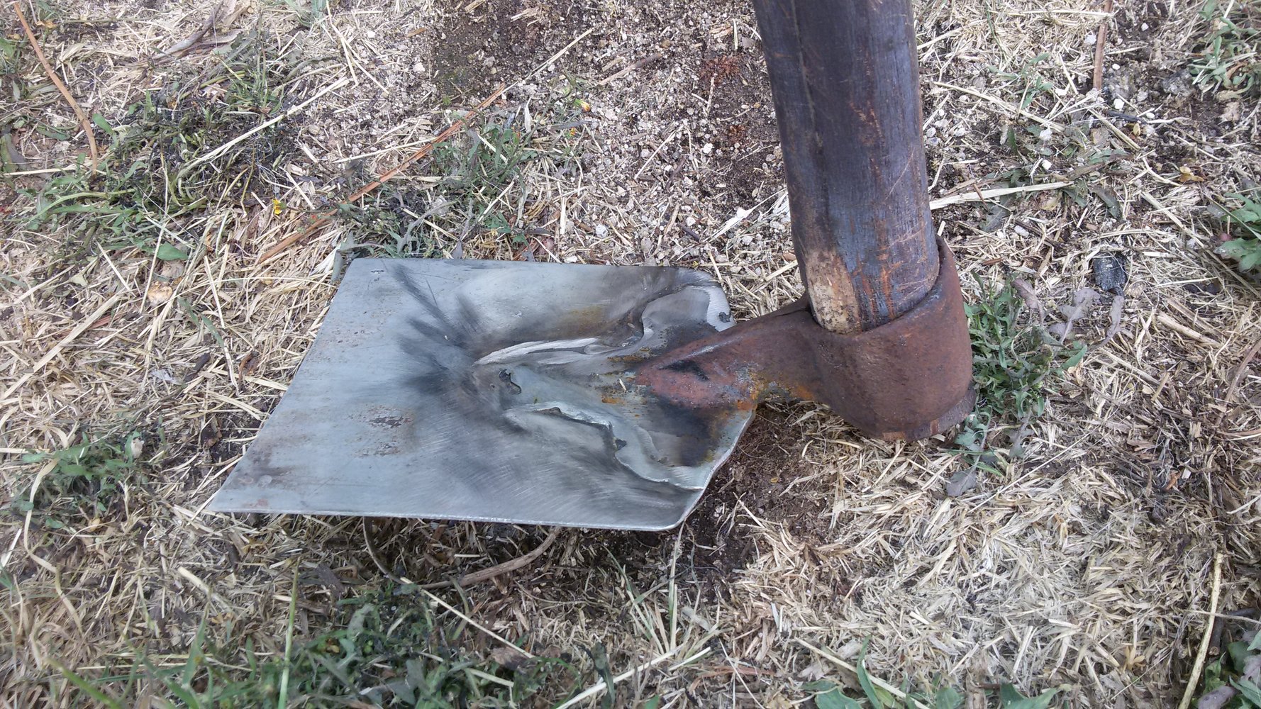

Made a pickaxe this morning.
Or better put an handle on it (both new bought this morning)
Made a test fit this,made it fit as best as possible.
Then heated up the eye with a propane torch , until it stopped smoking (oils from the hardening process) ,drived the handle using the pickaxe weight itself , I've then used an hammer to finish it up .
Then quenched to make the eye shrink on the handle.
I was wondering to put a stainless steel thing to protect the handle near the head but ,I didn't want to break out the welder and the grinder or whatever thing Id have needed to make the thing.
I can still make it just for aesthetical purpose.
Surely I will apply linseed oil on the handle, maybe an hole to hang it on a needle
