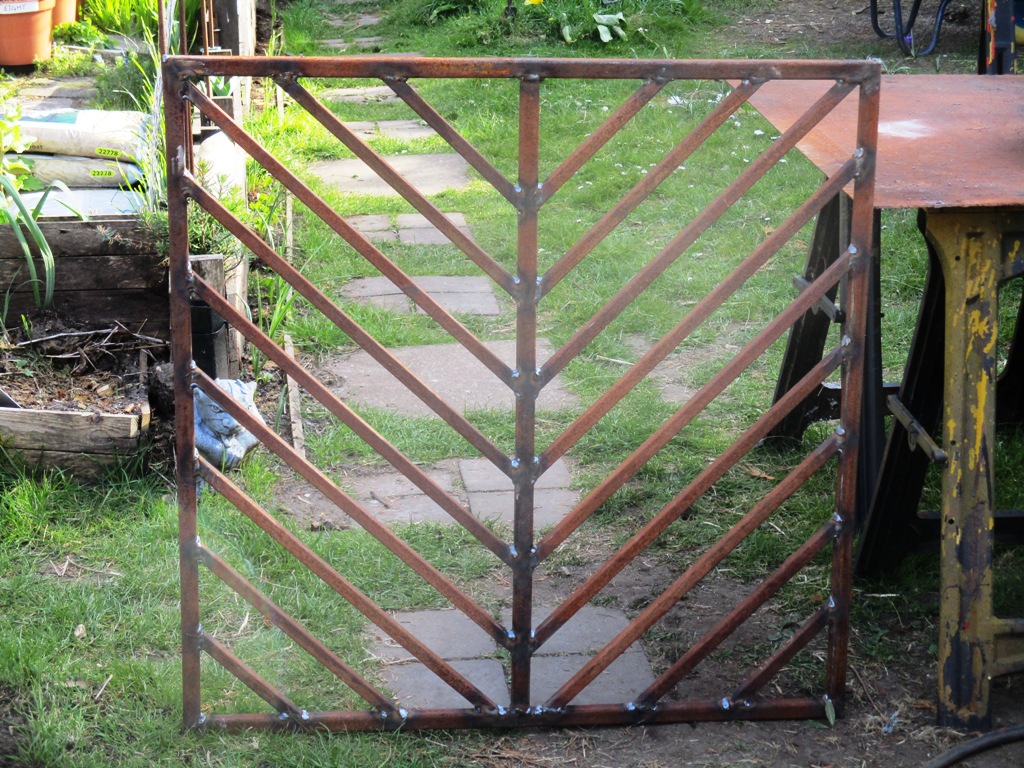

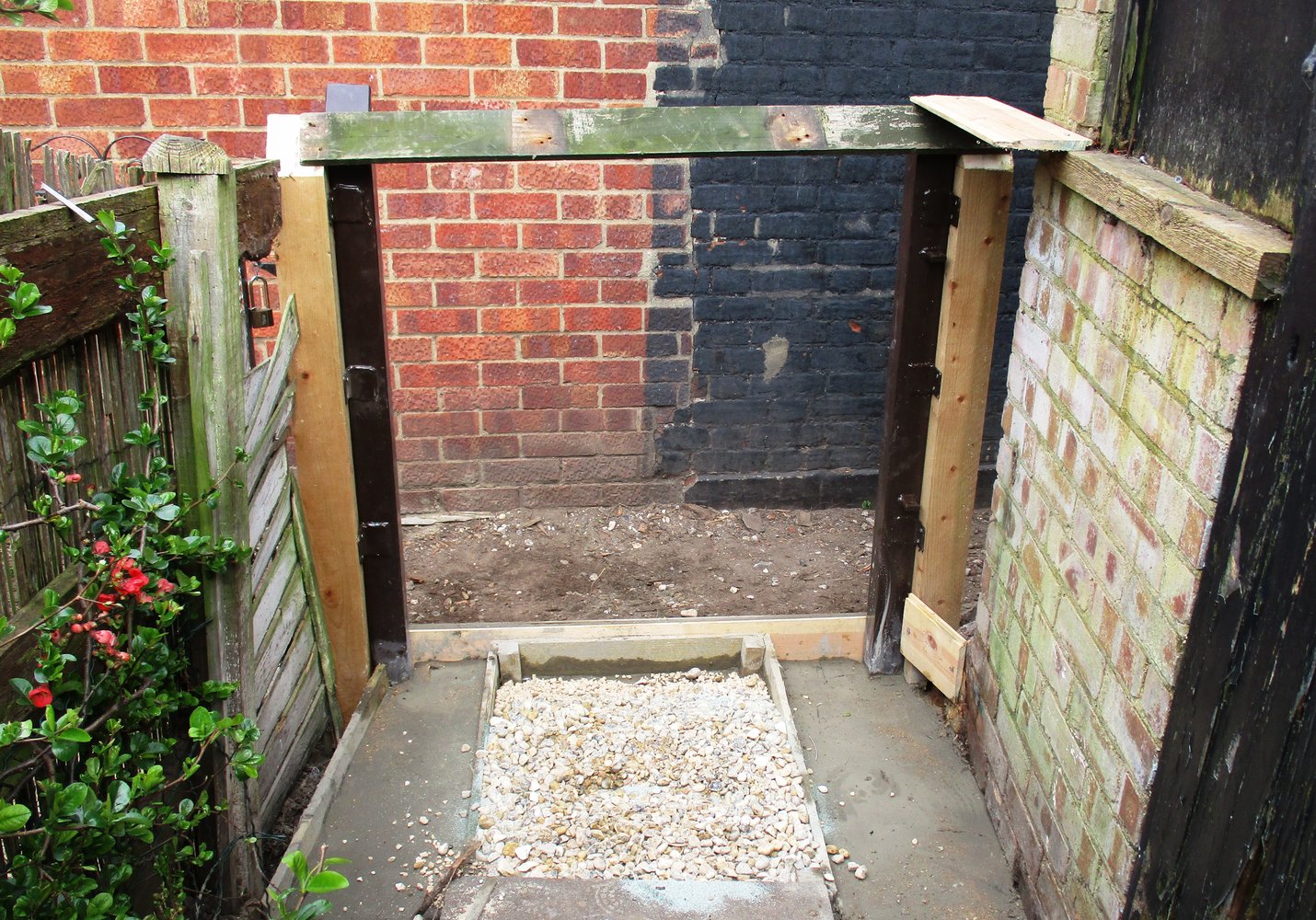

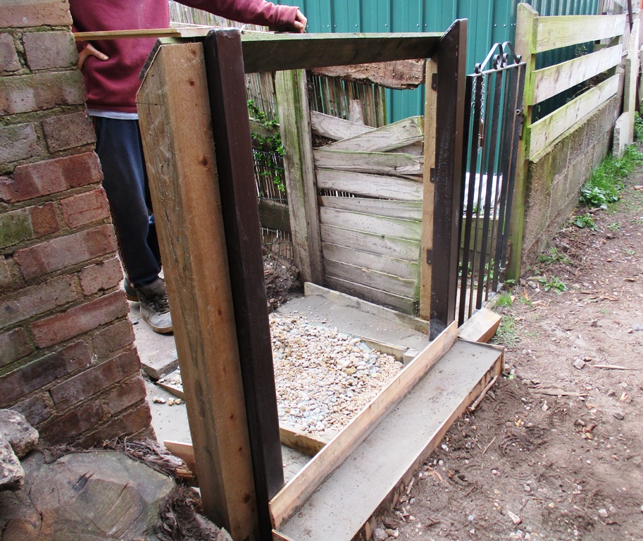

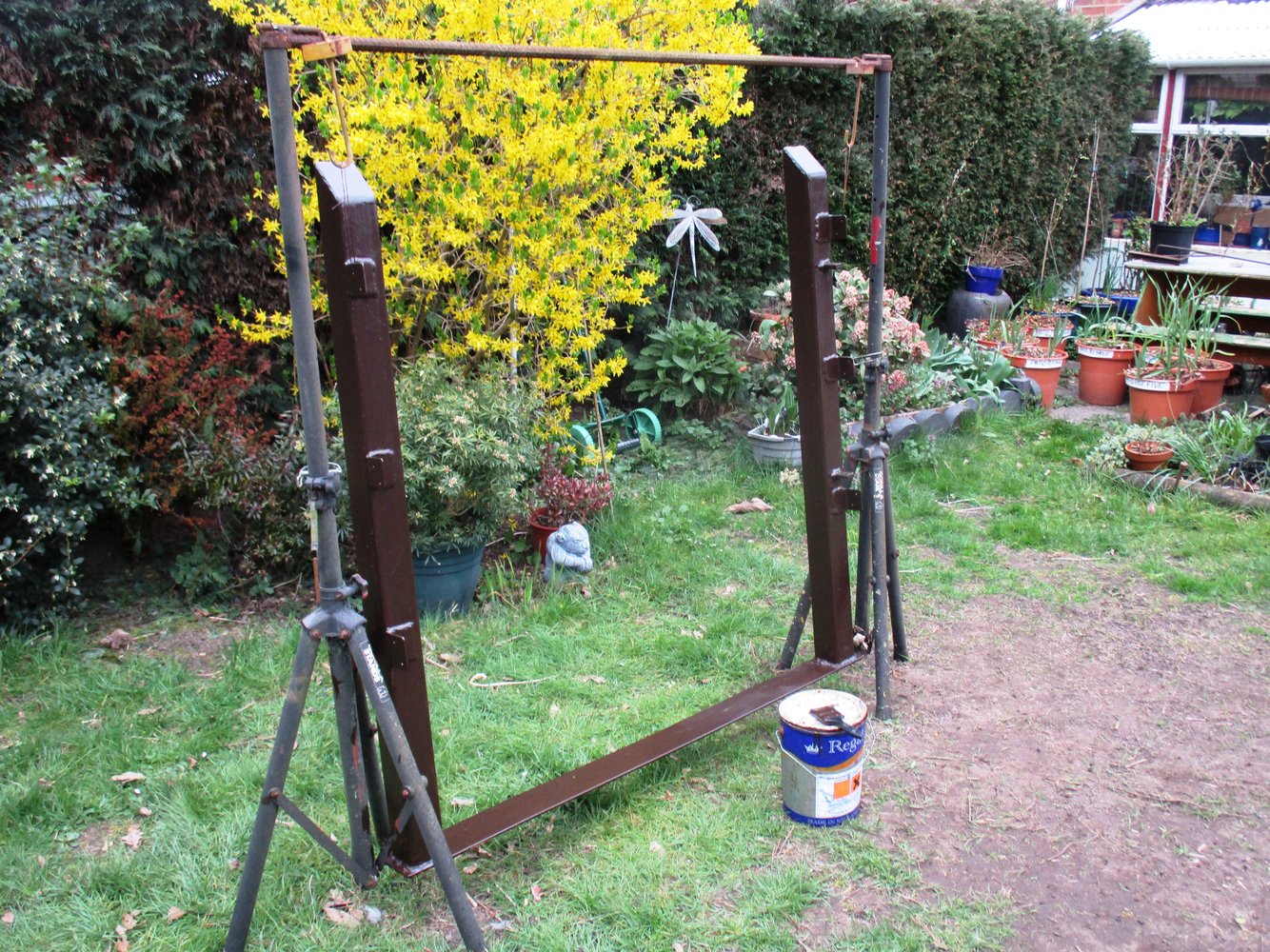

The new 75 x 75 x 3 box section steel gate posts. I've welded them to the 120mm wide flat because of the steps down from the garden to the communal back alley:
On the 1st of April I had got this far:
Rob & Paul did this for me on the 2nd of April.
Unfortunately I became ill again and it was the 22nd of April before I was well enough to start on the gate and the frosts had arrived her in Norfolk.

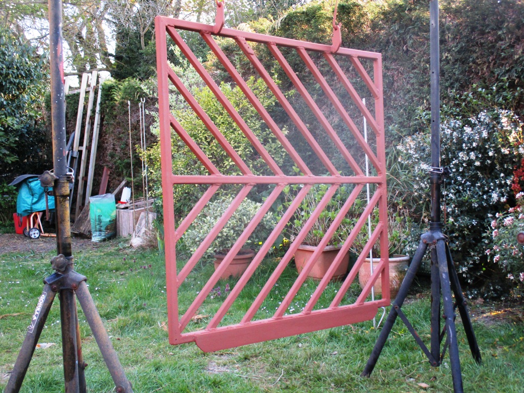

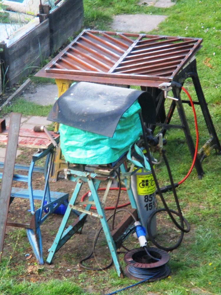

I set up a temporary work station in our garden and because Hannah was wanting to put her house on the market I decided to use some rusty old new stock that had been left uncovered and open to the weather outside my workshop for 15 months due to my illness.
05.45am on the 23rd of April, it's -2°C out there and the steel for Hannah's new garden gate is covered in frost.
It's 06.30am on Saturday the 24th of April, it's -2° C and the frost is beginning to lift.

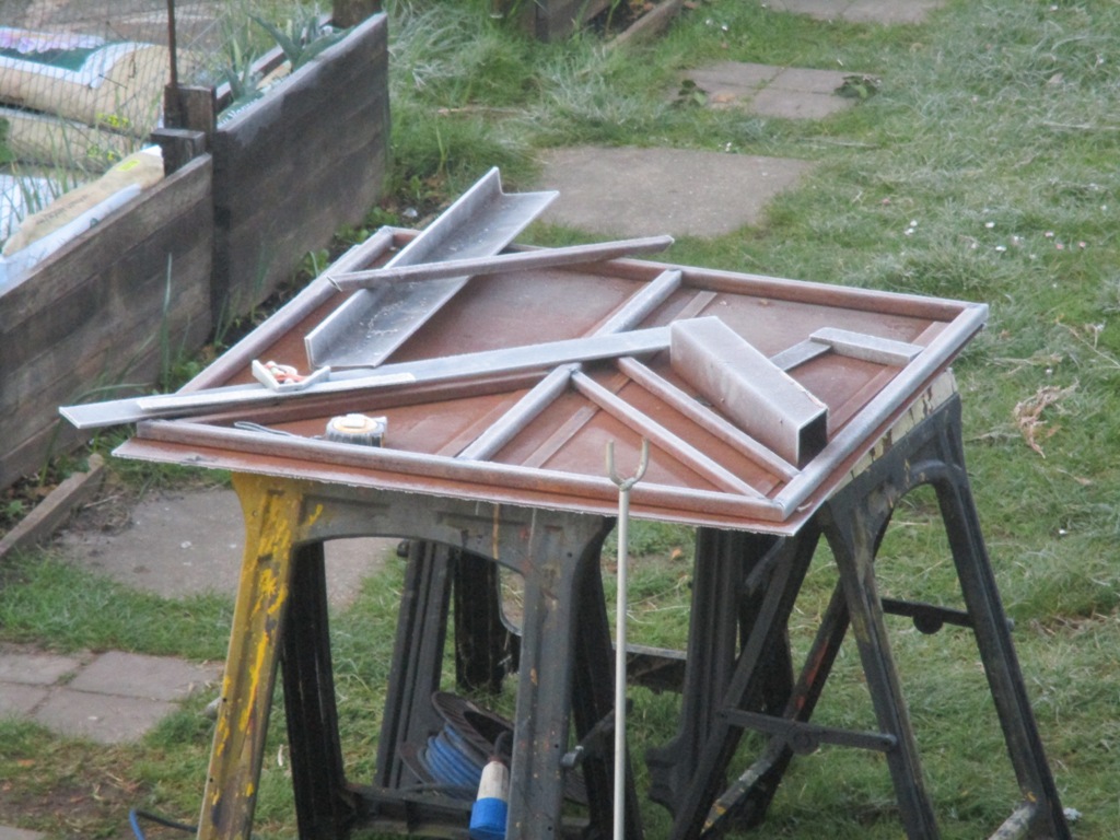

The main fabrication has been done and in about two hours time I'm going to position and fix in place the the stop plate and hinges and drill and tap the holes for the return spring and catch.
My trusty R-Tech 250-1 mig welder has been left out all night under that green garden waste bag.
I can only work for about 30 minutes, I rushed and only rested for about 1½ - 2 hours between sessions. It took me all day to get to this stage and I made a school boy error: can you see it?

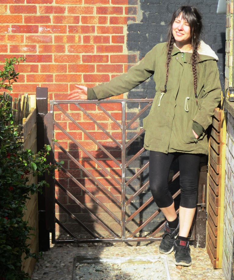

My adopted daughter Hannah stood proudly with her new gate at the pre-completion fitting to ensure everything is OK before painting it chocolate brown and final installation ready for her house to go on the market.

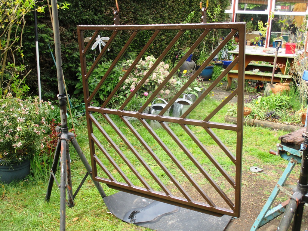

Back at ours and after a lick of ready Oxide the chocolate brown gloss has been applied.
View attachment 293323View attachment 293324

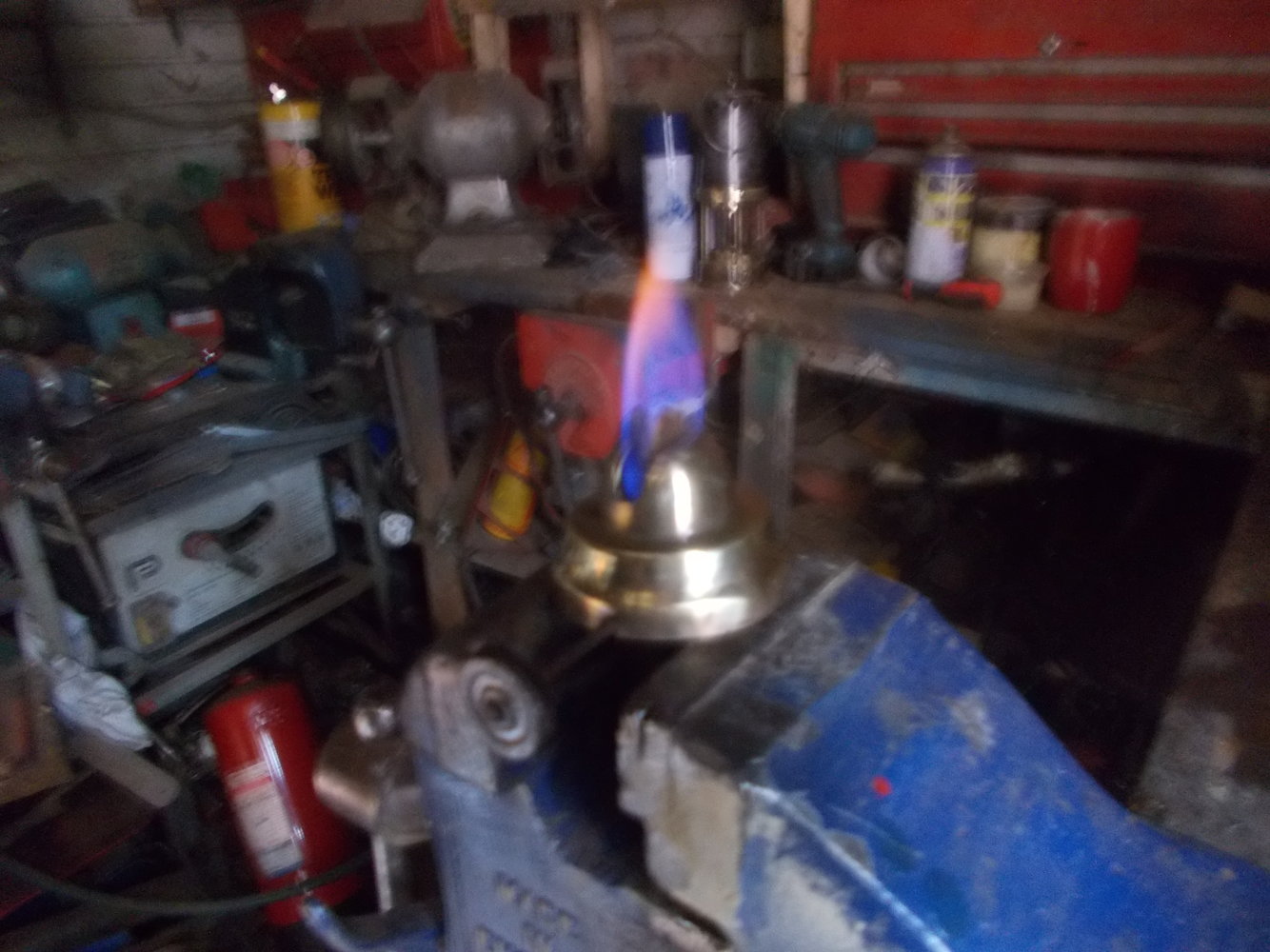

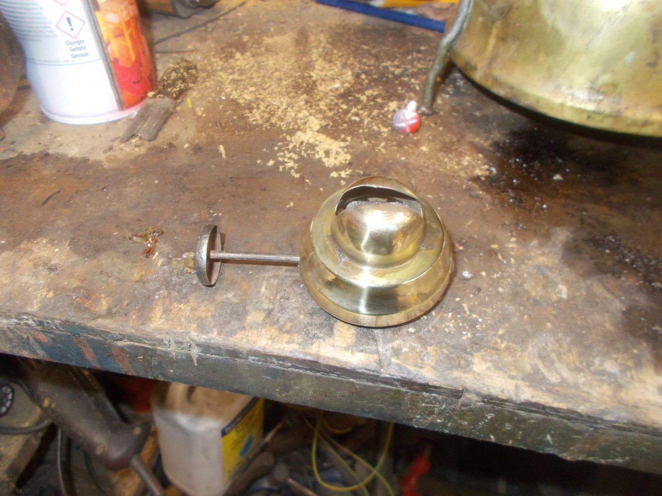

Parts ordered during the week, on a works slow point.I'm always amazed at how you take something that looks crappy, and turn it into something desirable. And it never seems to take you all that long, either... I assume you're retired, to be able to put those sorts of hours in?
photos @The_Yellow_Ardvark ...Parts ordered during the week, on a works slow point.
Striped Thursday, repairs on Friday evening, paint and more repairs on Saturday.
Small jobs Sunday, assemble Monday and steamed.
Thank you for your kind commit.
Go see my Mamod rebuild @Barking Matphotos @The_Yellow_Ardvark ...
