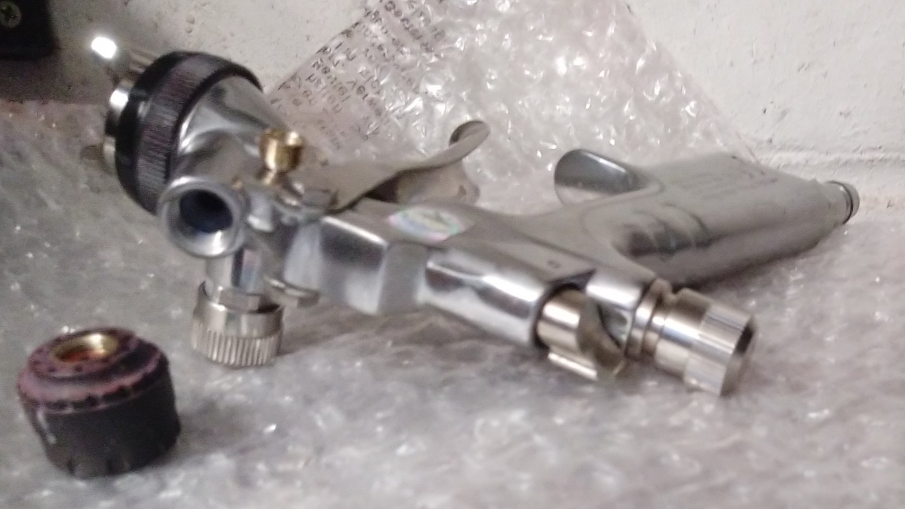

I wanted to try @Dcal 's suggestion of adding tint for the second coat, I risked it with 2g metalic blue basecoat in 75g epoxy. It didnt mix very nicely and sludged up a bit at first - which I then forgot to filter
But it mostly sprayed ok, but a pain to clean gun at the end.Cocked up at end holding the heat lamp too long at the front, it bubbled up
