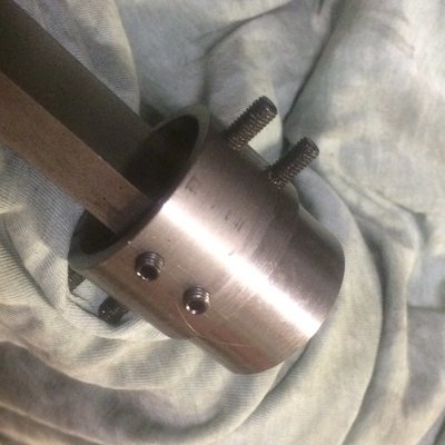

That looks useful. I had to google it though, never seen one before!Made a small cat's head, a bit too thin walled but it is about as large as I can fit in the steady for scale the bar it is around is 25 x 10mm
Will see if it works tomorrow.![]()
Thanks just use the grub screws to clamp the workIt's a fixture for holding odd-shaped pieces that you would not be able to hold in a conventional chuck.
My plan is to turn between centres using a dog with the cat's head in the steady, anyone would think I don't like animals.It's a fixture for holding odd-shaped pieces that you would not be able to hold in a conventional chuck.
Yes, all being well I'll post pictures tomorrow.Thanks just use the grub screws to clamp the work
Need pics deffoMy plan is to turn between centres using a dog with the cat's head in the steady, anyone would think I don't like animals.![]()

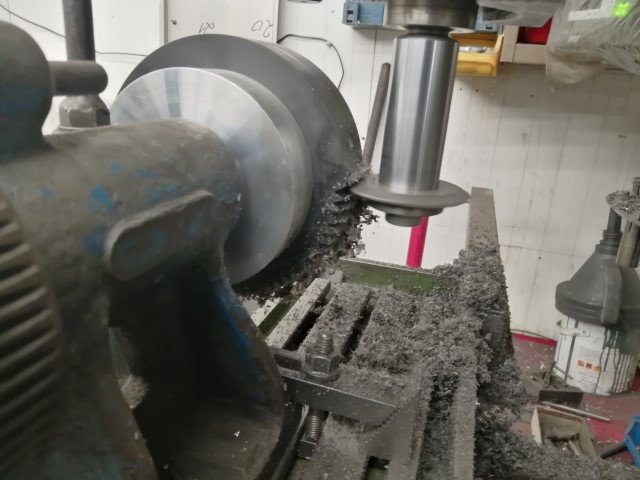

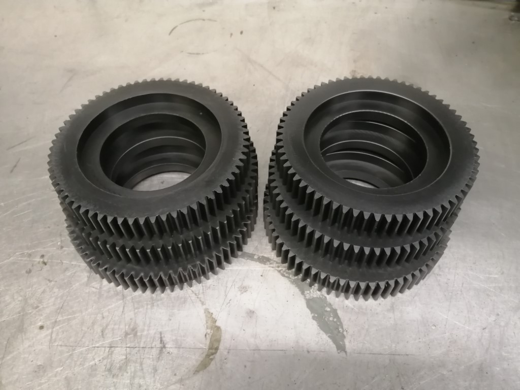

They're beautiful @Pete. What machine(s) did you use to cut the teeth? Something automated I hope?Made some gears from Delrin. These are lathe headstock gears which you can't get anymore. Every once in a while someone else needs one so I make a handful at a time and sell one or two a year, not to make any money since they take so long to make it's not profitable. It's more to help out people who otherwise would have to scrap their lathe or pay silly money - and wait several weeks - for them.
Dividing head and a tooth cutter on a mill?No mate all manual machined. Too big for my hobber.
how do you measure out the teeth positioning? Or is that lump on the left a dividing head?I turn all the blanks then cut them two at a time on the mill. I could cut three or four at a time but if you mess up the indexing you mess all of them up together.
