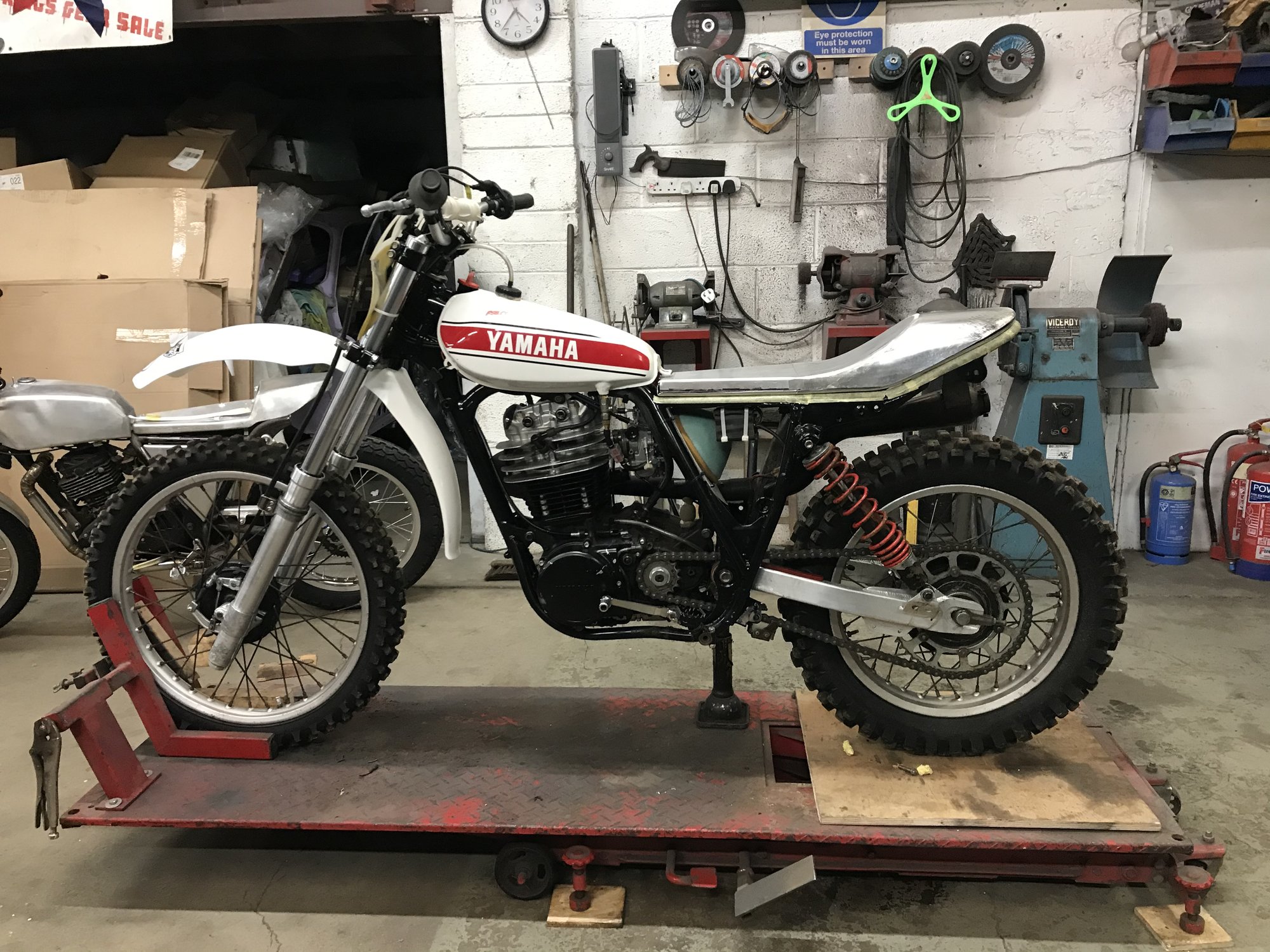

looks like it has a TY50/TY80 tank and a tasty flatside tooWhat bike is that?

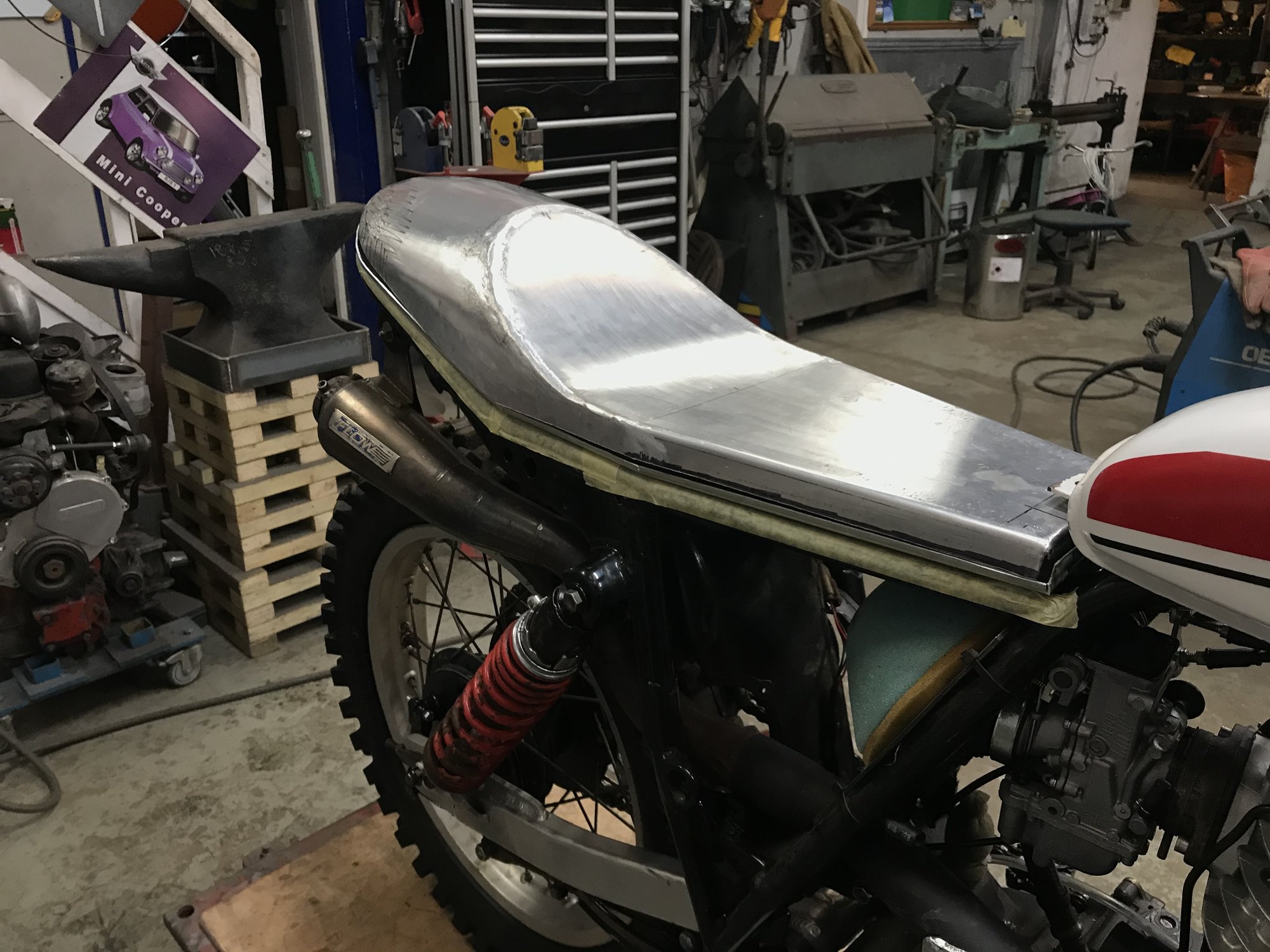

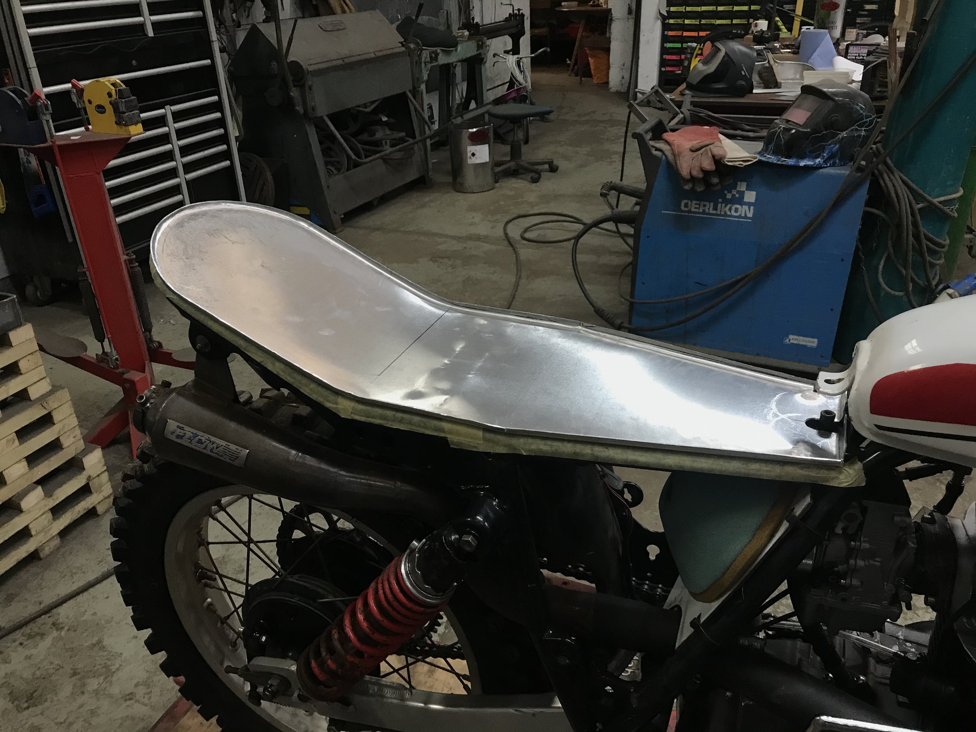

Got some more done on flat tracker tail #2. A bit more trimming and it’ll be ready to weld together.
View attachment 254747 View attachment 254748 View attachment 254749
It’s starting to mature.A bit of patina on it and that will look great!
Does now too mind.

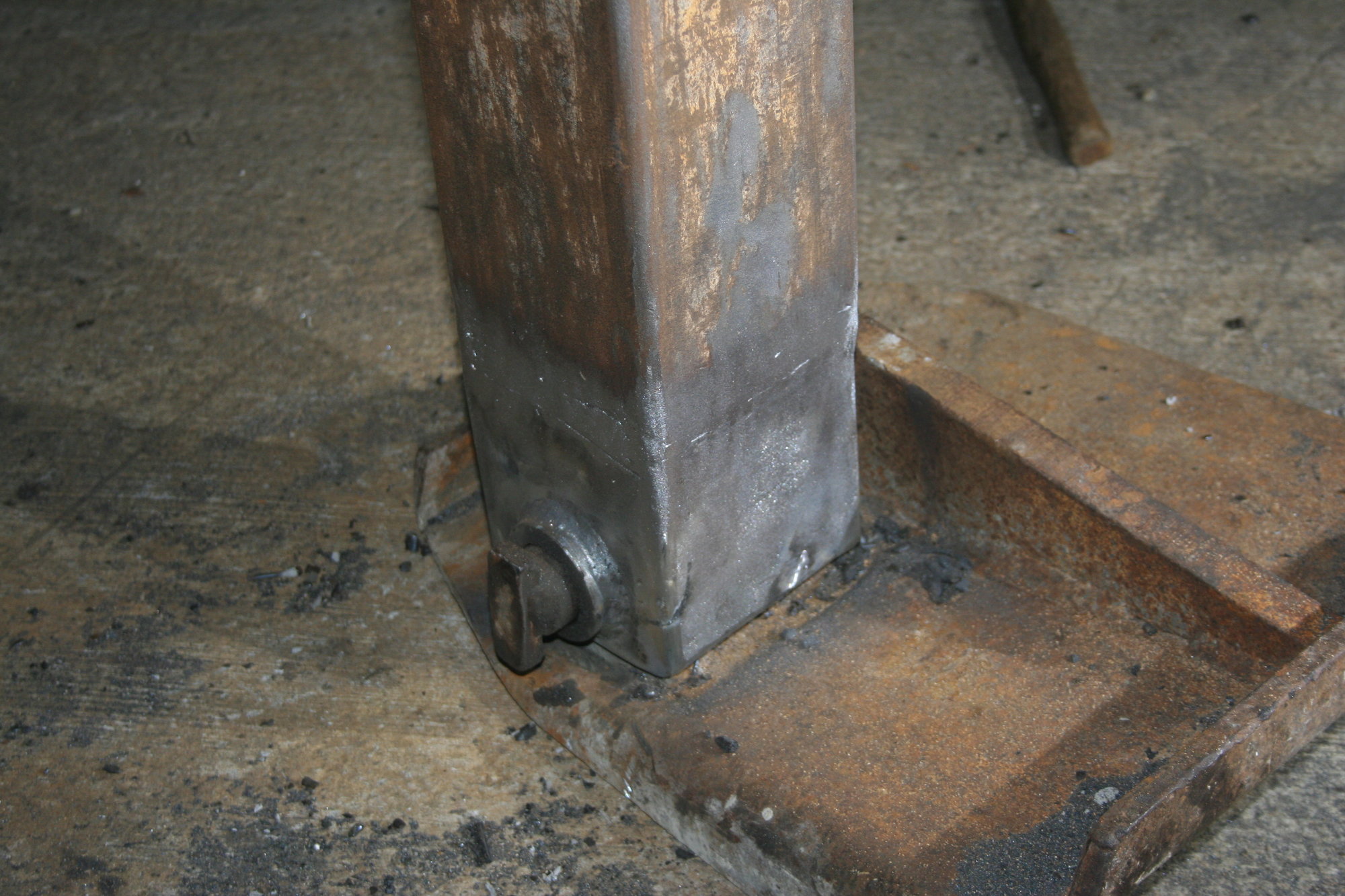

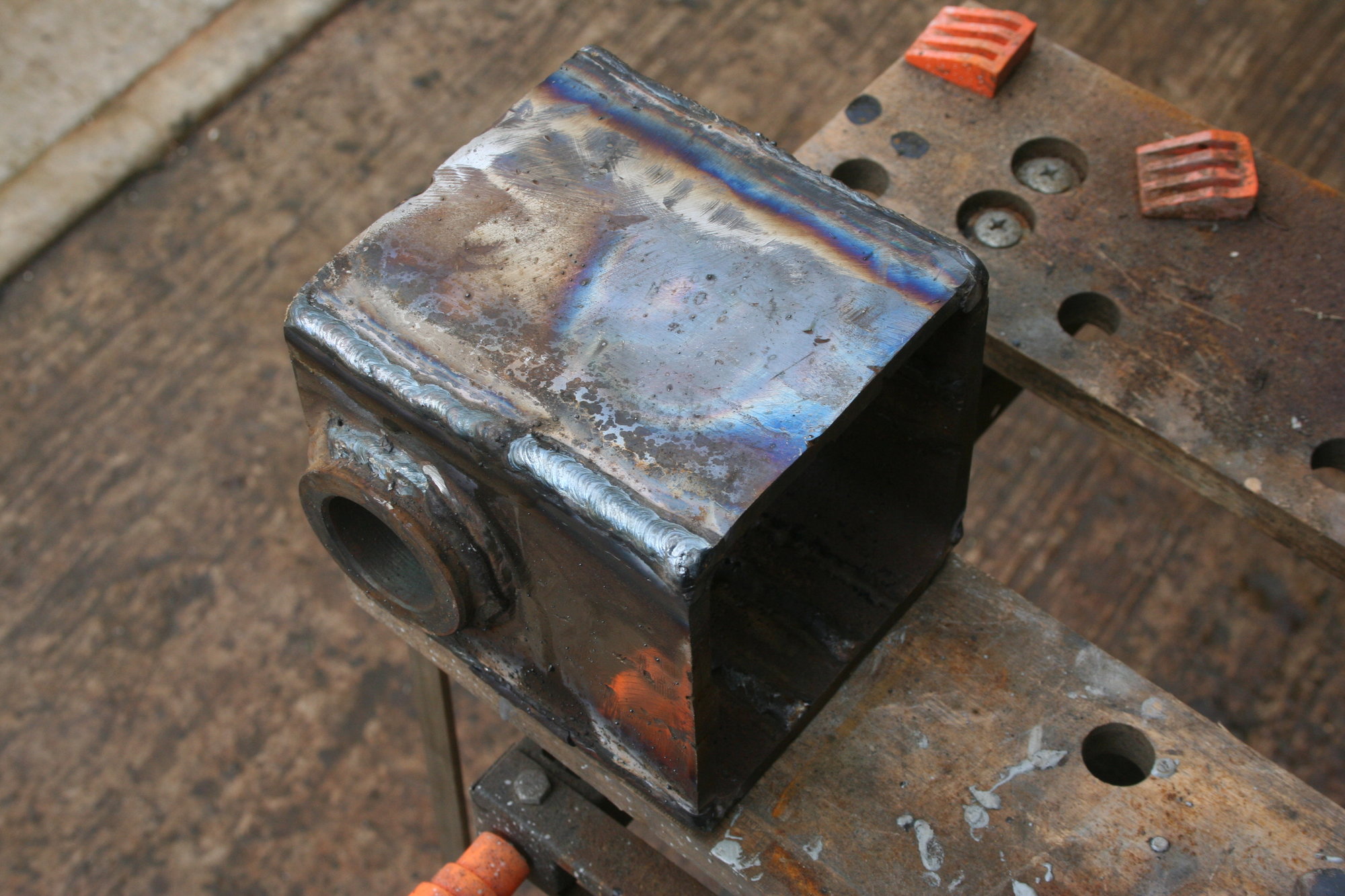

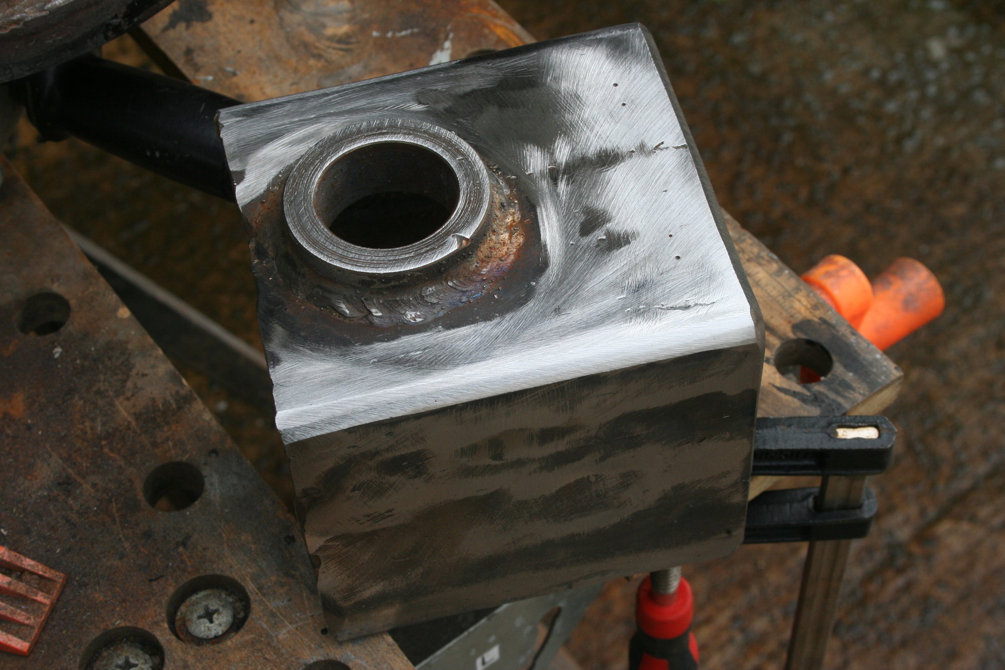

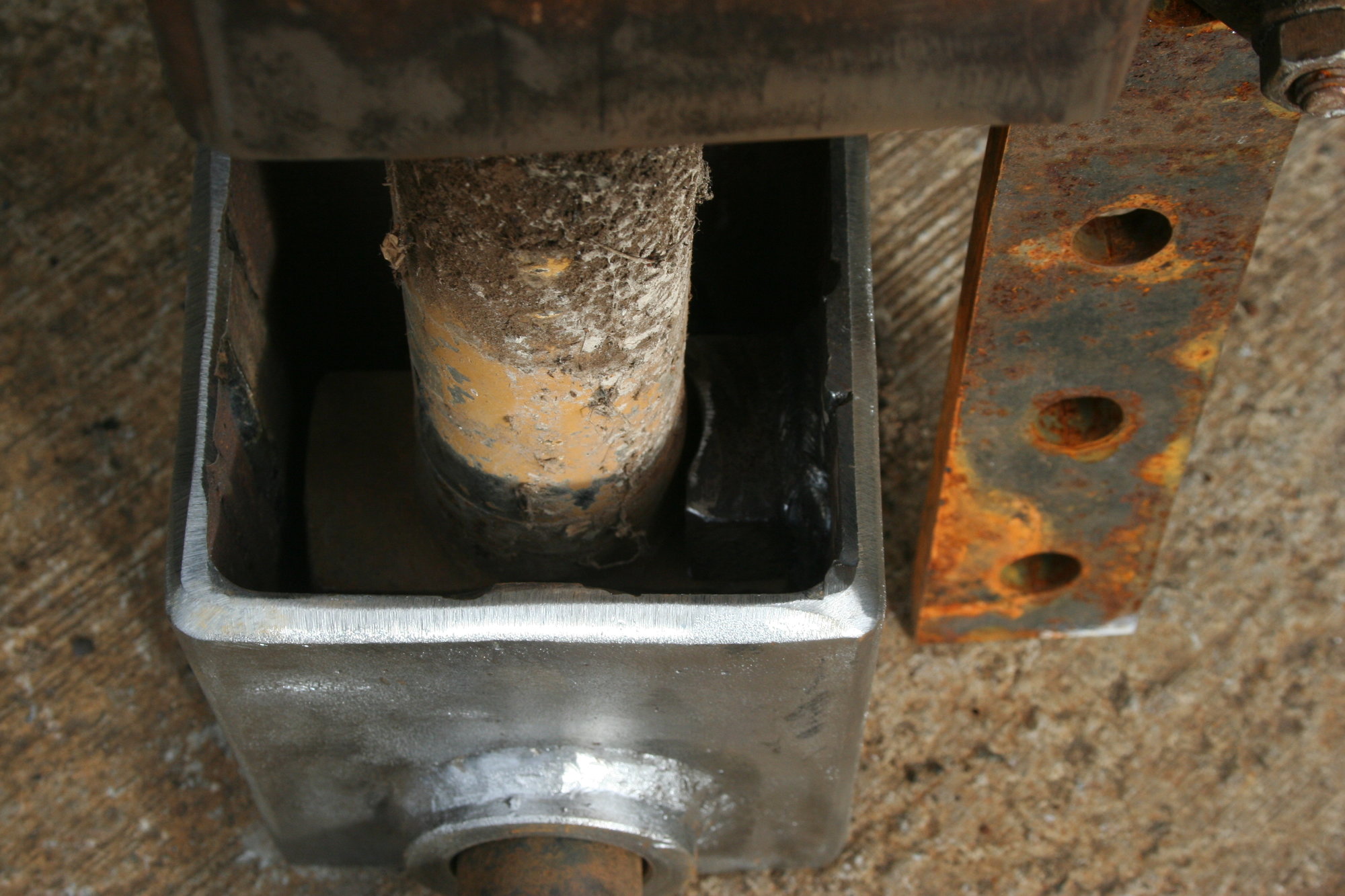

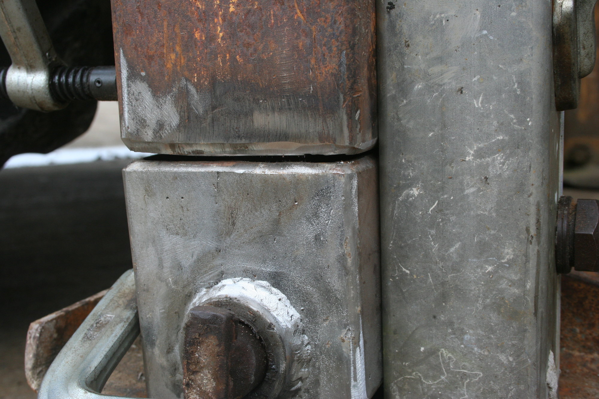

Not made... more bodged.

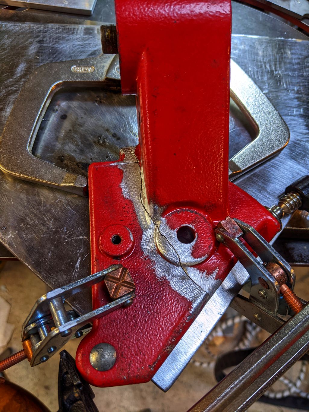

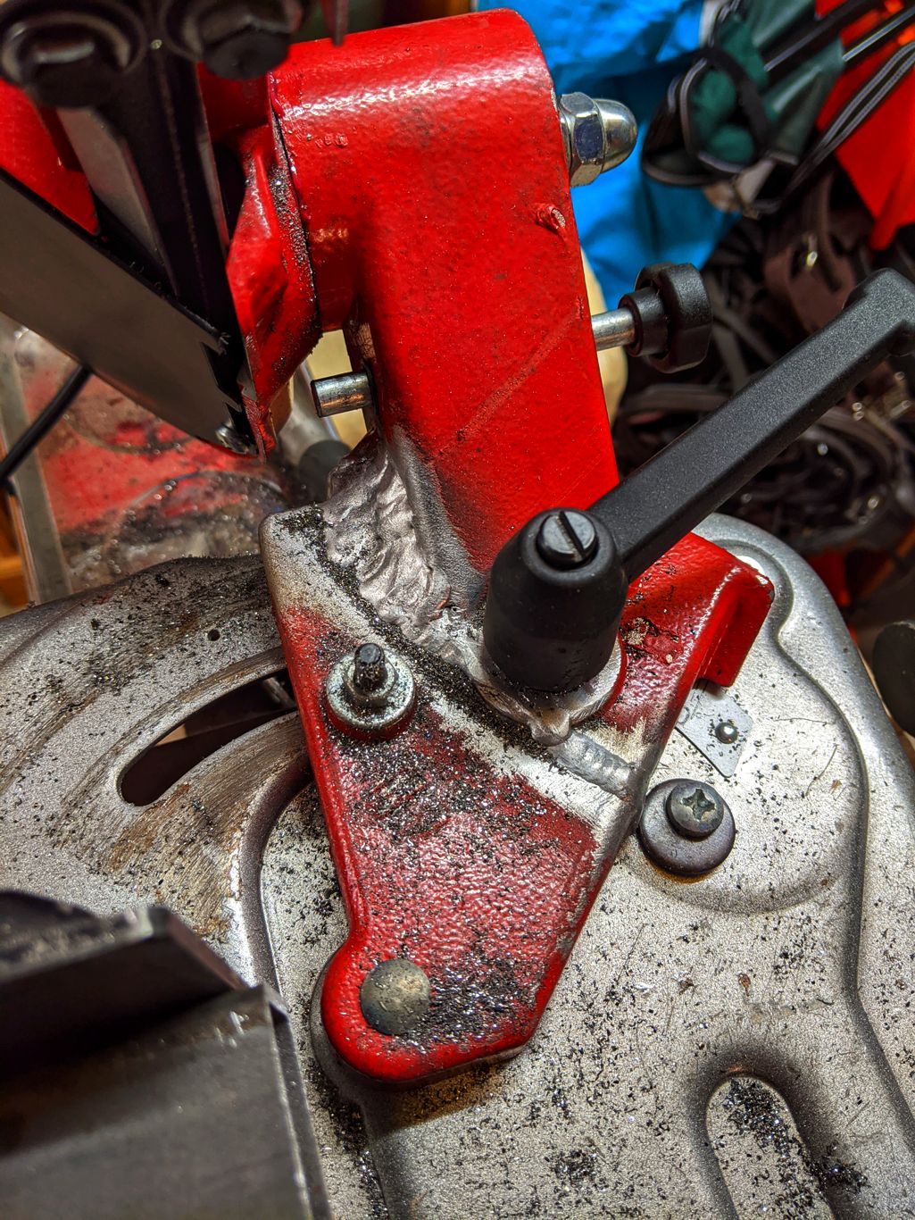

In a moment of buffoonery I managed to knock my FEMI bandaw off the bench and broke its most critical component;
The bargain Sherman TIG206P meant that I could have a go at bodging a fix (alas my beloved Lorch MicorTIG is DC) before I can get hold oc a replacement part. Its about 1deg out vertically as I put way too much filler and heat into it but I'm hoping some filing and washers might fix that. A messy weld and got heaps contamination but its made a few cuts and held!

It’s an XT500 trail bike but it’s been used for classic motocross.What bike is that?
Thanksnice work. i like it and the bike!....how did you get the rear shrinking done? might have a bash...........literally on my next project
 , I’ve got an english wheel and a shrinker/stretcher setup so I wheeled the top and shrunk the back edge to get it to suck down over the edge. Once it was close I annealed it with a MAP torch and hammered the last bit over a form.
