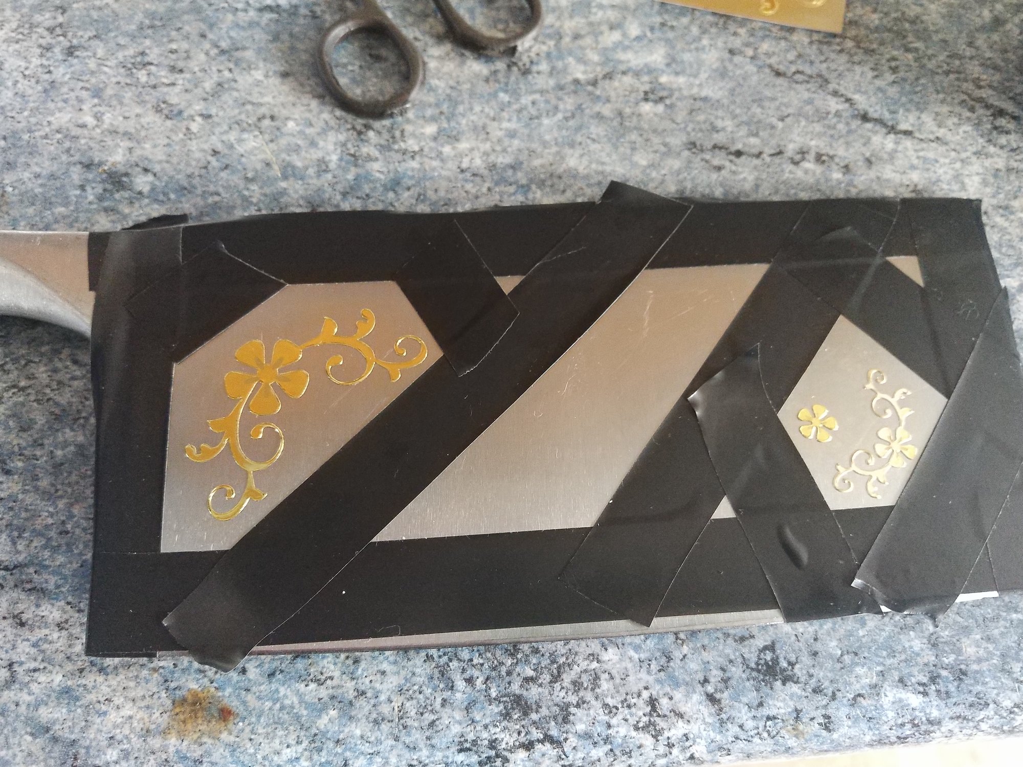

Finally finished the painting on my new aluminium end marker boards. (It's amazing how much you can't get done when you're only home at the weekend

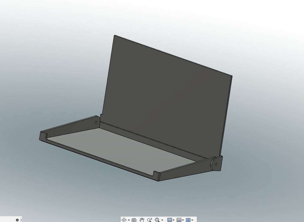

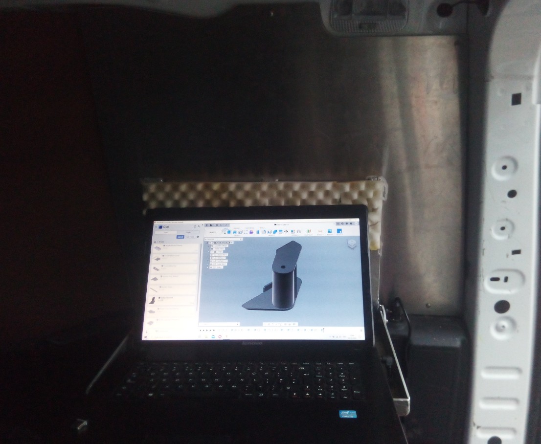

Needed somewhere to store the laptop in the new van for when I am working away as Fusion on the phone is not the best.
There is an Aux 12v socket in the back so it was the perfect place for the chargers so I made up a model in fusion.

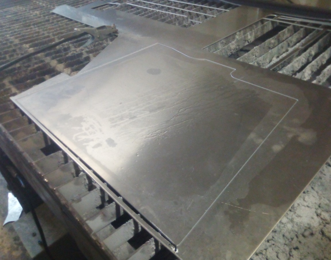

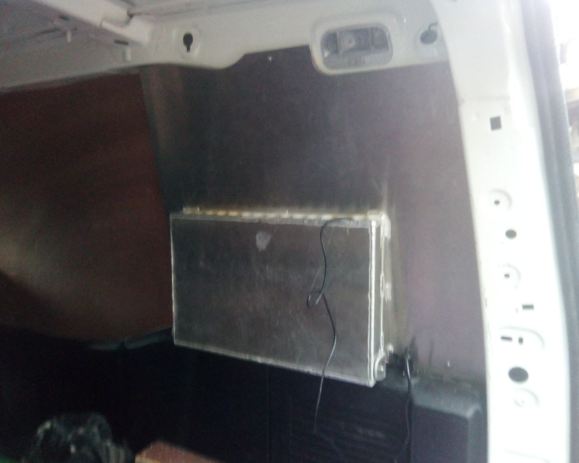

I cut the parts out and welded up and then screwed it to the plywood lining of the van but it is pathetically thin, only 6mm and poor quality ply at that, so another plan had to be made.
I did some measuring and then cut this out on the plasma.
I then welded the tray to that and and fixed it over the plywood with self tappers right into the vans metalwork, it is much more solid.
I need to get something made to attach the adapter to and I should probably have incorporated something for a mouse as I detest touch pads

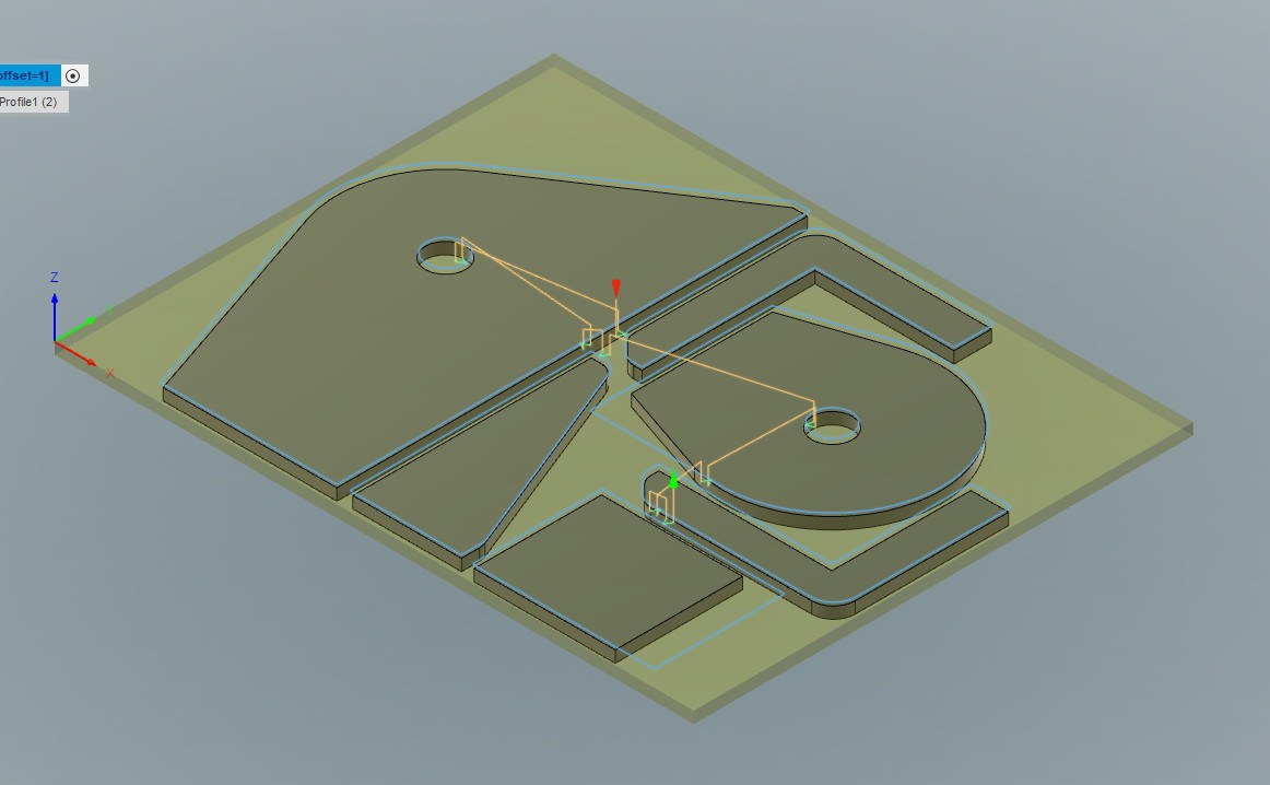

The thing about SolidWorks was you had to build your parts for a model in single files then pull them all into an assembly and join them together to make the part. You could model all in one file but then it was one part so not easy to separate out into individual parts for plasma. With Fusion it is all done in the one file and you use different components for different parts and you can then pull it apart and align for putting into a plasma ready profile for the CAM.
I usually do my model then once done I "Save As" so that I can then pull it apart and align parts but still have the model complete.
Here is a vid showing the stages I went through on a model of a roller I made up. Obviously it has already been drawn but I am just showing the stages of making the model from individual components rather than a one piece model.
Here is the model laid out for plasma.
