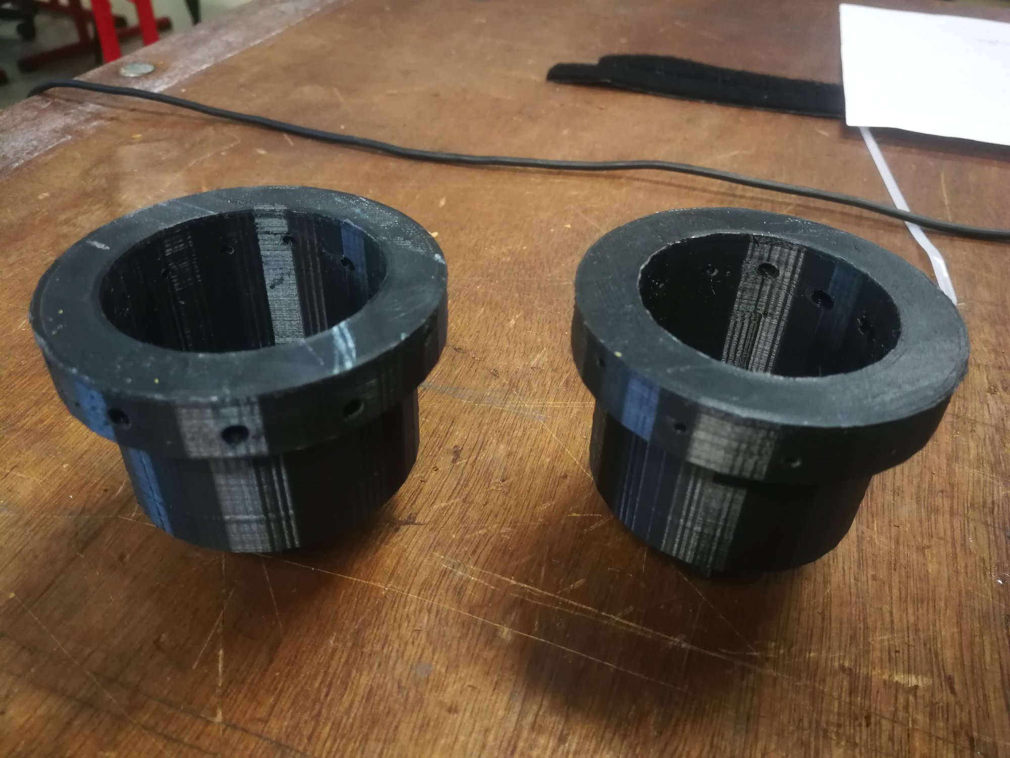

Excuse my ignorance, but is this possible on a 'non CNC' lathe?
Cool
It can be done on a manual lathe, all that is required is that the rotating tool is geared to the spindle and that can be done with shafting or even an encoder on the spindle that feeds a servo drive that drives a servo motor which rotates the tool..It’s a CNC Lathe.

I've never quite understood the point of Polygonal Turning. On the machines I've seeing it done, it's always been a relatively slow process and the result is never that great (as you said the surfaces never come out that flat).
With live tooling there seems to be many better options.
@Hood Any reason you have chosen this process or is it simply a because you can and its cool?![]()
Wasn't me but usually a Y and C axes would be needed for live tooling to be of most use or at least much easier if you had themI've never quite understood the point of Polygonal Turning. On the machines I've seeing it done, it's always been a relatively slow process and the result is never that great (as you said the surfaces never come out that flat).
Now you're going too fast for me.....................................The flatness depends on the ratio, cutter diameter, and number of cutters. When I get time, I think I'll code a program to calculate and show the variations.
The reason for opting for this is for some parts I need the flats at the chuck end, which with basic live tools would need some form of long lipped/stepped cutter like a t-slot cutter, whereas polygonal doesn't have the same clearance issues.
To do the same job without polygonal would need a full Y axis.
