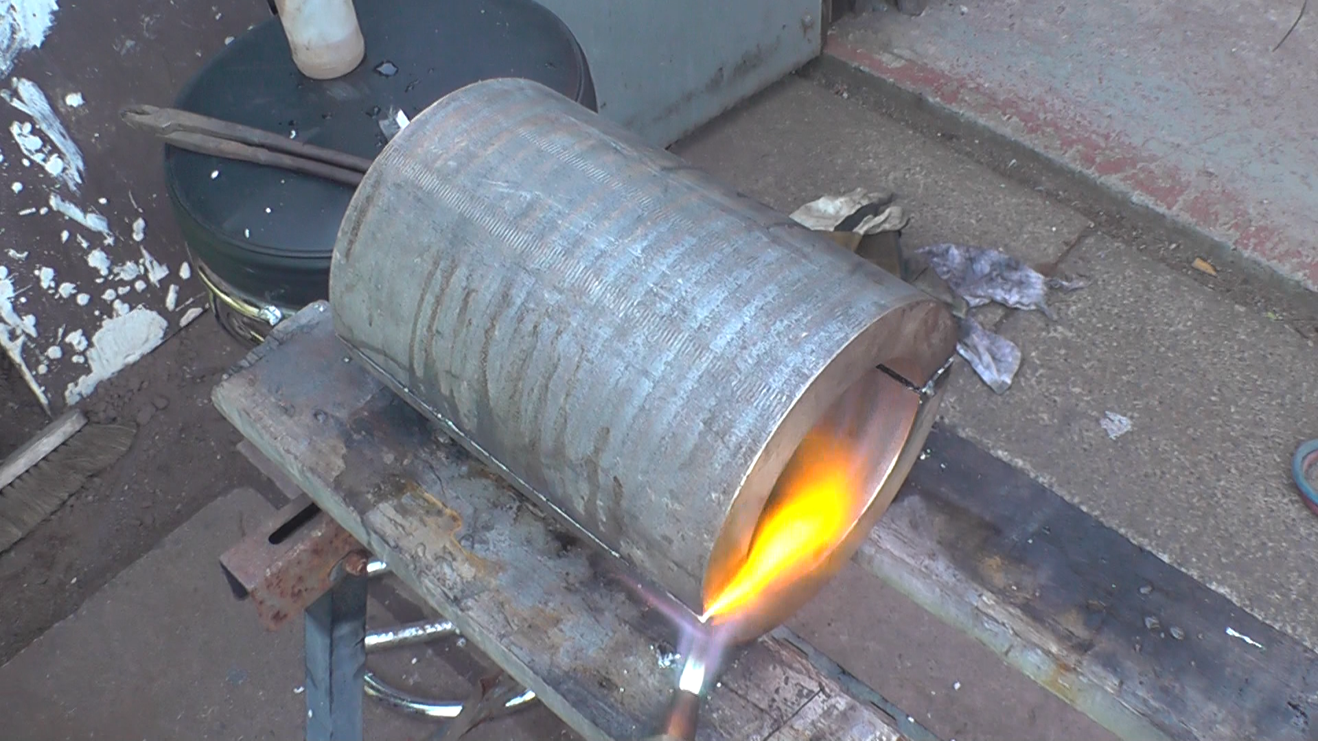

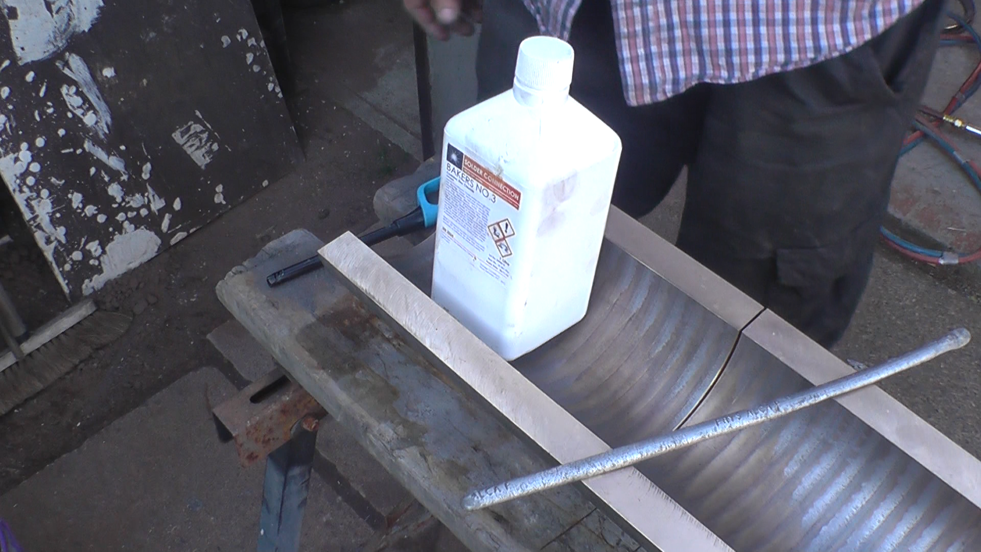

How did you cut it length ways?A start on some bronze bearings
The hollow bar was £400
View attachment 248802 View attachment 248802 View attachment 248803 View attachment 248804 View attachment 248805 View attachment 248806 View attachment 248807
Just what I was going to ask. I know it wasn’t a hacksaw, because John did a bit of that in Sunday’s video and didn’t seem to enjoy it too much!How did you cut it length ways?
A friend has a proper band saw then milled flatHow did you cut it length ways?
Yes cutting torch running flat out be a bit video next weekJust what I was going to ask. I know it wasn’t a hacksaw, because John did a bit of that in Sunday’s video and didn’t seem to enjoy it too much!
I bet it soaked up a bit of heat soldering the two halves together.

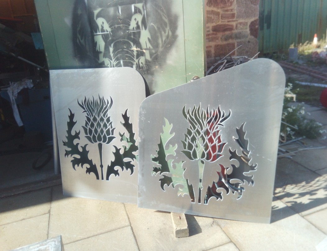

A friend asked me to make some small handrails for his steps so I made a start today by cutting some 5mm 5083 Aluminium.
A view of the plasma doing its thing. The view is through the Optrel Crystal but I still can't get a true to life view, the camera seems to auto adjust no matter what I do and it doesn't come out anywhere as near as clear as you can see with the eye.
Hopefully I will get a chance this week to bend the tube and weld things together and then get it into the powder coaters.
I am well impressed with the Jasic. Will be much better if I ever get a chance to get the new plasma table finished as the rails on this ones Y axis are cracking away good styleQuality of your cuts rival some top end machines
Not sure when that will happen though as I have a boat to finish fitting out and another two boats want roller systems and then near the end of the year is another new Cheetah to fit out and have loads of smaller 2-3 day jobs to do in between.I am well impressed with the Jasic. Will be much better if I ever get a chance to get the new plasma table finished as the rails on this ones Y axis are cracking away good styleNot sure when that will happen though as I have a boat to finish fitting out and another two boats want roller systems and then near the end of the year is another new Cheetah to fit out and have loads of smaller 2-3 day jobs to do in between.
I am just doing the prep work he will be machining them
It hurts to pick it up must be pushing 50 kgHow heavy is that lump?
The scrap price for bronze is only around £1.95 per kg.
I know it's not scrap but even so.

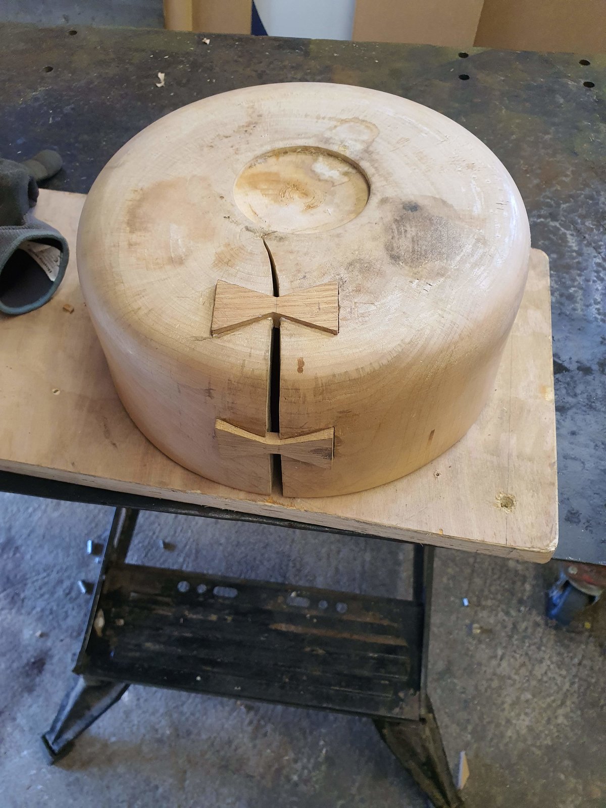

sometimes a repair can add to the look of an item and make it more interesting.Managed my first 2 bow-ties today. This is a bowl a turned about 10-15 years ago, was from a section (or cookie as the yanks call them) of sycamore. Not surprising it split, so insert 2 oak bow-ties to stabilize then I'll cut them back and tape it up then I can pour some resin in, probably use some copper powder in it. I'll probably throw it back on the lathe and re-turn it once done, maybe cut it a bit deeper.
