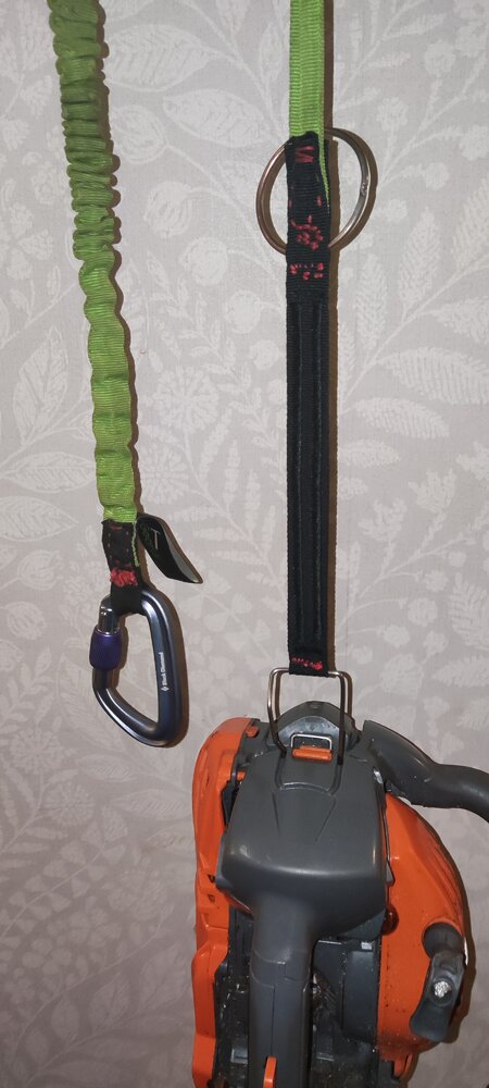

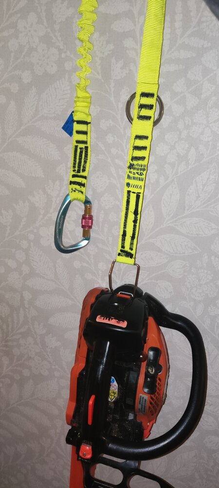

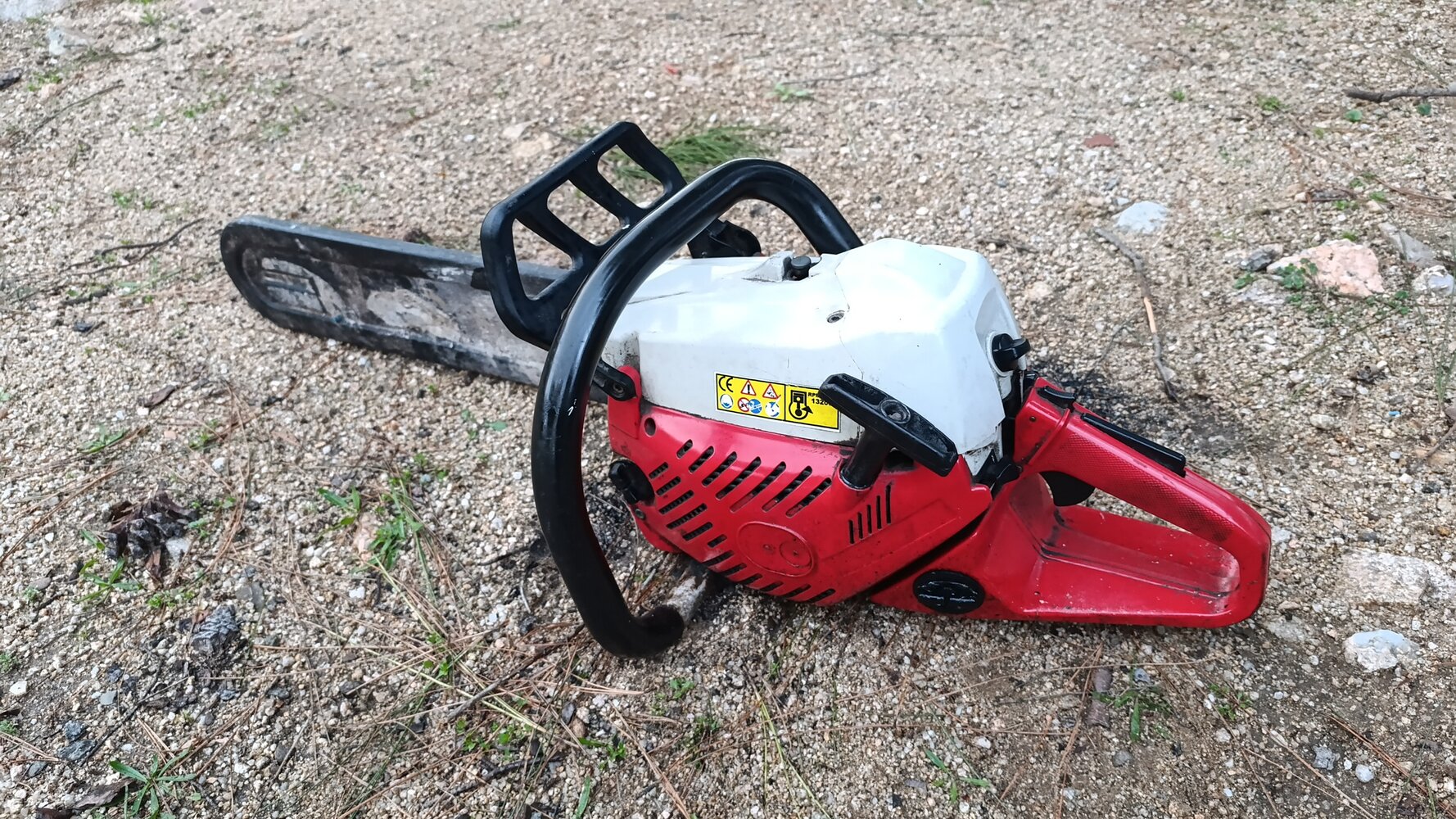

He was so happy he almost criedRebuilt this Active 62-62 chainsaw
New piston, honed cylinder, new fuel lines, new primer bulb, new diaphragms
Spent the entire morning assembling it and 2 hours now in the evening to do heat cycles and carb tuning
Chosen to go few hundred rpms short 12800 instead of 13200
It has a fantastic airflow and I'm over fueling it a lot to go short in RPM.
It's like the Stihl Ms 361 more crude cause it's electronically limited but there are no strange things like compensators or particular air filters or catalytic converter in the muffler.
I had this saw for years now it was scored, it was a friend birthday the other day and I decided to put it back together for him.
It'll be more than happy I believe
That's a good 800 euro saw
This is the collection.
