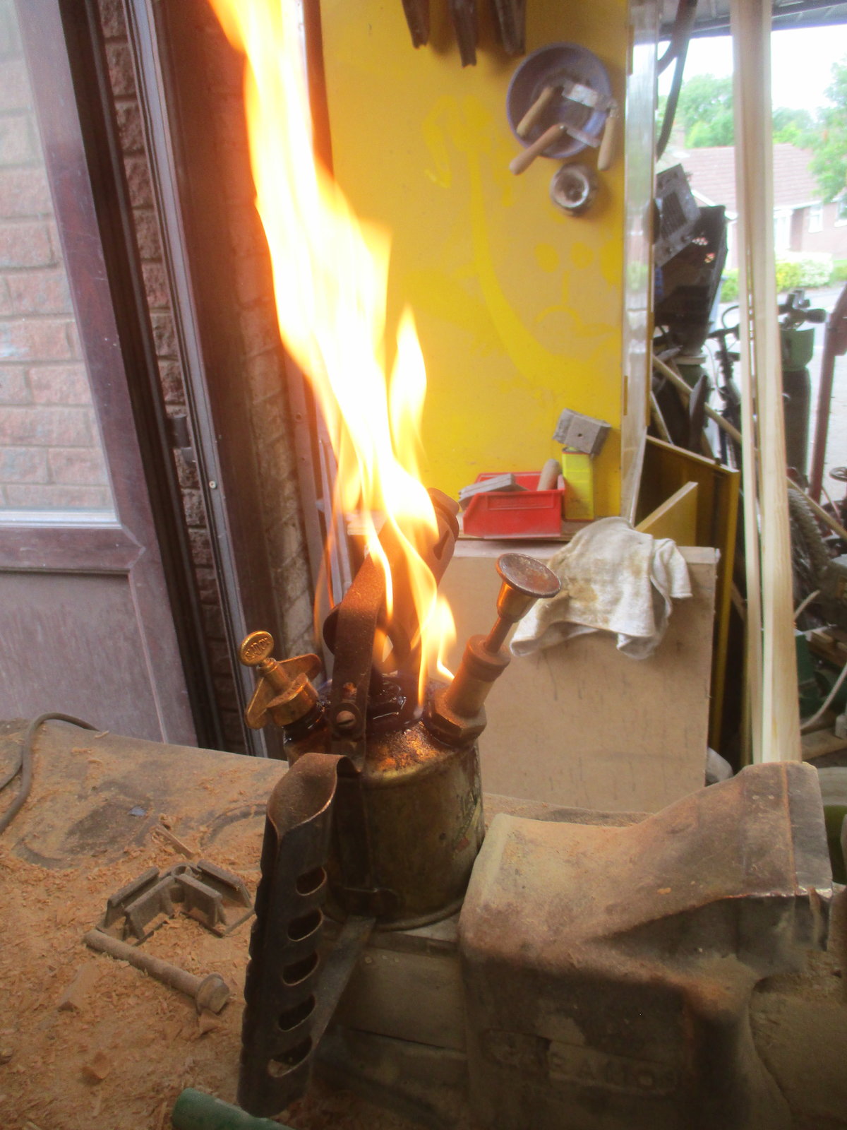

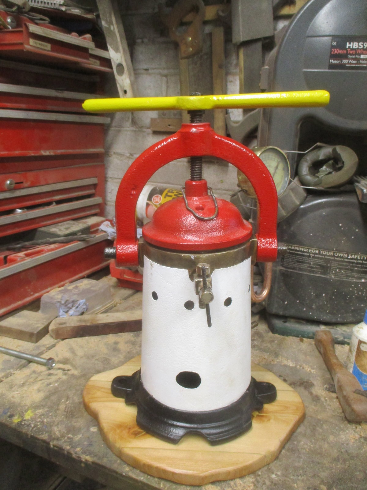

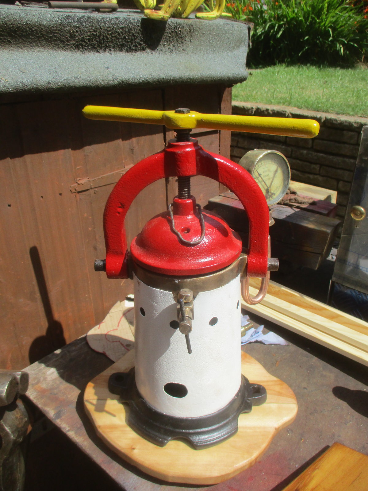

This was set up at my place to show what was wrong.
Paraffin Blow lamps are very common, 60% are not worth repairing but look good to look at. The other 40% are worth spending time and funds to get them going. Service parts are cheep.
I always replace all seals, they are in the kit.
This person only replaced the cup washer in the pump and "Declared it was now fit for use."
First use, he primed it, pumped it up and after it was burning nicely the Pump to tank washer failed. Allowing paraffin vapour to escape with the resulting fire.
I now have to get a new CO2 extinguisher, as it was sued to make the torch safe in MIS.
When it all had calmed down and new coffee made, our expert was heard to say.
It had to be cheep parts from china, he could not made that mistake.
