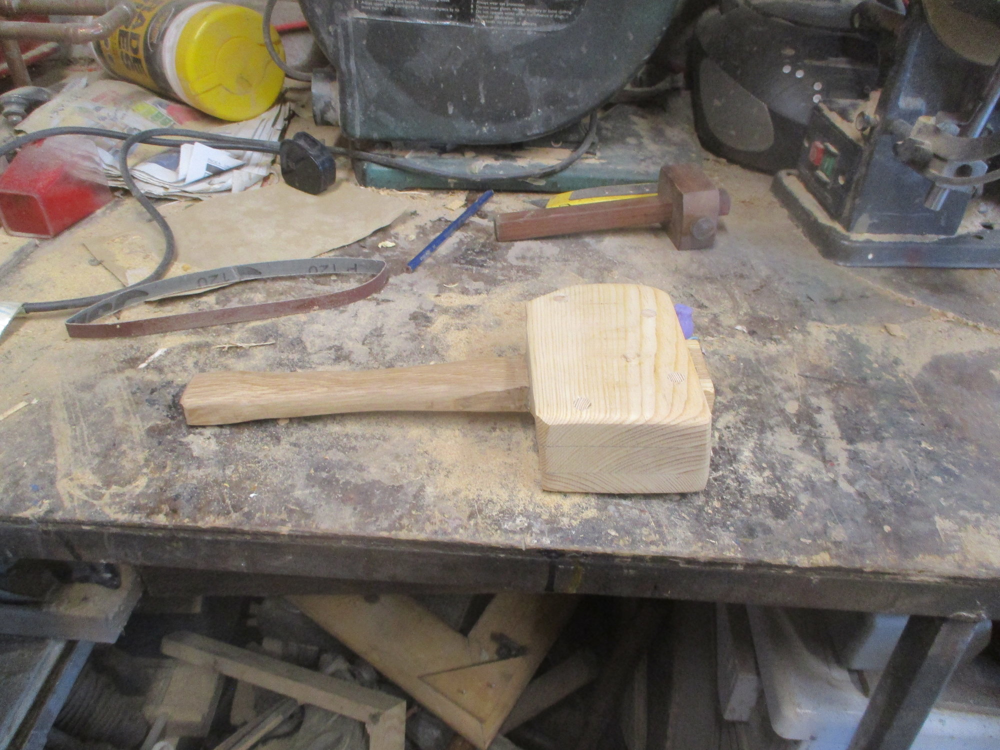

Recently a friend gave me a lot off Wooden Planes.
I restored a few. But a friend who needed some help in the trouble times, so I gave him the rest to restore.
His first big restorations.
Up shop is that his Local MIS has a lot of working planes.

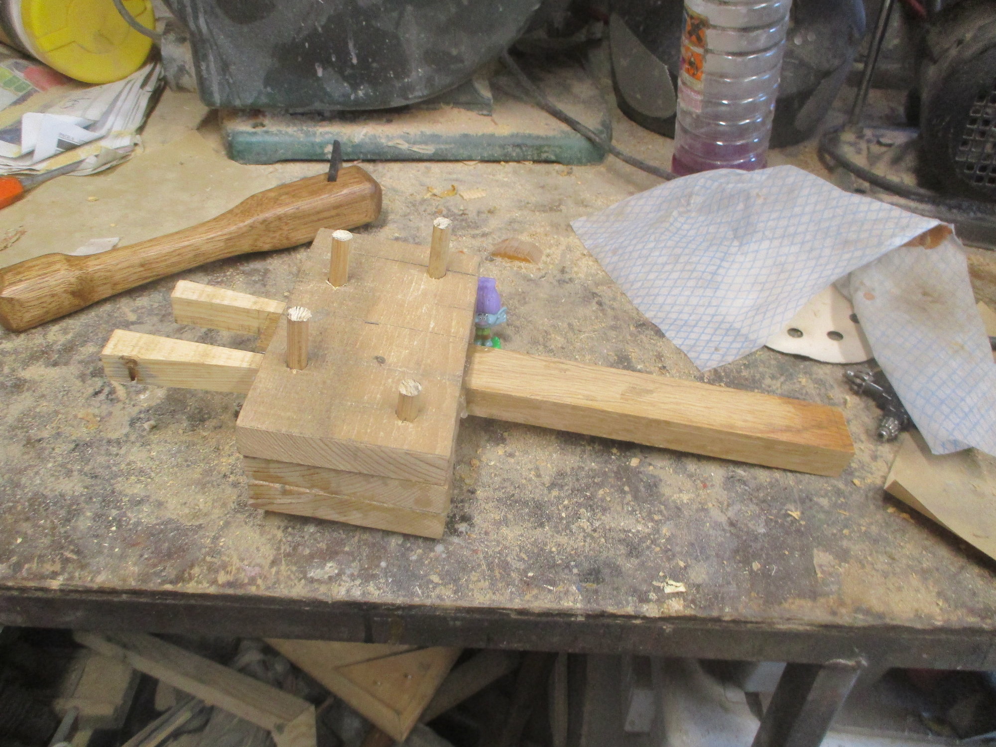

But, it is a bug bear of mine that some users will use a metal hammer to force the wedge in, set the blade and beat the wedge out.
There is no need. You can simply make a wooden mallet to do the job. This does not damage the wooden plane.
So, I made another one.

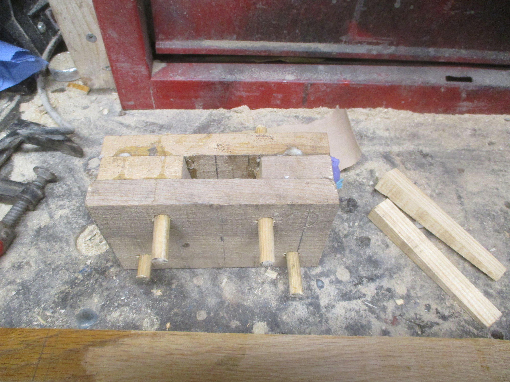

3 bits of scrap wood. The 2 outer ones are the same size. The inners ones are cut to suit the handle and tapered at 1:7, as are the 2 wedges.
The head is doweled, only to give a bigger surface area for the PVA glue. Tip, I used a dowel chamfer tool to make the driving of the dowels in a lot easier.

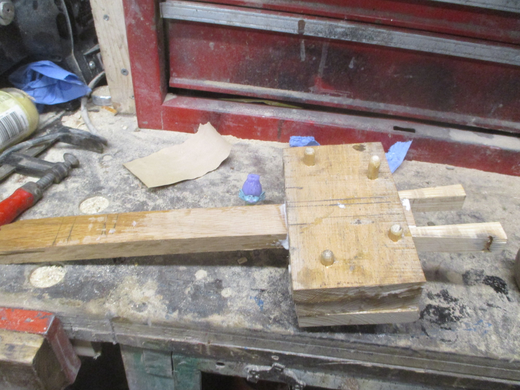

Assembled, the blocks are glued as are the dowels. The handle and wedges are not. The cam action of the wedges will lock the head in place. The handle was also tapered to the same as the wedges.
I used normal PVA this time, not the quick drying one.
When driving the wedges in listen for the sound change, you will hear it as the wedges lock.
Yes, a short shaft, you want the weight of the head to lock the wedges and shock it loose. Brut force is not needed. You tap, not whack.

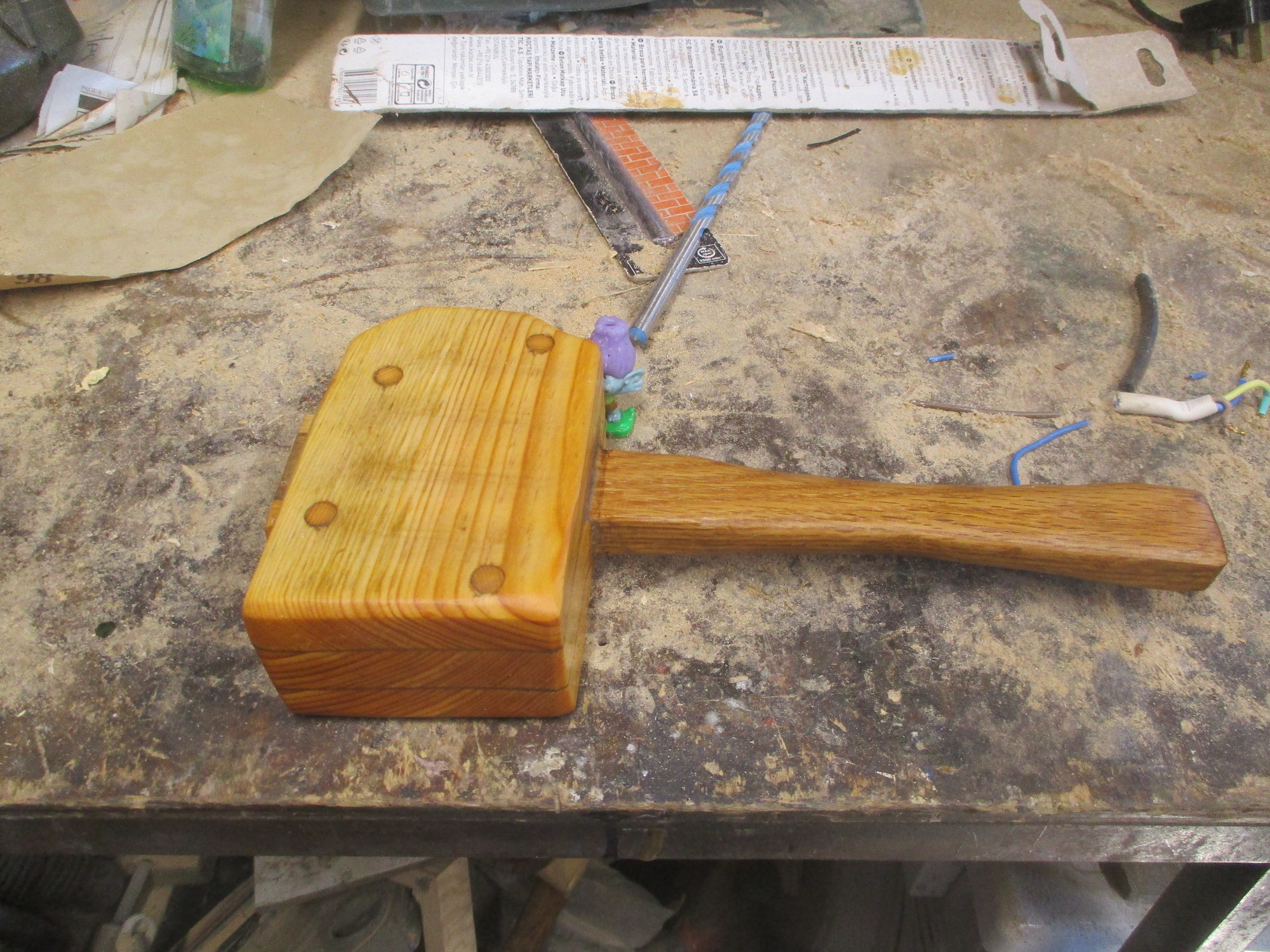

Shaped, one face is angled so it strikes the plane body flat. The other is cut to from a "Cross Pein". This is for setting the wedge.
The shaft is trimmed to suit most hands. My friend is making is own to suit his hand.

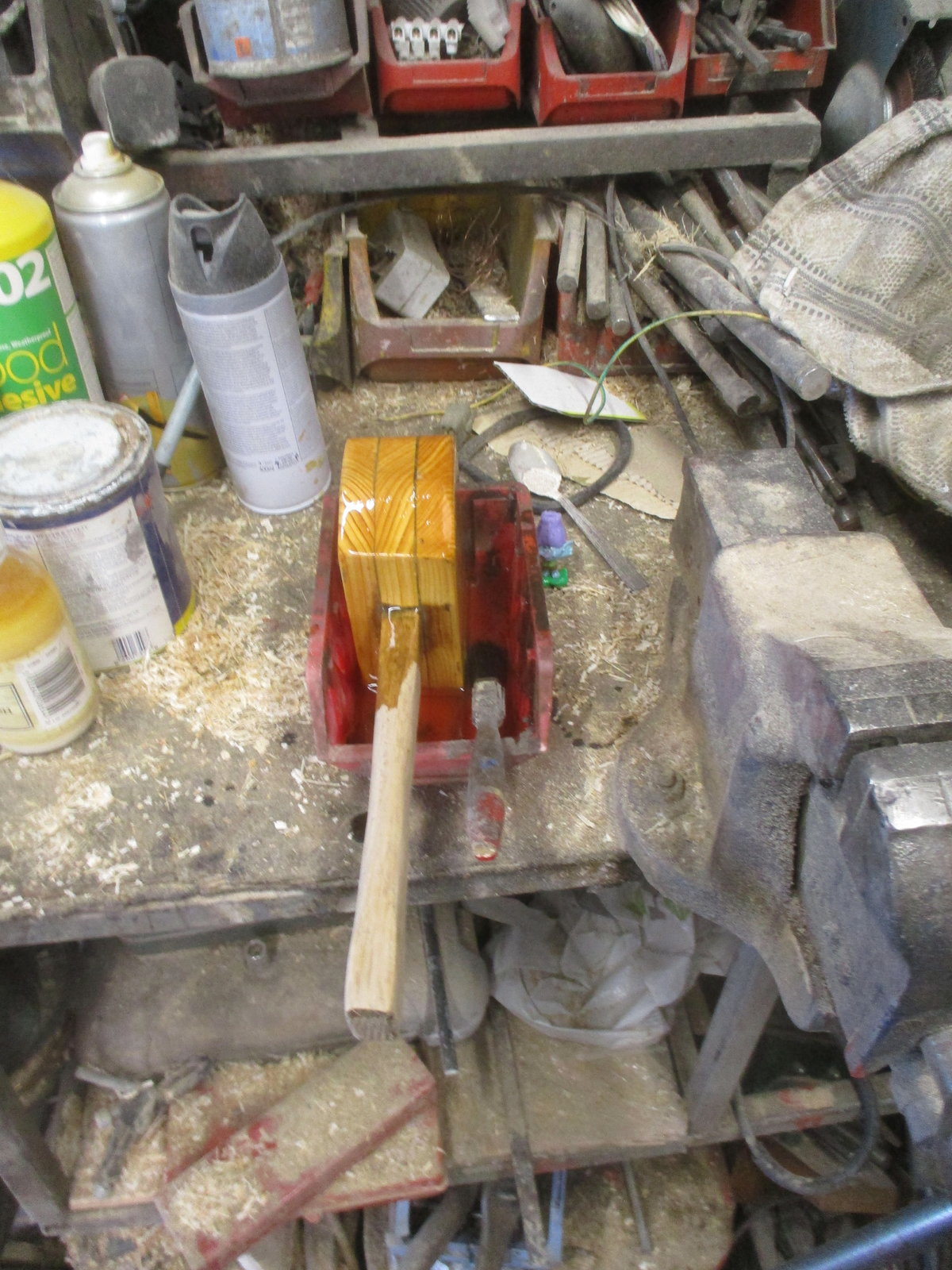

Soaking in Linseed oil, went in weighing 1Lb.
Came out weighing in at 1lb4Oz's. This adds more weight and give sit a nice finish.
Finished.
If you have hard wood for the head, beech is best, and a red wood for the handle you can make wood working mallet the same way.

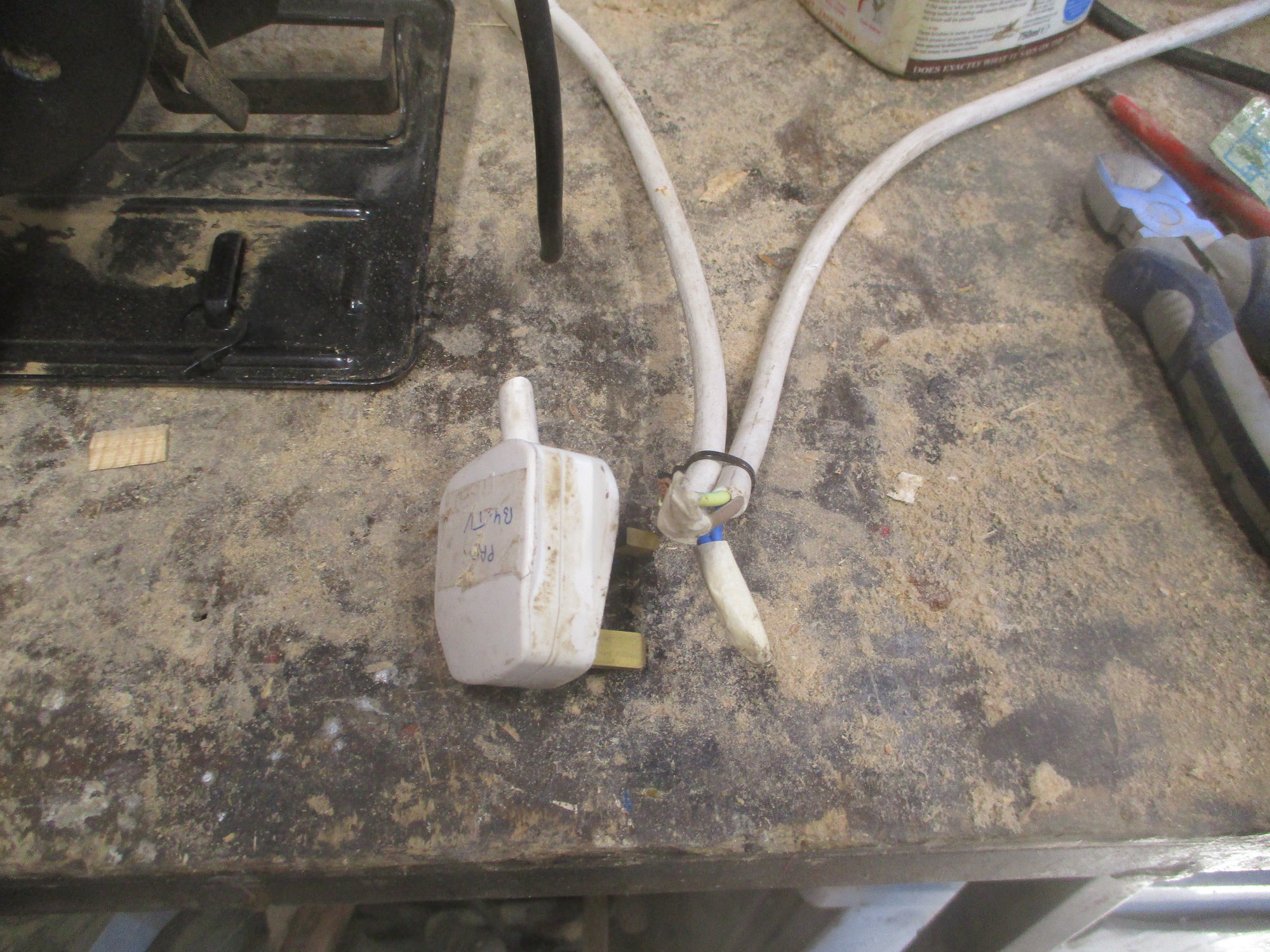

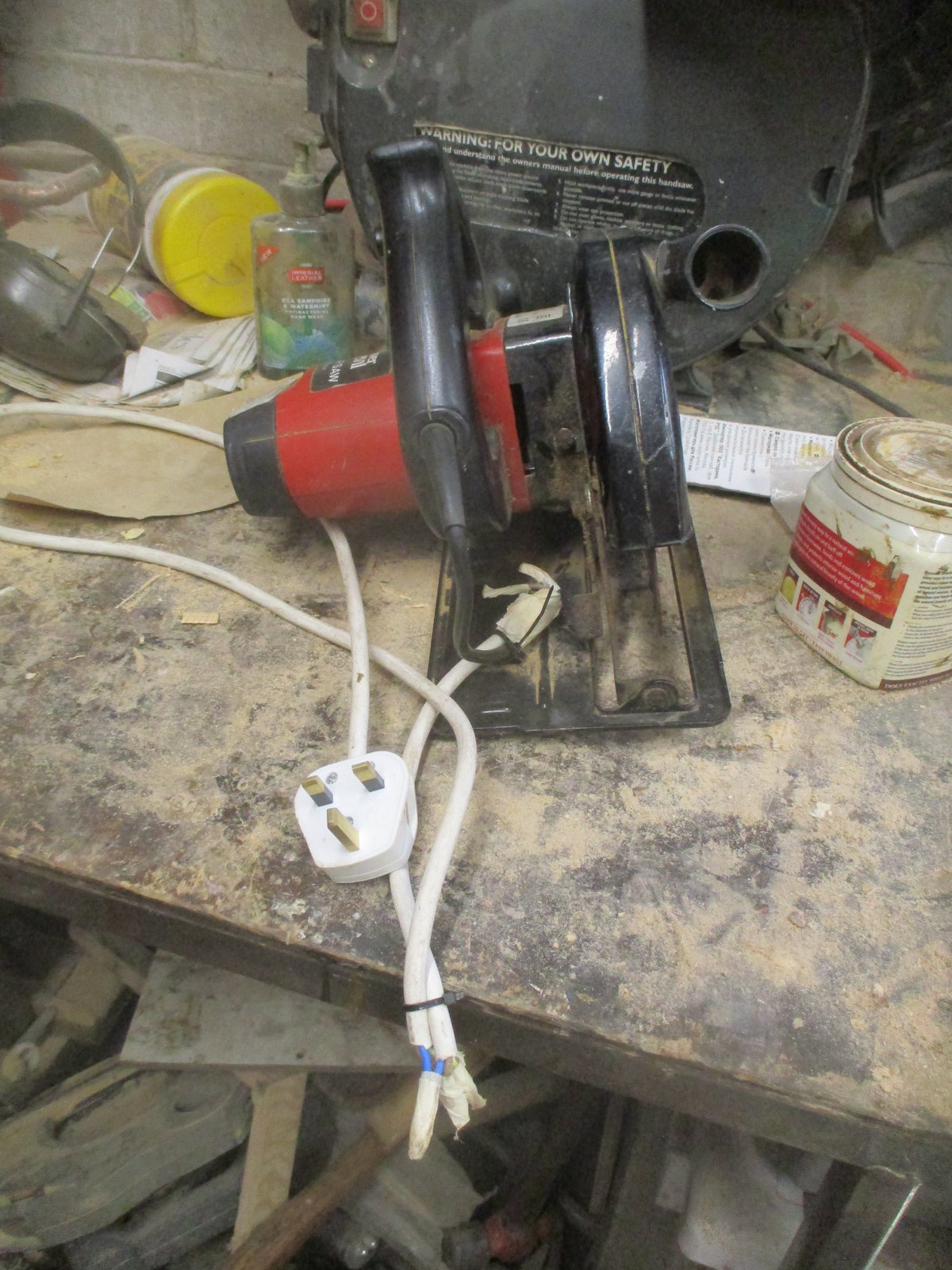

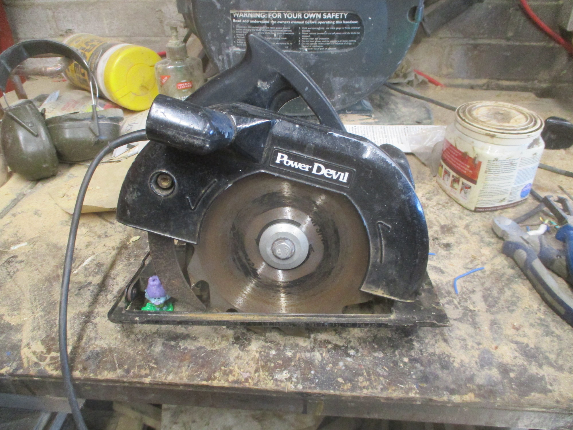

That clumsy thing that is always in the way, without it it is easier to cut cable?Plus one more safety thing.
Riving knife touching blade?![]()
Mind you judging by the electrical 'work' the safety guard wasn't even thought aboutNo safety guard.

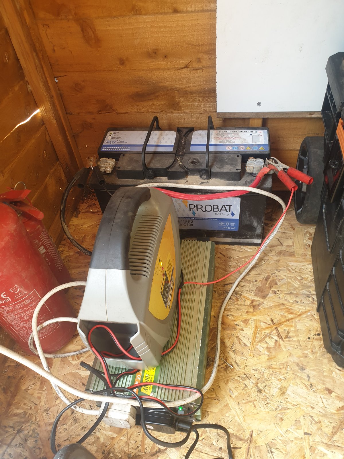

The self charging battery. No idea why no one has done this before.
My genius knows no bounds
Well it will keep the frost out of the shed...How well does that actually work in practice/the long term though?
Doesn't it not work out to be that great due to the losses within the inverter etc??
