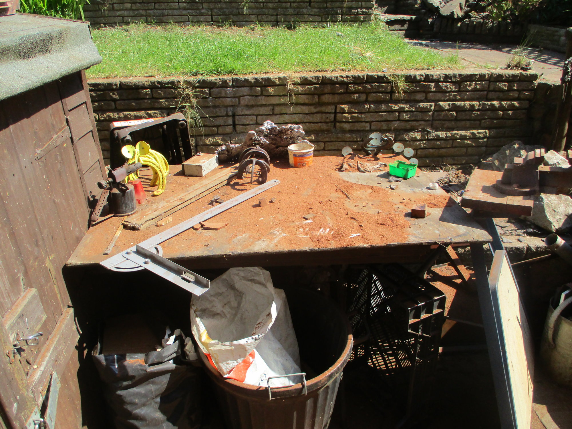

Today I made my workshop tidier than it has been in years.

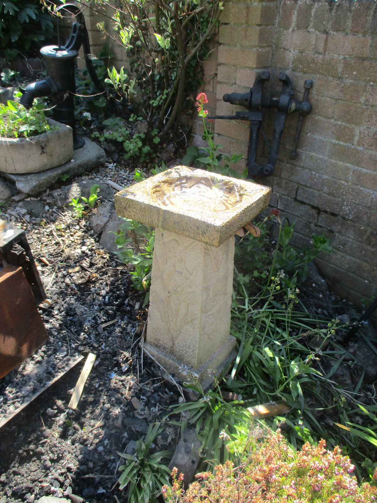

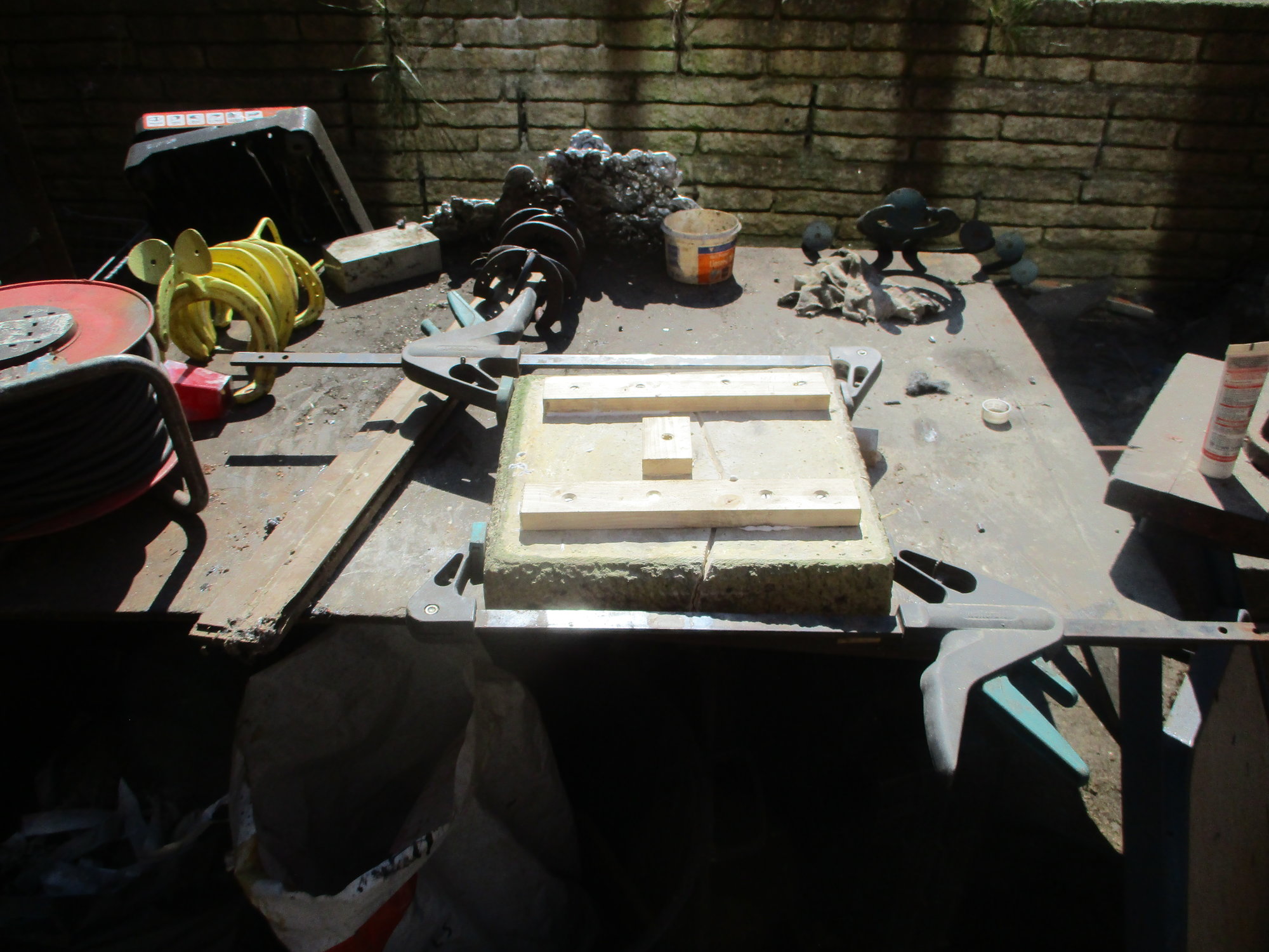

Cast top for the bird bath, I think it is no longer water tight.

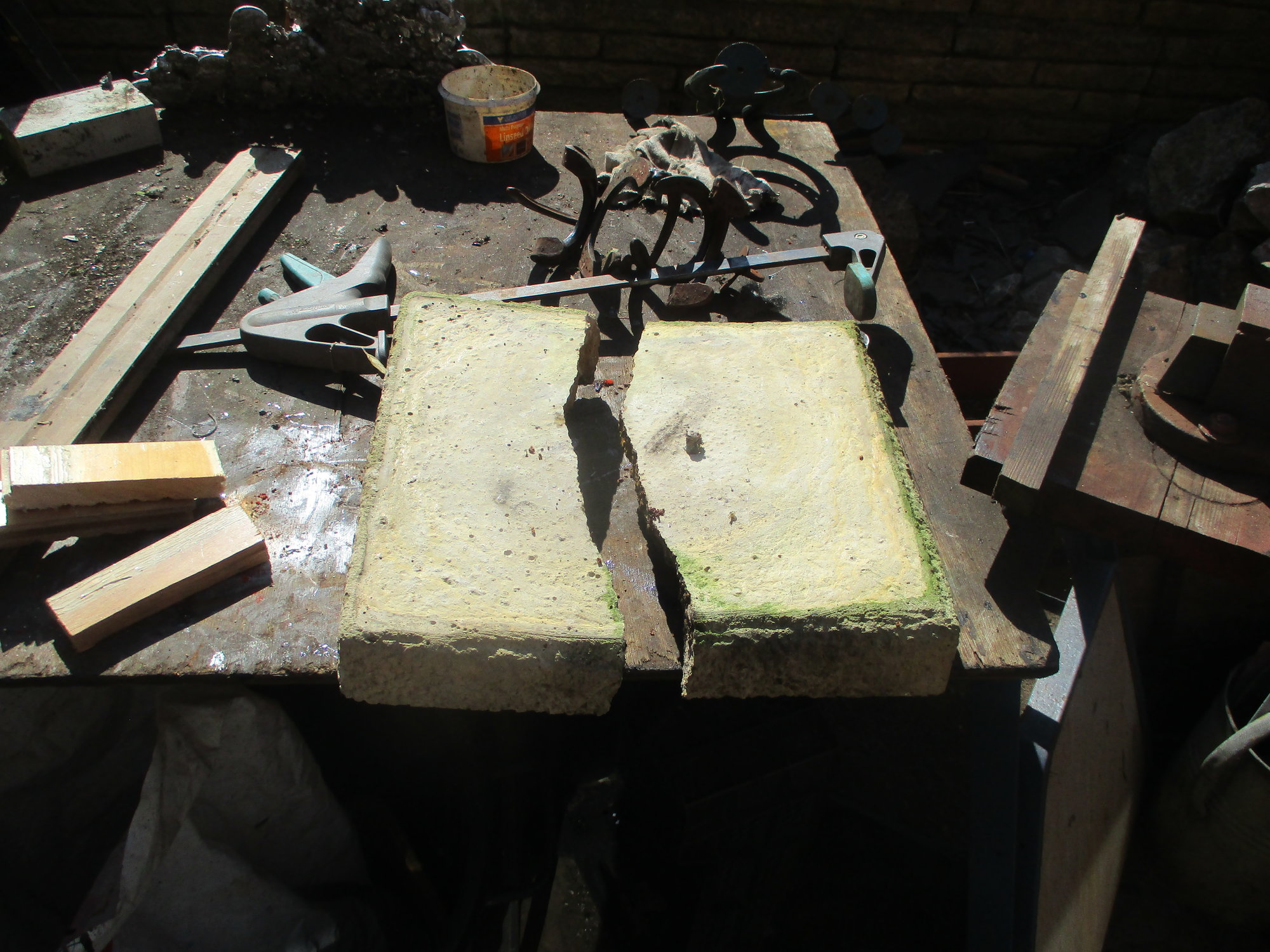

The crack was old, very little was holding it.
3 metal pins across the crack. But not glued or fixed yet.

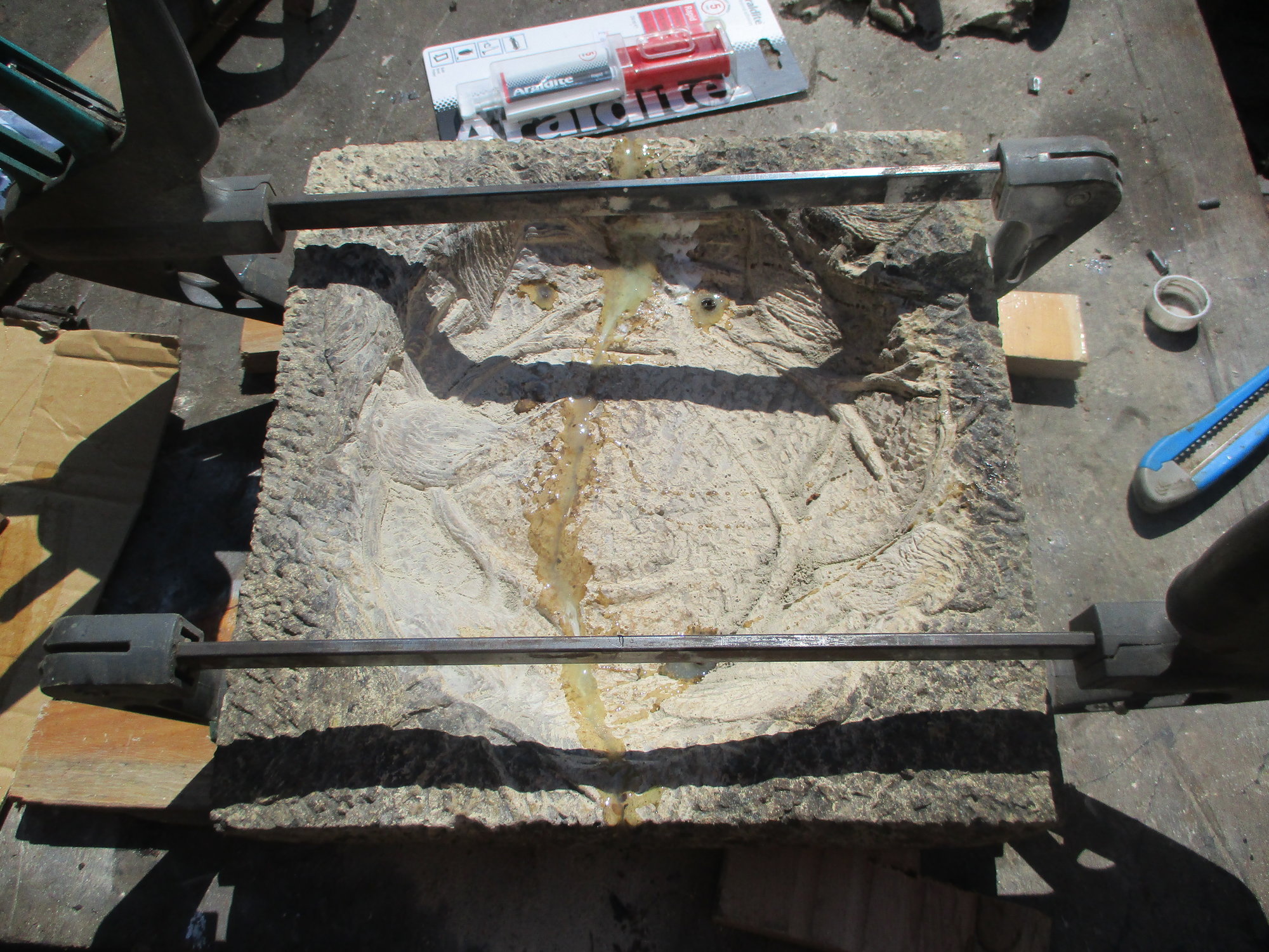

The crack was opened up, to give a decent bead for the glue stage.
The clamps, here are holding the 2 halves in line, so I can open the crack and clean up the stone.

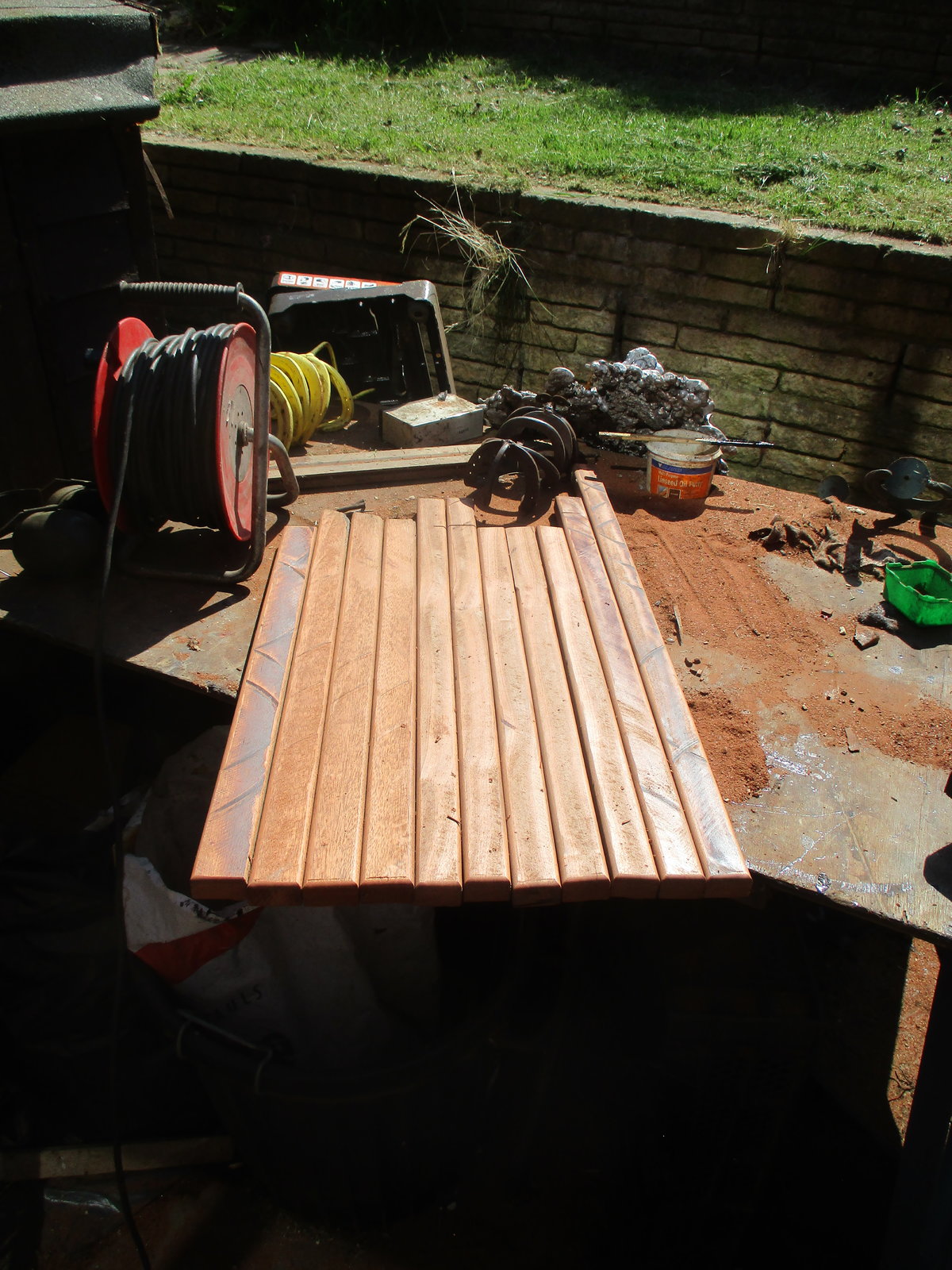

Pitch pine strips, again across the crack. But out of line of the steel 6mm bars.
1 side is fixed with the screws going vertical. The other side the holes and fixings were drilled at a 10Deg angle.
So when you screw them up, it pulls the joint even tighter.

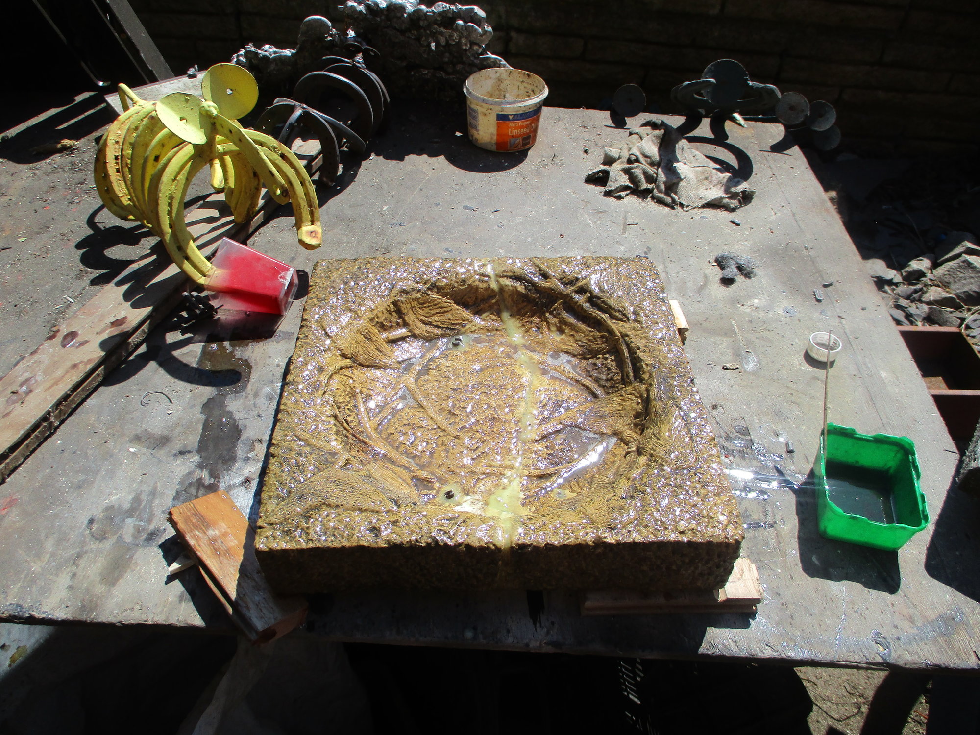

Glued up.
The metal pins.
2 pack glue.
The wood parts.
Can't believe it is not nails.
The crack.
2 pack stone resin glue.
A word to the wise, it will get hot.
The clamps are not holding it compressed.
But to make it easier to move round to glue.
The 4 screws, at the angle pulled the too halves up very tight.
Sealed with exterior grade stone sealer.

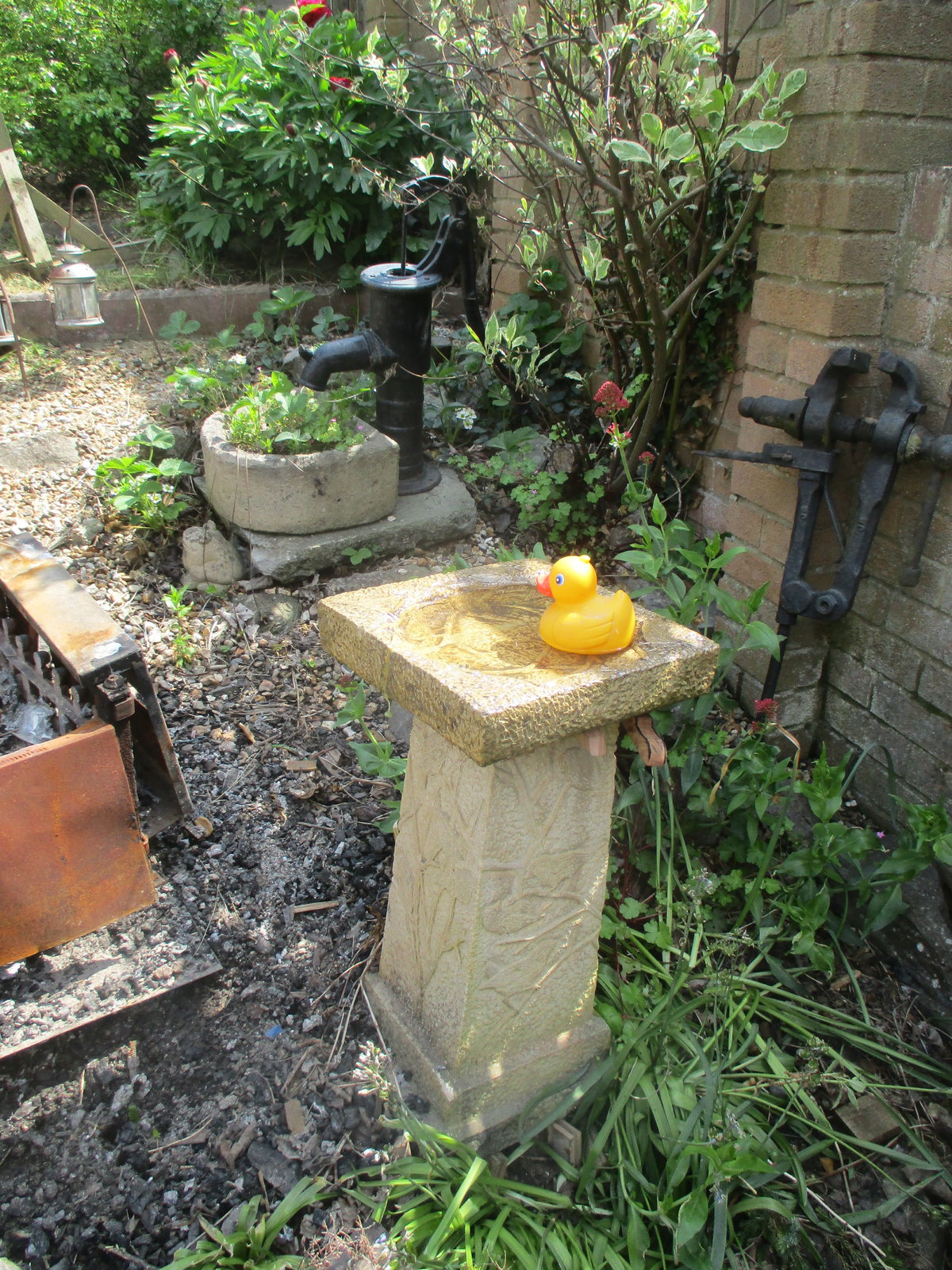

Back in place. Ready for water.
Total cost?
£0:00p

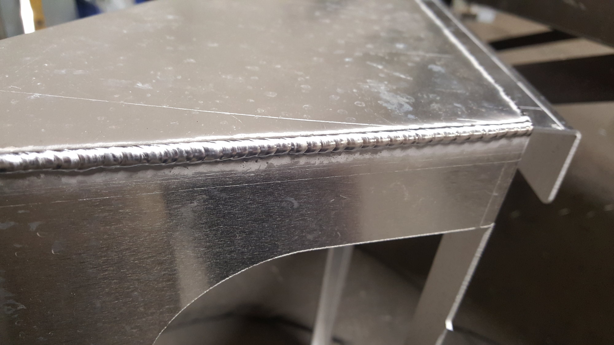

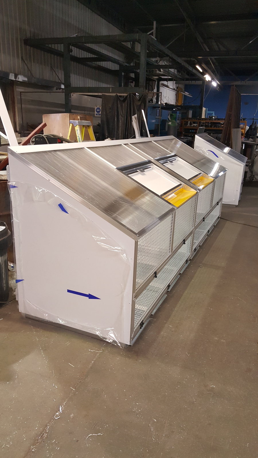

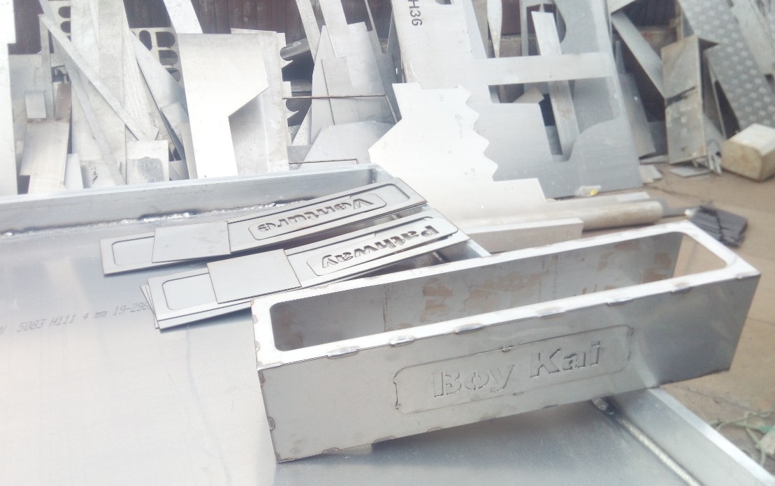

Cut another sheet of 1.5mm 316 for the chute part of the Mackerel stripper boxes I am making.
Got one welded up ready to attach once I get the stripper box finished.

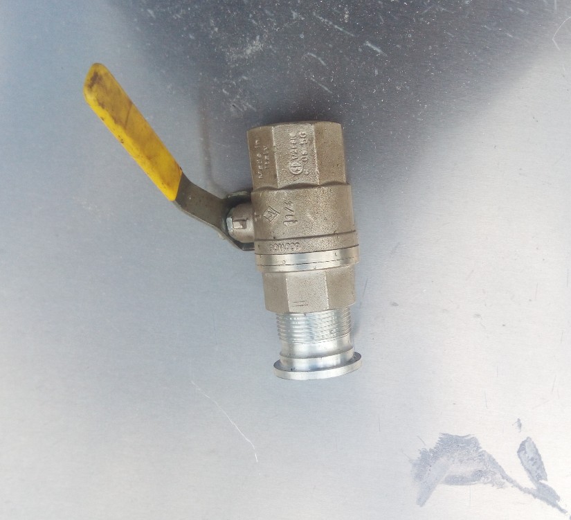

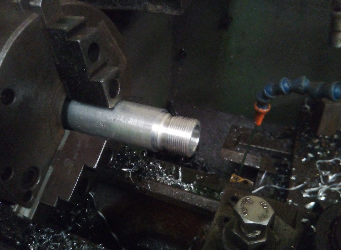

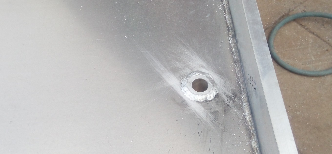

Just before I headed home I decided to turn/thread some 50mm dia Alu.
It is for this 1 1/4" BSP valve.
Bored a hole in the new plasma table and welded it in.
View attachment 228708 View attachment 228709
They are not too expensive, you can get a 1 1/4" brass valve for about £15 or less.I need to source a ball valve to fit our table.

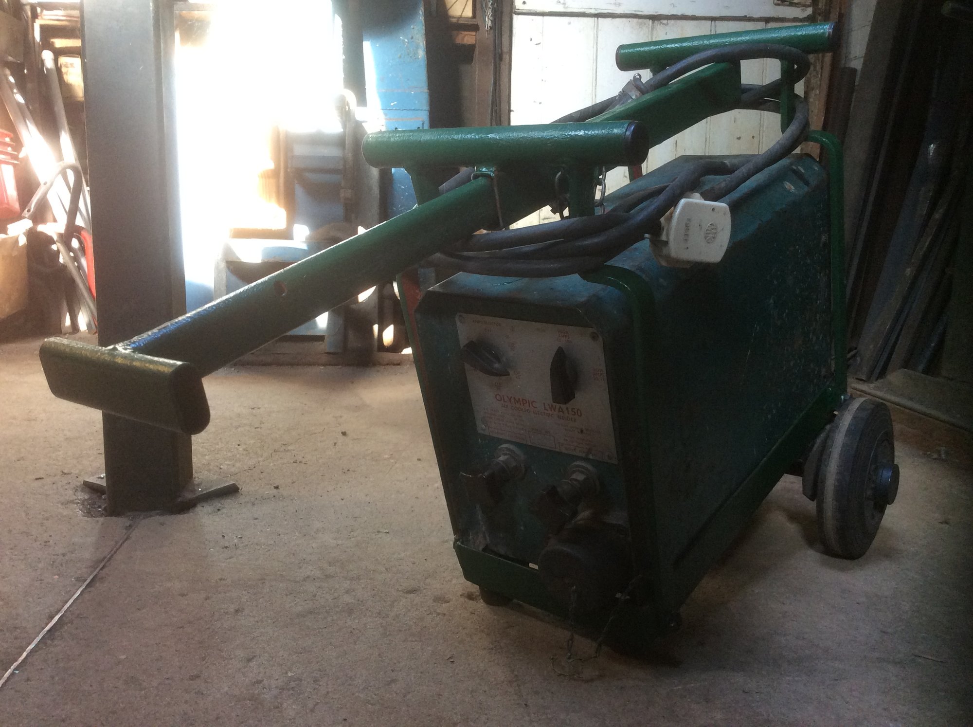

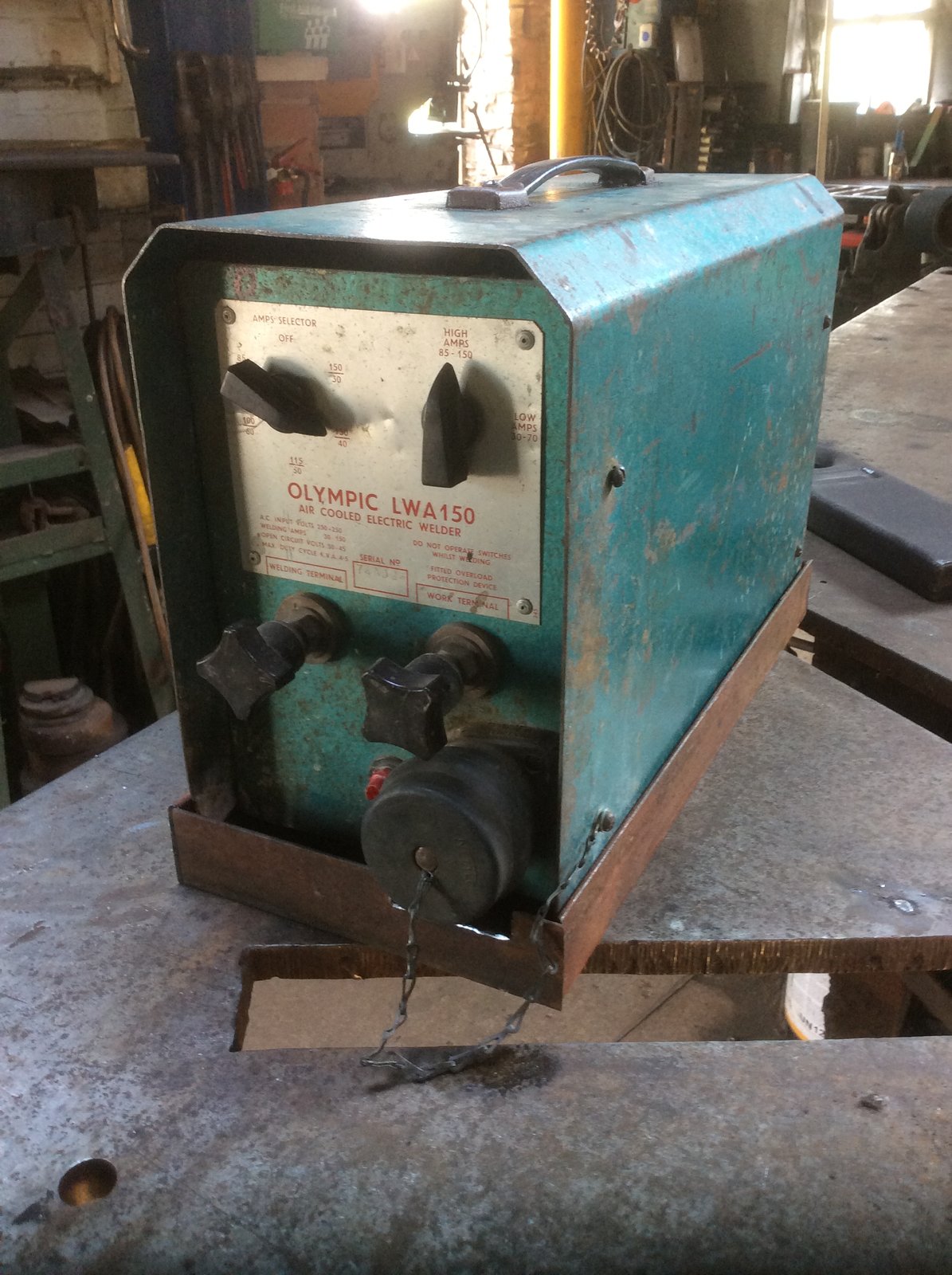

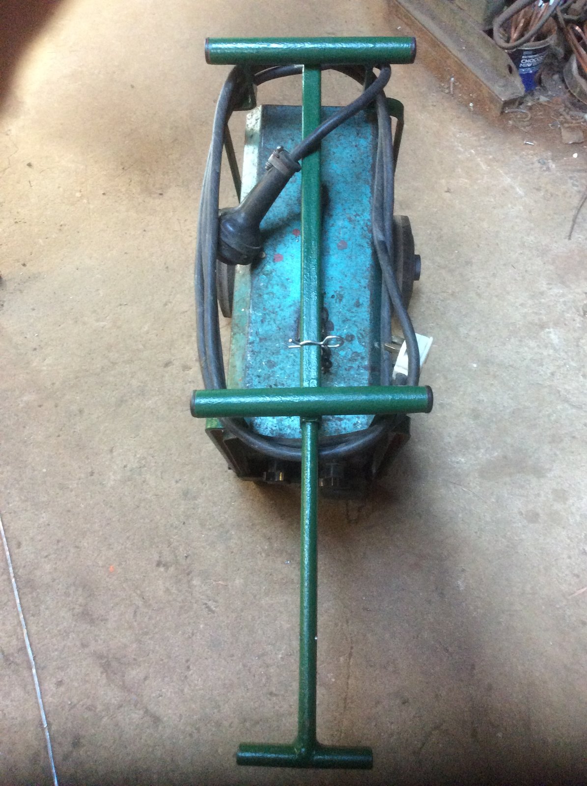

View attachment 228802 View attachment 228803 View attachment 228804 View attachment 228805 Now I’ve used the excellent OLYMPIC welder bought from @mtt.tr ,I wanted to make it easiest to lug around,so copied one I made years ago for a similar ERWO ,wheels off my migatronic,big enough for steps,rough ground,and a telescopic handle.
These transformers outlive the inverters so many times ,but I’ll keep my IFL for occasional use.
