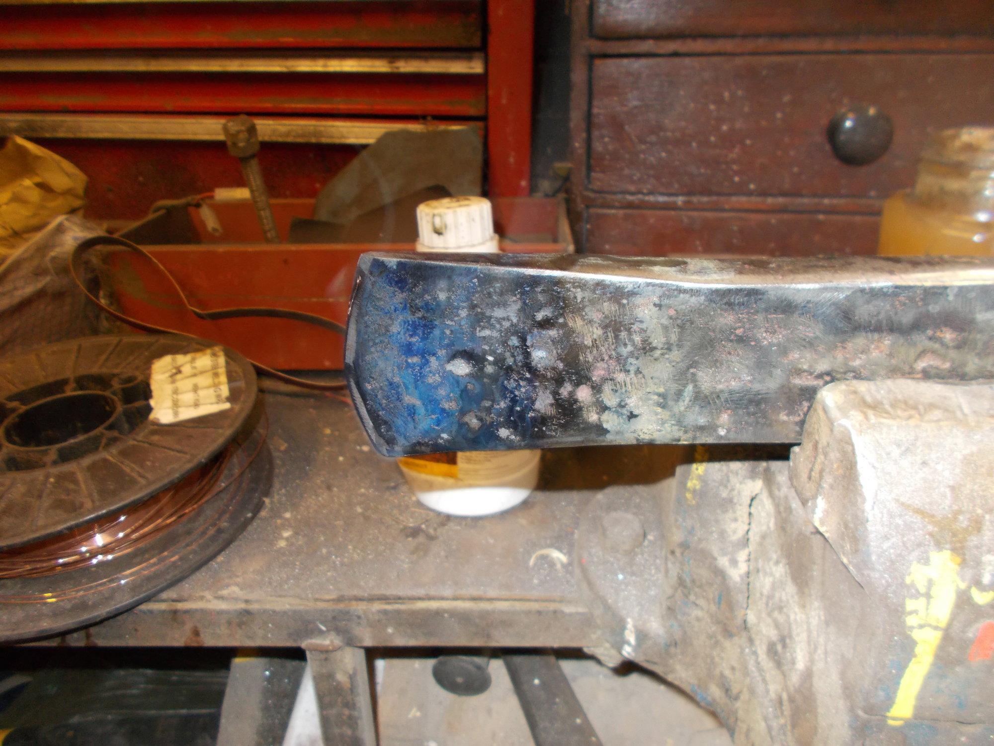

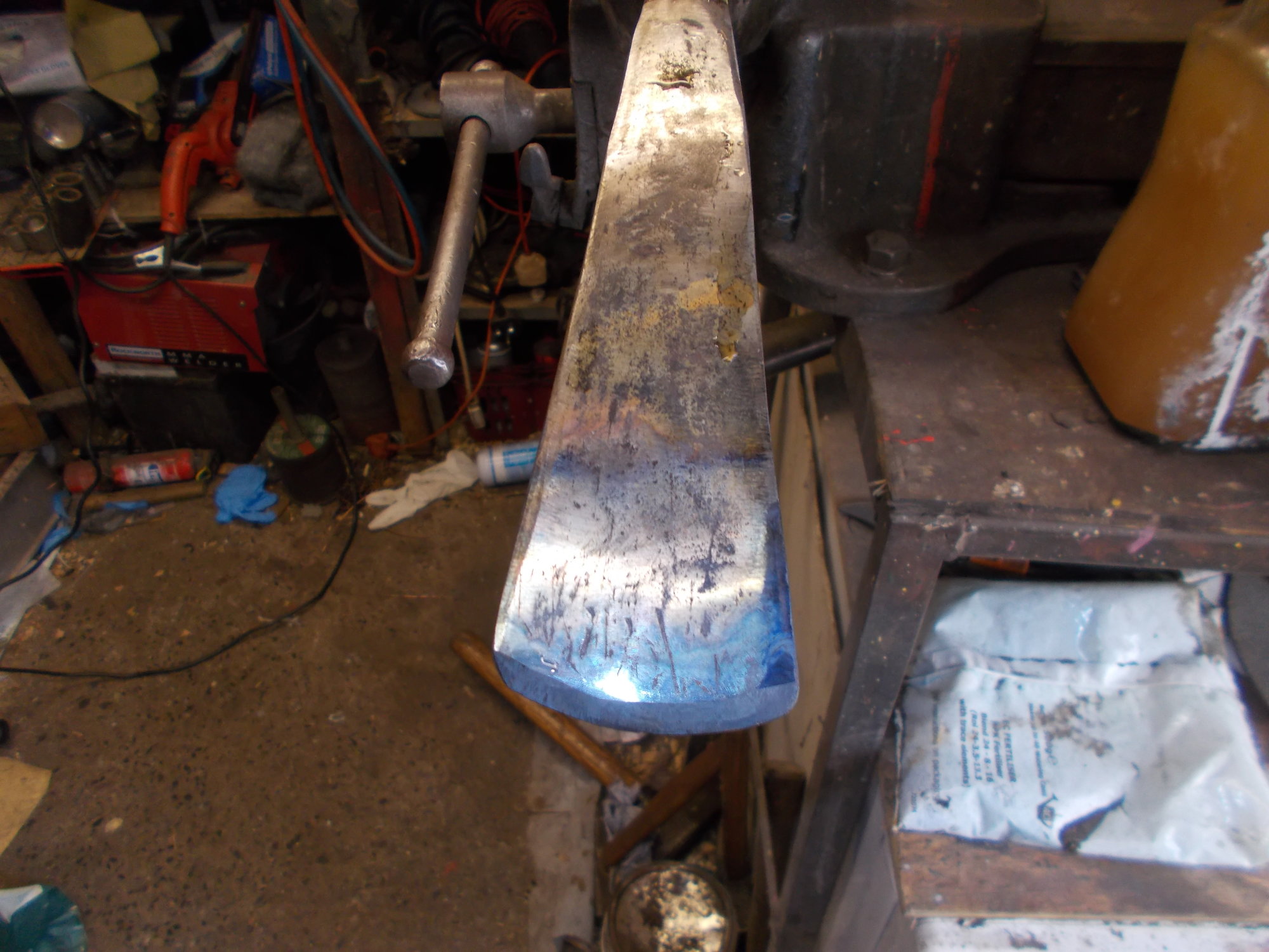

View attachment 213895 View attachment 213896
Ok. This is a pick axe.
But the idea is the same. You can see the way the heat has moved to the tip/
And which one is better for this application (it will hit metal)
