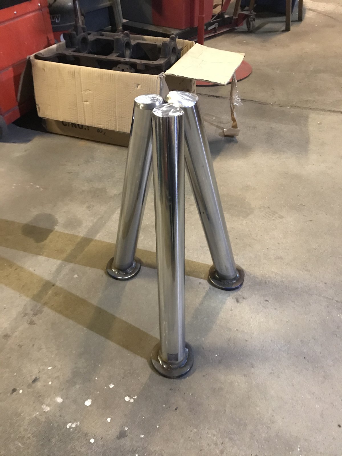

Wow!, R2D2 has let himself go.

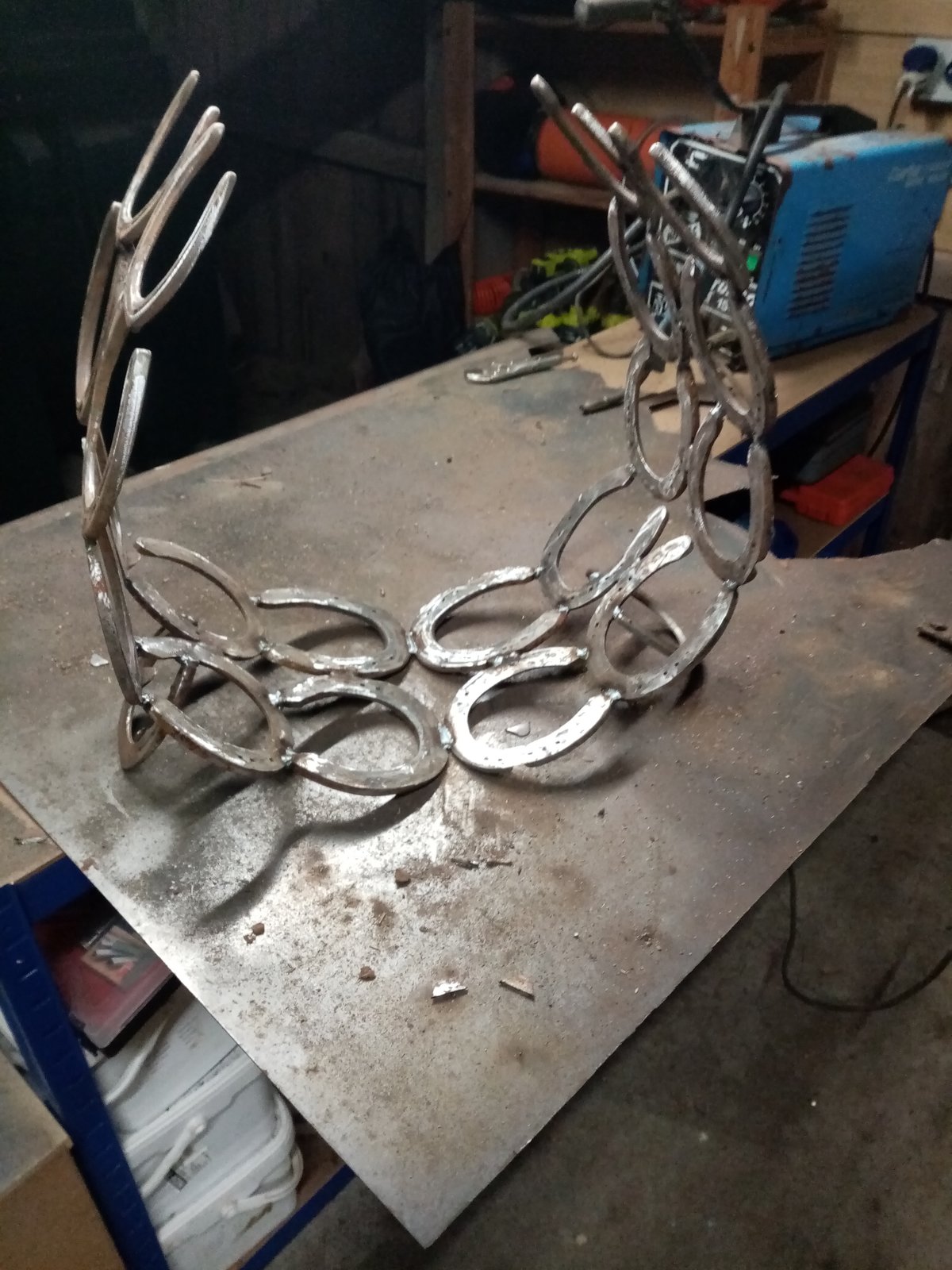

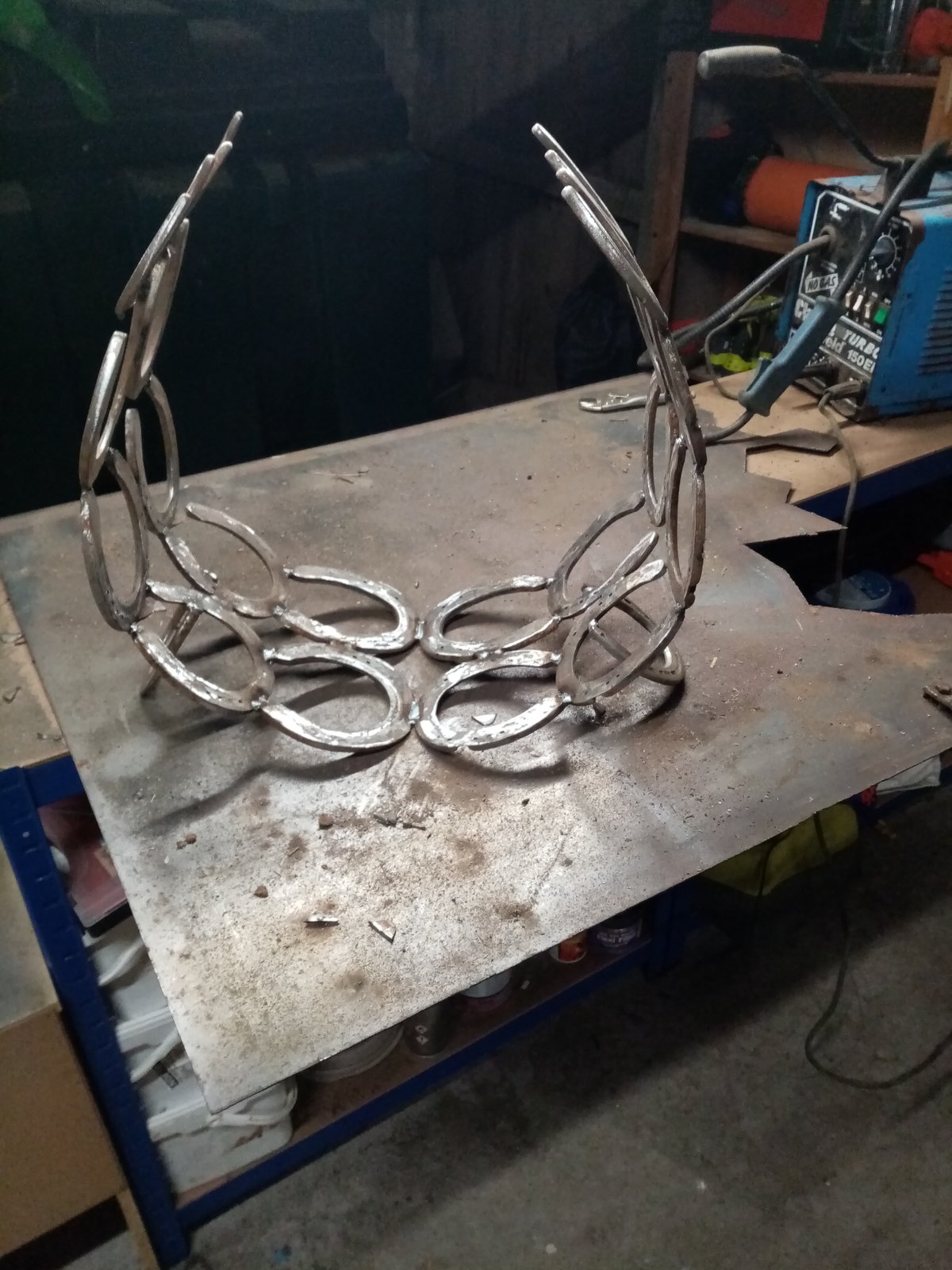

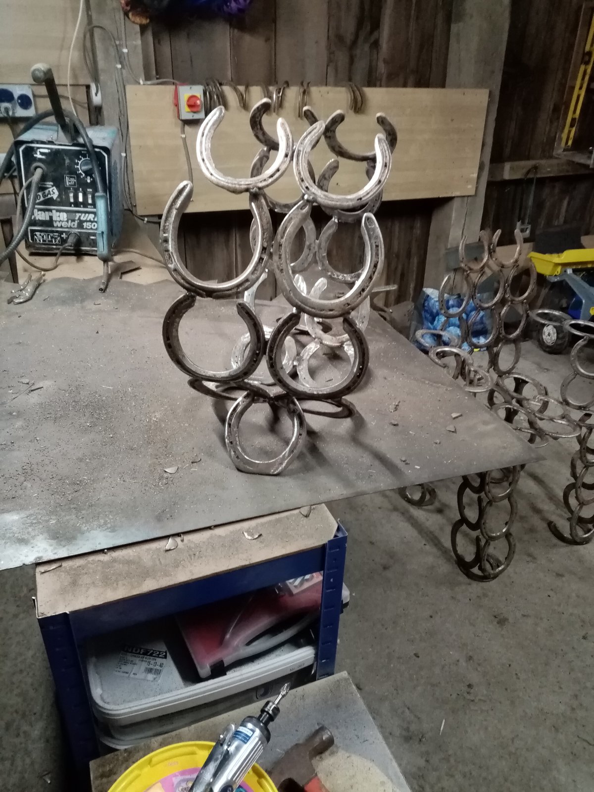

More horse shoes stuck together.
View attachment 208621 View attachment 208622 View attachment 208623 View attachment 208624
A tiara for someone with a *really* big head?
Fire/woodburner log holder?

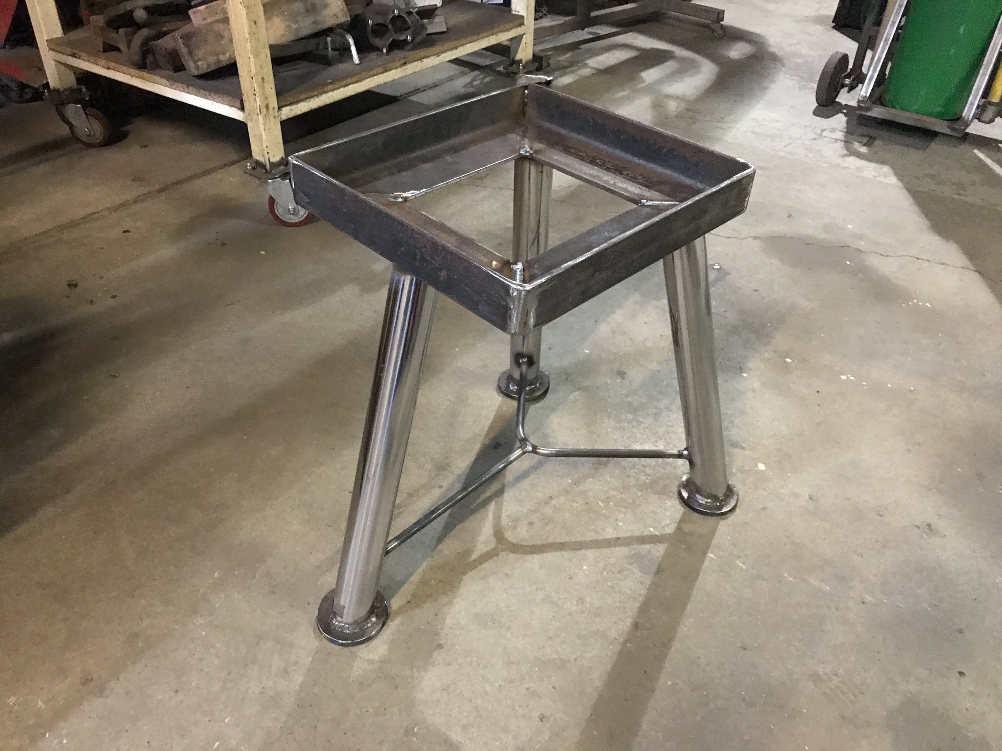

Chopped some 100x50mm channel into 80x50mm angle, glued it together and added the solid 50mm legs.
I need to find my kidney belt so I can lift the anvil on now.
The vertical joints in the corners are welded on the outside and smoothed with a 60g linishing disc so no grinding on the inside.What did you use to grind the inside corners?
